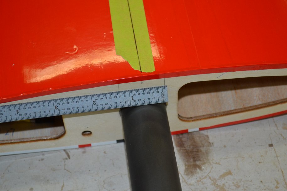

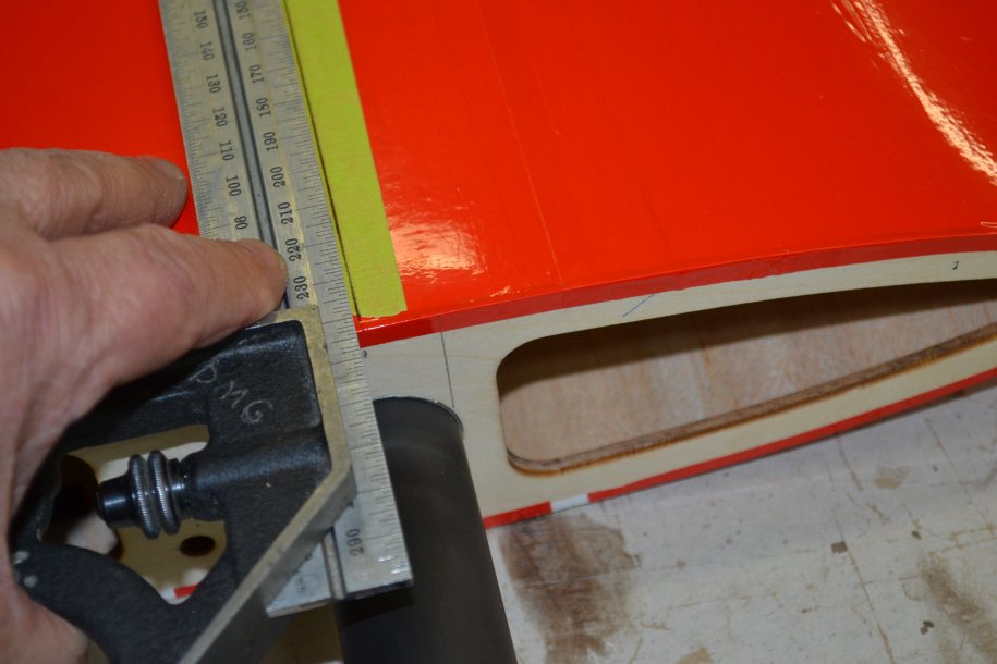

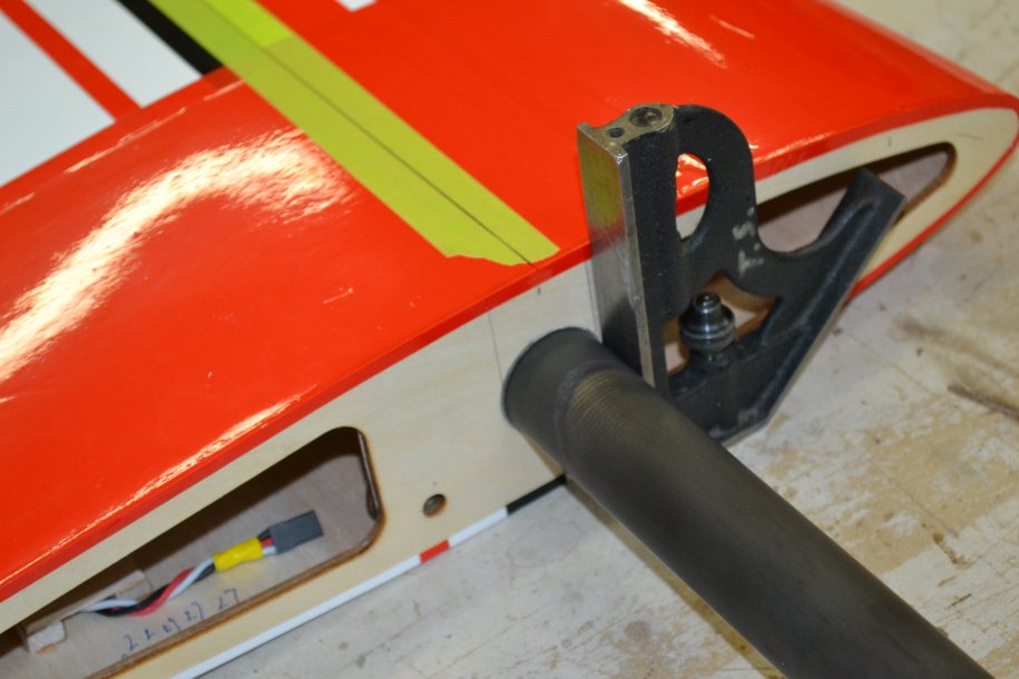

I jumped the gun a little. I had to get ready for tomorrows Club Meeting and Indoor Fly. While I was charging batteries I laid out the center line of the Tube on the bottom of the wing. PAU planes are easy to do it with since all the planes I've had the wing mating surface is parallel with the C/L of the plane.

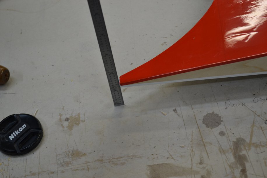

First I blocked up the wing so the trailing edge and the leading edge were parallel with the bench top.Then I used a square to mark each side of the tube. Then you measure and split the difference between the lines to get the center of the tube. Put down some masking tape and draw a line with a Square to transfer the line out so I could use the balancer I have.

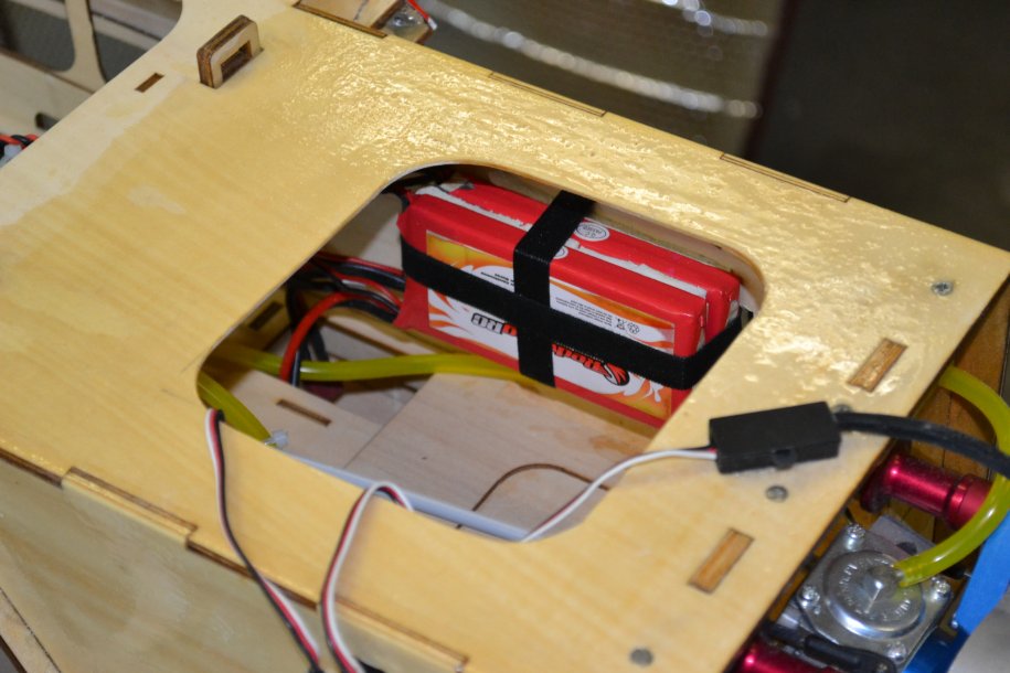

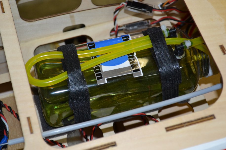

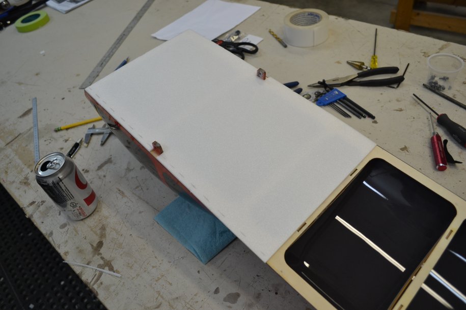

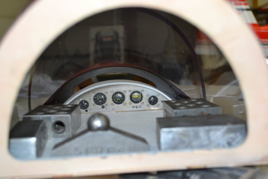

Found the location of the batteries. All thats left is to secure them inside the fuse. I'll get to that sometime this weekend.
Remember you don't have to be to fussy with static balancing the plane. You have to fly the plane to determine the balance point.
Hint for the new guys looking in. You balance the plane by first trimming it for level flight. Next you fly an inverted 45 degree upline. The plane should pull slightly to the canopy. If it pulls to the belly then you're tail Heavy.

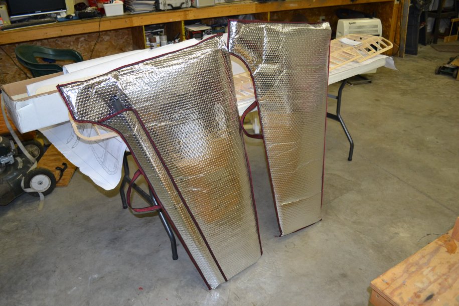

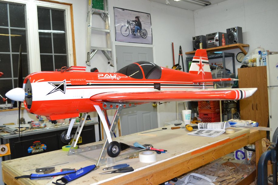

I love these wing bags PAU gives with the Sukhoi. Real easy to use with the velcro closure and they fit the wings perfect.
