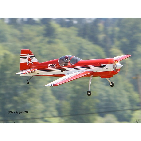

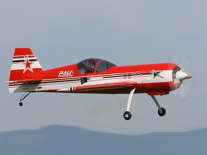

sweetpea
You will love it!
Here's mine
Tseres
For those of you that don't already know. Sweetpea and I are good friends. He's one of my first R/C Internet friends. I've seen those pictures years ago. John is also a great photographer. Sam if you have some pictures that you want to share. I'd like to see them again. There is plenty of room. post them in here.

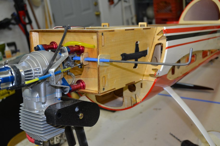

Tom actually stopped by my house in when I lived in VA once. We got some pictures of him with my PAU Edge! We have not gotten to fly together yet, but now that I'm in Ohio we should be able to make that happen. All my Su-26 pics are on my home computer.....I do think there is a build thread on FG though. Basically this plane goes together very easily. Only items to look out for
1. Gear are a touch tricky to put on, but if you have a pole extended magnet it is easy.
2. The lip of the cowl will vibrate against the hatch. I used 3M red electrical tape to go over the lip so it doesn't rub the hatch or chip the cowl
3. Never run the engine with the cowl on and the hatch removed. The vibration will crack the paint on the lip of the cowl.
