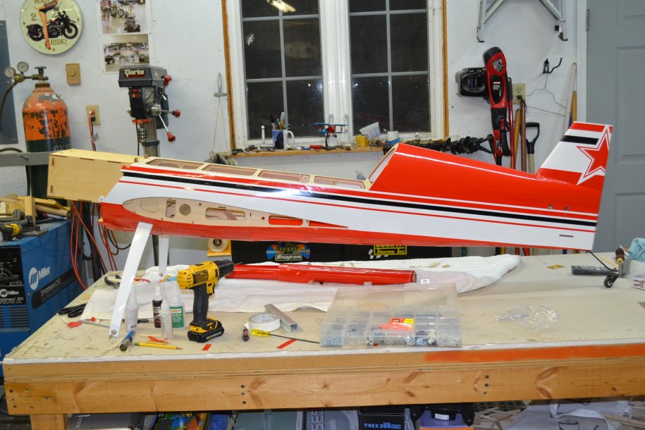

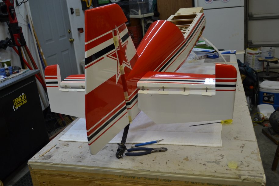

Its back on the building table. I'll have some time this afternoon to start on the Hinging. DSC_0108.JPG

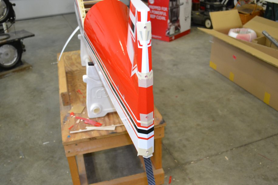

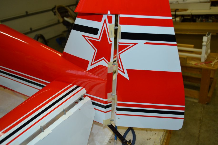

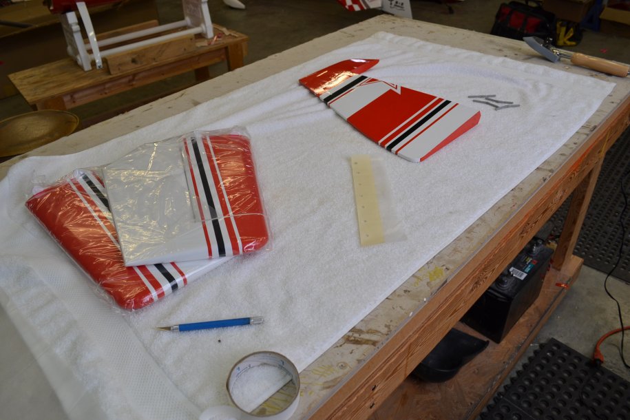

Got the first four steps done. Shrink the monocote. I have to say that this is the best covering job I've ever seen on an ARF. There are a few bubbles but all the seams are tight and there are a million stripes on this plane. They were all stuck down real nice.

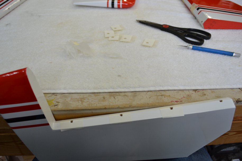

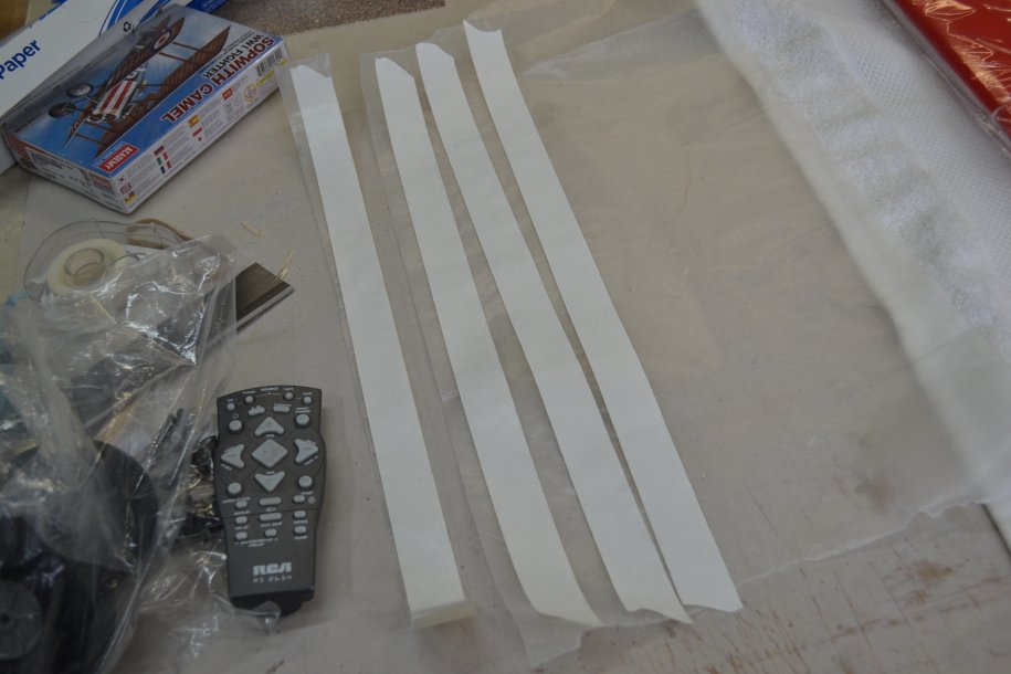

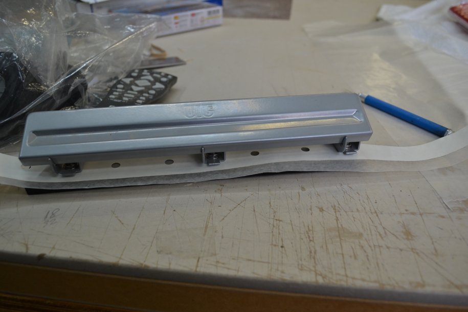

Then I made up some masking tape to protect the covering around the hinge holes from the glue.Learned that from Terryscustom and it works great.
Put all the masking tape in place.

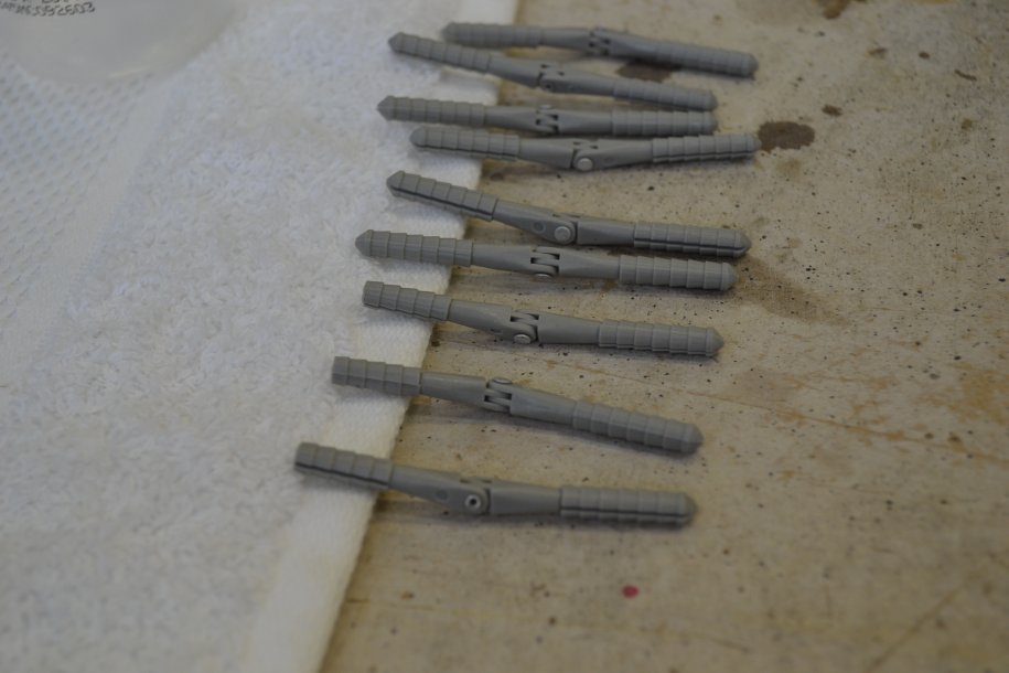

Glued in all the hinge points with epoxy on one side only. I learned this the hard way. I used to use gorilla glue on both sides and taped them in place overnight. I got away with it a couple of times but it only takes one time for the glue to push the pins out of place and you learn fast. I'm going to wait for the epoxy to set up then I will use gorilla glue on the other end of the hinges.
Side note. There are 4 hinges that are shorter on one end. These go on the inside of the stabs. 2 each. These holes aren't deep enough because they are blocked by the Stab Tube Socket.

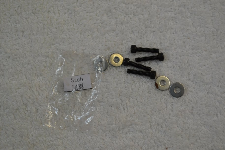

One thing that I like about PAU planes. They have all the hardware separated and marked in English. Yeah. I switched the flat washers out with some Bonded washers to mount the stab... We all have our preferences and I found that I like the bonded washers the best.

Terryscustom
Masking tape stuck to wax paper.......why didn't I think of that! Makes it a lot easier when the paper punch is not sticking to the tape I bet. Way to improve an an idea Tom!
Tseres
You just said you punched holes with a hand punch. I never thought you didn't use any backing. The wax paper sticks to the tape pretty good but will peal of with a gentle pull. My notebook paper punch is also a compromise to your idea. Cause that's what I had handy.
I like that idea too: will do on my next assembly!
