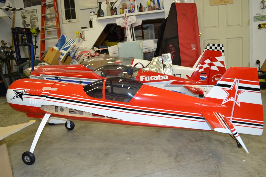

I use the 1283's on my Carden yak on A123's. They have been perfect. After I get the PAU ultimate the sukhoi is next!

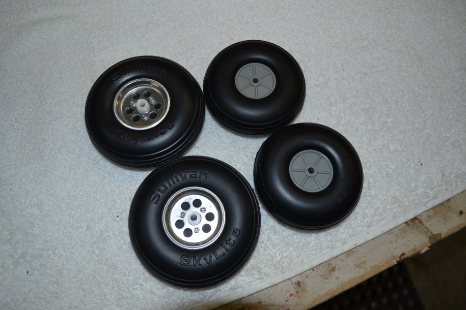

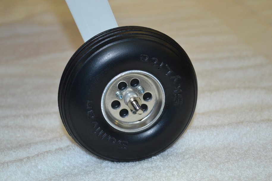

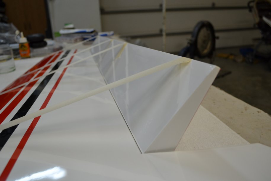

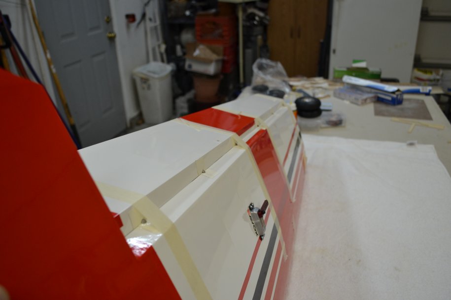

When you get the plane together the 4" are perfect. Nice choice BTW, I really like those wheels on all my planes that I don't do the WR wheels. For hinge gap I normally bend the surface just a hair beyond the max deflection I expect to get when done, then tape at that angle and use tape on the other side to pull the gap tight. When dry and tape is removed there is a gap left that is sealed with your preferred method.

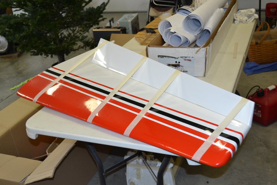

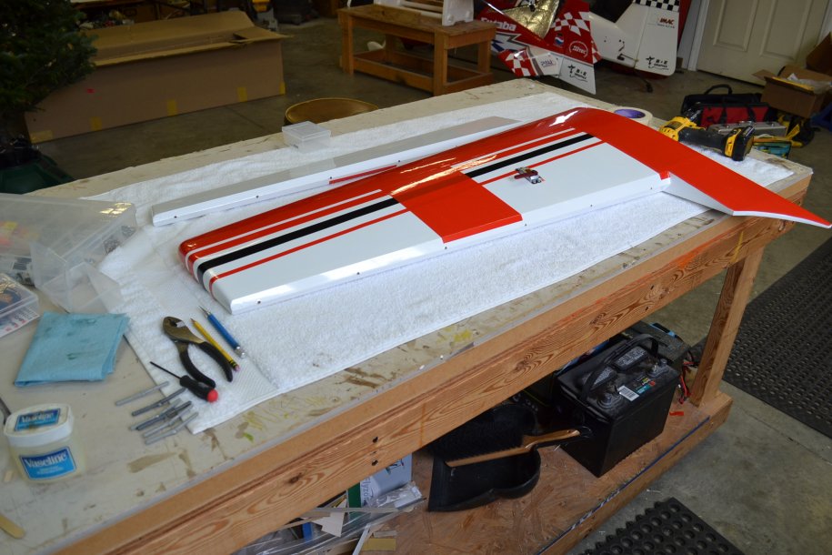

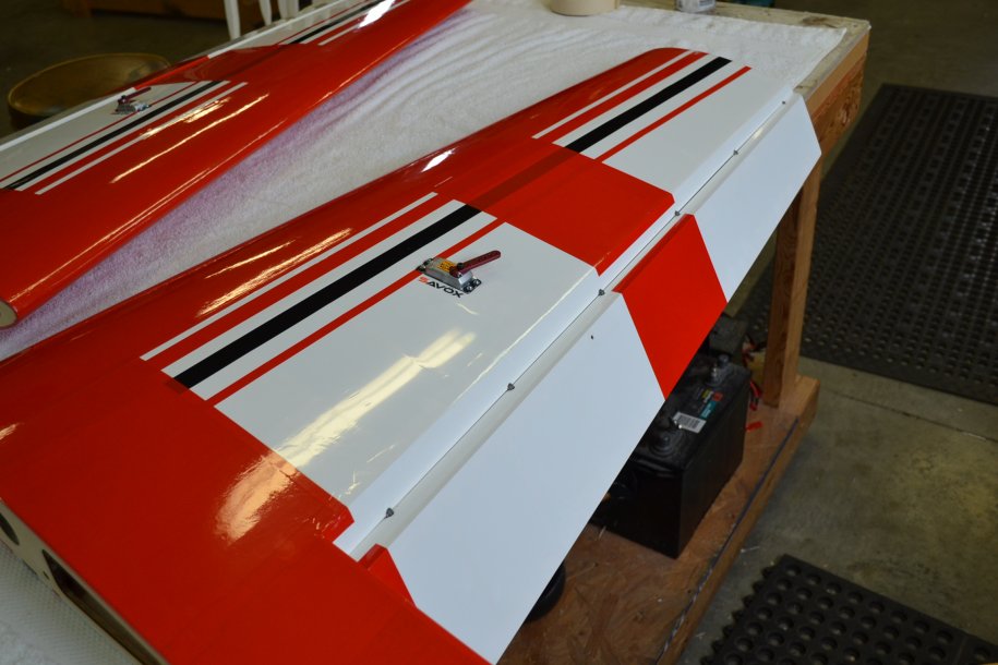

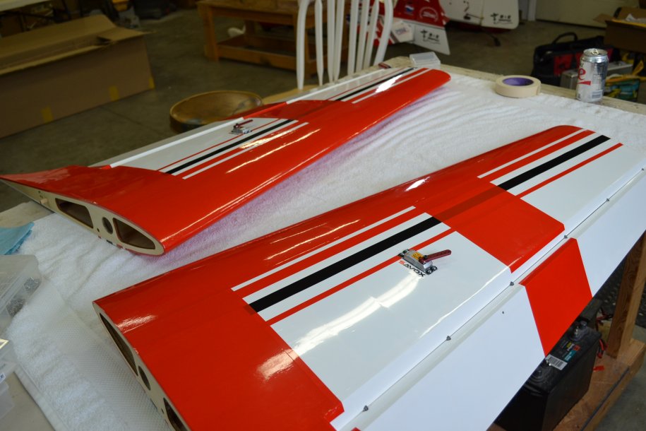

I have the second wing hinges epoxied into the wing only. While that is drying I picked out the tape from the first wing. These hinges are turning out to be the best I've ever done. I think its the routine partially, but mostly because I'm taking my time.

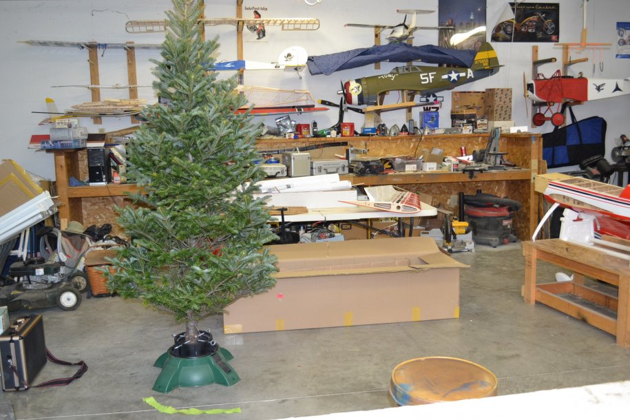

Yes. Christmas is alive and well in Toms Shop.

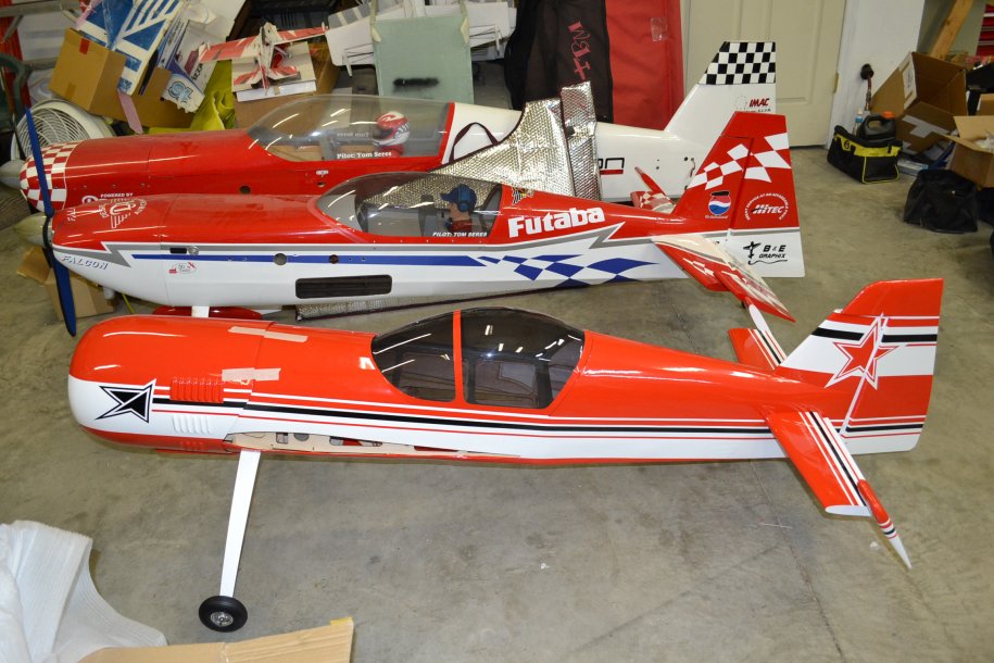

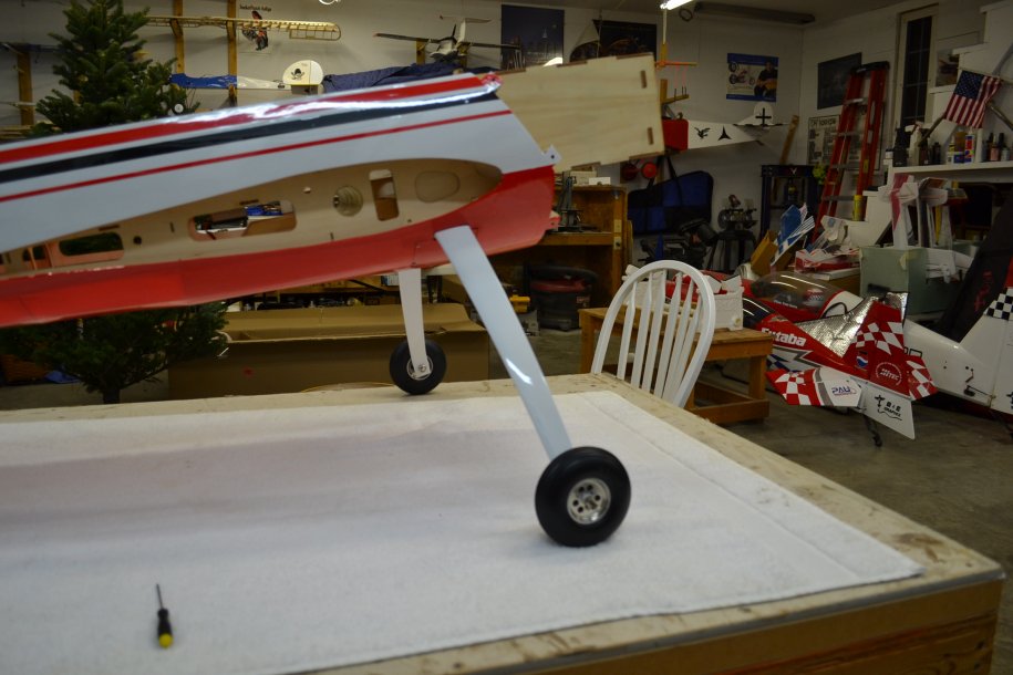

View attachment 5461 View attachment 5462 View attachment 5463 View attachment 5464 View attachment 5465 View attachment 5466
