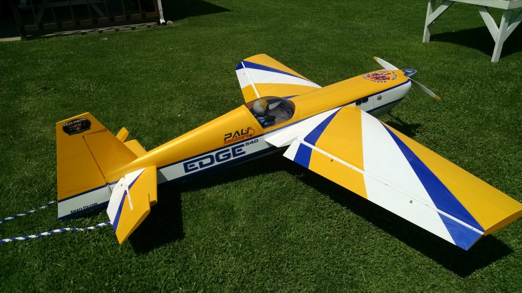

In good news...I got my edge ready to fly finally after the move and shop being built.
Bad news is tomorrow may be a crappy day.
sweetpea
Shouldn't be. I put my batts just behind turtle deck with pull pull. If I had push pull they would go on the motorbox

Only took about 8 months from the day I moved......PAU Edge finally got airborne. Windy day with 10mph crosswinds, but had to get out
