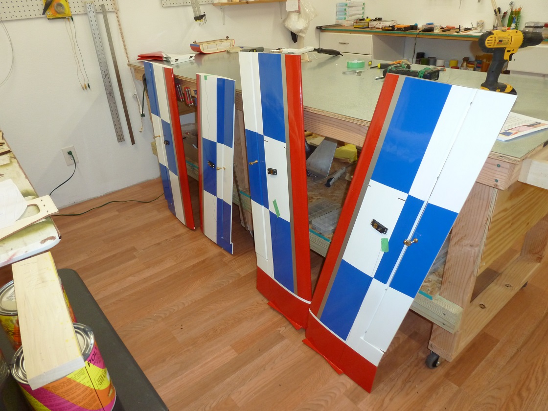

Assembly has been progressing but very slowly. Yesterday as I was working on it I noticed the overlying covering was not looking like it was stuck down as well as I thought. So with each piece it is really, thoroughly, absolutely getting ironed down, it kind of put's me in mind of old covering where the clear peels leaving the coloring and adhesive. Not sure when it was made, box says it is number 62, but if it is from the original run it would be 9-10 years old. I don't know but I'll finish it up, fly it like I stole it, and hope the covering stays put.

Take your time it would not be the first time that I have seen an ARF land with one side of the wing covering flapping or missing.

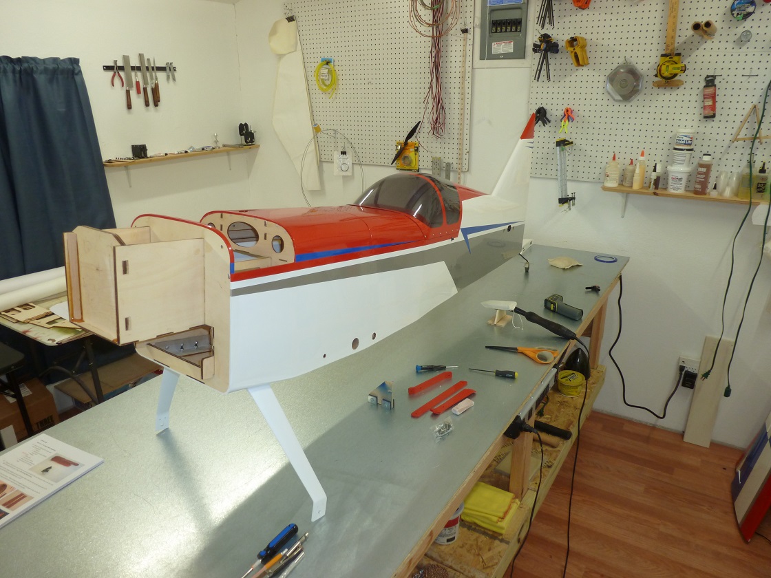

The cabane is in loosely, I won't tighten it up until I can mount the wings. The wing servos and control horns are installed less the wiring, as usual no wiring until assembled.

It has a canister tunnel but don't see the usual heat exit just somewhat large square blocked areas. I will probably have to make a ply piece to fil in one of those areas with the usual tunnel exit slots.
The same with my Extra two large rectangle opening in the cover for the exhaust . I had to cut two to fit my tuned pipes also enclosed the area with balsa so the heat has a place to exit . Two canister brackets were install for the pipes and one for canisters .

This Ulti has the can area boxed in quite well and with front dumps I just need a heat exit. Getting a piece of filler shaped to fill one of the big areas will be the most difficult part. But then maybe not if I use a 1/4" thick piece of the green flower foam as it is very impressionable. Should be able to lay a piece over the area and just rub the perimeter to get the shape and size.
