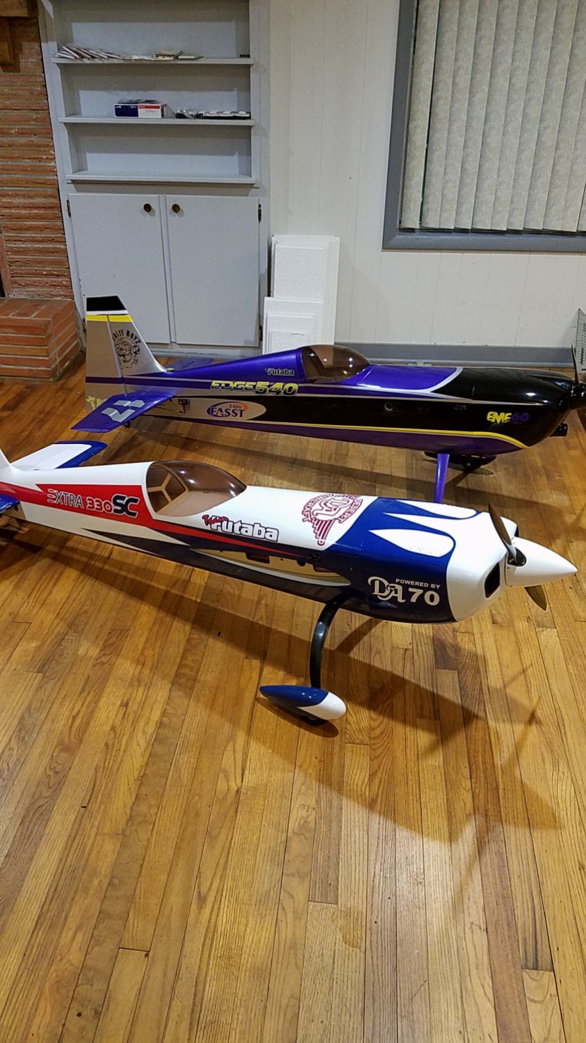

TY Kelly, you were right though, color didn't help seeing it, still blacks out, unless keeping it close. It;s fine, just gotta keep your eye on it. I got 3 flights on her this eve, an we starting to become friends. Don't get me started on the xtra I'm really LOVING it. I've never flown anything that tracks like this thing. I just got @combat chicken canister, and installed it this morn., need a tune, an gonna let her eat some more.

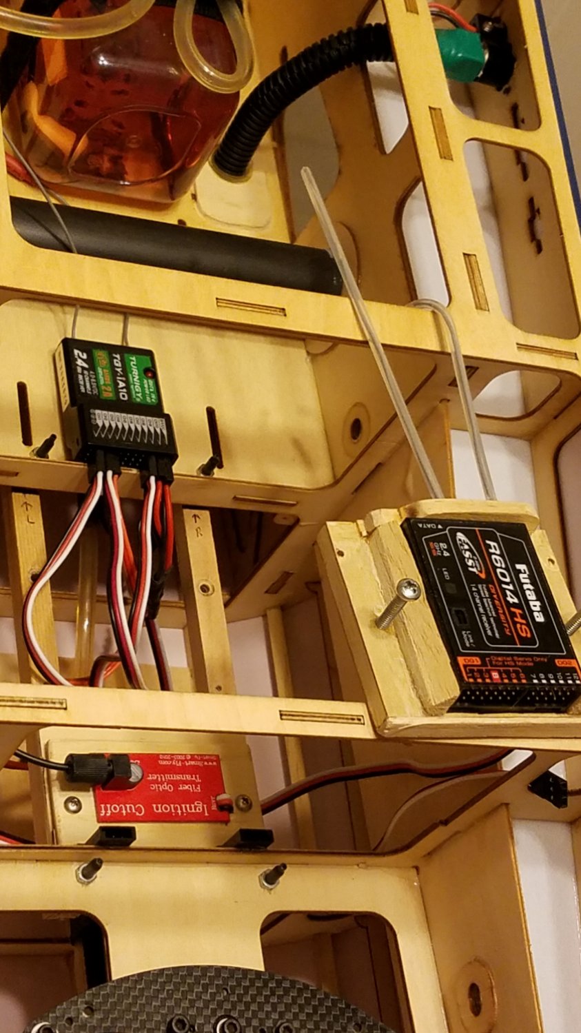

Glad I got six to try out. Servos that is. Set the plane up on the i10 and found the rudder servo has an issue and needs to go back for service. Everything else works perfectly. Set the servo frequency to 335hz and everything else works as it should :)

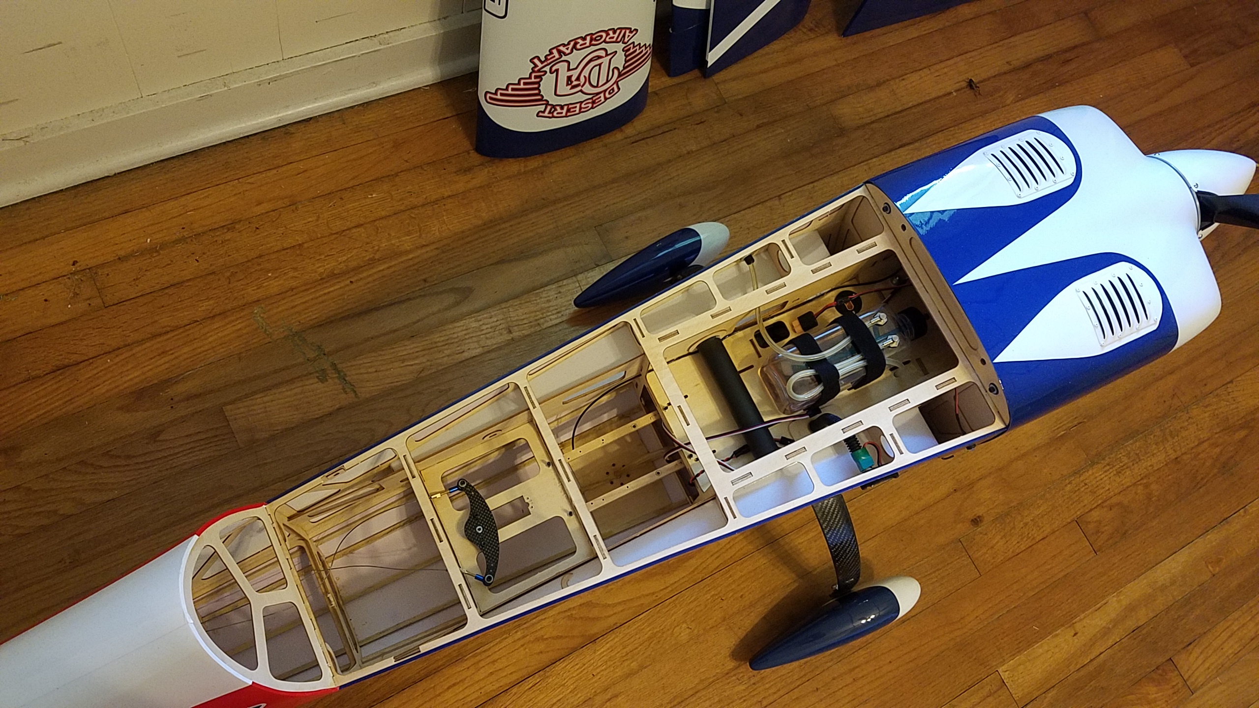

It has been a bit and the plane has just been sitting pretty in the hangar. All 6 BLS-H50B servos have gone back to Blue Bird for "updating". I wont have them back for a bit but the problems encountered and found with the extensions have made me realize that the workhorse BLS3114's where not operating to their full potential. I am going to make some nice heavy duty extensions with MPX connectors and re-install the 3114's so they can have all the "potential" they can get:attaboy:.

The 330 sets a little naked right now. Once All my servos are back it will get an Aura to boot with the i10.
