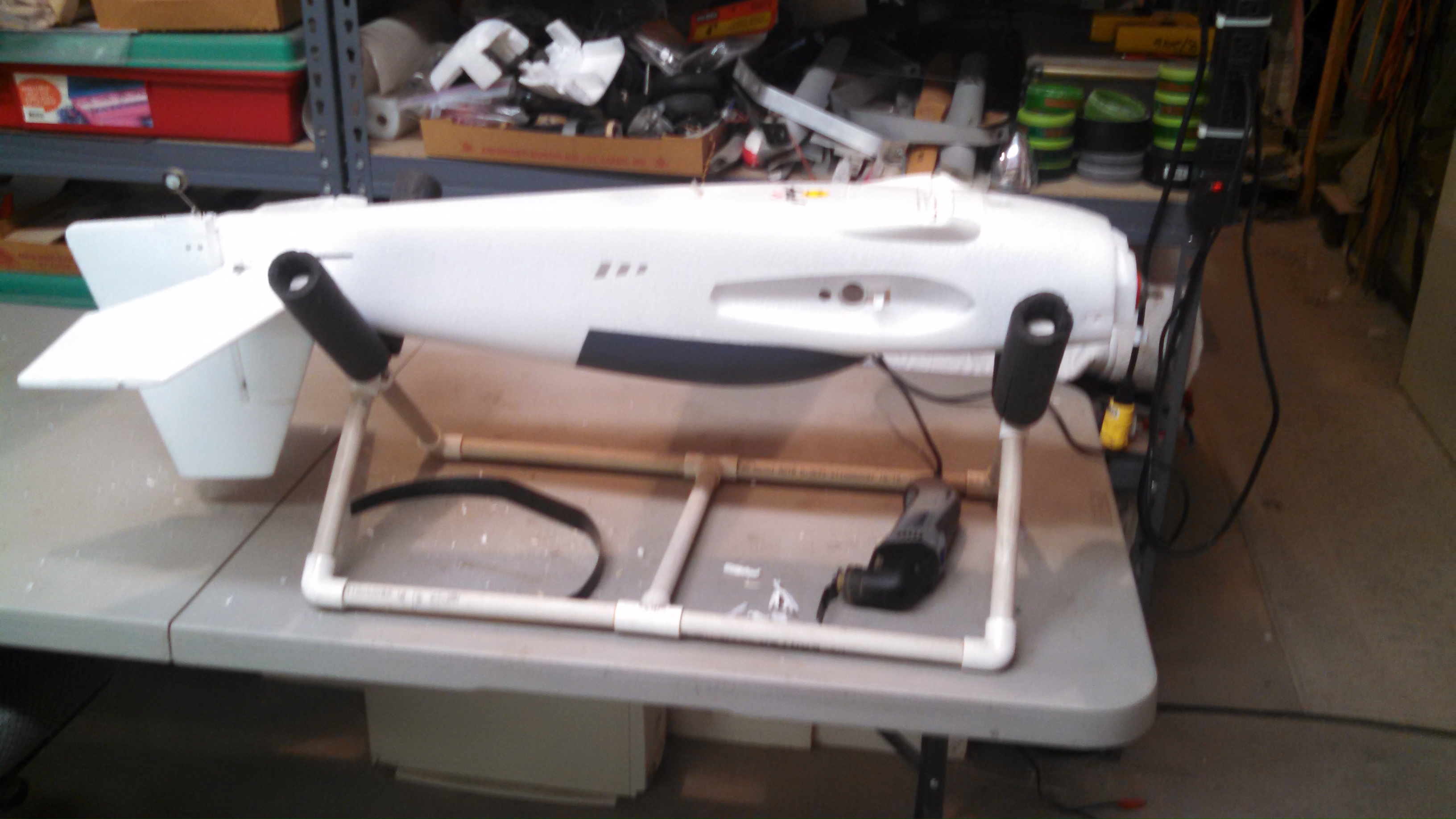

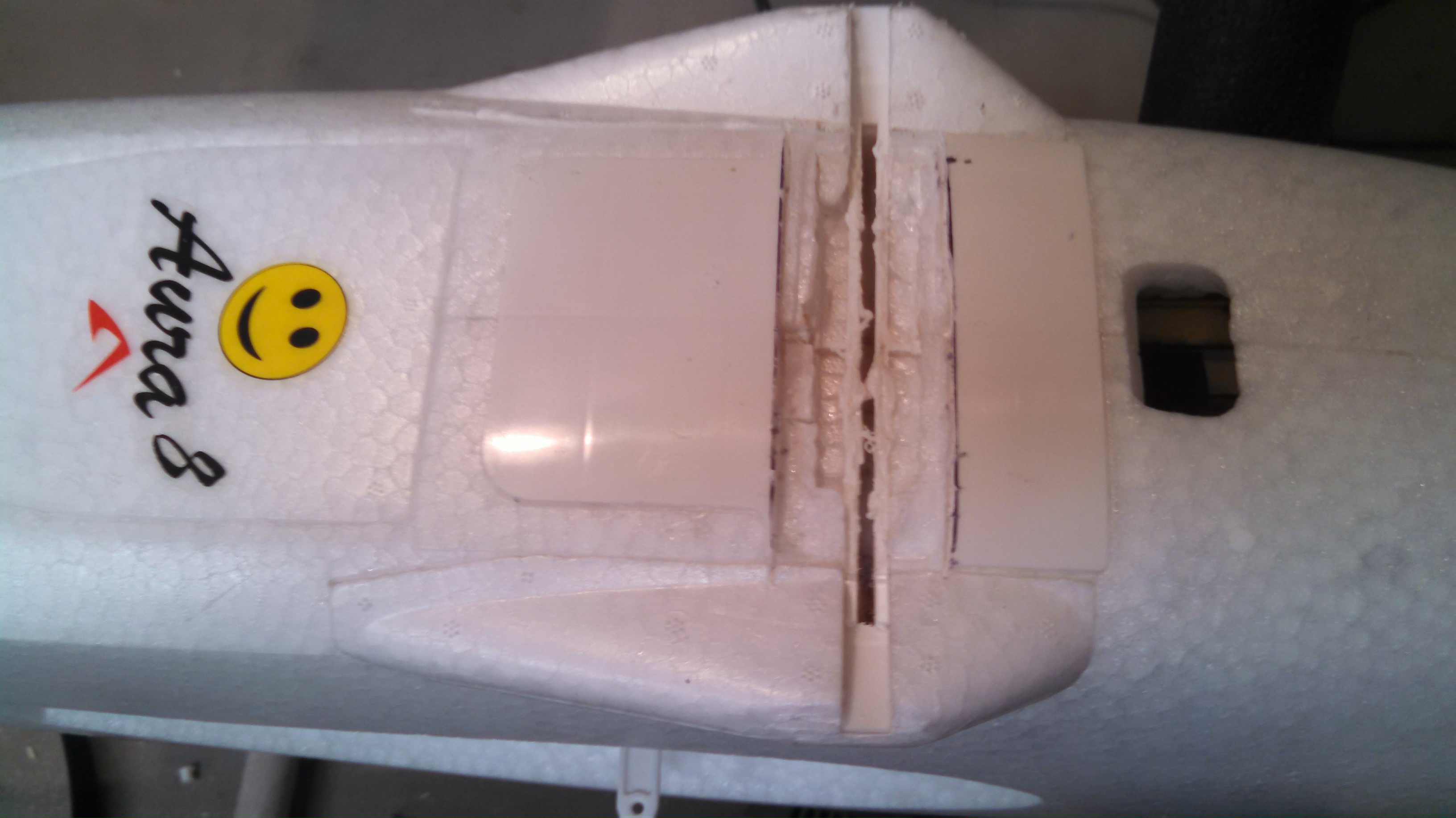

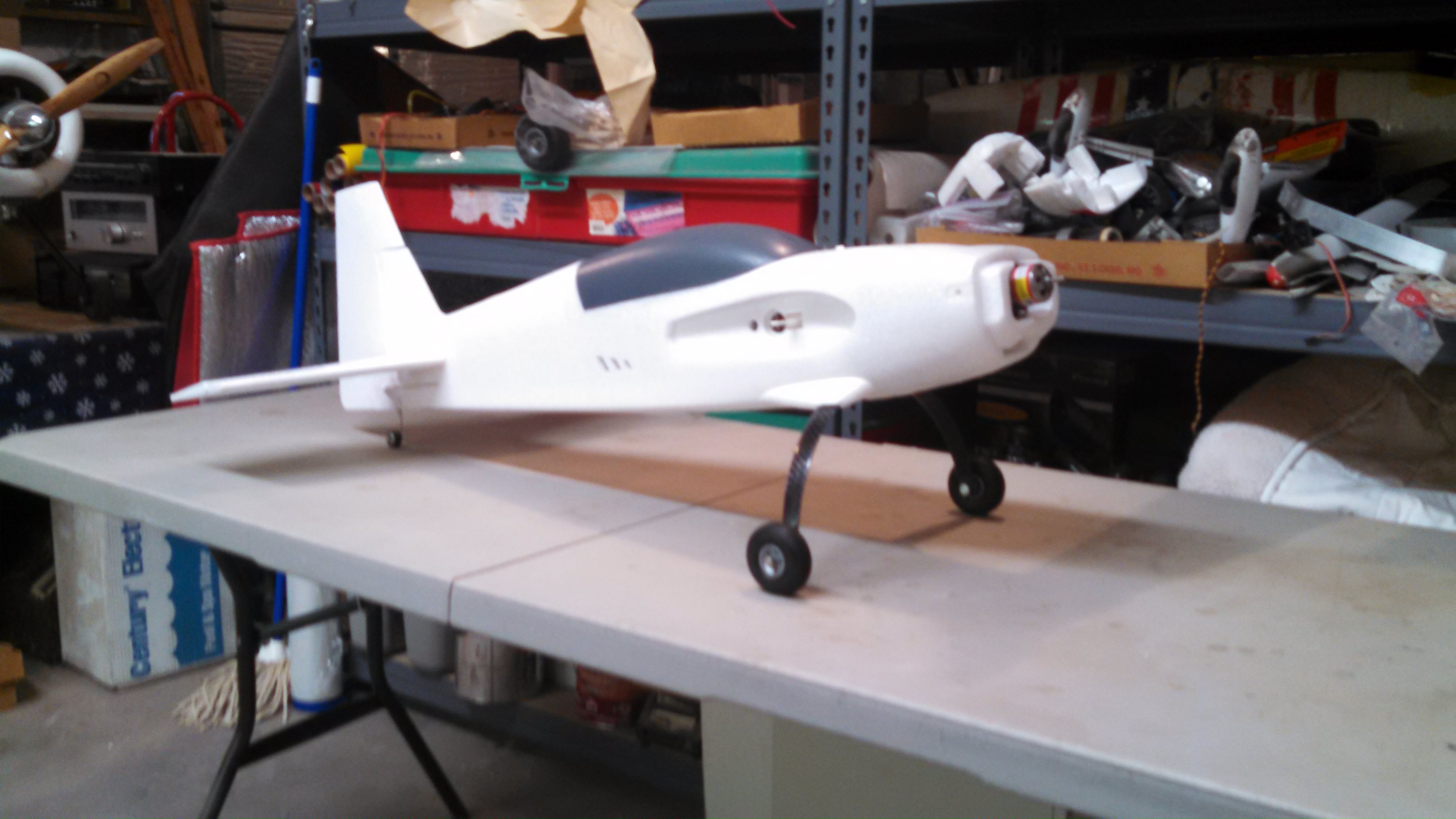

Permission to hi-jack the thread? @49dimes, what adhesive did you use on the gear block in the QQ Extra? I'm debating 30 min epoxy vs Gorilla Glue. Also thinking of some carbon fiber rods 2-3" through the gear block into the foam above? How is yours holding up?

I used 30 minute epoxy. I also glued a piece of 1/4" x 3/8" hardwood stock down the middle of the gear plate that slides in to the slot that's left in the foam from the plastic one. It gives ample area and strength for just the glue to bond and hold everything. The foam will break up before the gear plate comes loose. Mine is holding up extremely well. The guys at the field are impressed at how good the ground handling and rolling on grass or pavement is.
Yeah, I was thinking about trying the plate idea as well. I'm just about done leveling things up. I'll give it a go this afternoon. Thanks!
