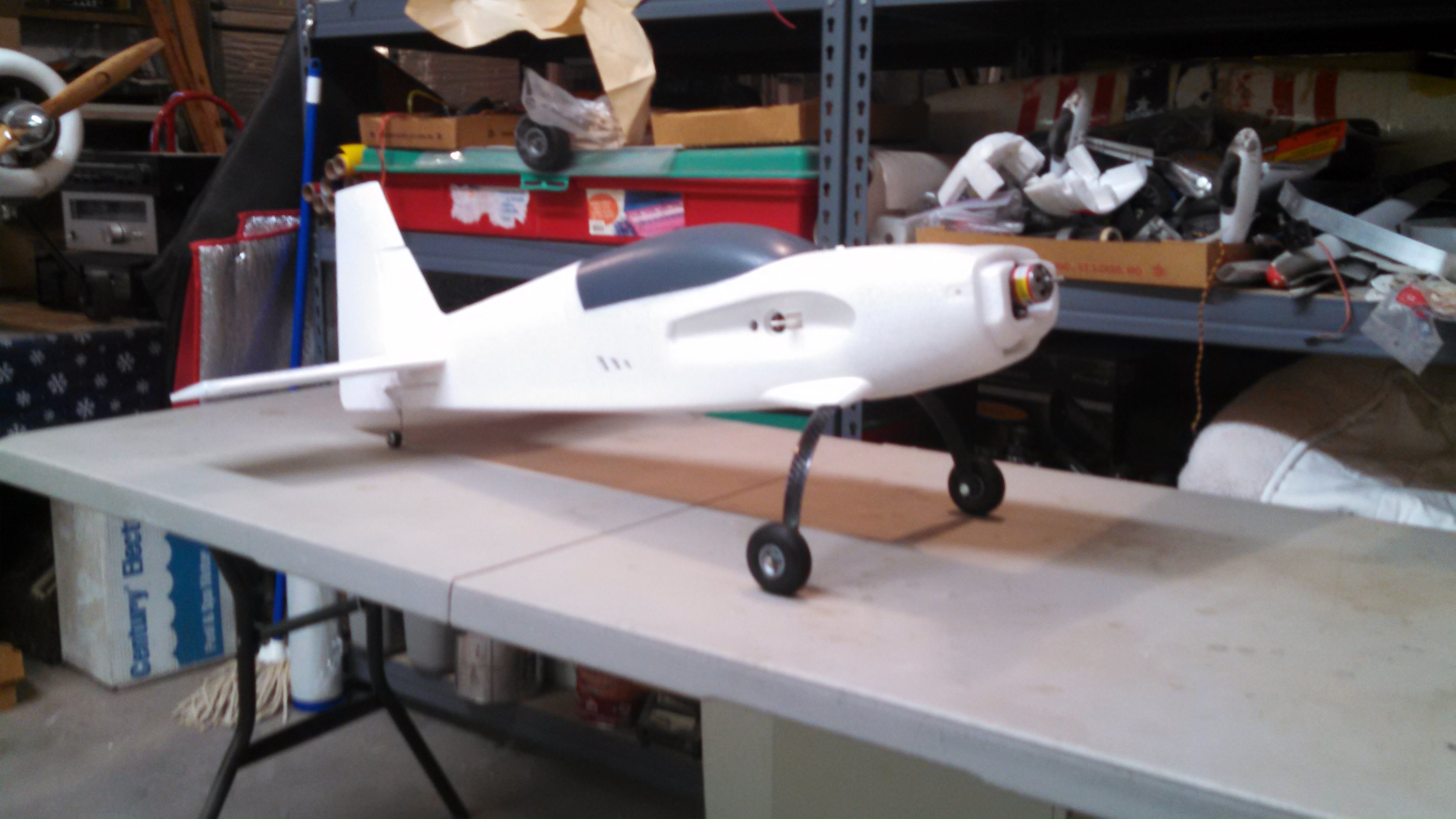

. Latex spray paint works great on the plastic protective cover of the foam.After two attempts finally got a battery solution going for the Extra to get rid of dead weight and put about a pound (15.2oz) of weight up front over the engine.
View attachment 101069 View attachment 101070 View attachment 101072 View attachment 101073
Must say that looks professional it is crazy the lengths we will go not to add weight to our planes but you know it is worth it, it just fly’s so much better when they are light. If you need any help on putting weight on the front of the plane again just ask @Jetpainter he has a picture on how to do it properly I will never forget that one.After two attempts finally got a battery solution going for the Extra to get rid of dead weight and put about a pound (15.2oz) of weight up front over the engine.

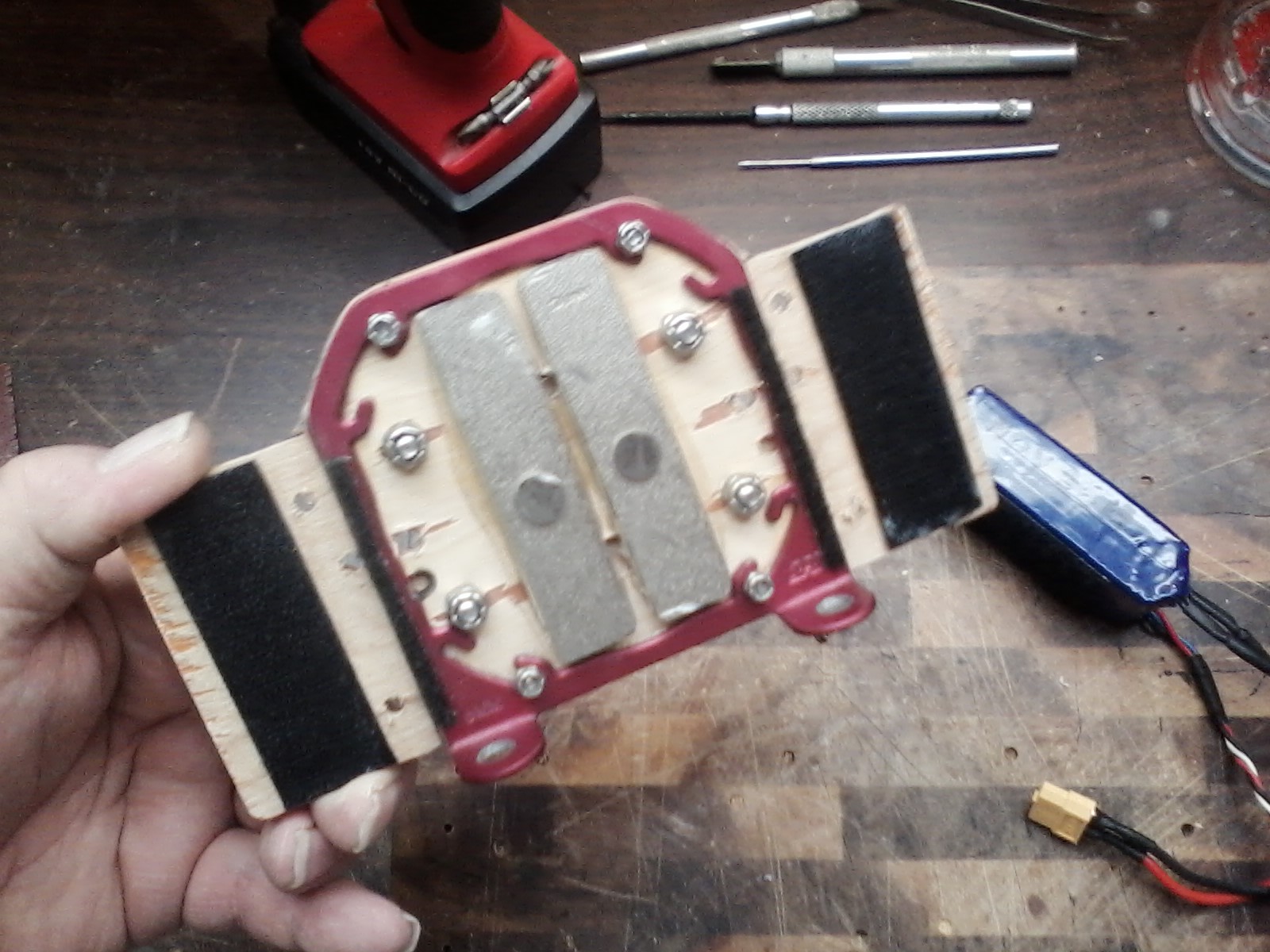

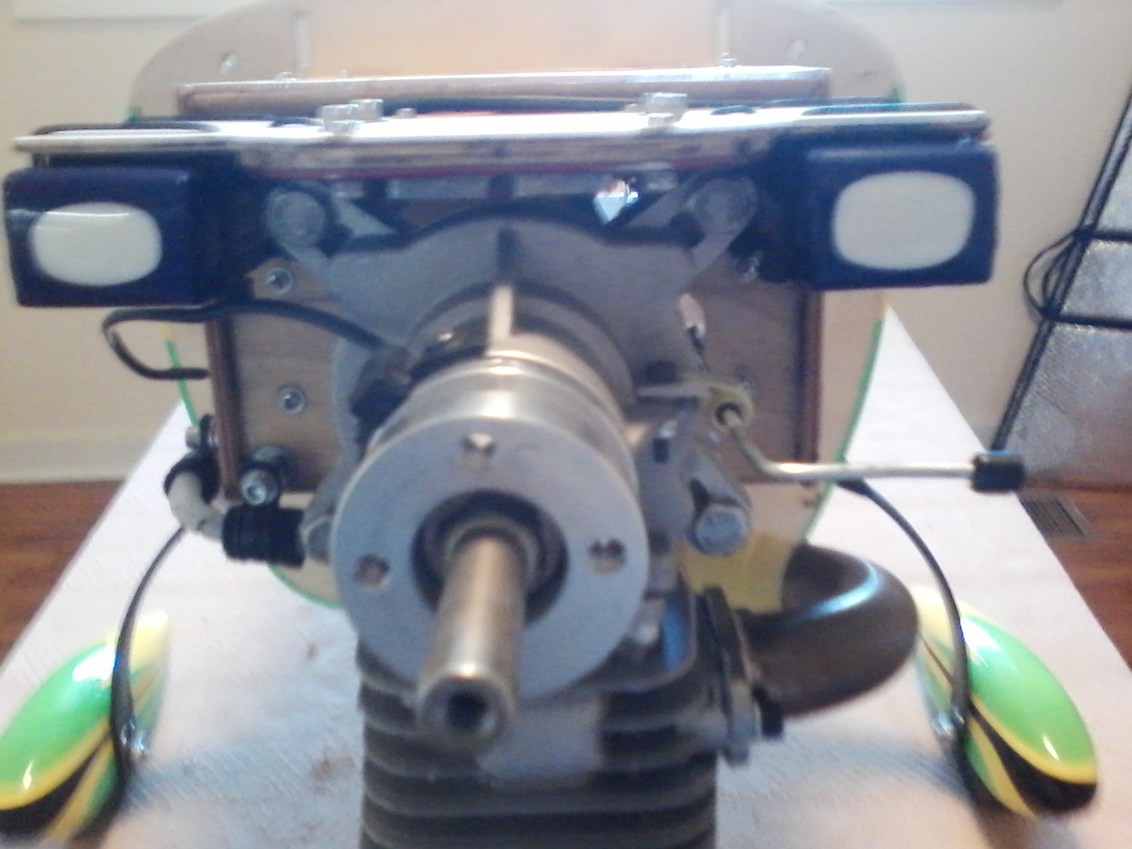

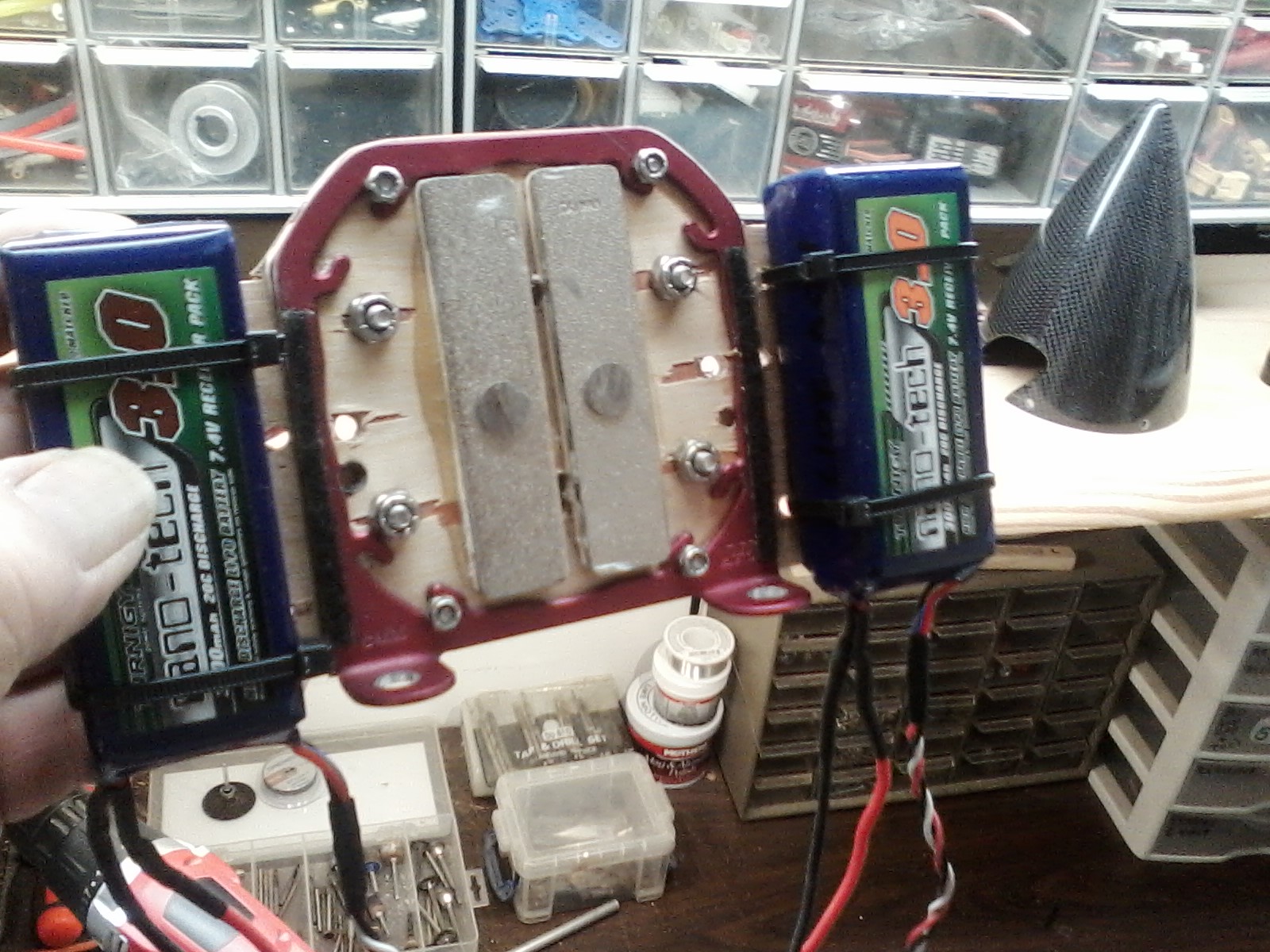

before better weather rolls in . I explained to @stangflyer why I had to go another way about getting the batt's mounted.

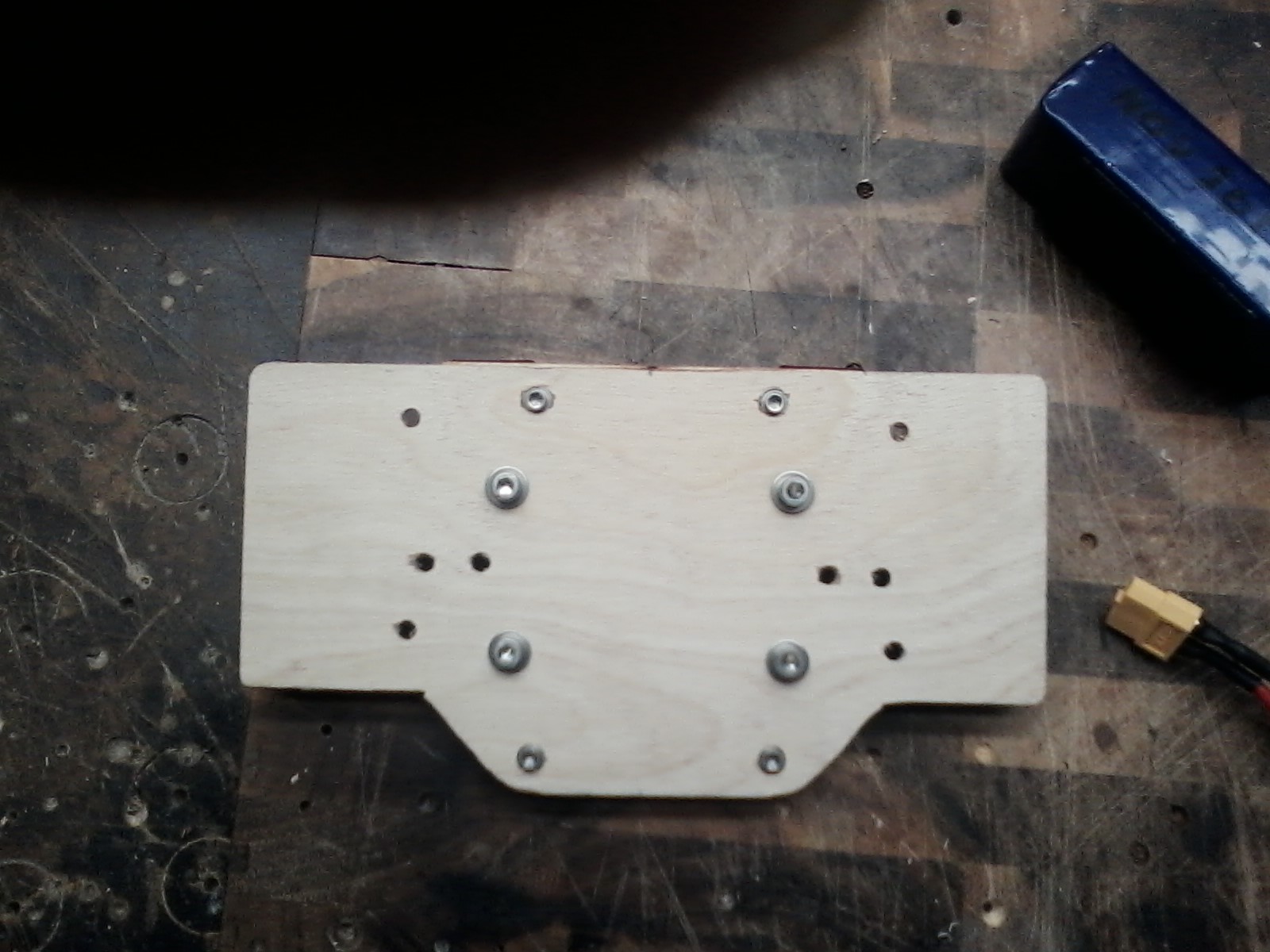

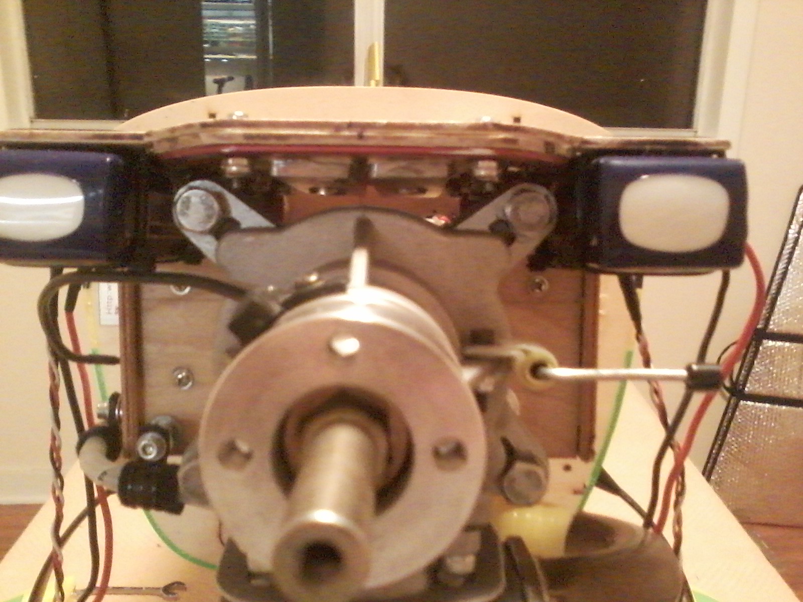

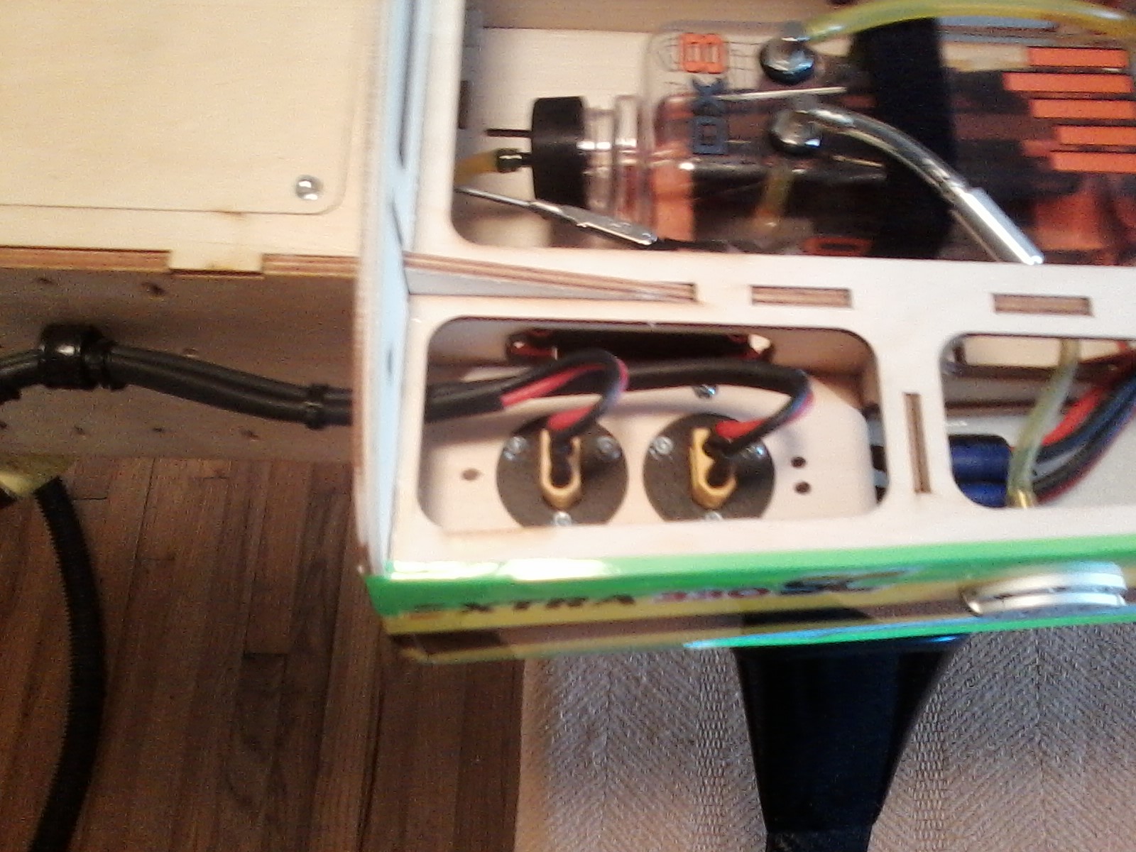

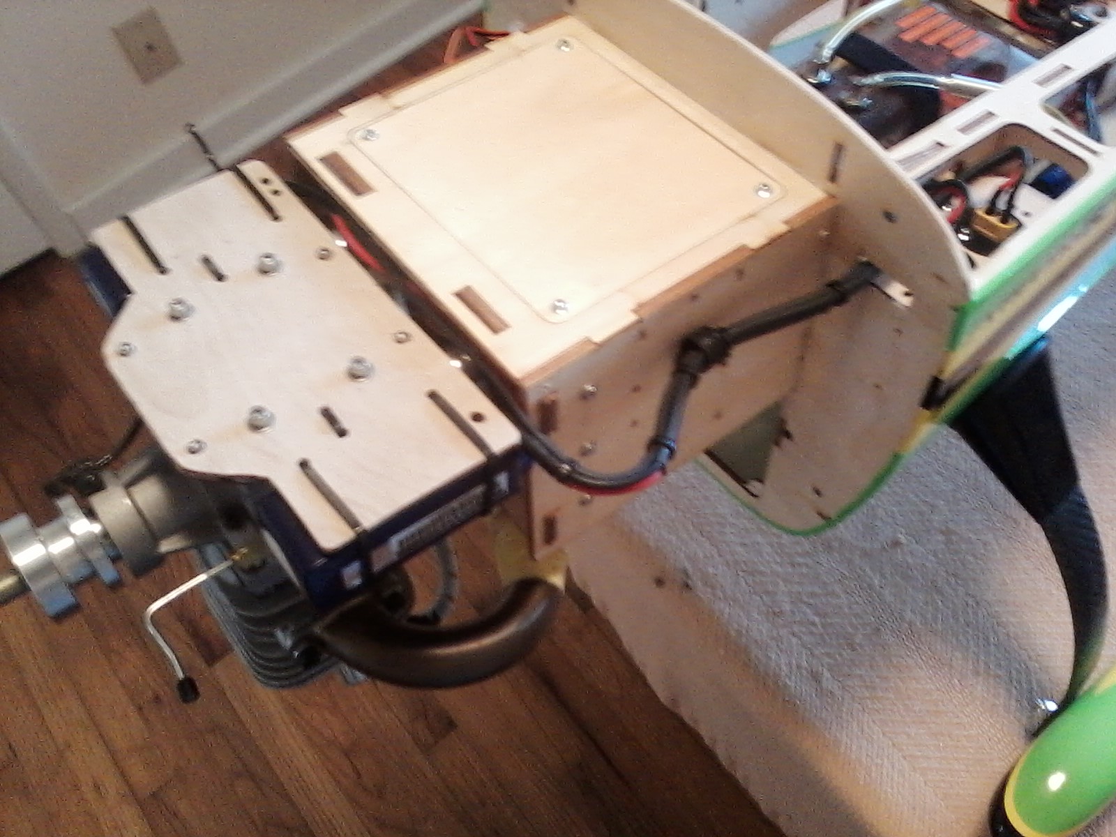

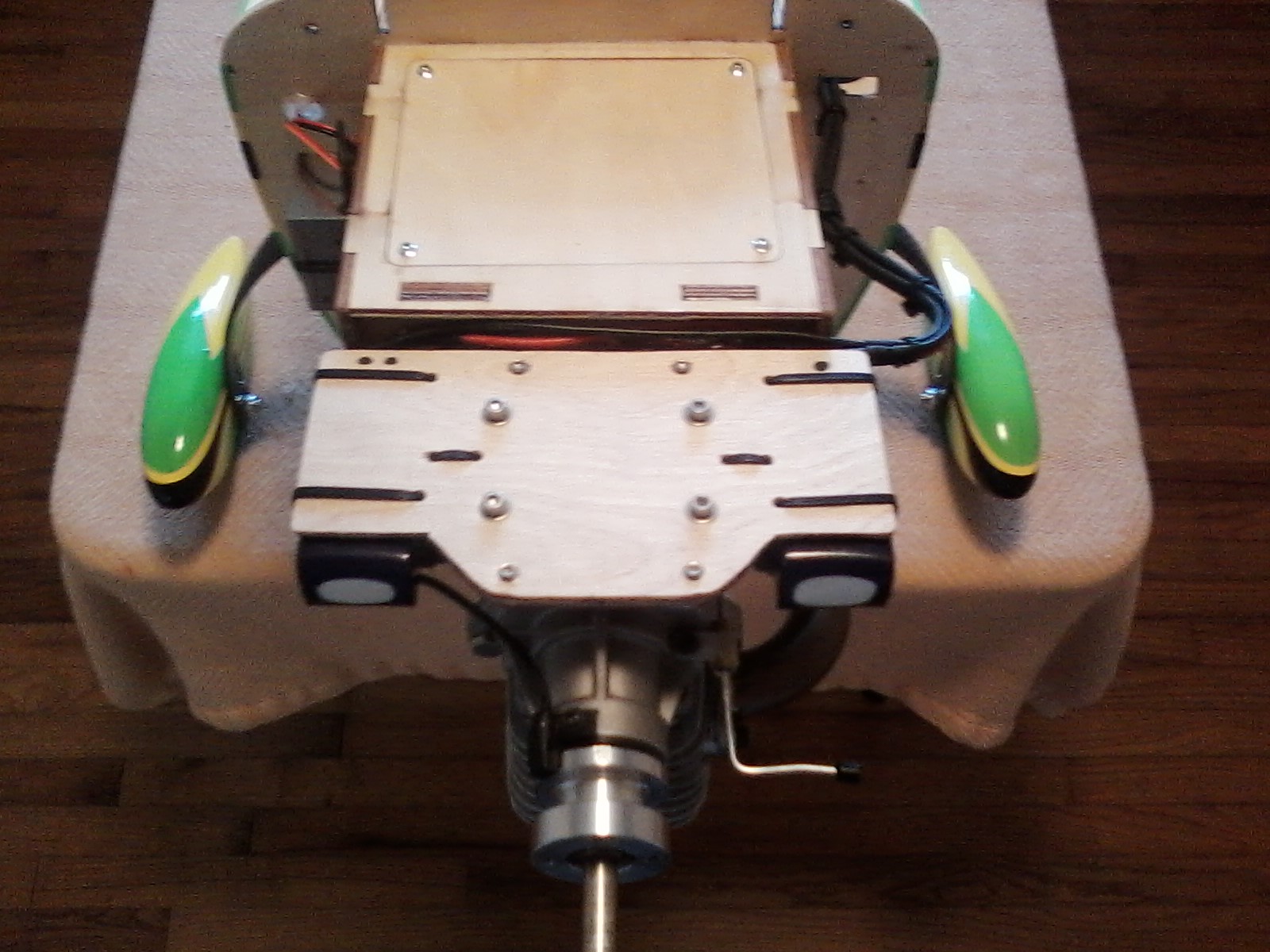

The first mount design put the batt's too high up and cowl would not fit. If I had just moved it to either side then the choke would be interfered with or the access to the carb needles interfered with. So here is the finished mount installed. The dots indicate which battery so the appropriate balance tab can be used.
View attachment 101096 View attachment 101097 View attachment 101098 View attachment 101099 View attachment 101100 View attachment 101102 View attachment 101103 View attachment 101104
