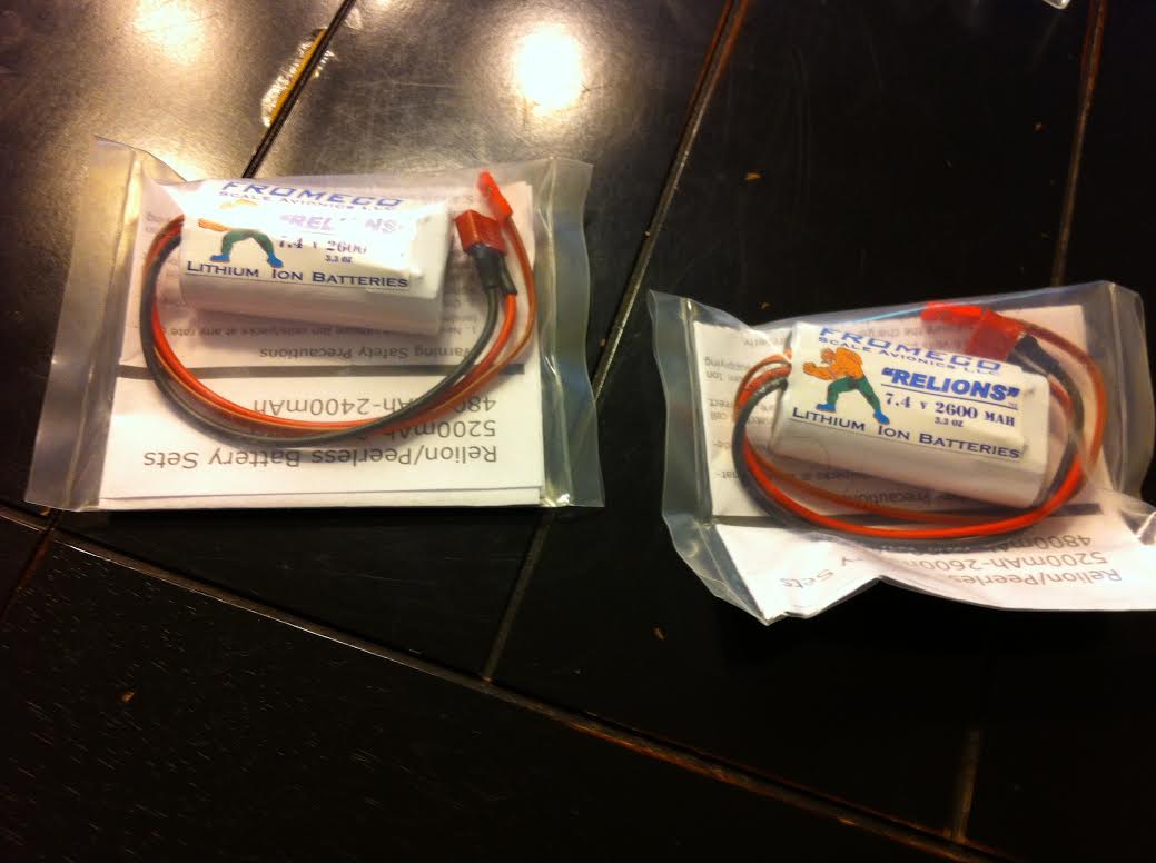

Got some batts in today thanks to Fromeco! Relions 7.4 2600's :)

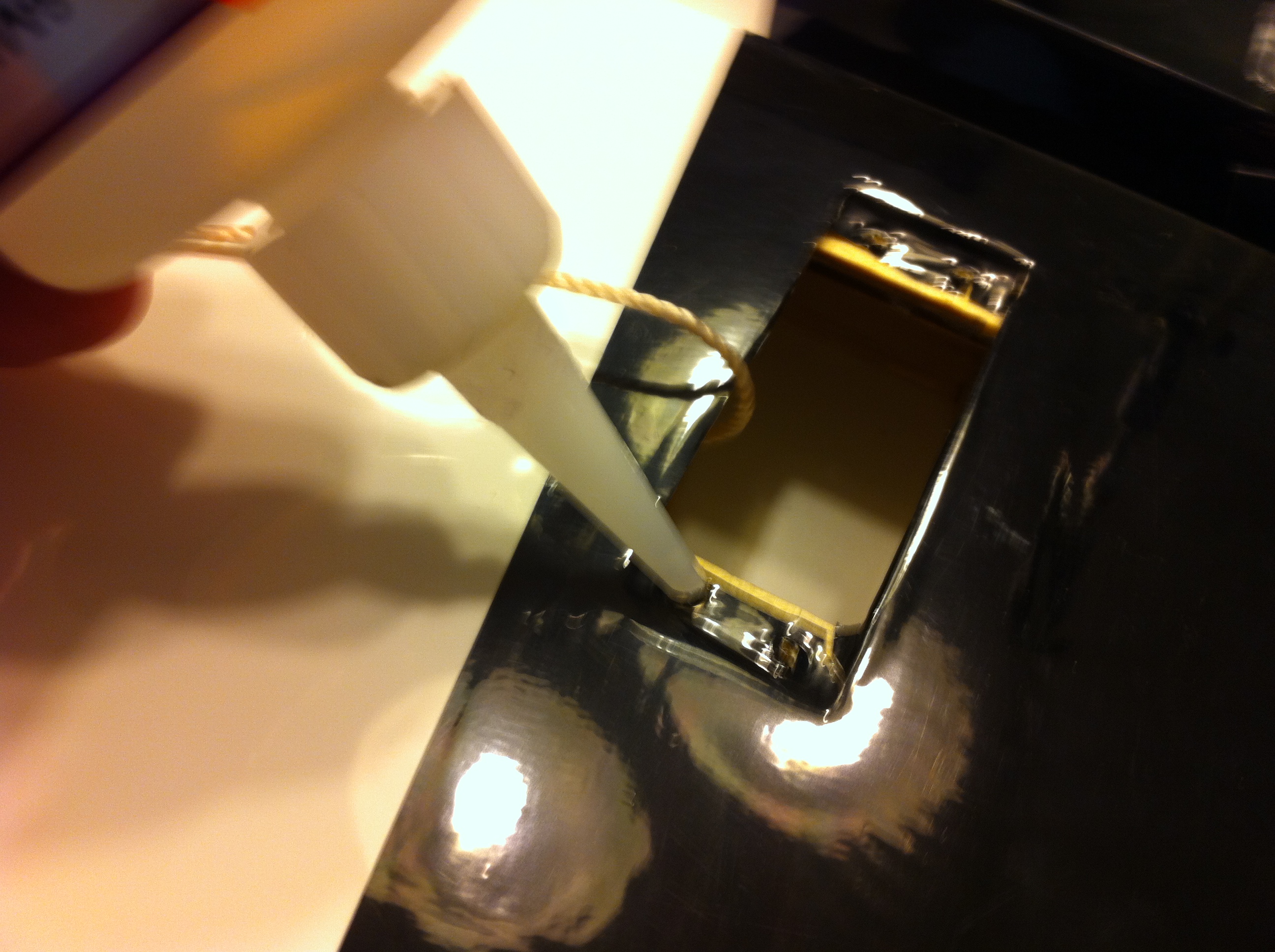

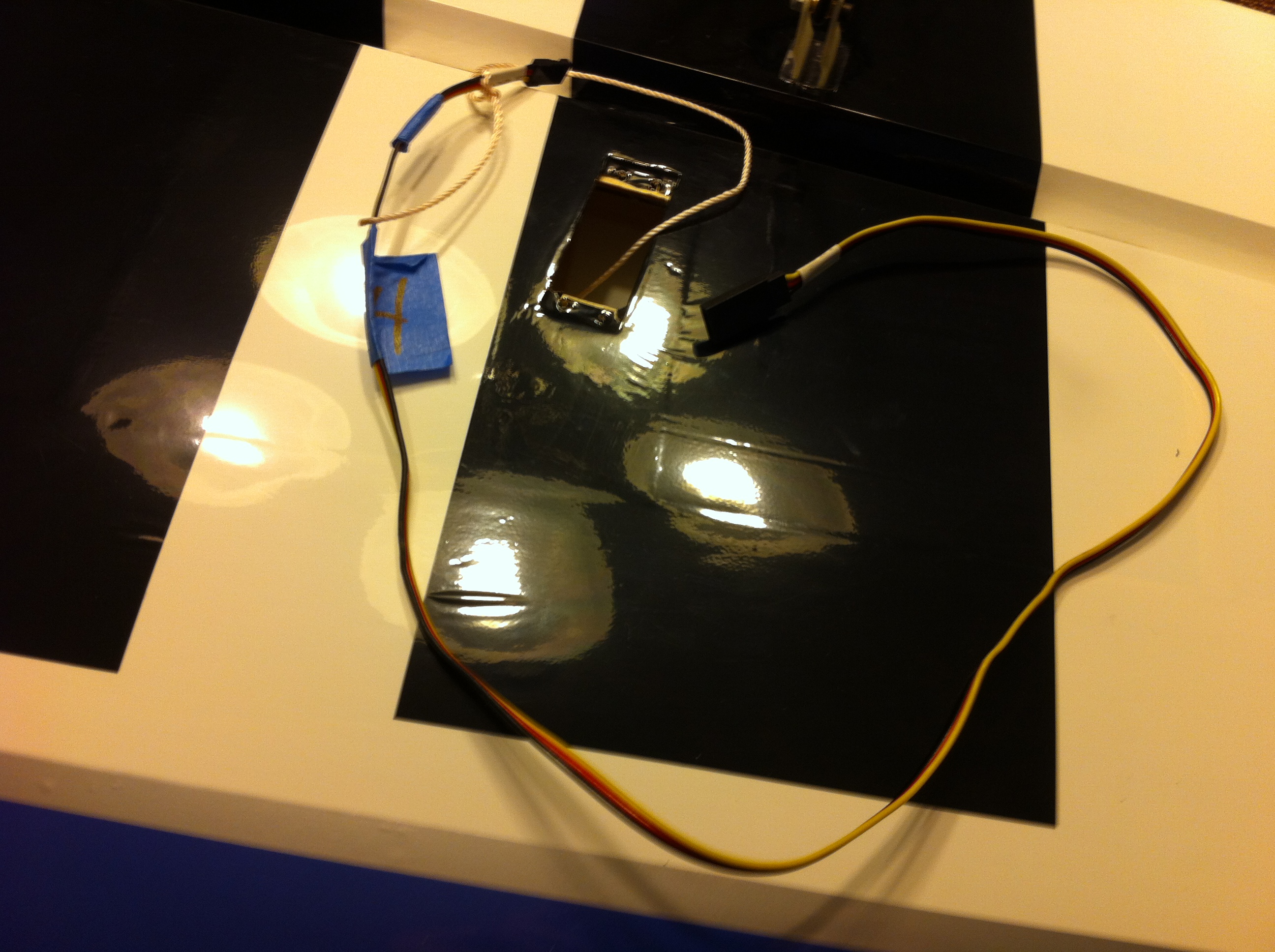

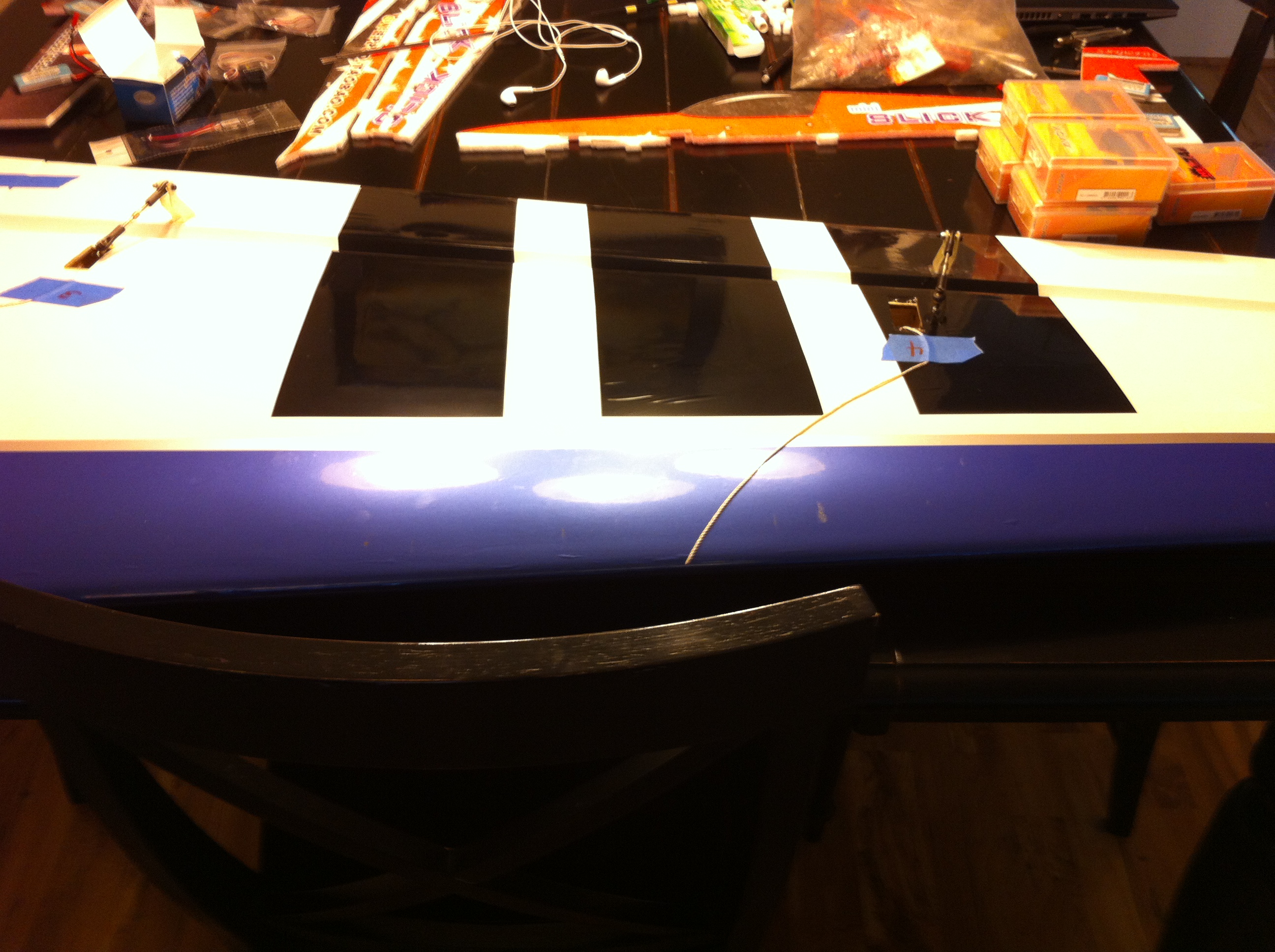

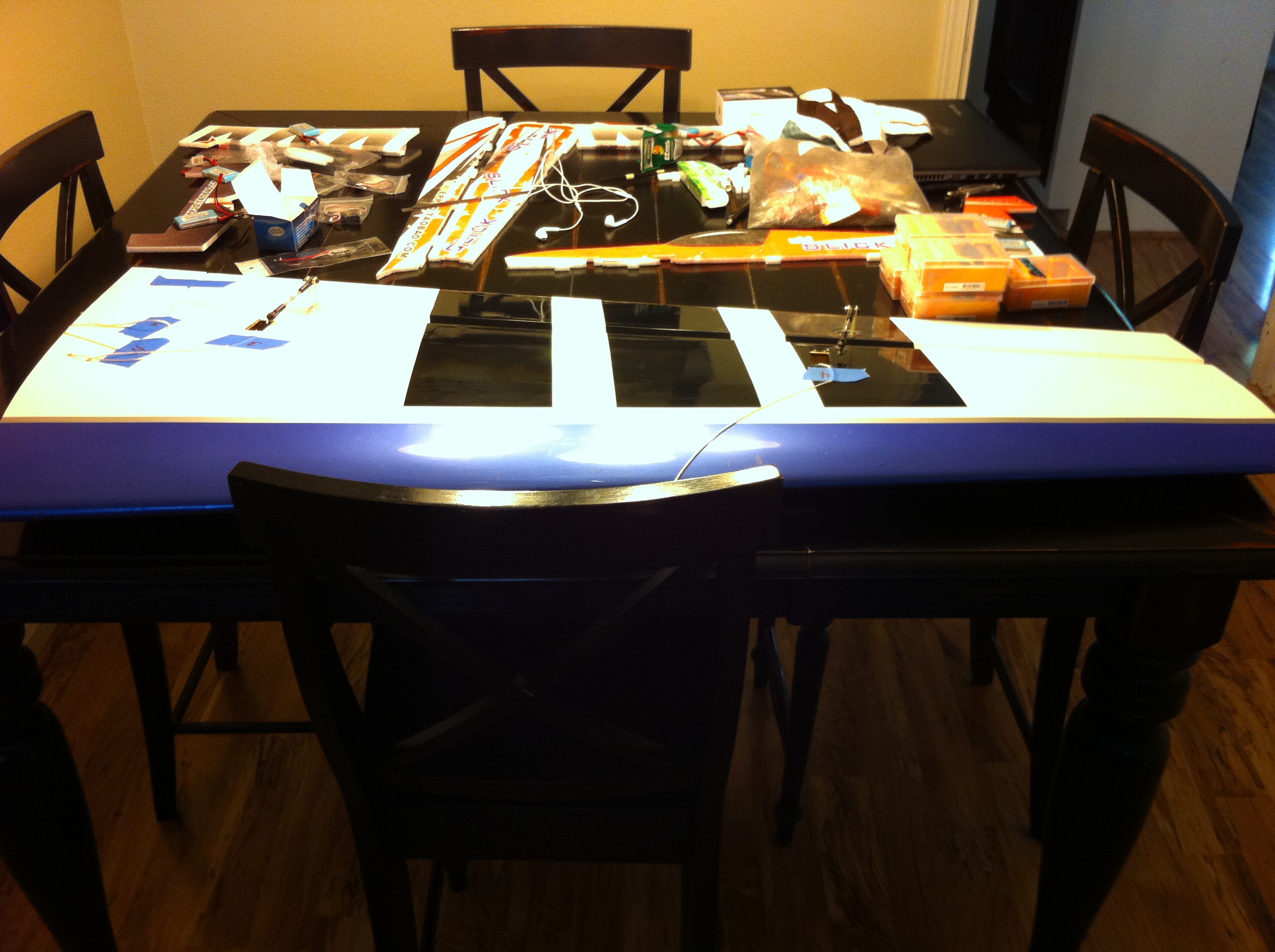

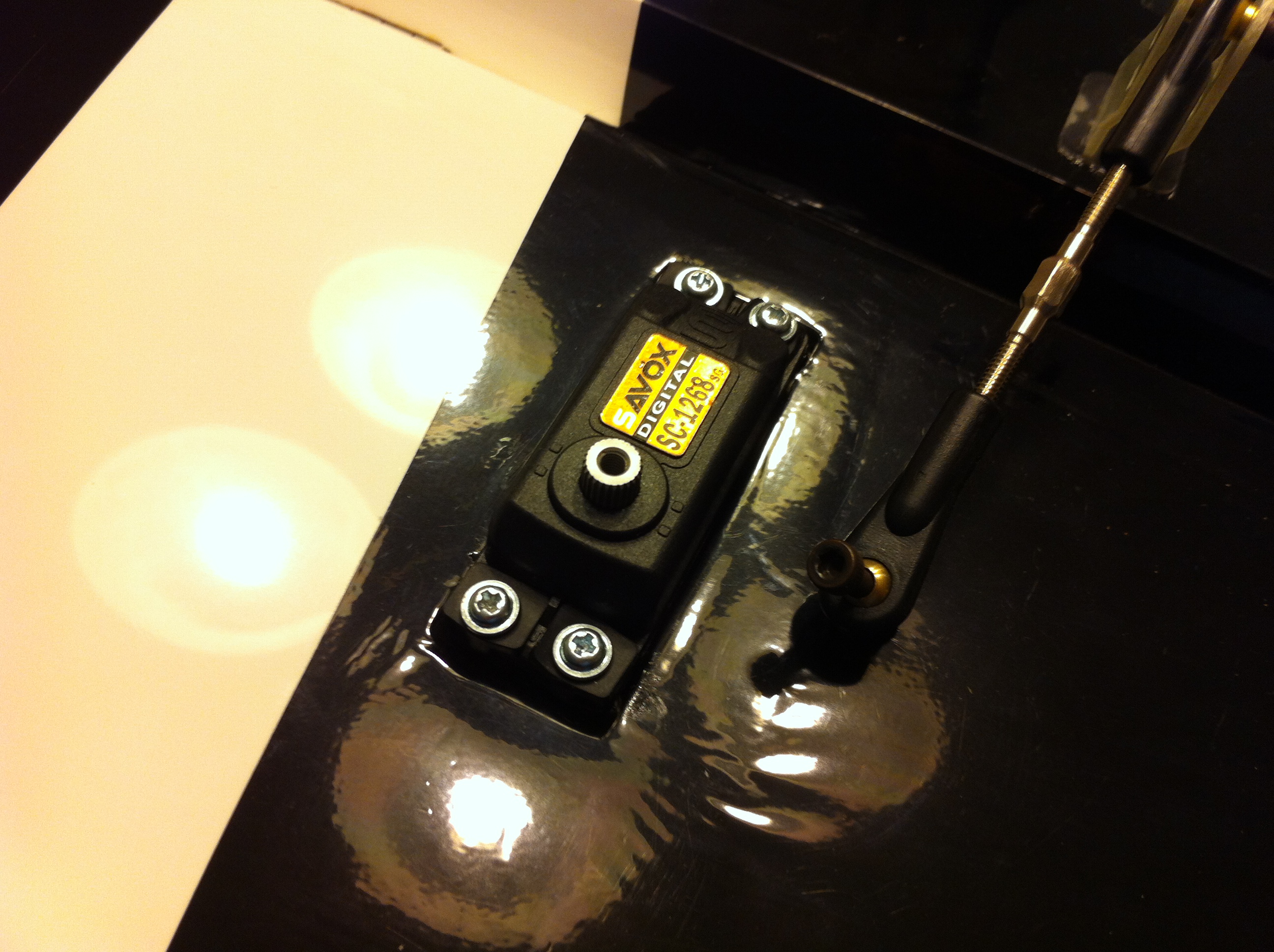

Here are some pics of the Savox servos making their way into the ailerons!
I usually put a dab of CA since this is NOT a new servo hole. They went in nice and tight!
Coming along nicely!

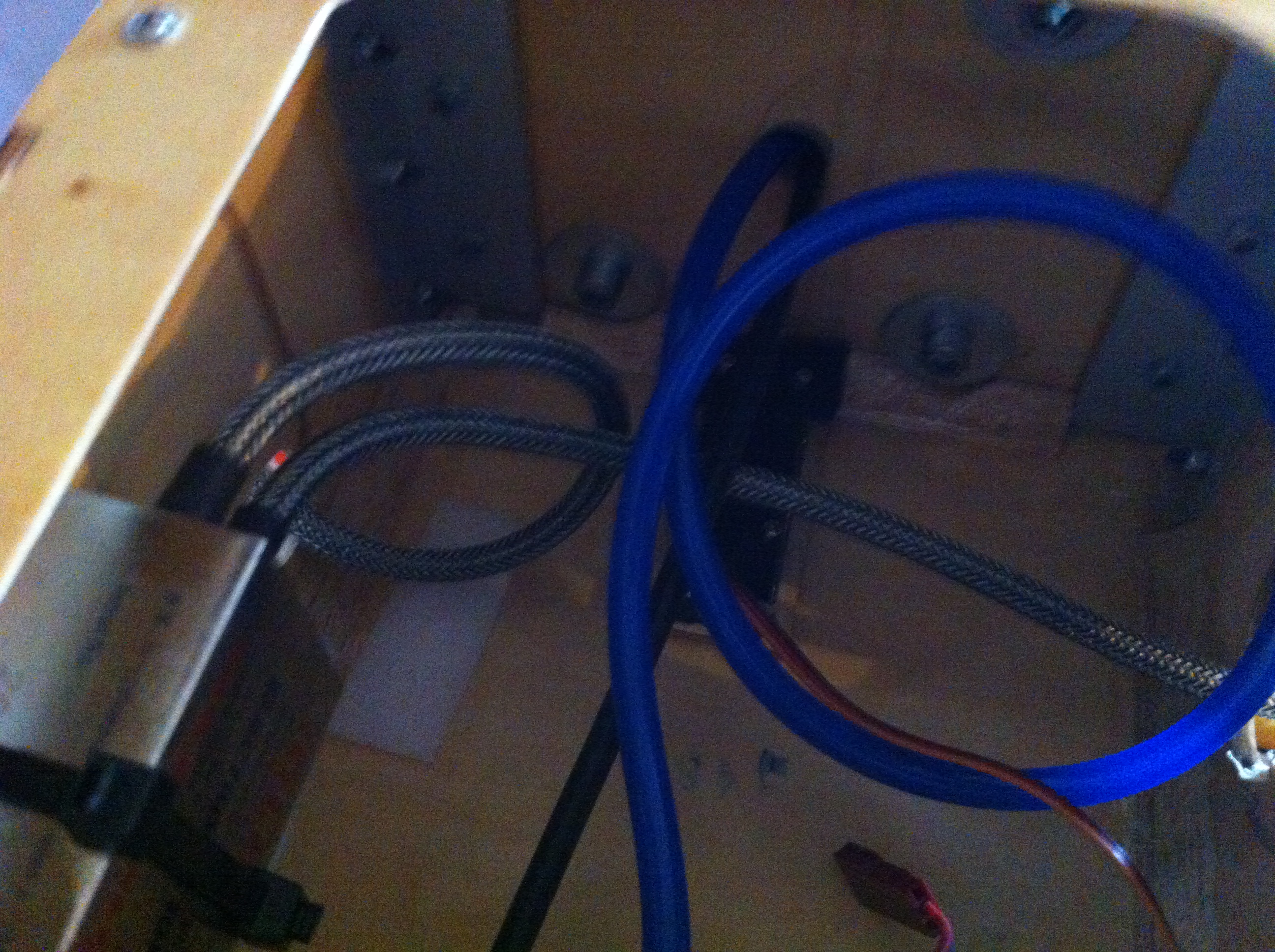

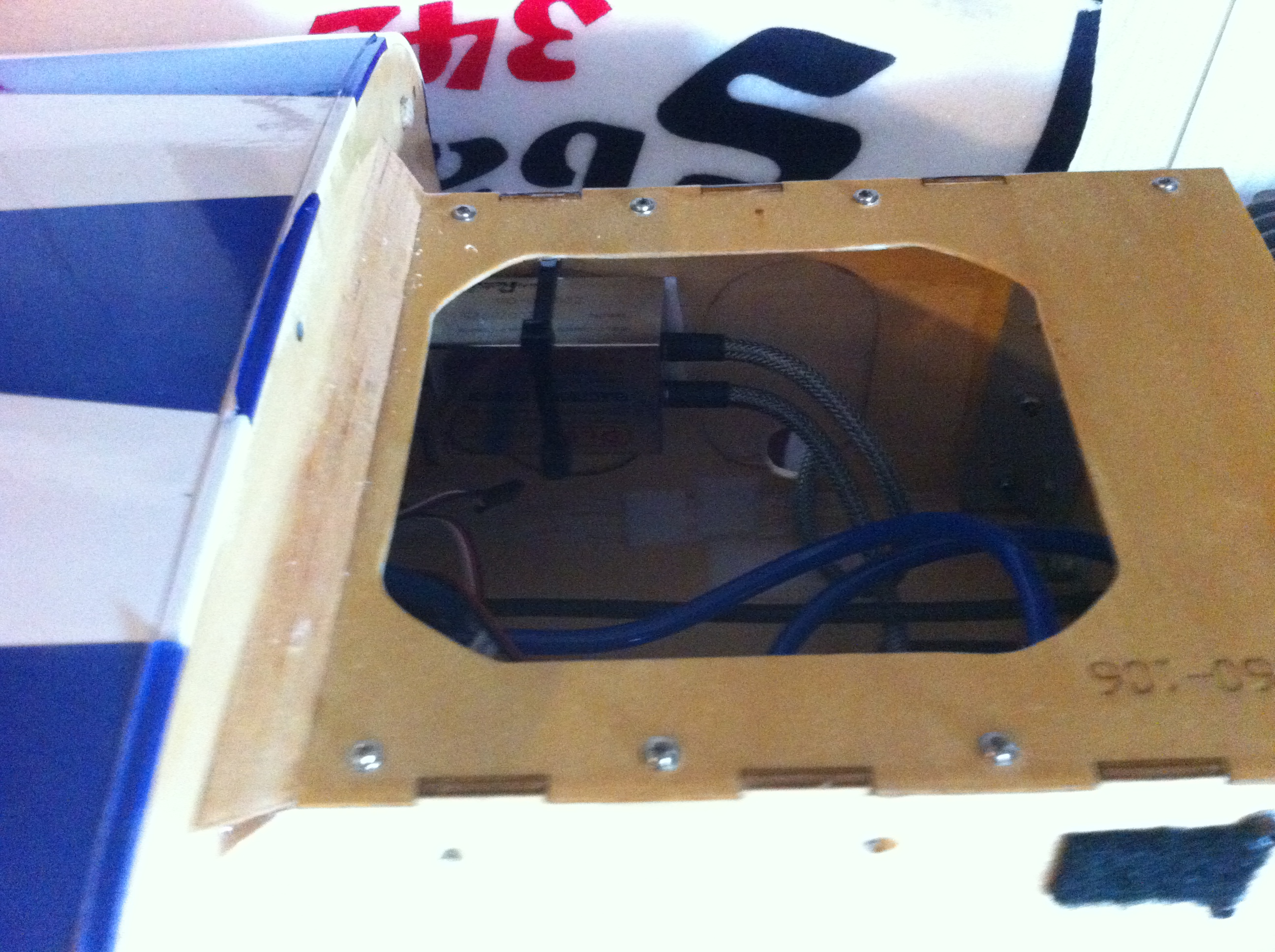

Got some work done on the Extra this week end.
Programmed the smartfly eq6 which was super easy. Smart fly has done a great job with the user interface.
Made my power wires and protected them. Used the spiral plastic on some additional areas like the elevator servo wires. Mounted my ignition and routed the spark plug wires through the motor mount. Mounted the Biela prop. I will have more pics later.
3dmike

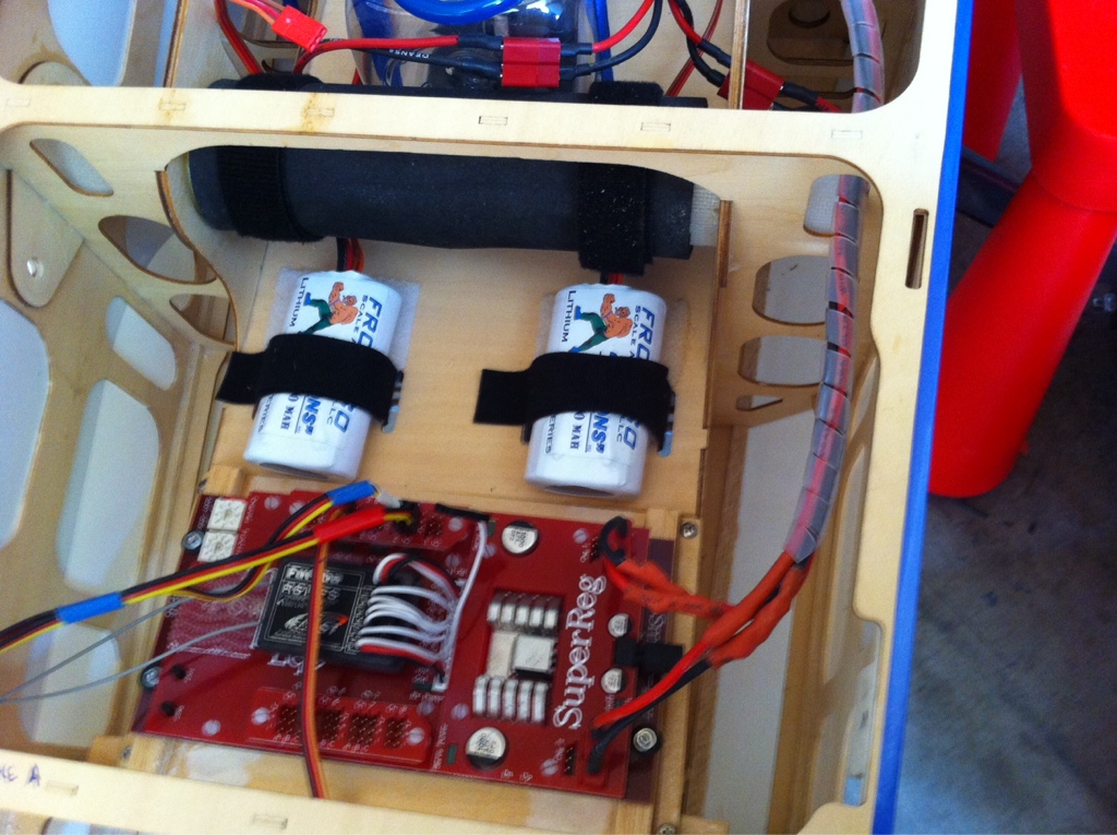

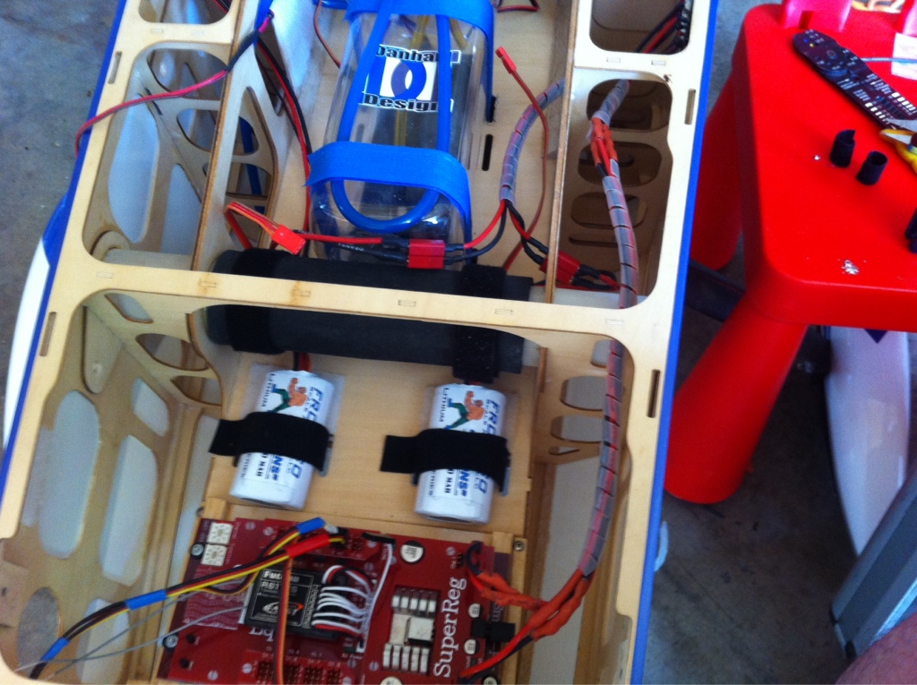

Here are some more pics of my progress!

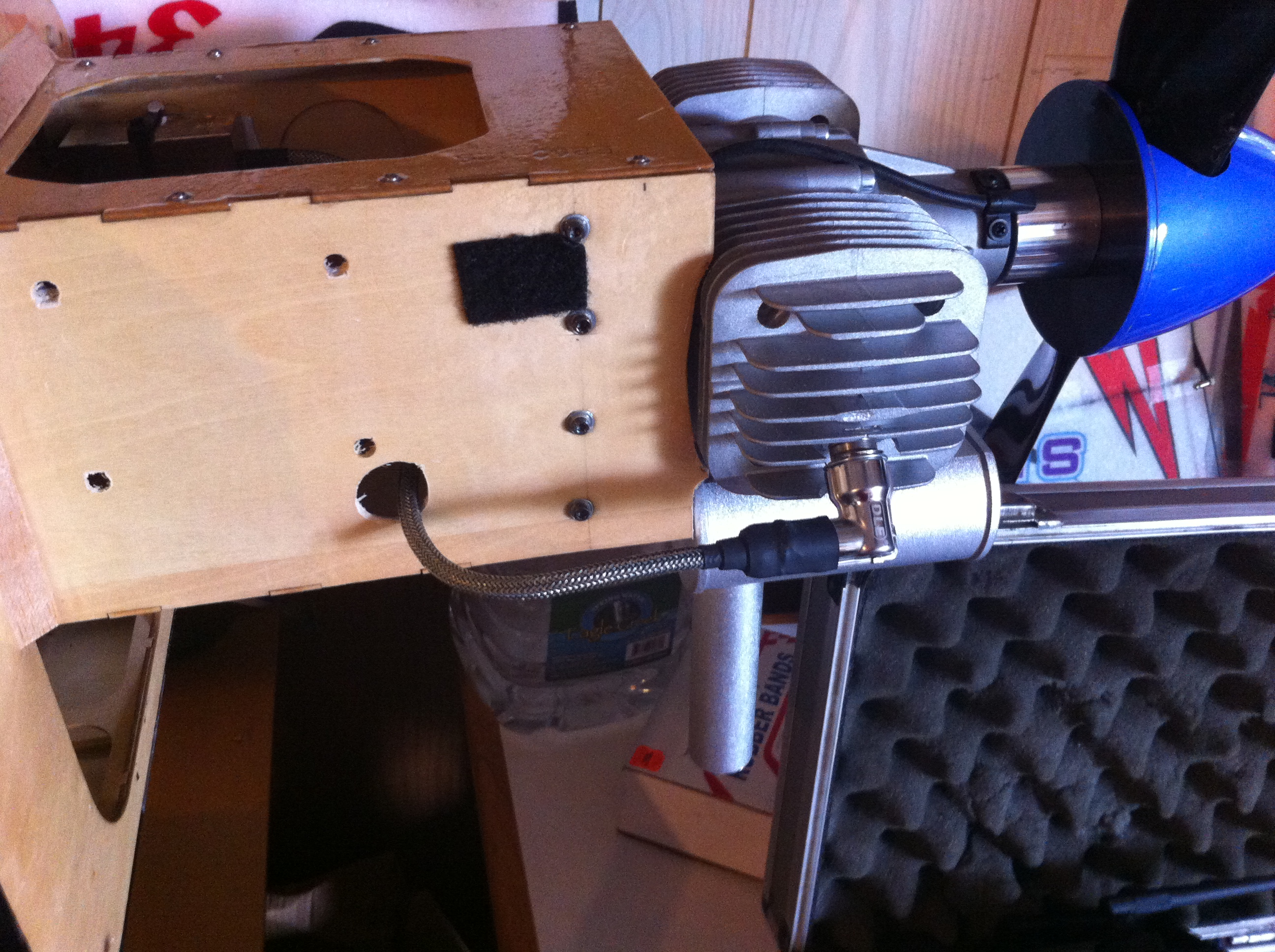

Mounted ignition in the motor box.
I will be getting some rubber grommets for the newly drilled out holes for spark plug wires.
