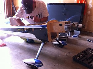

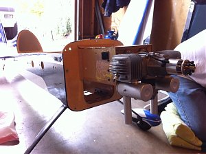

Made some progress yesterday and today:
Mounted servos, engine and power board yesterday/today
Had to drill hole for the exhaust since [MENTION=2649]GOGO24[/MENTION] used the pro flow cans.
ImageUploadedByTapatalk1398544331.746428.jpgImageUploadedByTapatalk1398549402.510472.jpgImageUploadedByTapatalk1398609530.724996.jpg
I will get some better pics soon. Since I don't have a work bench that i can pull the middle of the garage my back is killing me!
