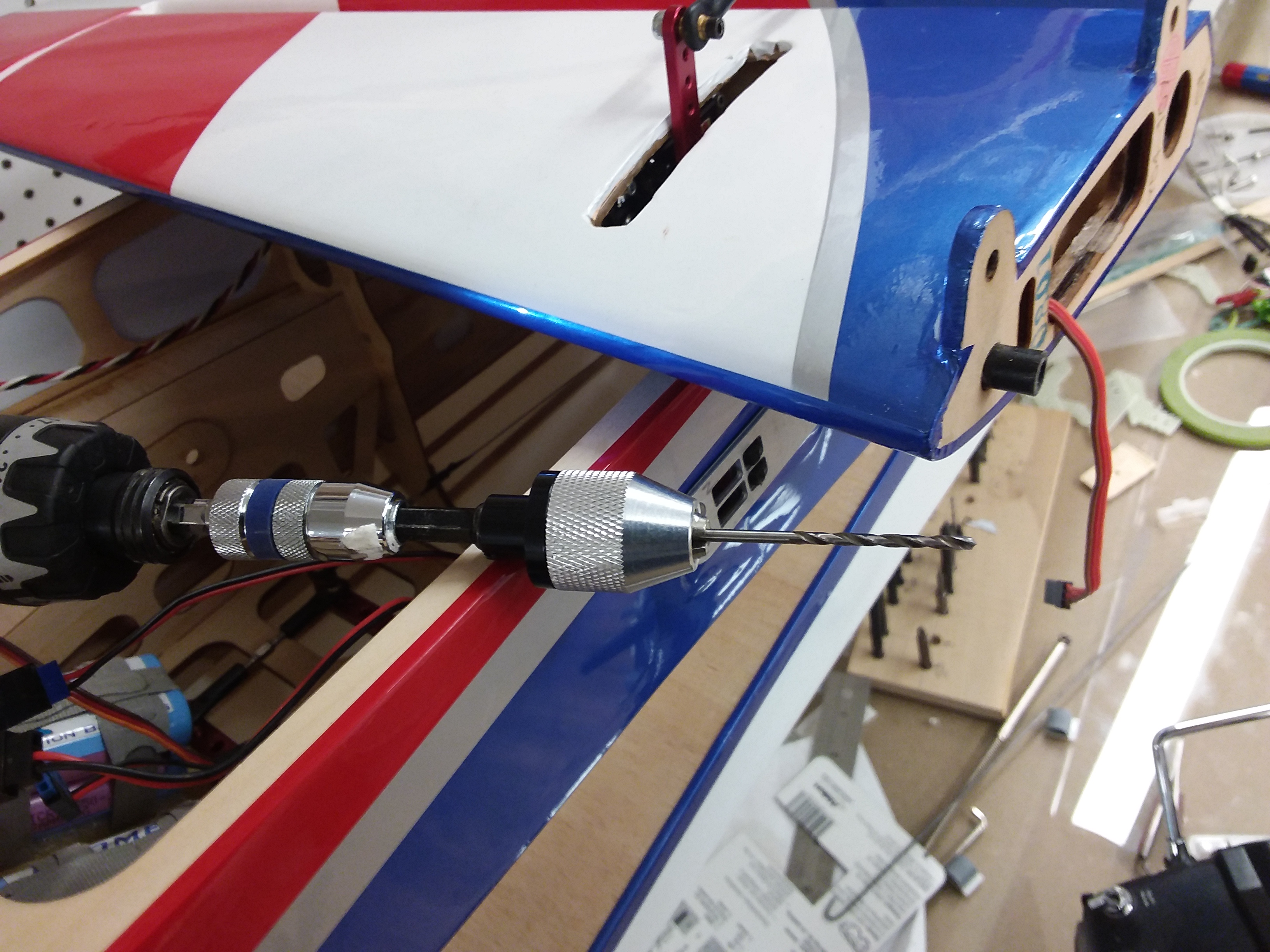

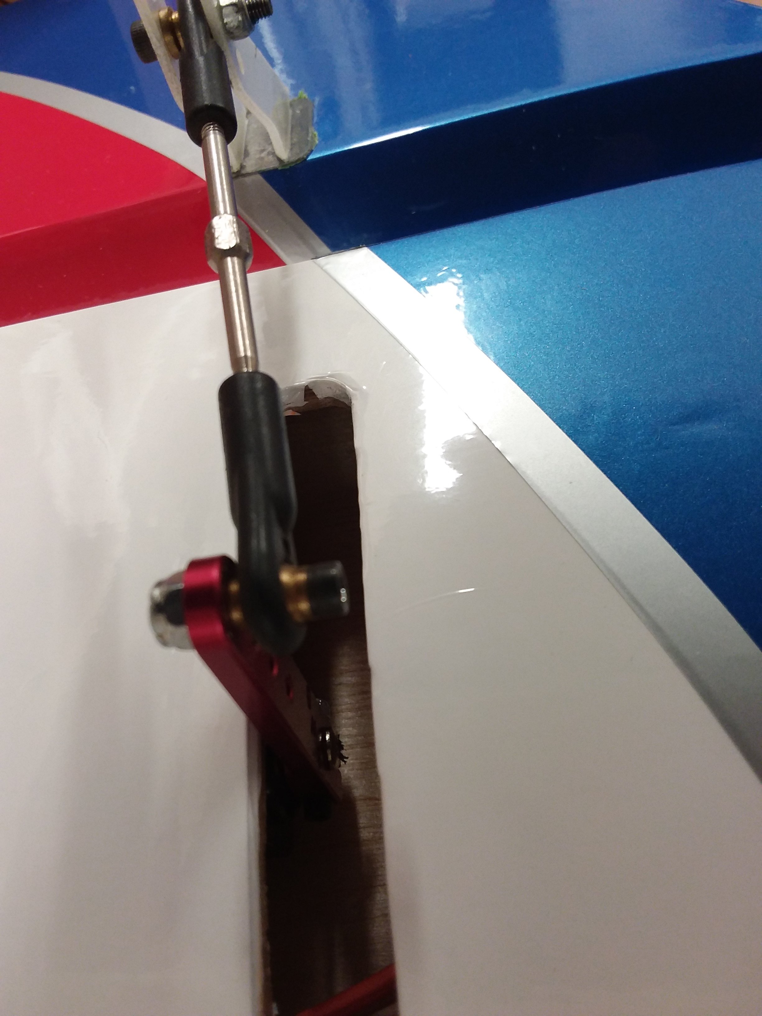

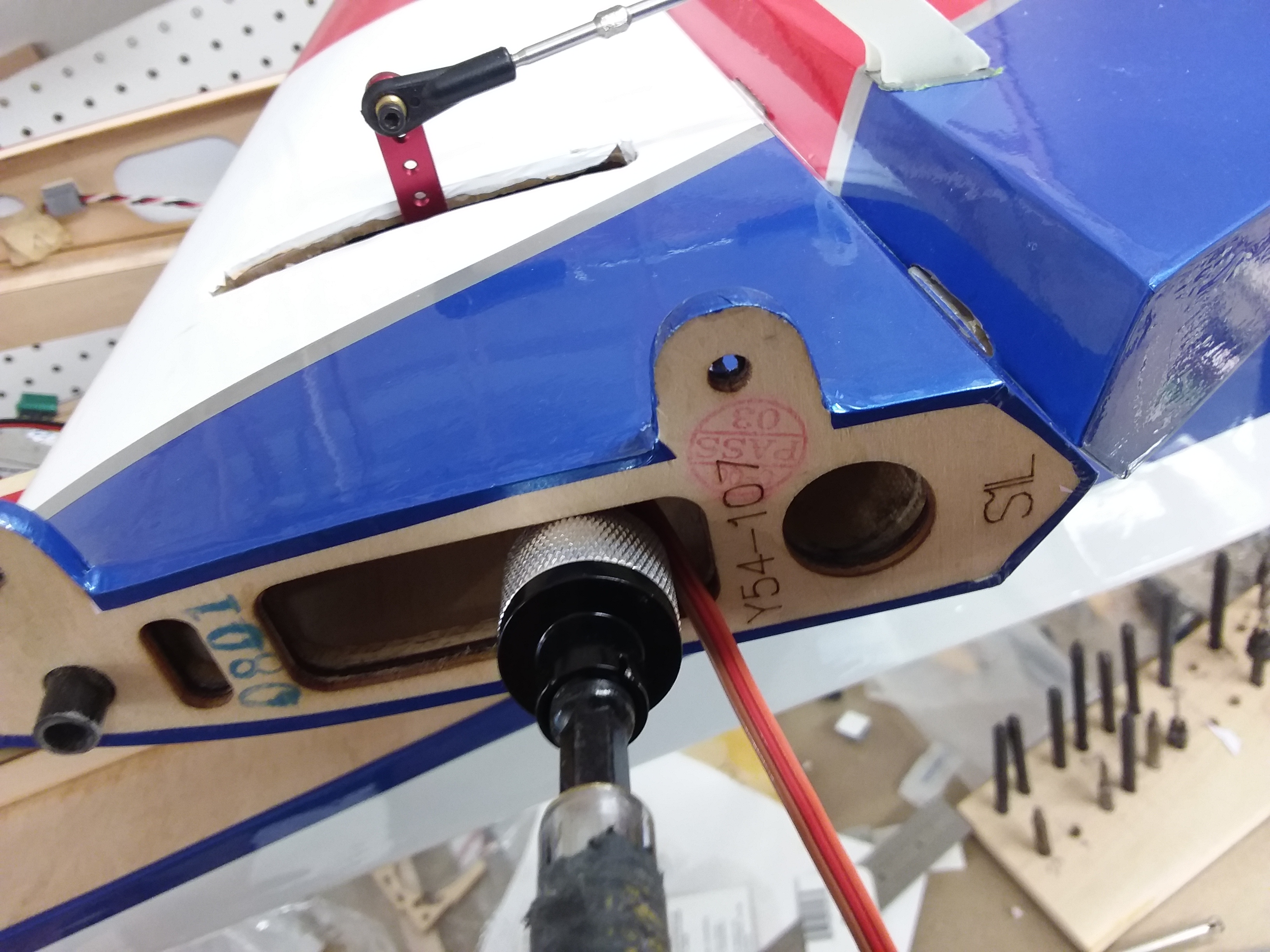

Needed to adjust elevator servo arms recently and tried to reach the OEM Phillips head screws via long screwdriver. Not. Stripped soft screw deep in the elevator. Ordered a mini ease out kit and a mini adjustable drill chuck and went to work.

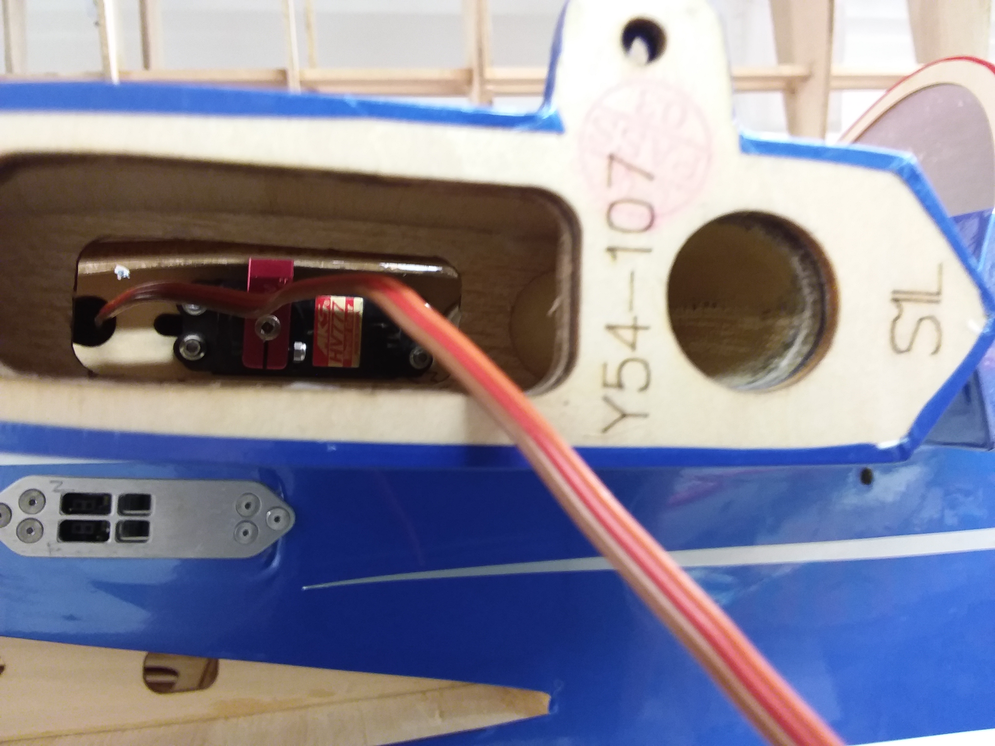

Why I had Philips head screws in there I don't know....... Hard to see but there's an ugly Philips head screw in there.
