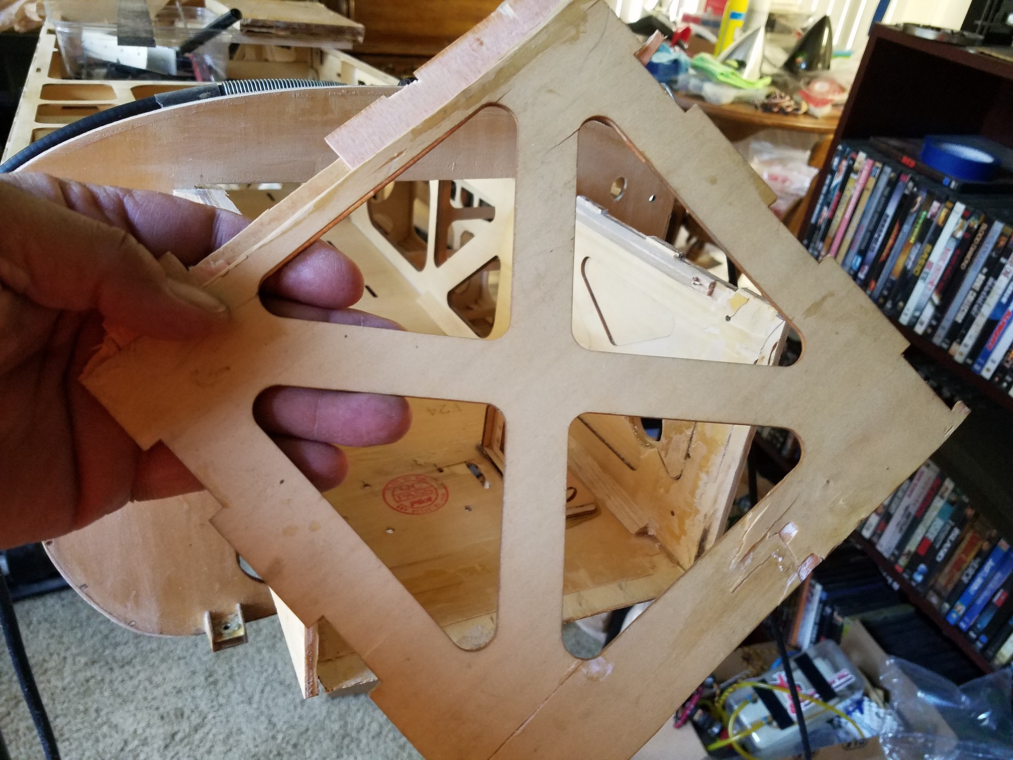

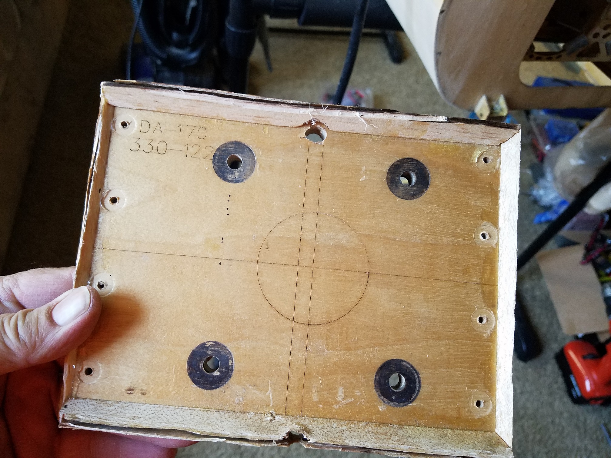

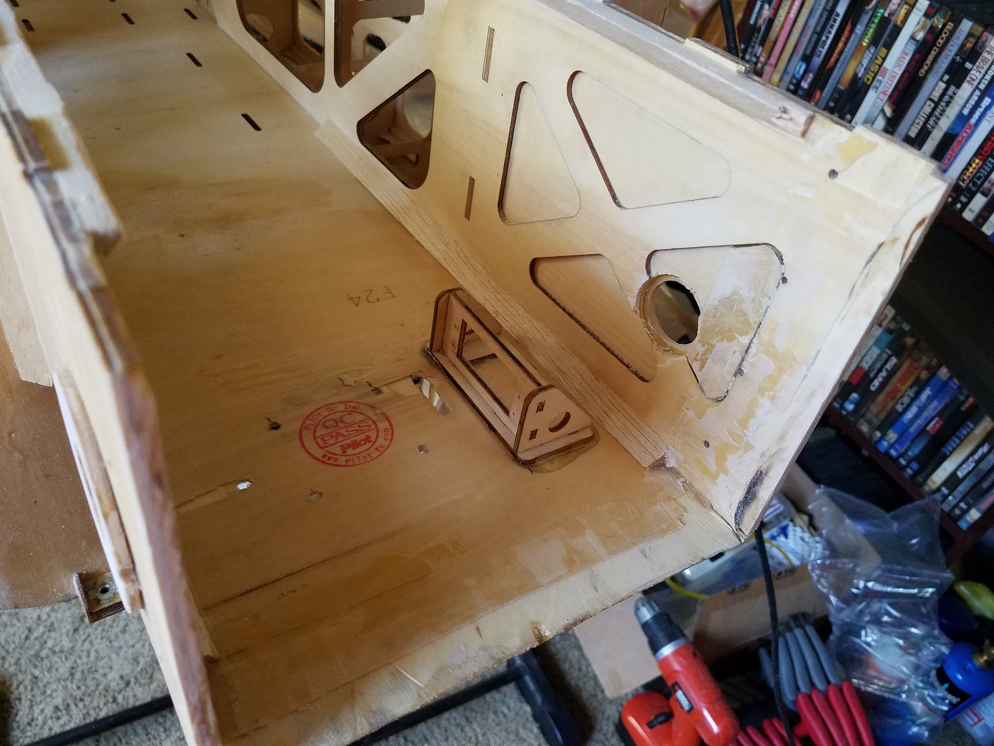

As promised... a little bit of an update. The covering has arrived. And I am so jacked and ready to start covering this beast. But first, I need to take care of that totally illegitimately installed firewall. I just will not do the 3.5 degrees right thrust and 2 degrees down thrust. I cut the firewall free from the motor box and now I will build a new firewall... set the proper angles and reattach the new firewall. I do also need to build a new top motor box cover. As I destroyed the original by removing the firewall. Oh well, if you're going to do something....do it right. Right???? LOL

What are the new thrust angles going to be?
As per Tony, the down thrust will be "0" degrees and the right thrust will be 1.5-2.0. (I am probably going to stick pretty darn tight on the 1.5 degrees right thrust) The original owner of this airframe had it set up for literally IMAC only flying. The first dead give away was the 1/8" wafer at the top between the front former and the cowl ring. Setting the cowl in a down slant. I knew right off the thrust angles were going to be so wrong for what I wanted the plane to do. So back to the original as it comes from the factory.:way_to_go:

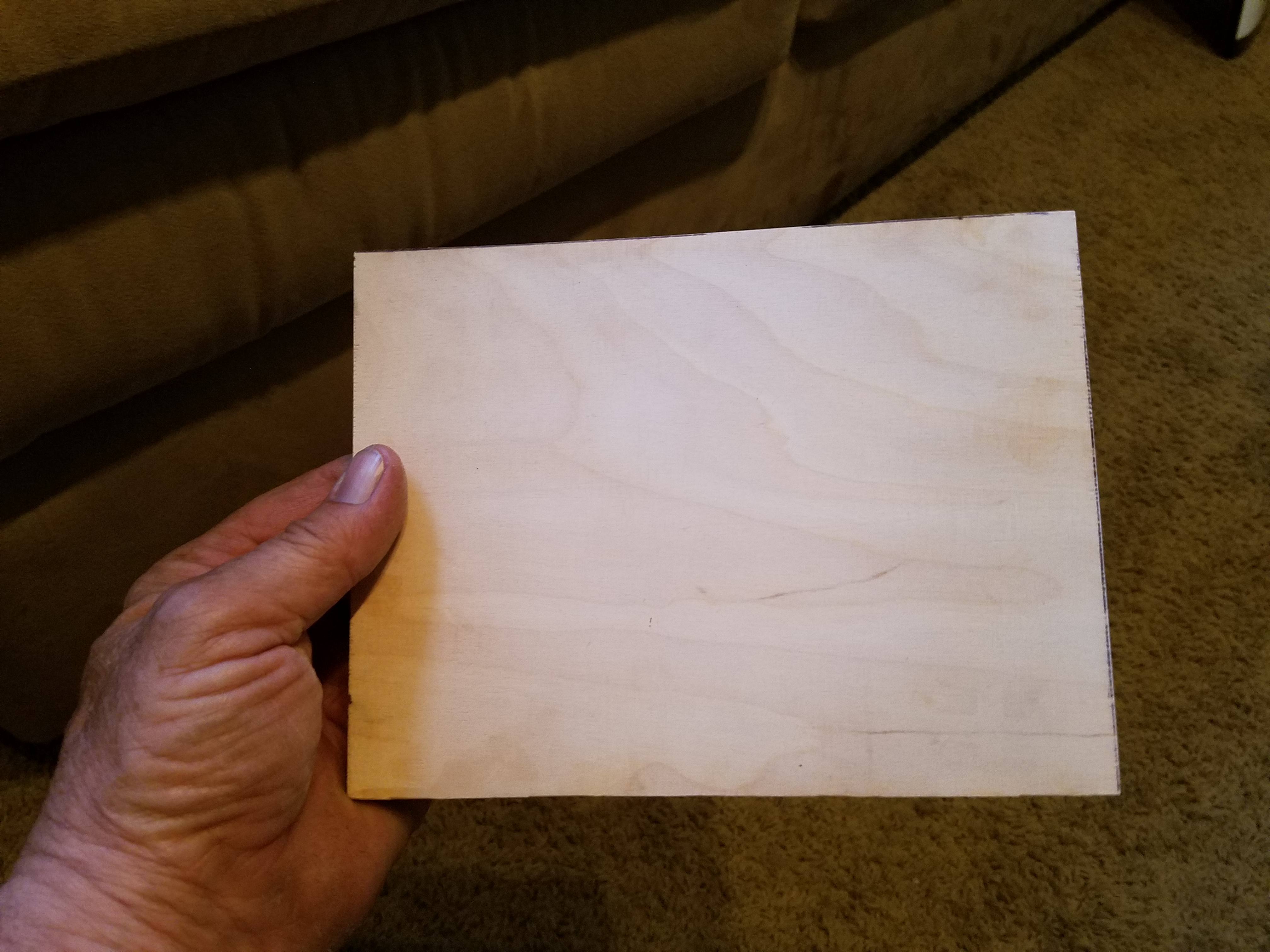

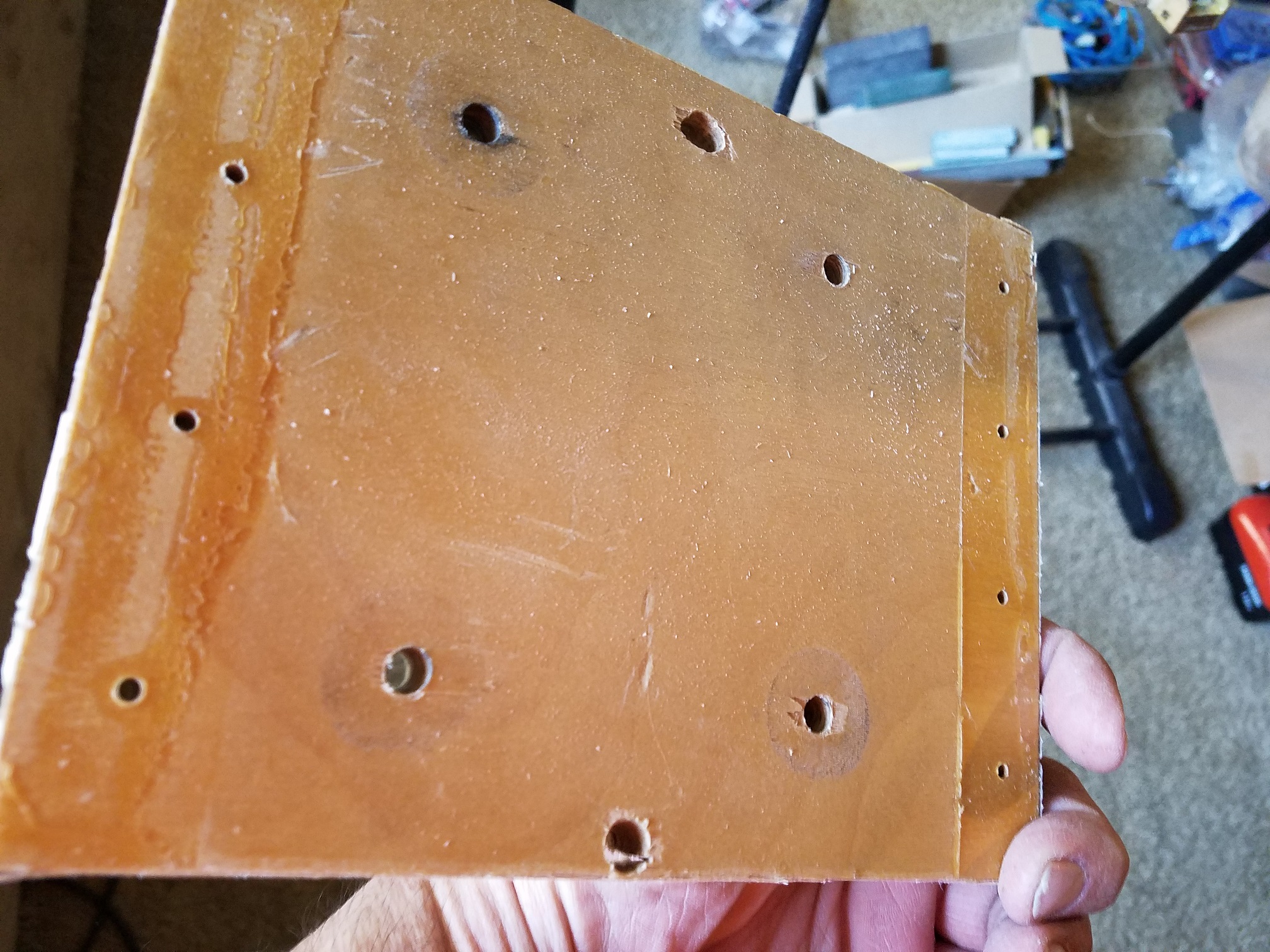

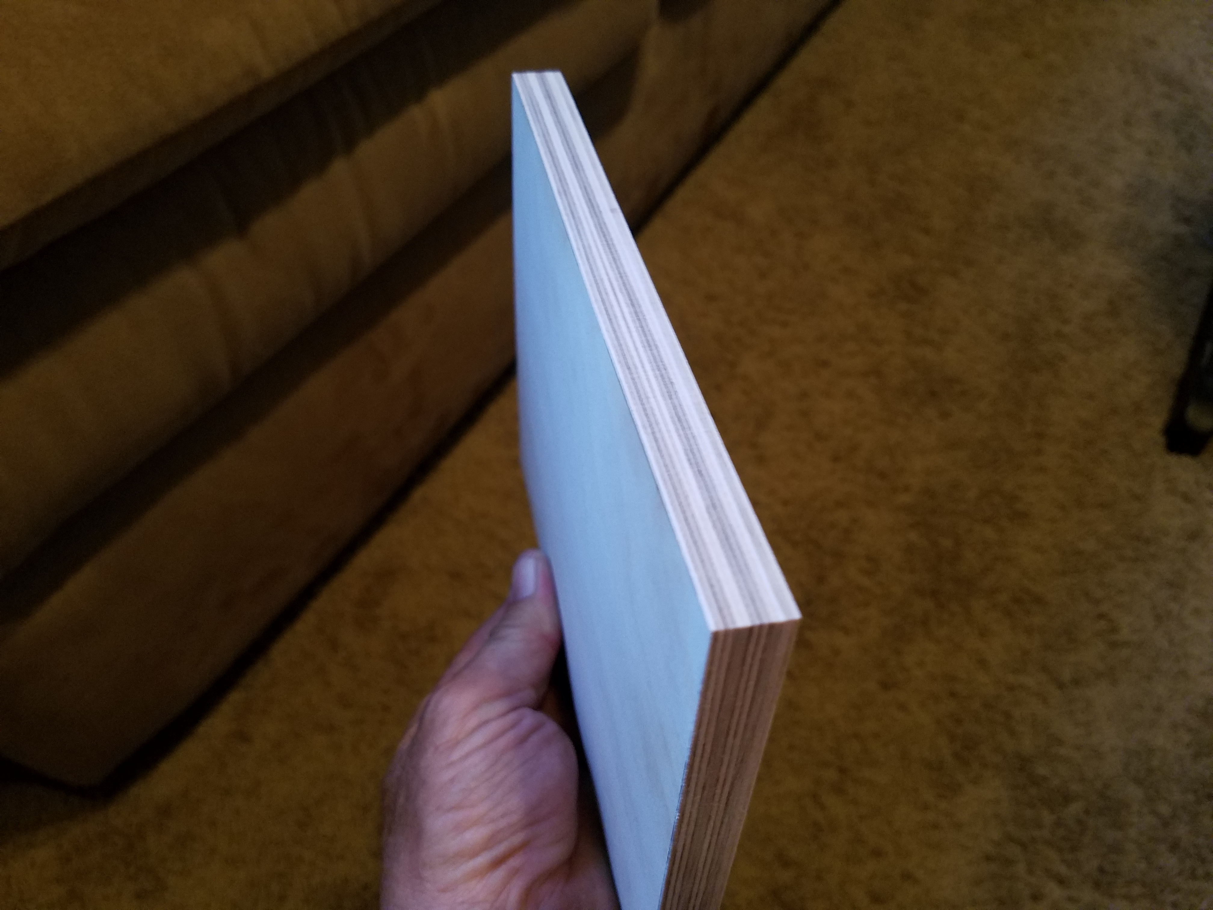

Thanks to my awesome son @Shayne Epley and all his really cool shop toys, I now have a brand new double laminated firewall for the 330. Two 3/16" and one 1/8" backer for a total overall (+) 1/2" thick firewall. Pretty sure this will be more than strong enough to support that beast 157cs yankin' on it.

I would hope so, I have a 170 on an 1/4" wall.
