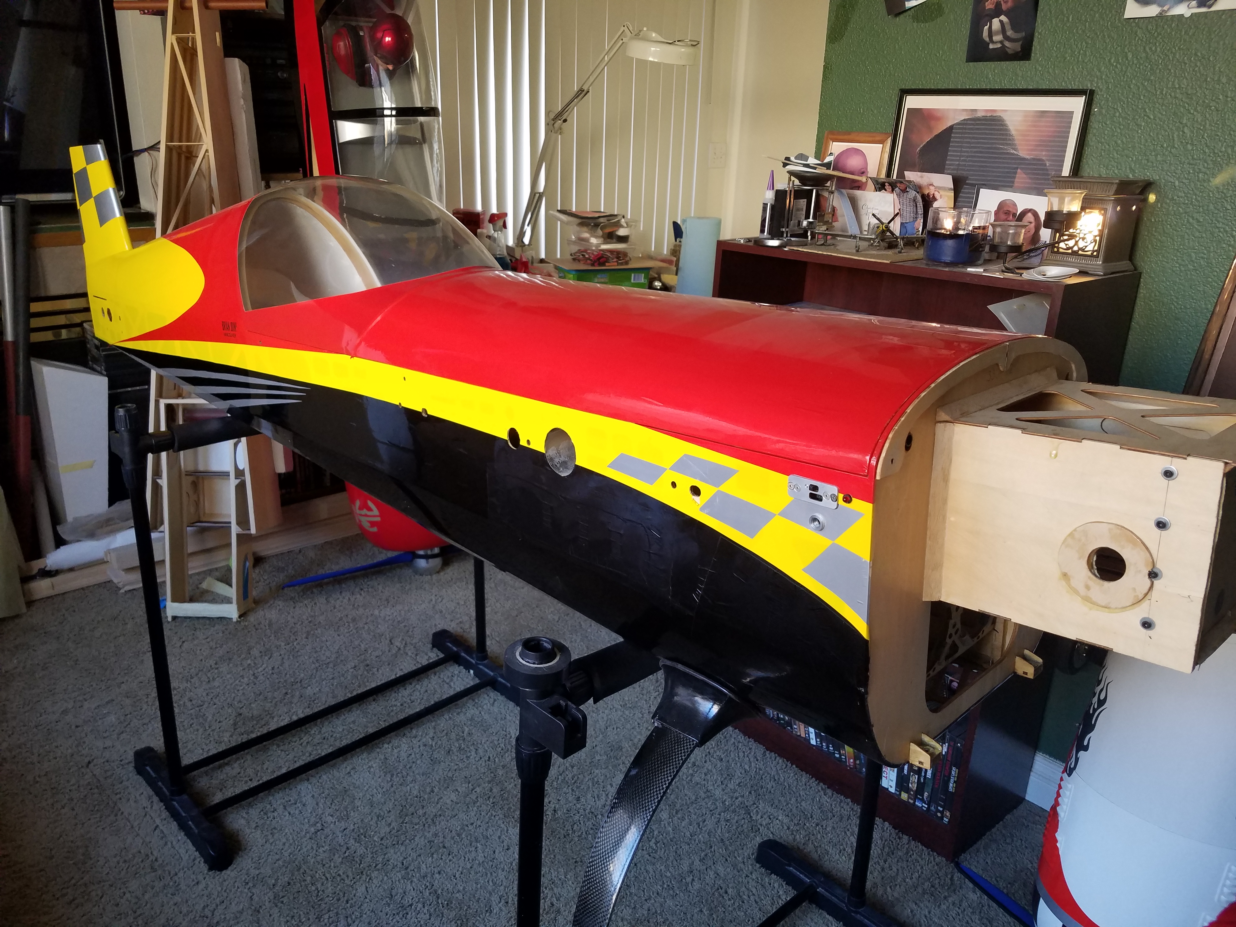

Sweet....with her belly vents and main gear removed, we can now cominse to removing the original covering.

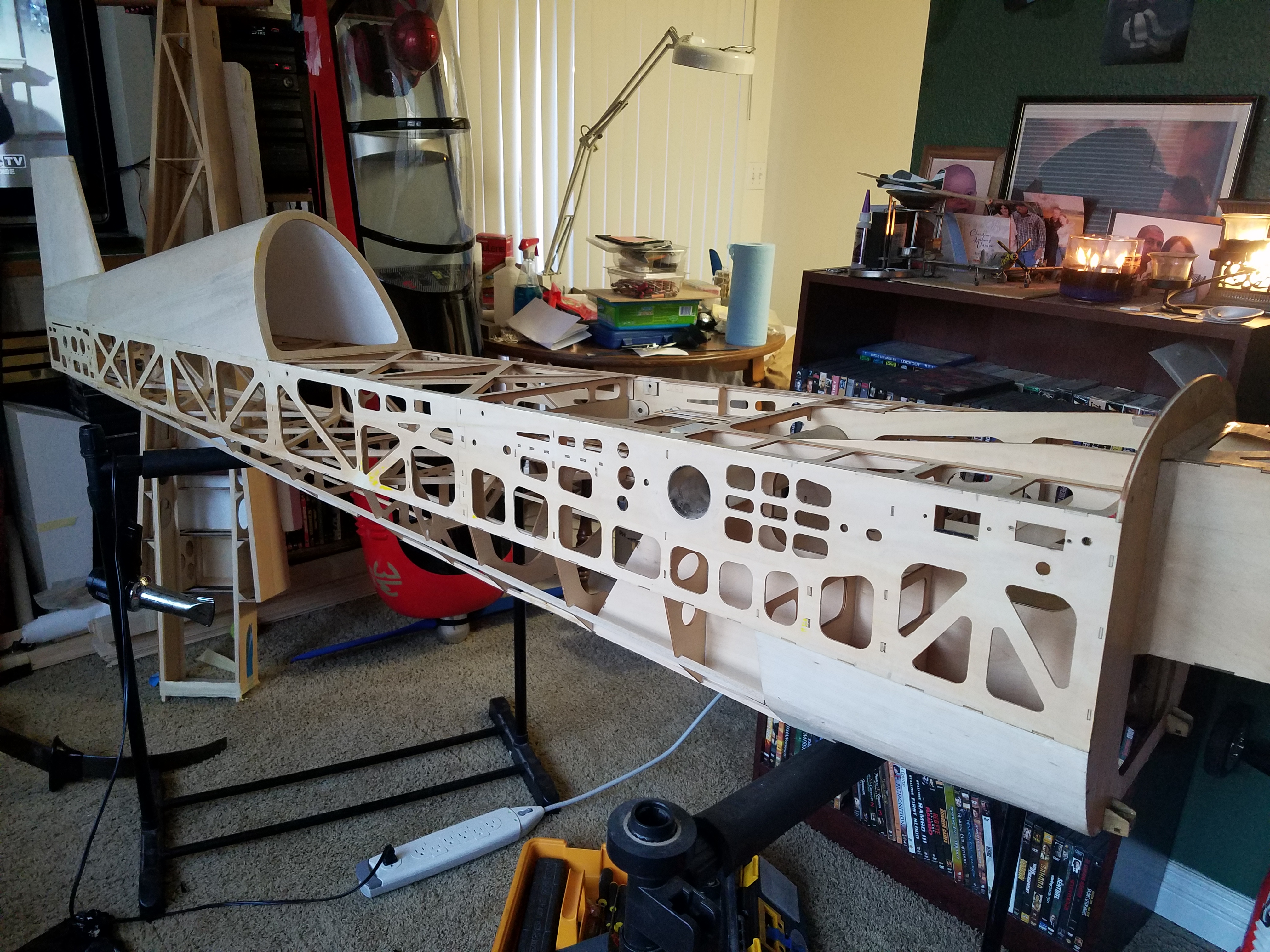

I goofed fellas. I accidently put this photo in the covering contest thread. It really should have been here. Sorry for the confusion. I now have the fuse stripped. Not too much residue left behind. A couple of spots of yellow like when I recovered the Behemoth Yak (1). But not a problem. I think it must just be the yellow pigment that comes off. As not other color seems to bleed quite so badly. But like I said, not so bad. I will get a couple of scraps of covering and heat the wood then lay the scraps over the spots. I discovered this helps pull up the residue. And any left after that, I will just break out the trim solvent.

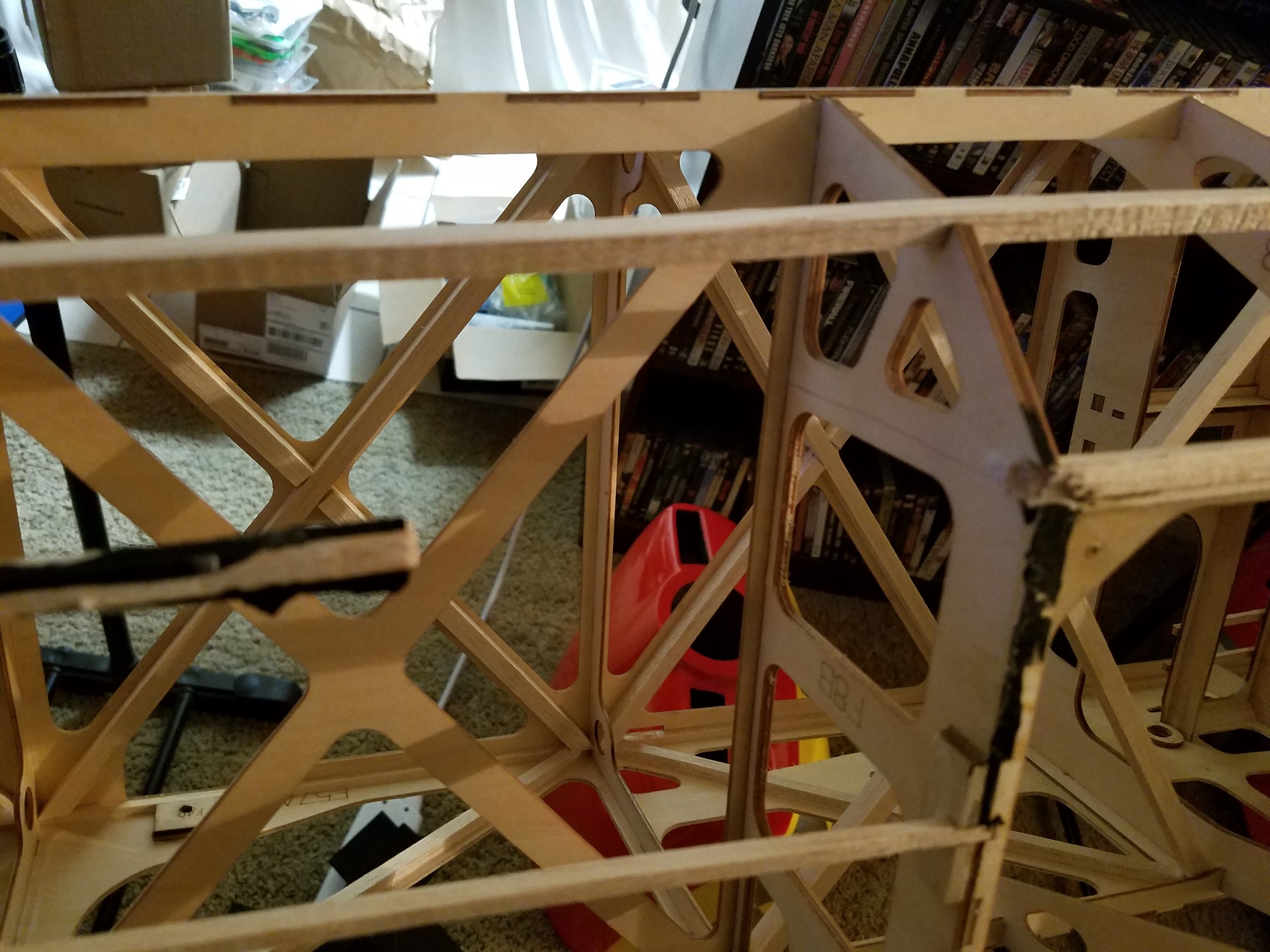

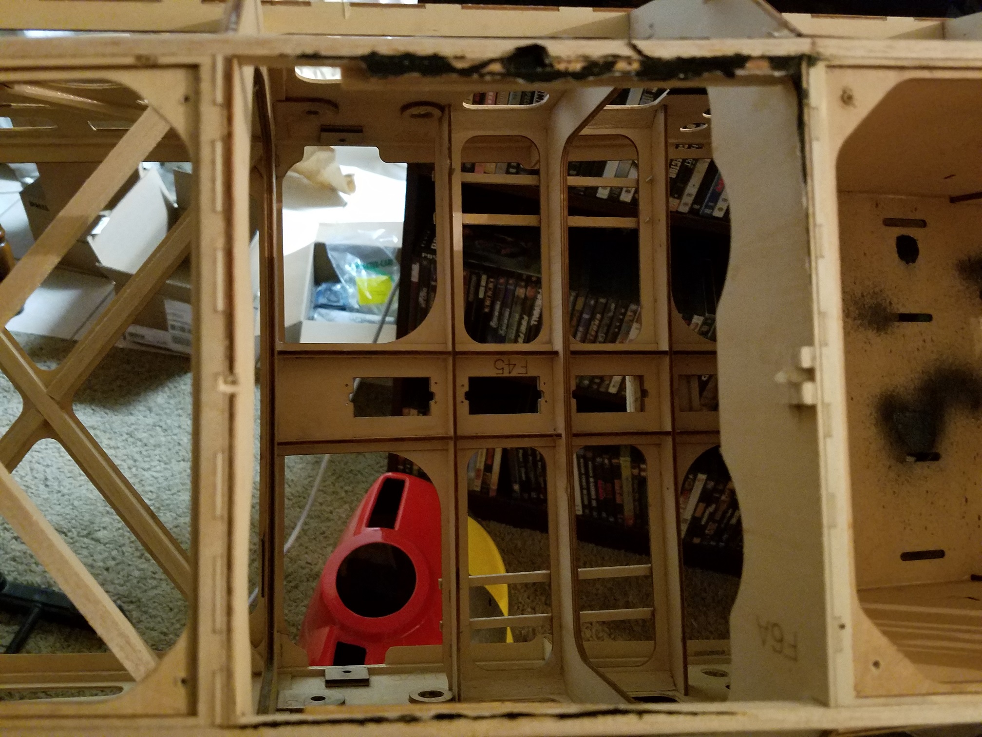

I went downstairs and noticed the 330 just sitting there on the stands all naked and cold and stuff. "So, are ya just gonna look at me or are ya going to do something with me?" Oh alright.... After looking over the airframe really well, I came to the conclusion that as thought before, she is in pretty good shape for a used airframe. Nothing like what I had to address with the Behemoth Yak (1). Pretty clean inside. However I did notice I have two balsa stringers that need to be replaced. Obviously from someone picking it up in the wrong spot. No big deal.

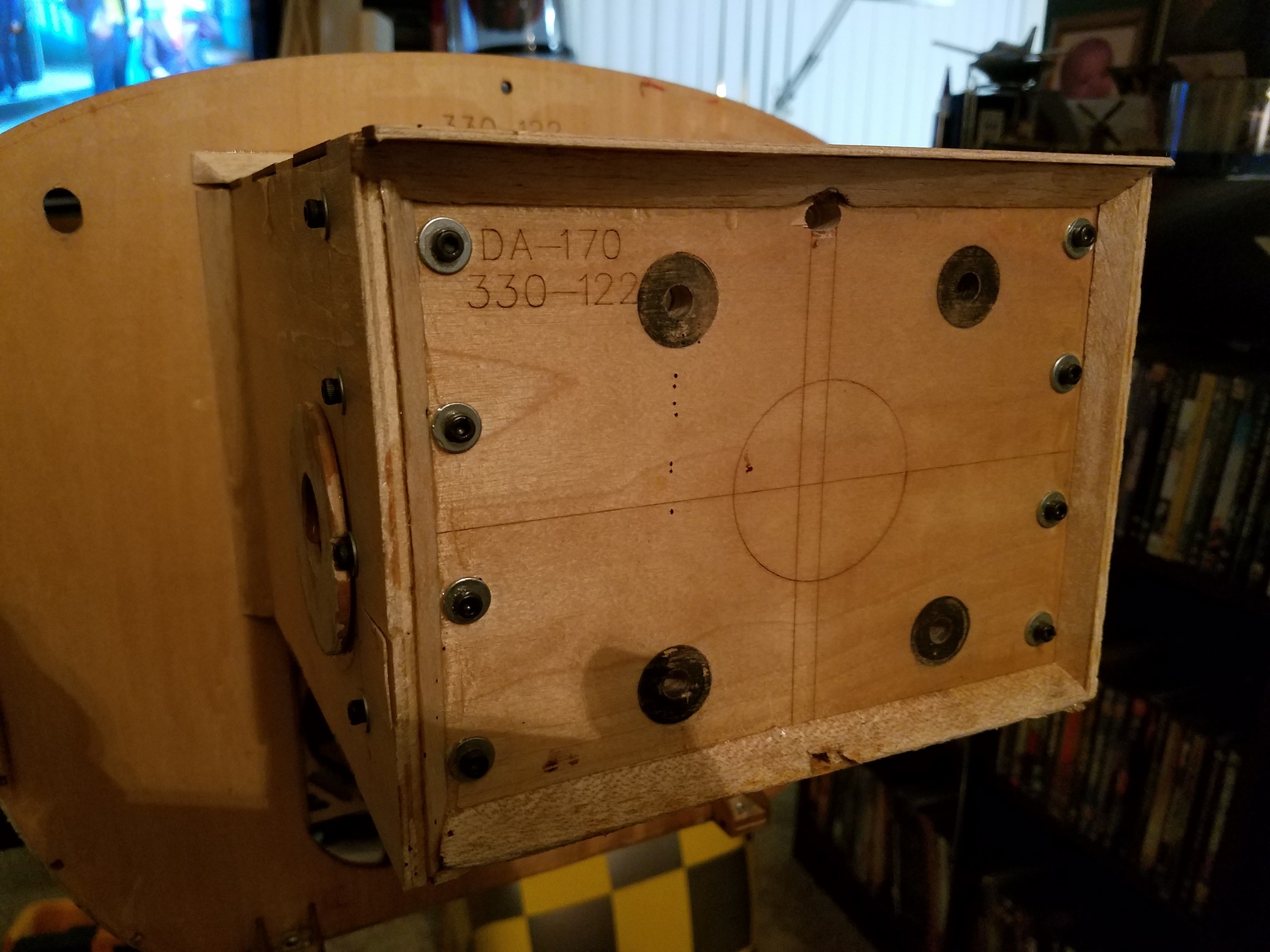

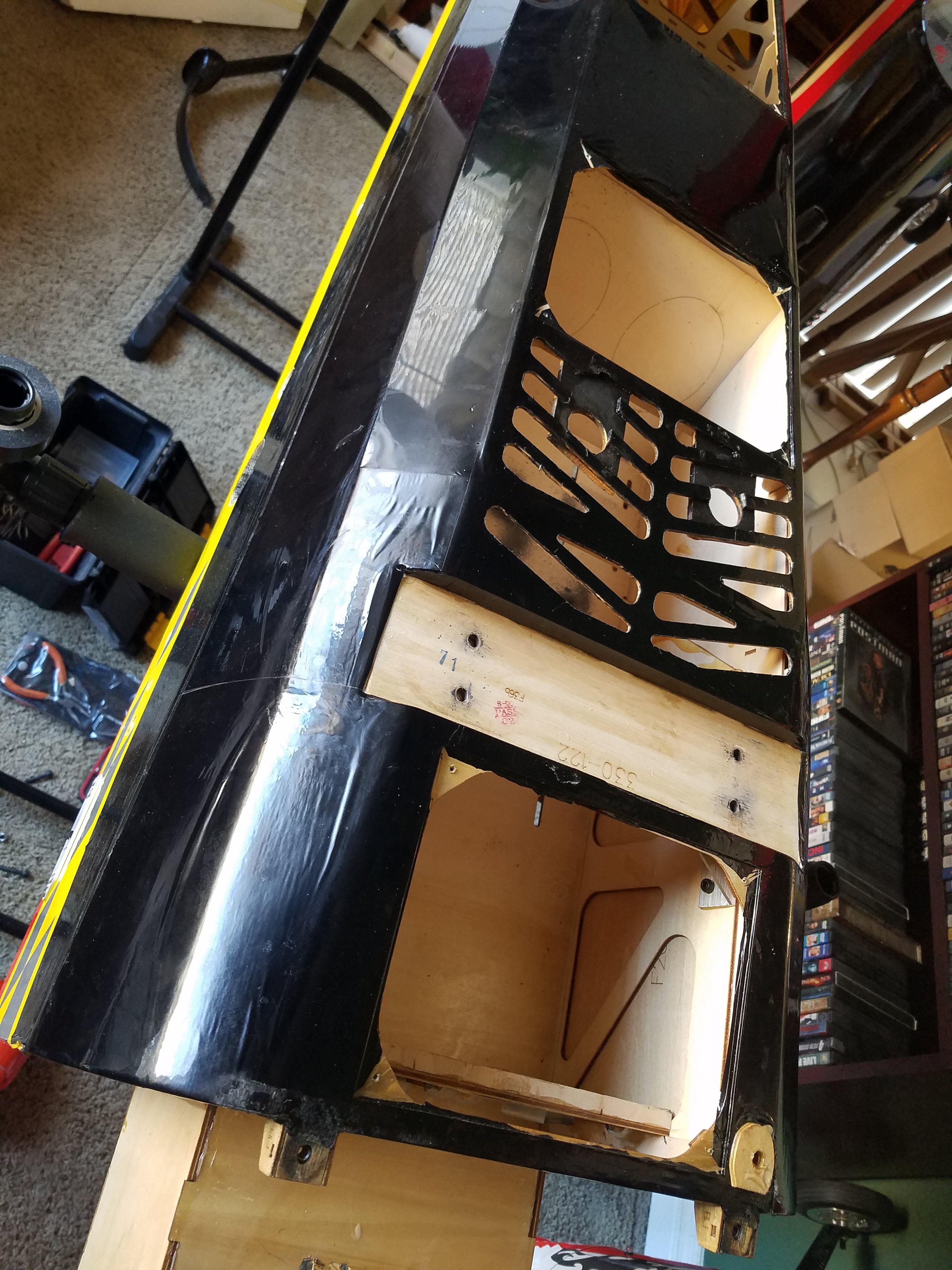

I also noticed that I will need to more than likely remove the firewall and reset it for my kind of flying. I measured the down thrust and the right thrust as I was curious why there was a 3/16" ply wafer around the top of the "F1 former. Apparently to offset the cowl seating. This I am sure was done because originally this plane was flown IMAC. Turns out the firewall has just over 2.6 degrees down thrust and about 2.5 degrees right thrust. I know for a fact that Tony sets all his planes up to have "0" down thrust and about 1.5 degrees right thrust.
Plus, I really don't like the way it was put together. I like to have my firewalls including the motor box sides and top pretty much flush. Too many times in the past I have had to "notch" the motor box sides to accommodate the offset of the engine cylinders. So I will remove this firewall and cut a brand new one and install it as per Pilot R/C design.

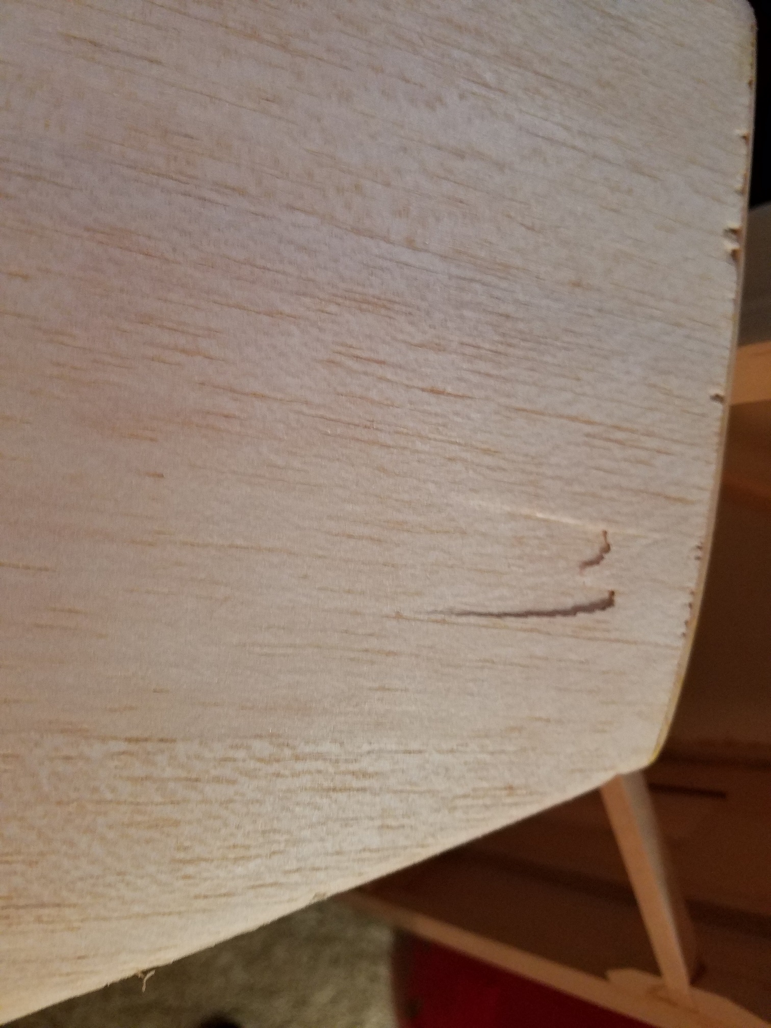

There was one other area of concern that I need to address. The vertical fin has a small area that looks as though it was "pinched" when someone grabbed hold of the plane to move it or or....??? So I will need to repair this small area.

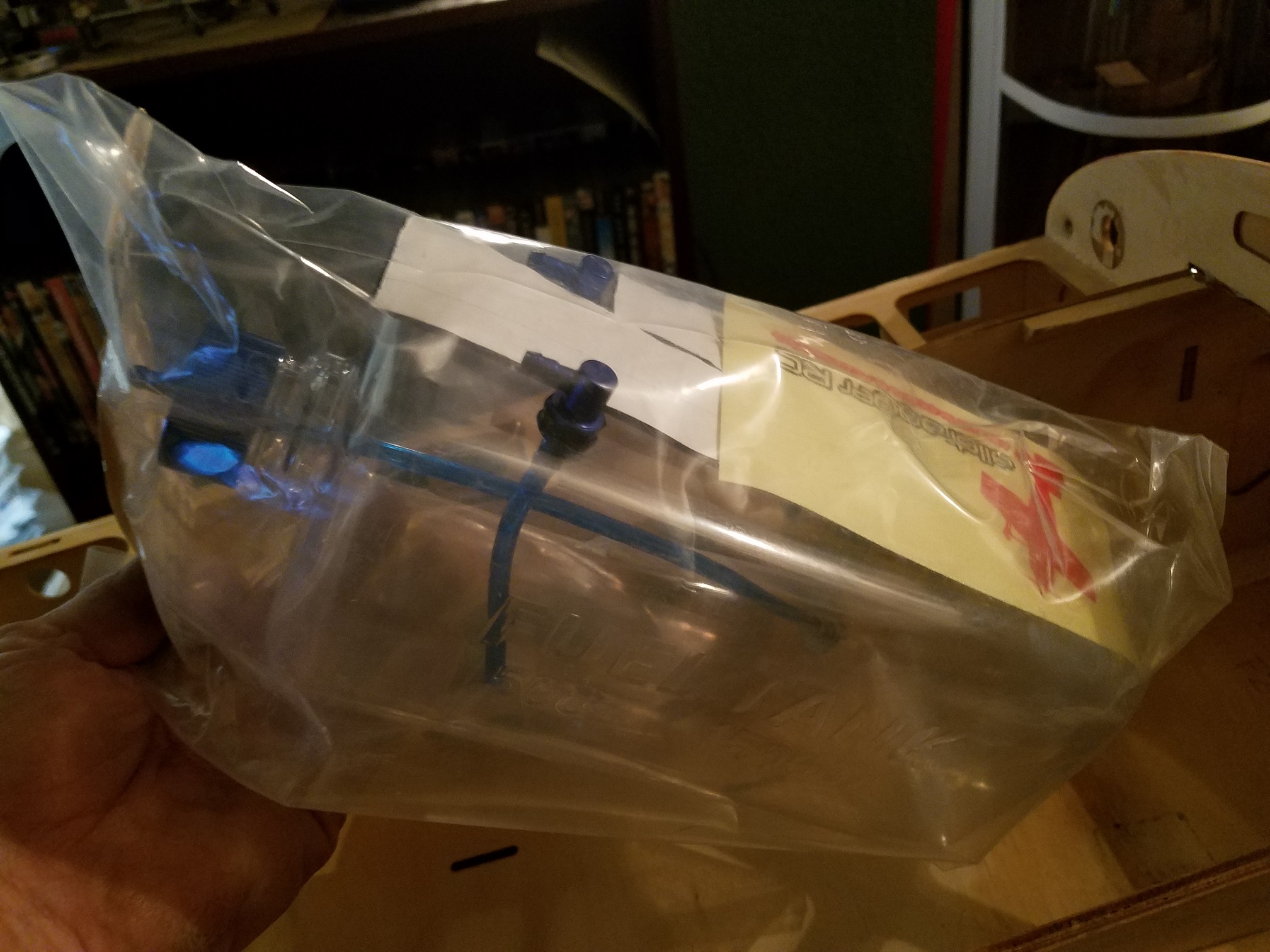

The new fuel tank arrived from TDRC yesterday. I need to get this thing done. I have too many parts arriving without a home for them to reside in. LOL
