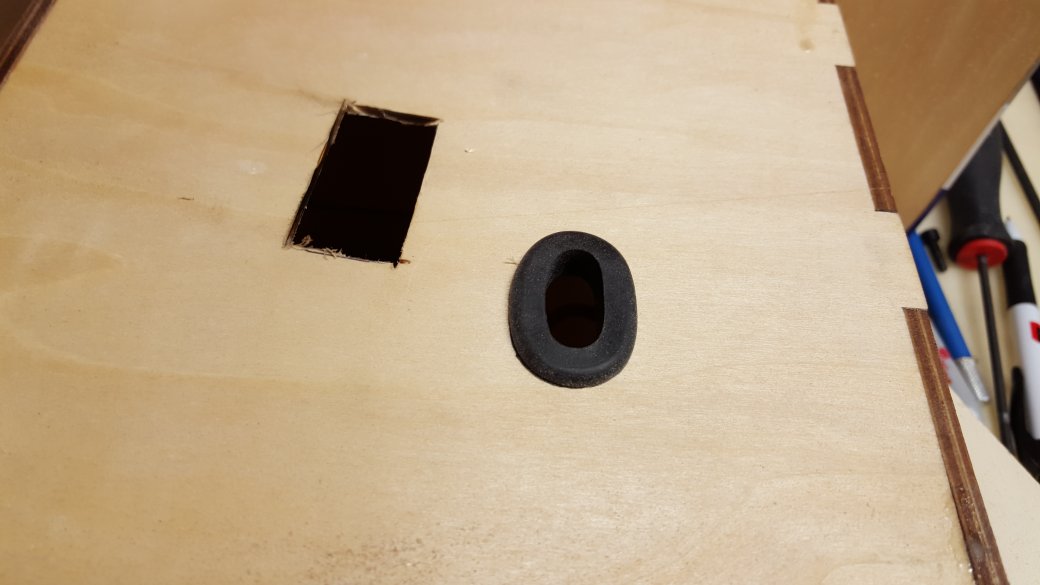

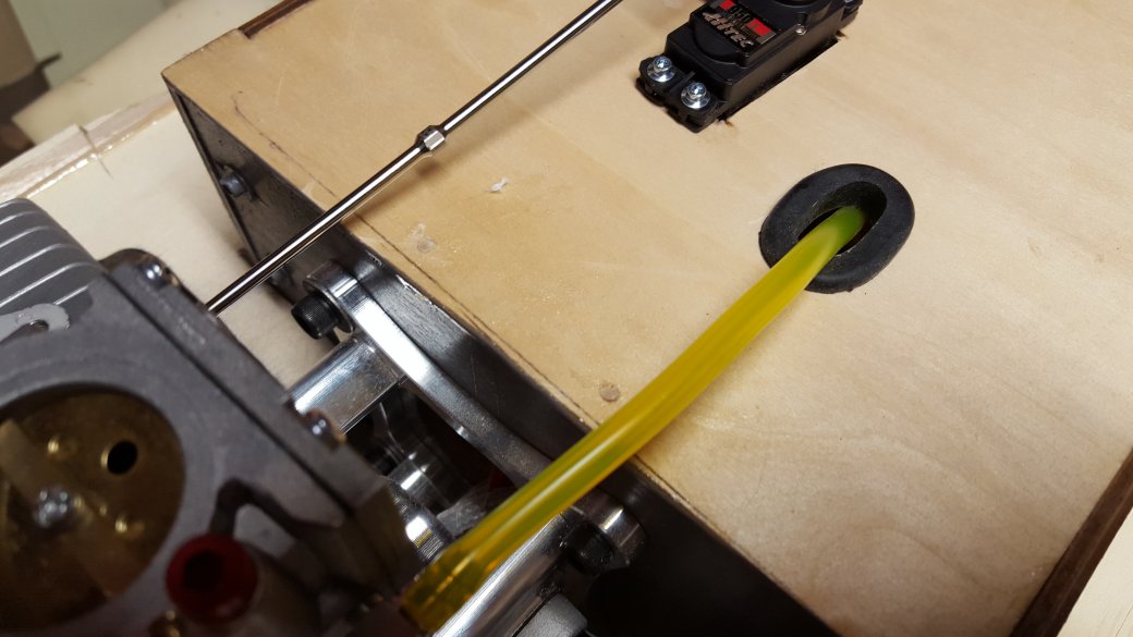

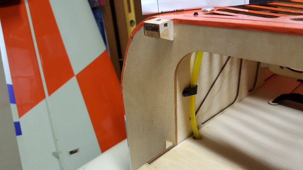

I've put together over 100 planes and always ran the fuel line through the plywood at an angle with a dremel (chamfer'd nicely), and never had the fuel line look even the slightest bit worn. But, @Mr.Anderson shamed me into trying a grommet for fun. :wink:

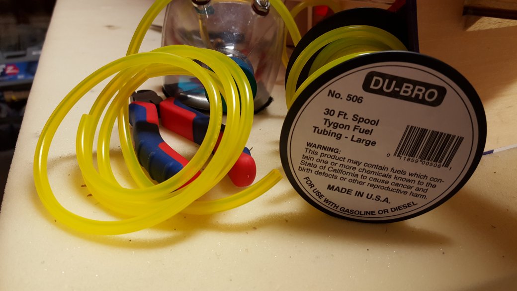

I always used to use 1/8" fuel line for my 100cc planes and 5/32" for my 150cc planes. But, the larger fuel line didn't work well on the fuel dot and also was scary big on the Tillotson carb nipple (he said nipple, hehe). So, now I'm using 1/8" on everything.

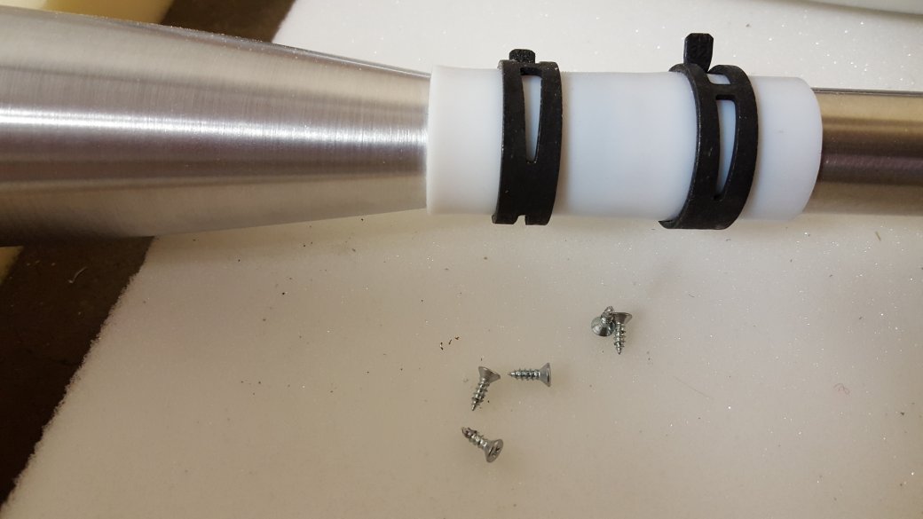

In the old days I never used a set screw and always got my canisters to stay attached. But, on the Sukhoi I ran 2 screws per clamp (8 screws total for the plane), and on this plane I'm trying 1 screw per clamp (4 screws total for the plane).

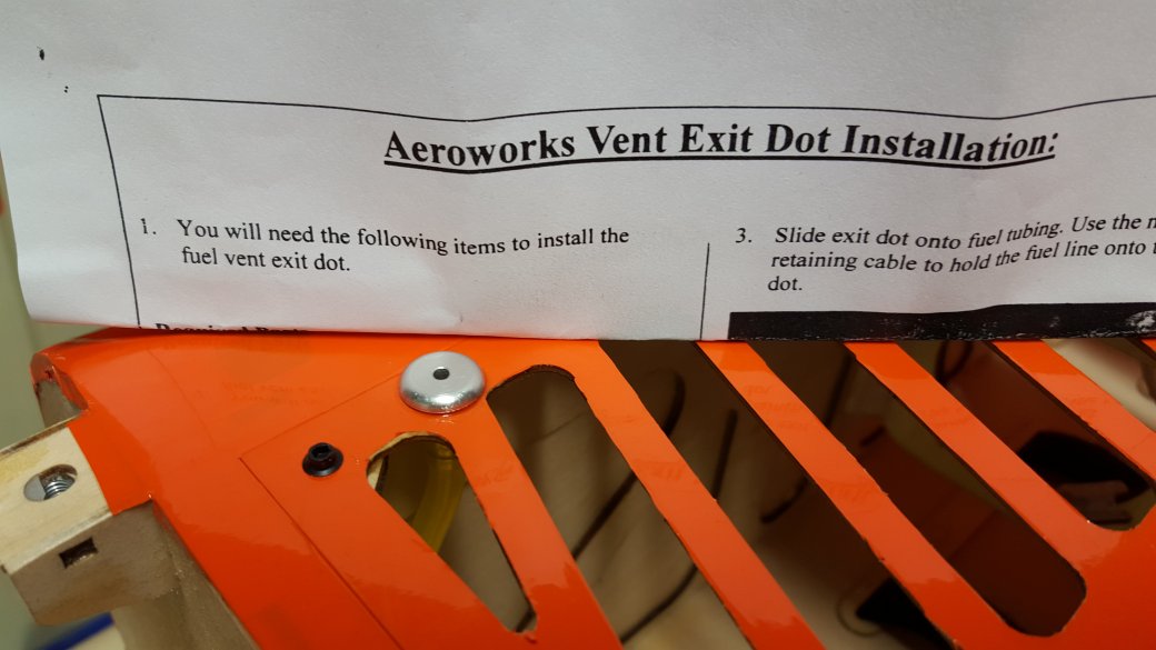

I used an Aeroworks vent dot... I used to use a fuel fitting nipple sometimes... they work well, but can get hungup on things, these are pretty slick:

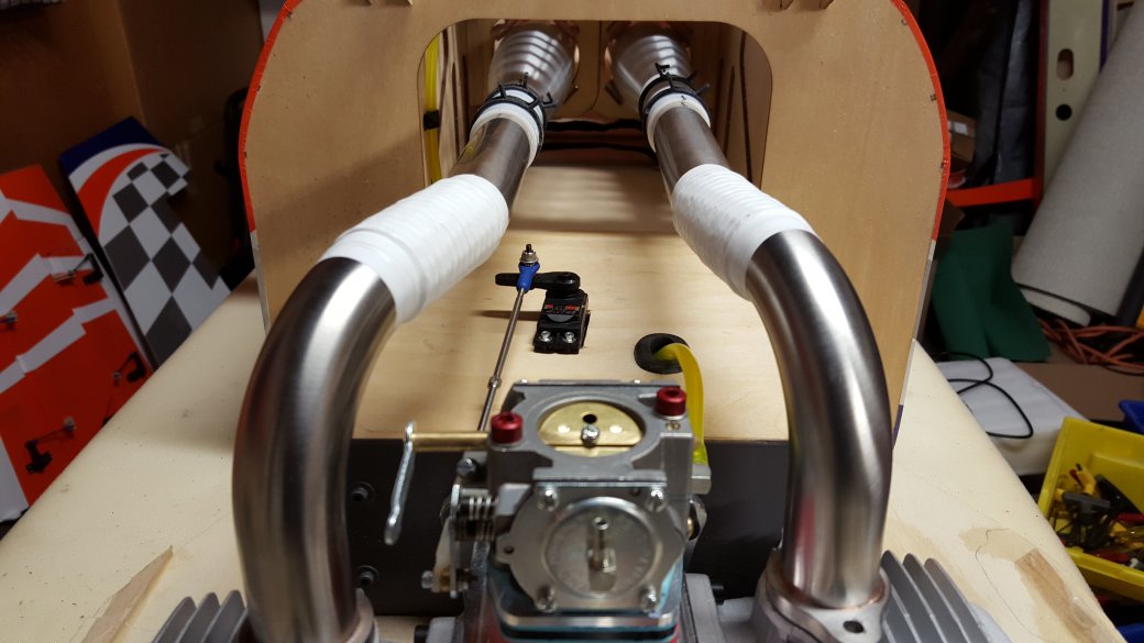

I placed the dot and fixed the vent line where it would avoid the hot pipes and headers:

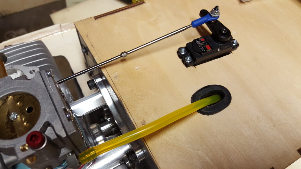

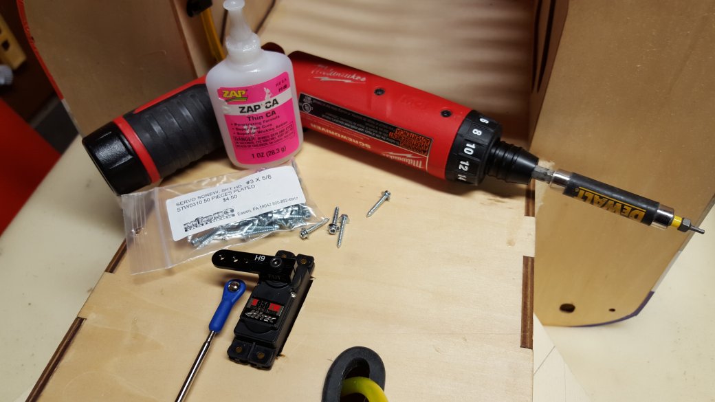

Gathered everything up for a quick installation of the Hitec D950TW throttle servo. You know the drill, pilot hole for the screw, screw in the servo screw, remove the screw, drop of thins CA, let dry, screw down the servo.

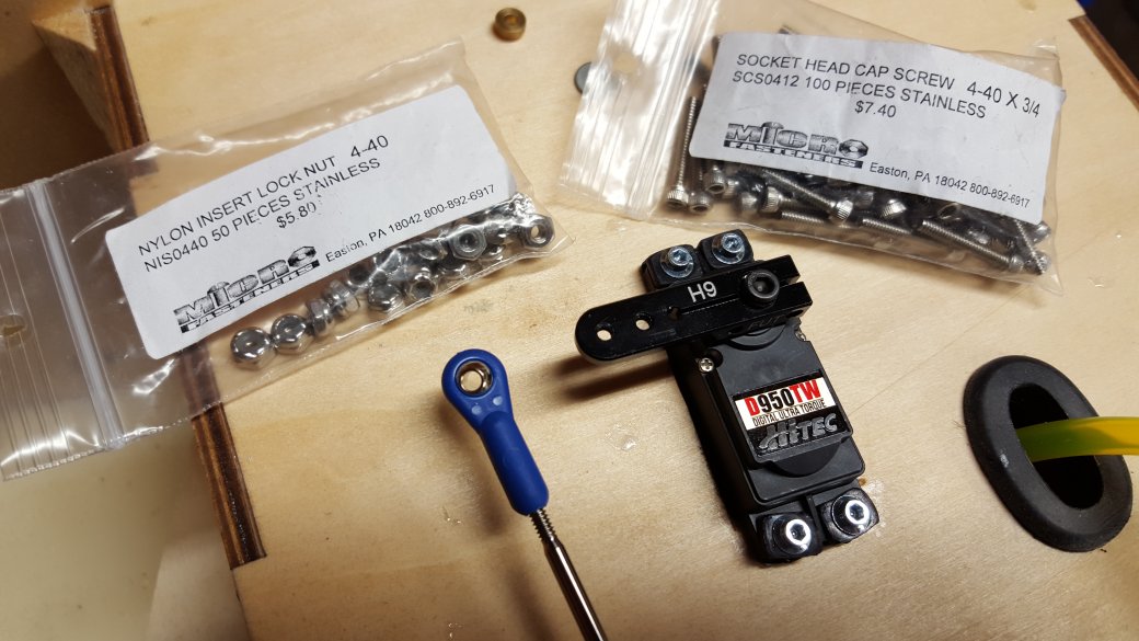

I thought I was so on the ball thinking ahead and buying a 1" H9 servo arm to match (tried it in the 3/4" hole).
But, it was too long for the short throttle servo arm (I keep asking Dave to lengthen that thing!). So I went with a stock plastic arm drilled at about 5/8" out. That gave me 100/100 end points. I probably could get even drill it at 1/2" but I'm not used to having such a short arm, and I'm not sure above the leverage, etc. I'd just rather have a longer throttle arm. But, 100/100 is not terrible. Also, if you go back and read QQs article on linkages you'll see that you can adjust the throttle curve with the length of the pushrod vs with a curve in your radio:

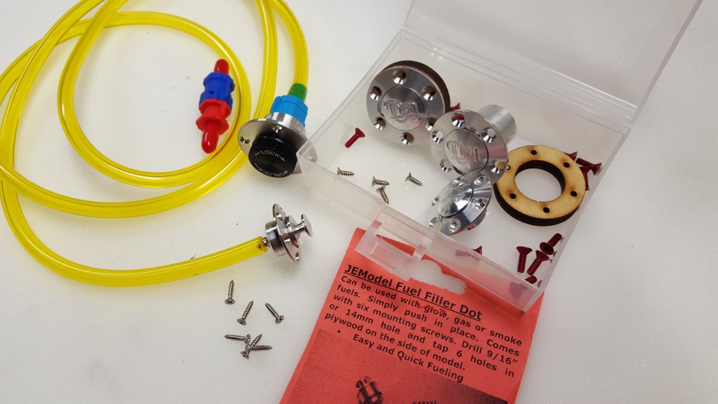

Okay, I had four great fuel dots in stock to choose from. I had two DA fuel dots, one Pilot dot that came with the plane (nice!), and one Jersey Modeler dot that is very nice, as well. Yet and still I ordered a JEModel fuel dot from Aeroworks because they're my favorite now... because they're easy on the arthritis and fingernails. :)
