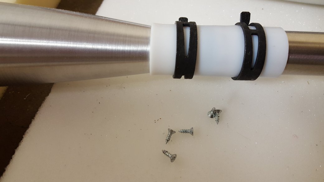

In the old days I never used a set screw and always got my canisters to stay attached. But, on the Sukhoi I ran 2 screws per clamp (8 screws total for the plane), and on this plane I'm trying 1 screw per clamp (4 screws total for the plane).

Very thin coat of high temp silicone on the gaskets, let dry. Use "nord locks" and the bolts will never come loose, never use loctite in the heads because it liquefies with heat and is useless anyway.
What screws are you using for this?
I have a ProFlow can in my Edge and I haven't had any slipping problems yet but I've been thinking about using a couple screws to make sure things stay where they should.
How about these dyna locks from microfasteners.com?

NO on the dyna locks....nothing compared to Nordlocks. Actually I prefer the standard stainless nord-locks because they are thicker and can be used over and over almost indefinitely. Use them for mufflers, and prop bolts. http://www.mcmaster.com/
