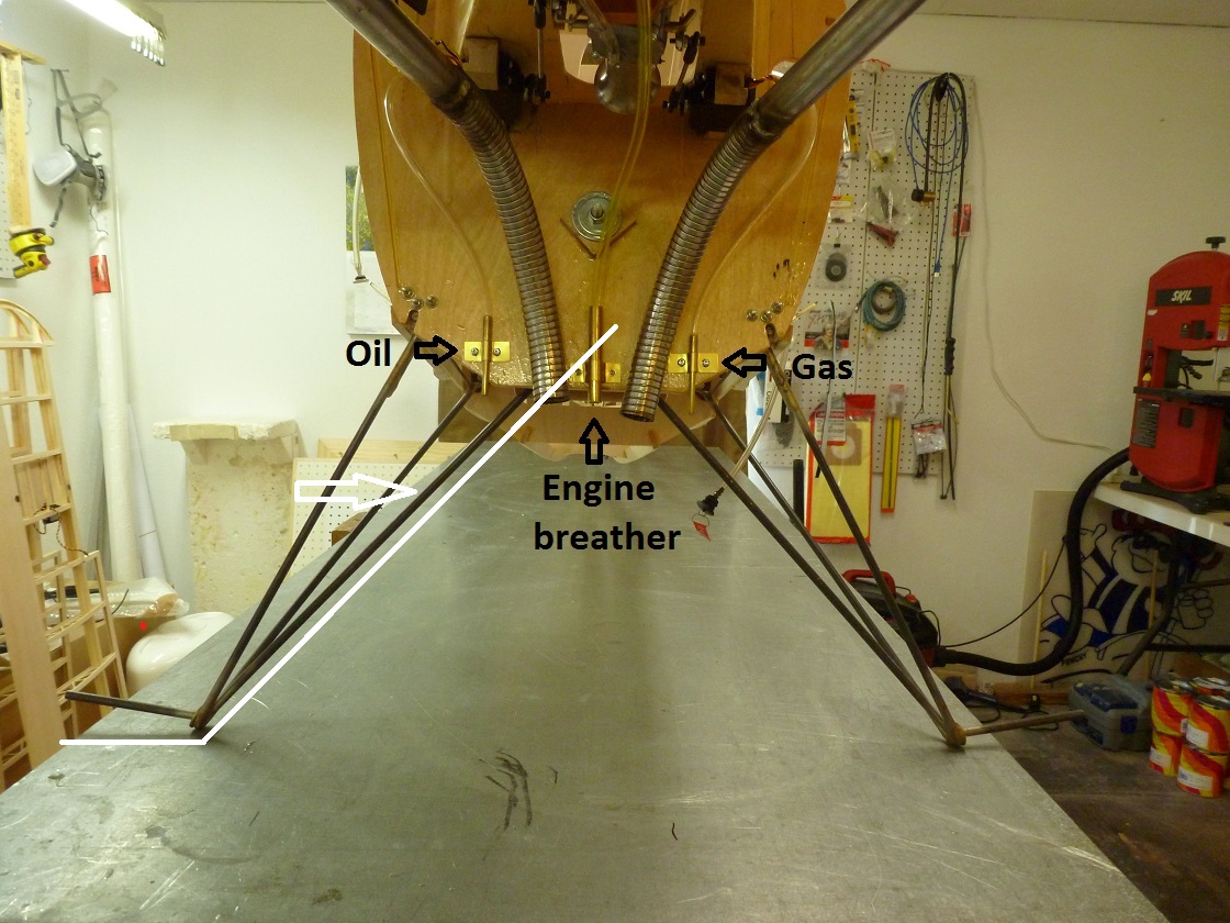

Ok guy's, tell me what you think. I need to replace the broke gear, we all know that. I was wondering if cold steel would be up to the job or if it has to be piano wire. My way of thinking is cold rolled may actually be stronger as it might have a little flexible give to it. The current wire is 1/4" and my wheels can be opened up to 9/32", which would be a bit larger.
What are your thoughts on it?
Ok Acer the answer to your question is complicated and has several answers. Note that piano wire has a yield strength of 280 to 320 K-psi And mild steel from 36 to about 80 K-psi. So depending on the diameter and what the cold rolled strength is either one can work it just a mater doing the calculations and the geometry. I do not mind trying to help you but first we need a drawing or layout of the gear with all the dimensions and angels to get the moment diagram. And then do some numbers to see if it works for you. Let me know. Have one concern how is the wheel axel connected to landing gear or is one of the landing gear wire bent to be the axel. Depending how it is done the calculation on a brazed connection is very difficult to do to many variables in the process and weld material and cleanliness of the weld.

Ok Snoop, in the pic the white arrow points to the wire I need to replace. The white line shows how it runs and the bend angle, the wire is the axle. The current wire is 1/4" but I could, if need be, go to a 9/32".

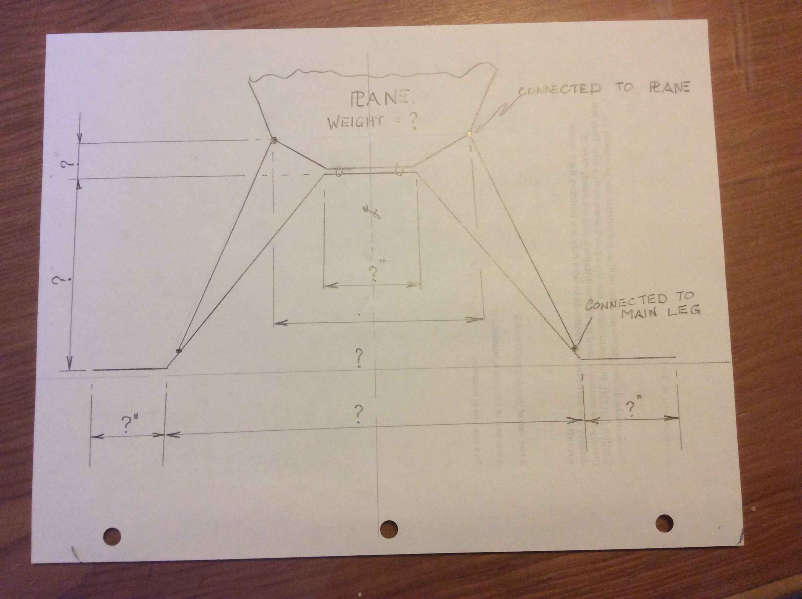

Ok I will need info from you and we will work our way through it. Just so I understand the picture properly the 2 main legs are very close to being in line and the 3rd leg between the two main leg angels backwards to restrain the gear from moving forwards and or backwards. Next assumption the 2 main gear wires are hard connected to the fuselage and the 2 wires are hard connected to one another near the wheel. If the answer to the above description is yes then I believe I know why your gear failed at the point it did which right at the bend at the wheel. Please read the note and give me an answer. Depending on the answer you give how we will proceed.
Have added a drawing that needs to be filled in to make sum calculations to see what is going on.
