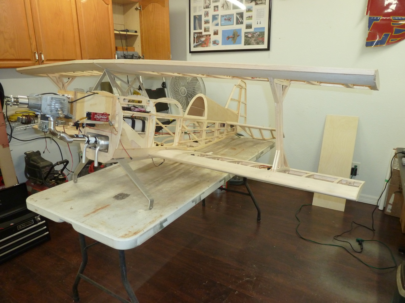

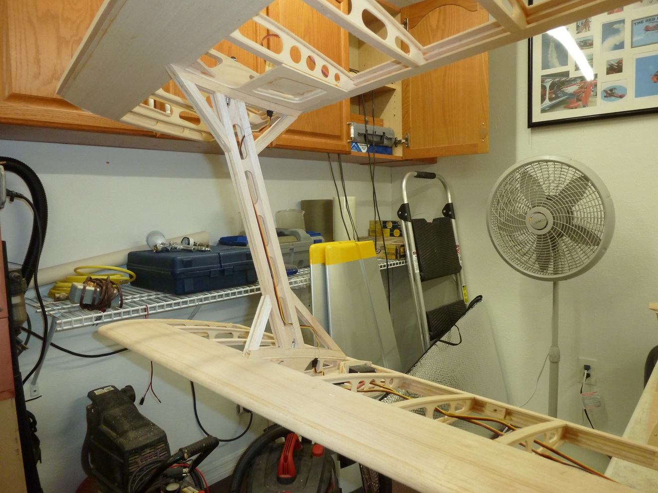

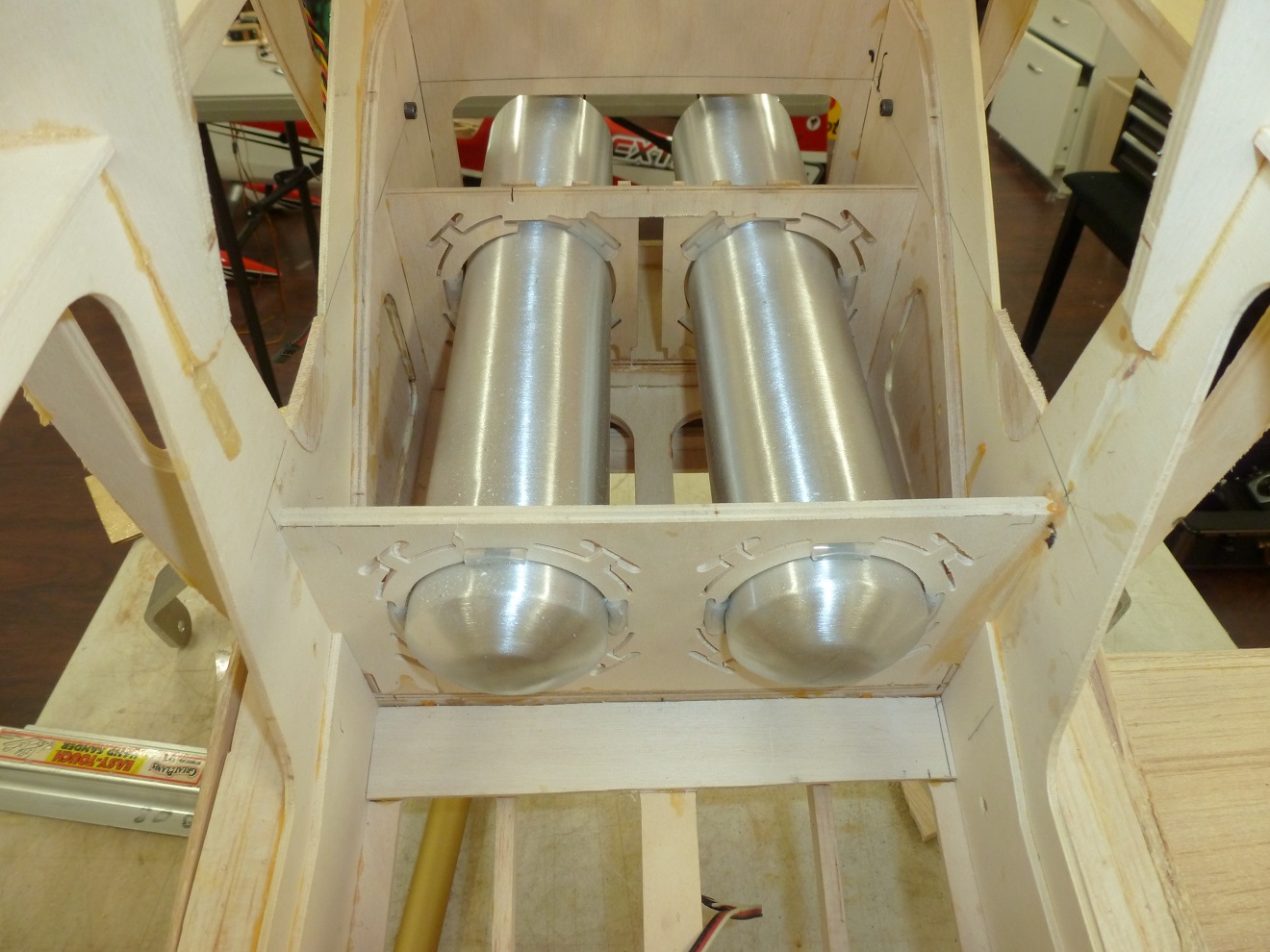

Speaking of Challenger, I am closing in the canister tunnel so none of the heat goes into the fuse. Also finally figured out how they (EMHW) intended for the flying wires to connect to the airframe. They should work out to be very strong, they show them being recessed in the wing but I will make them flush, will start posting pics tomorrow as I work on it. As it stands it need's the wire mounts plate, epoxying the canister area, finish up the servo extensions, mount the tank and electronics plate, install pants mount, and make all the servo to surface linkage. The covering should be here by then, so some light finish sanding and then cover.

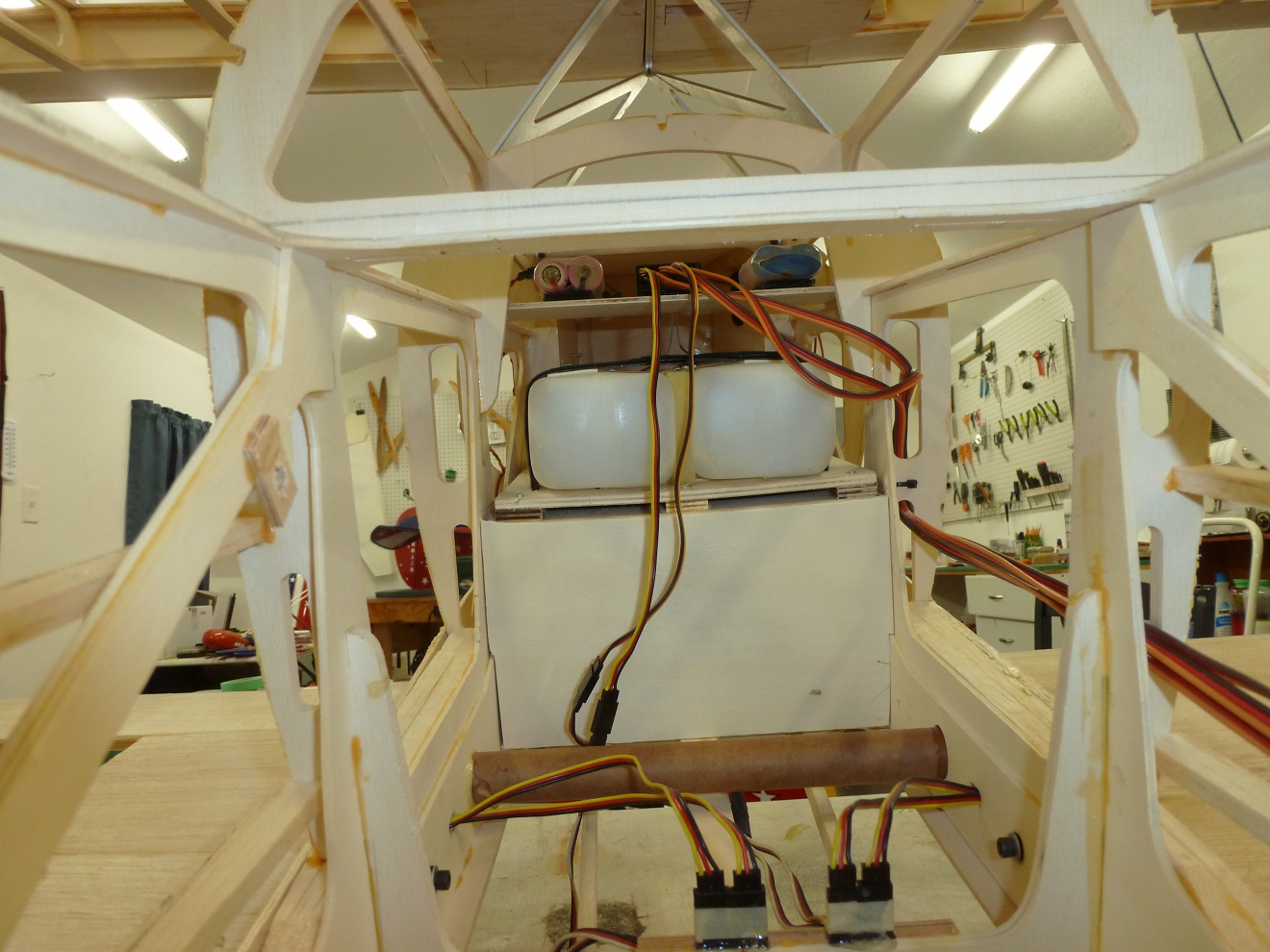

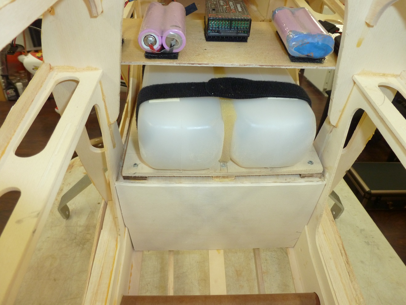

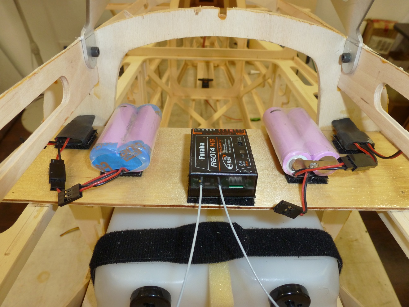

I have got a little done today, the tunnel is complete, fuel tanks in, radio tray done, all the wiring is complete except for throttle and choke. I spent at least an hour searching the shop for the Tech Aero, could not find that bloody thing any where. During a break a short time later it hit me, I put it in the Yak....One has been ordered.
