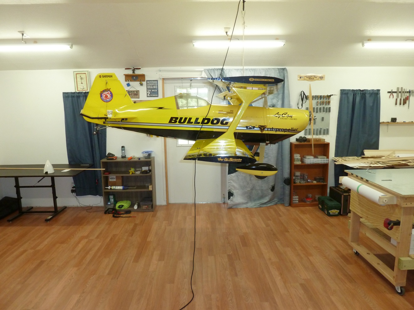

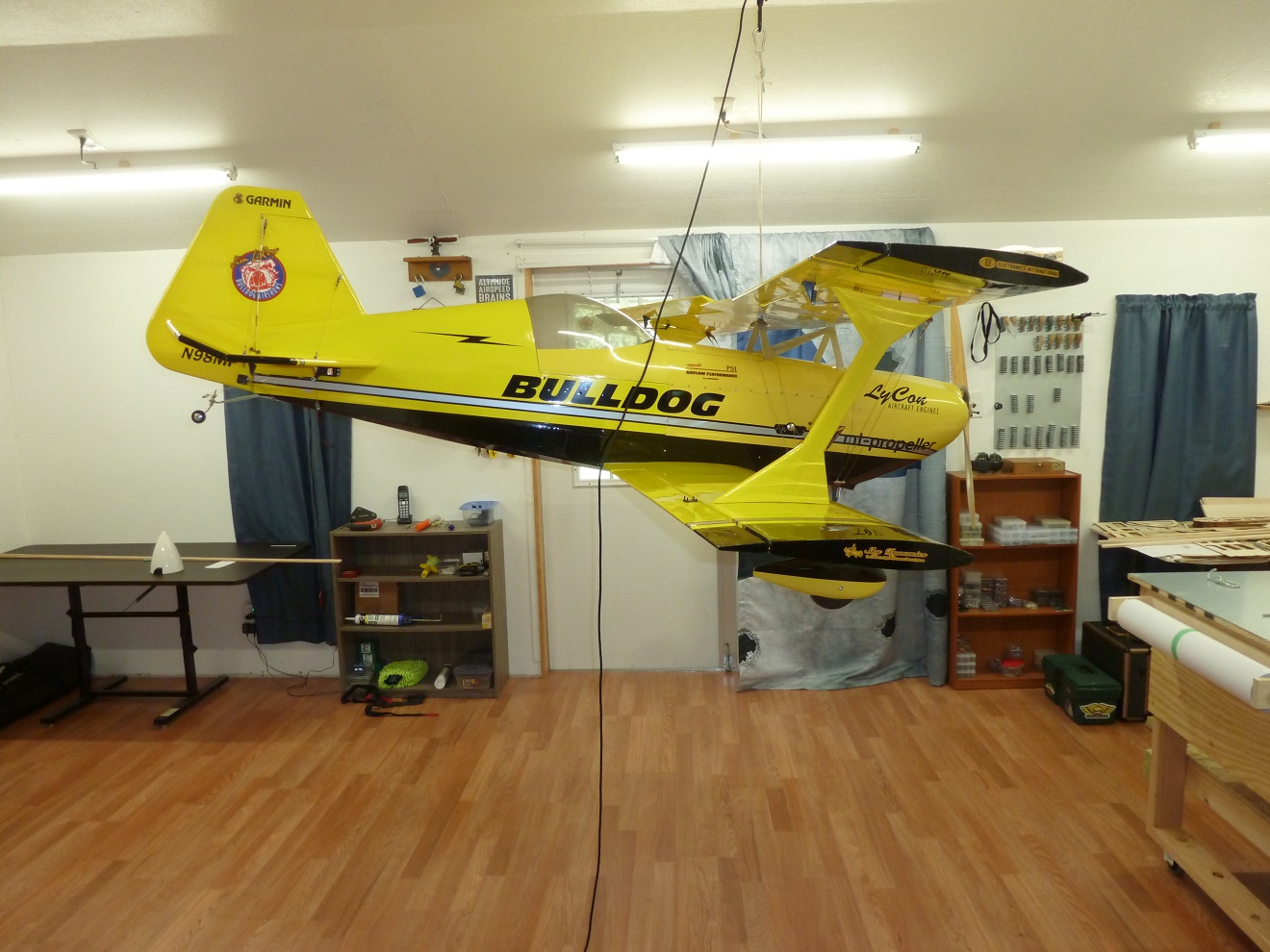

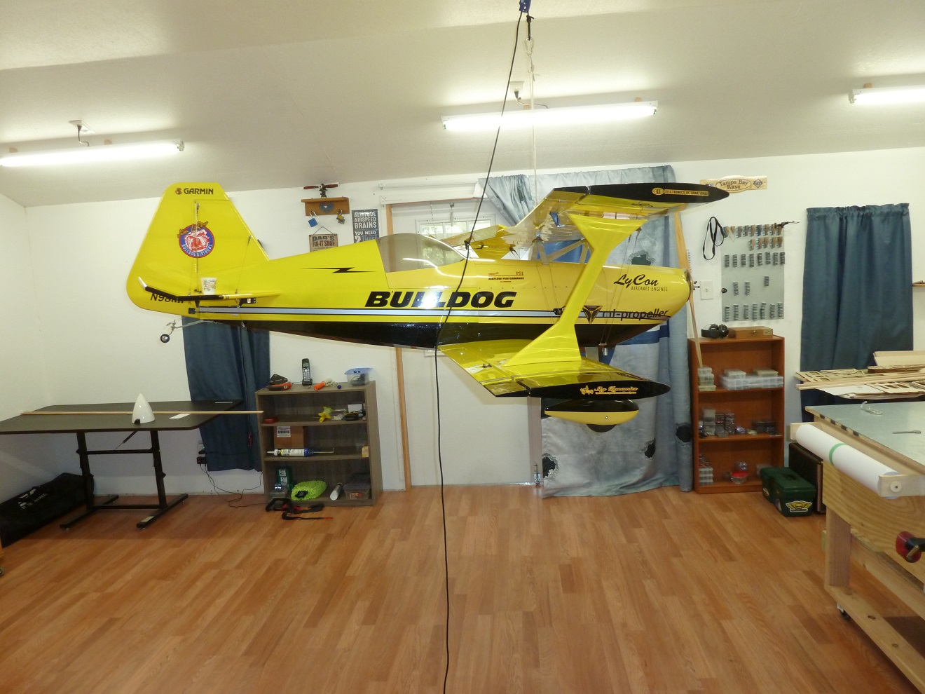

What do you guys think???
It is slightly nose heavy as seen in the first pic. The second is with 6oz on the tail then the third with 12oz. What ya'll say, maiden as is or add some weight?
I guess shoving everything possible toward the nose was a bit to much. But it should work out for the best when I strip it a do a Stits covering and paint job.

Come on guys, give your opinion. Every Pitts style bipe I have had started out flying like it was tail heavy even when balanced. So I am considering doing the maiden as is.

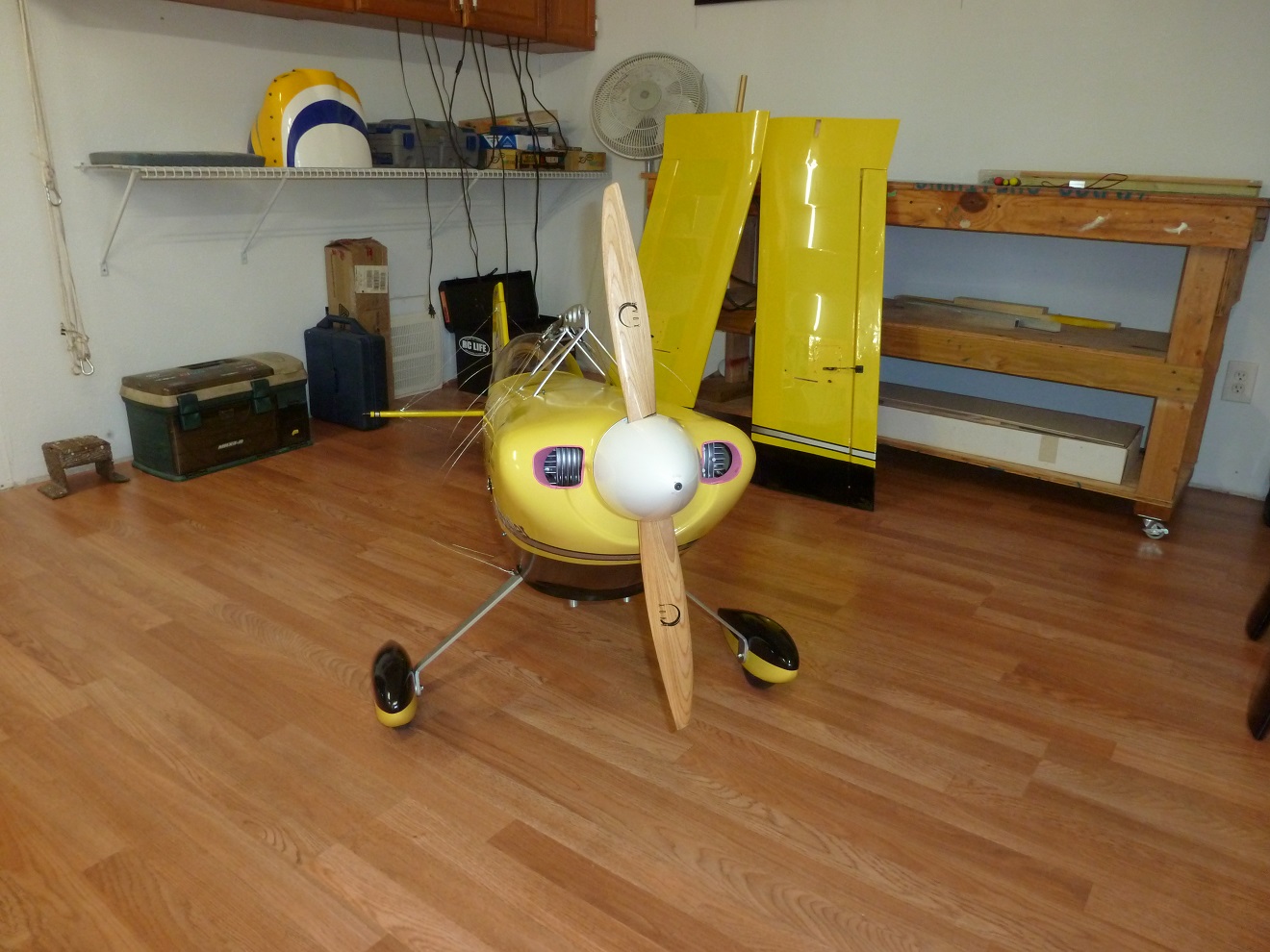

Did some baffling yesterday evening. All I had of the foam was some thin stuff so I took an unorthodox approach and just cupped it in the hole and trimmed close to the outside, will trim it more closely today.
