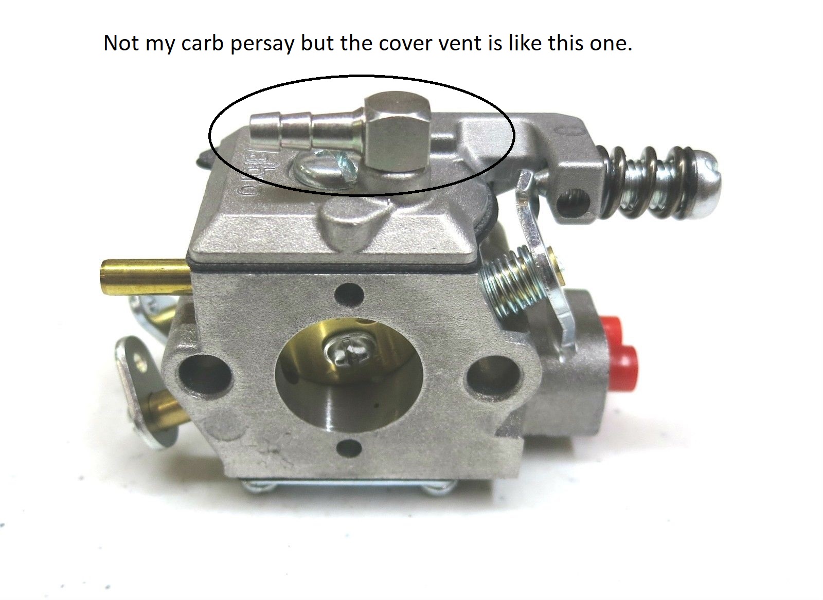

I finally got the Challenger outside, secured it, filled it with fuel, and then commenced to flipping. But not to many as by ten if no pop somethings wrong. Started checking things and the line in the tank was folded over on itself. Now I have fuel coming out the fuel line, hooked it back up, ten flips and no pop. Choke on, full throttle, no pop, but fuel is dripping out the carb. Tried every variant of carb and choke to no avail so I took it back inside figuring I need to go through the carb. When I set it on the table the side of the carb that has the vent still had the rubber cover on it. Now I am really confused, if the cover is on the diaphragm does not work right? So why the fuel dripping out of the carb? Anyone have any ideas?

The only thing that I can think of is when you were flipping with the fuel line plugged the diaphragm pulled all the way down fully opening the control fuel needle. When you fixed the tank and because the carb diaphragm was still plugged when you started flipping the fuel just ran in uncontrolled instantly flooding the engine and never had a chance to kick or start. That is my thought from a long distance away. Just trying to help

I thought with that vent being closed the diaphragm did not work, or does it still work just at a much lower volume or pressure.
The one side is connected to the crankcase side and the other to atmosphere and it there is an imbalance it open or close the fuel flow needle.

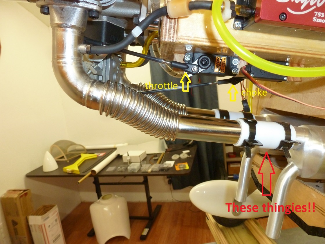

And it runs, amazing how that little plug just shut it down. Next time out I'll give it a bit of a tuning for first flight. I do have another small issue though, on the exhaust this time. Those little white coupling thingies are leaking, the clamps are pretty tight, how can I stop it?

I have had one engine with those Teflon connectors and they leaked all the time. Could not stop it. Some people put some Red RTV on the Teflon connector but I bo not think it works nothing sticks to Teflon. One suggestion not a good one wrap the ends with Teflon tape and then put the clams over it, that’s the only thing I can think off. Keep me posted if you find a solution. What ever you do do not try hose clamps do not work at all

100% silicon is the best for high heat so I'll just pull it apart and seal it up with some.
