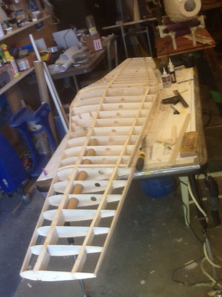

Here's a quick picture of my current status. Spar webs have been added, LE & TE reinforcements, and wing hold down sections have been built.

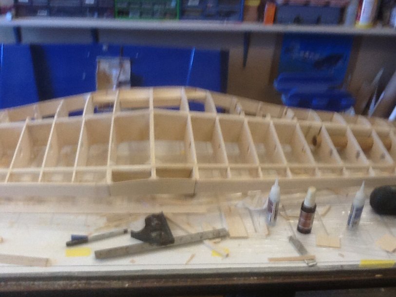

Little different perspective. That's 99 inches, that's 8' 3" of balsa and plywood, every piece hand cut. Not everything fits perfectly, but then that's just part of it. I love scratch building when I'm done!!
Red Raider
I didn't realize how badly misaligned this part was until I was taking pictures for this thread. Not only did I have to cut it off and start over, I had to figure out and measure the proper angle and the right distance from the rear spar.
