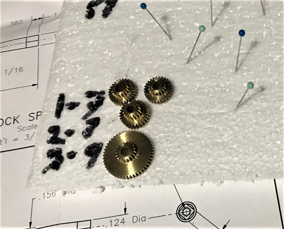

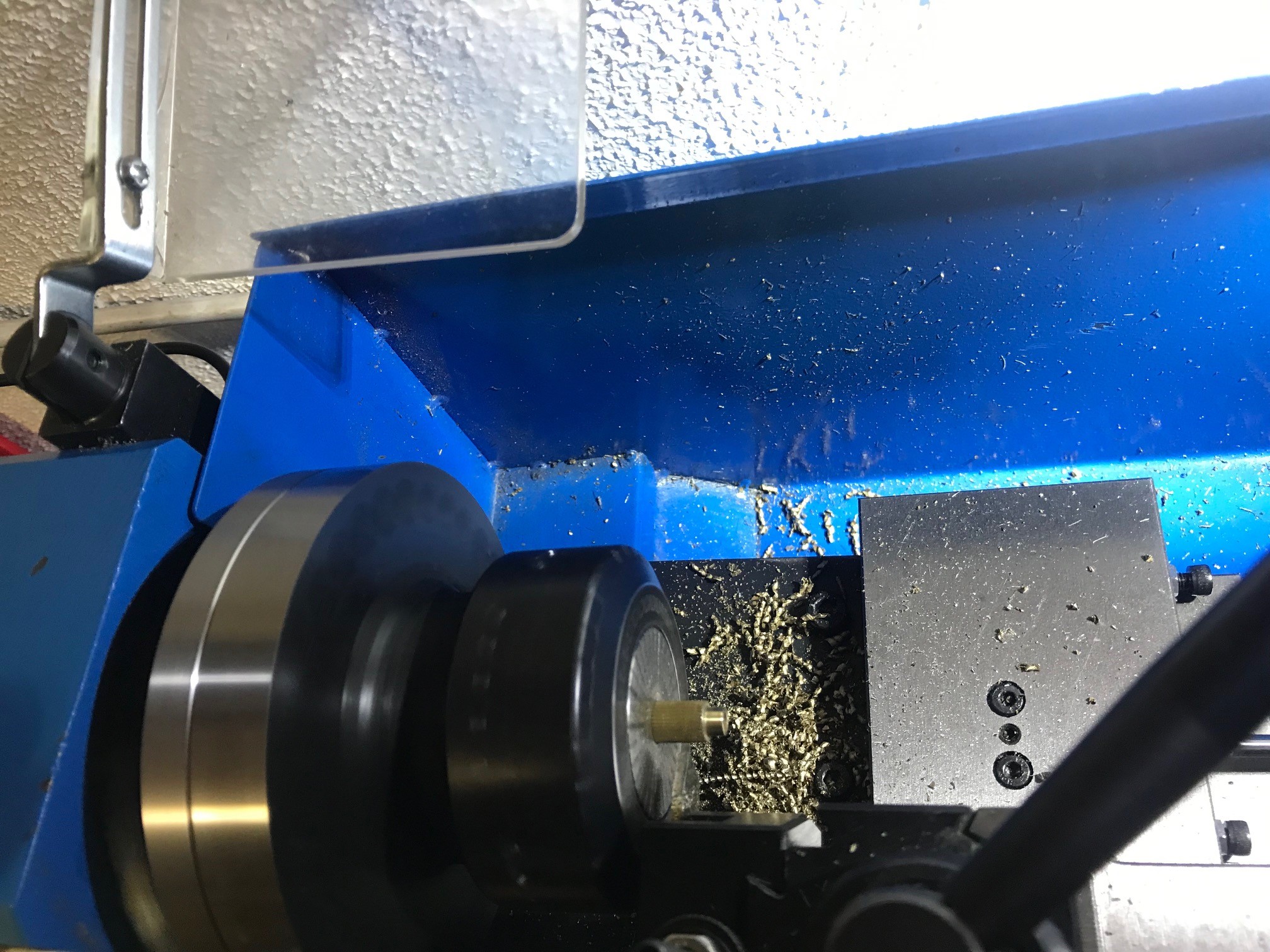

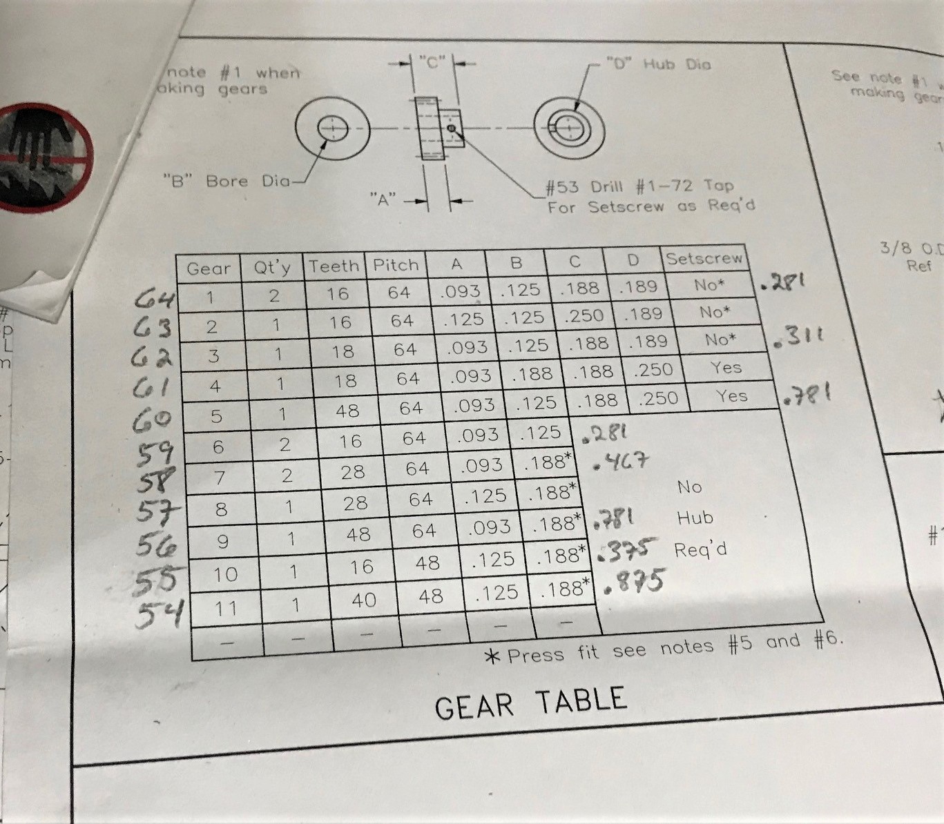

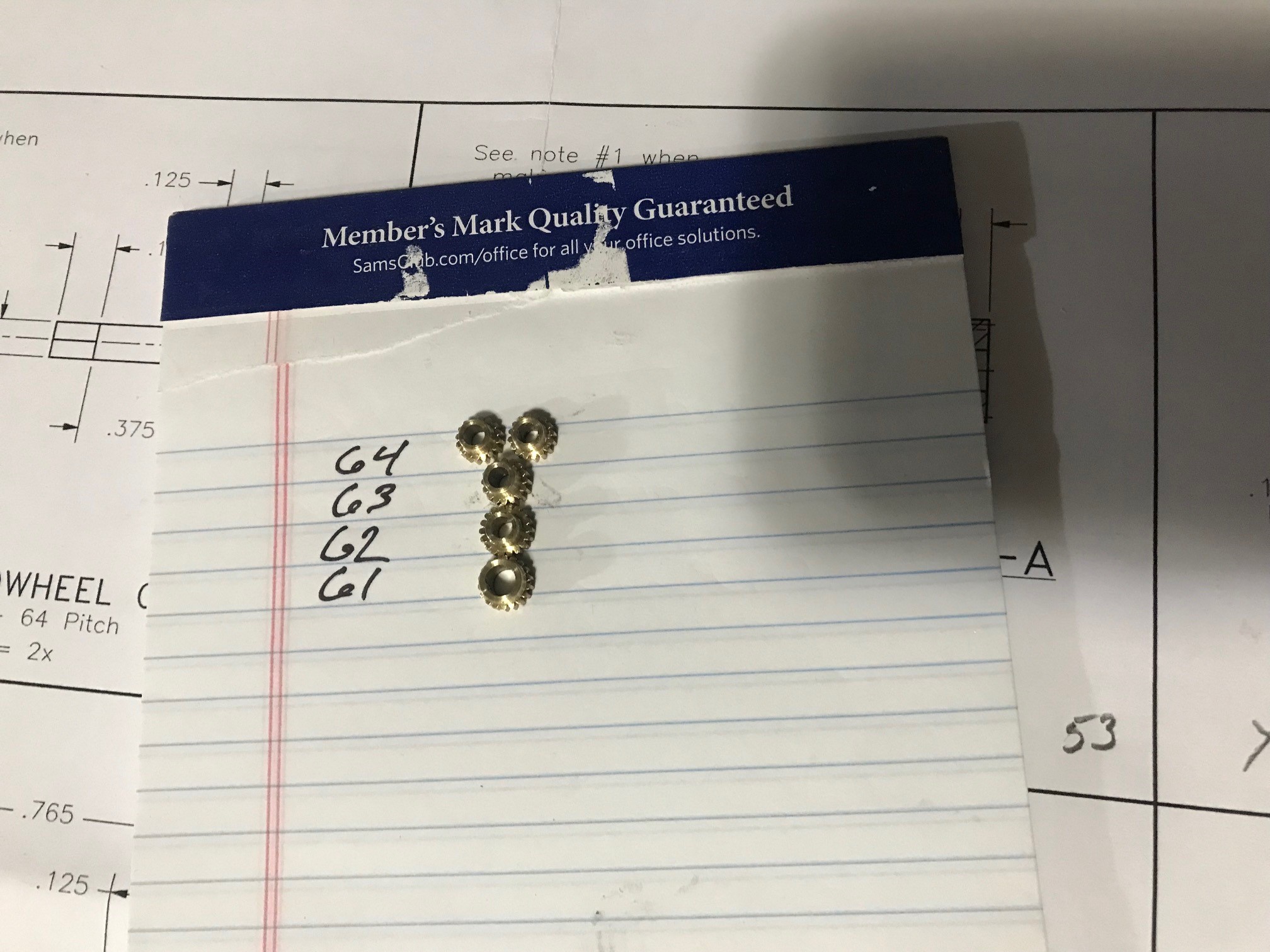

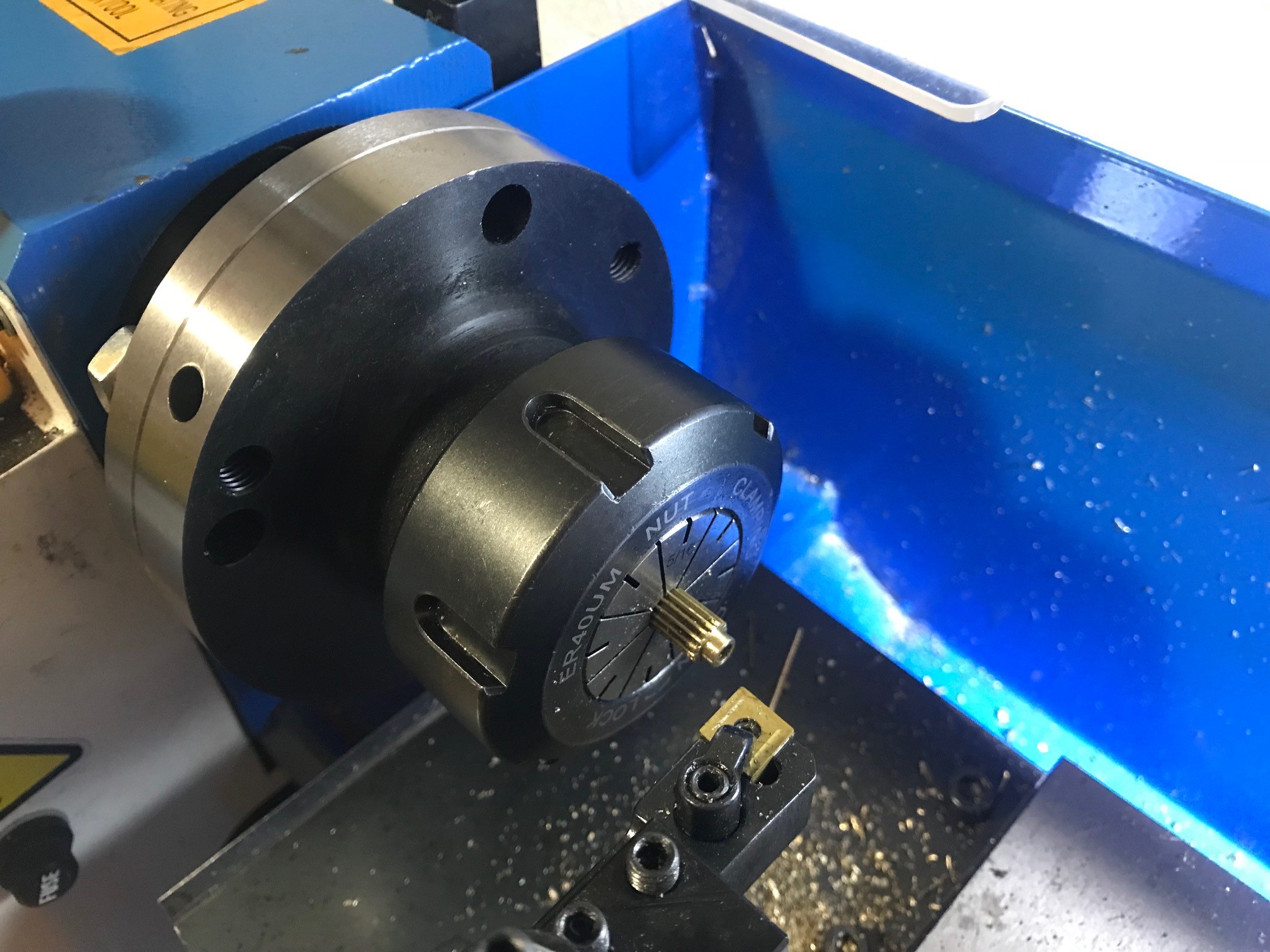

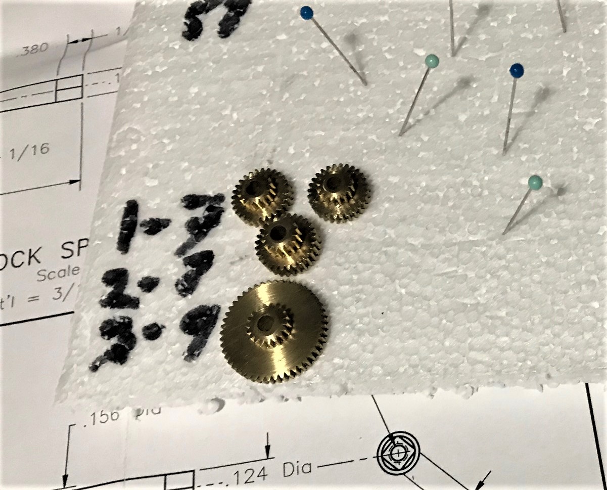

Spent a couple hours after work making a couple of the gears.

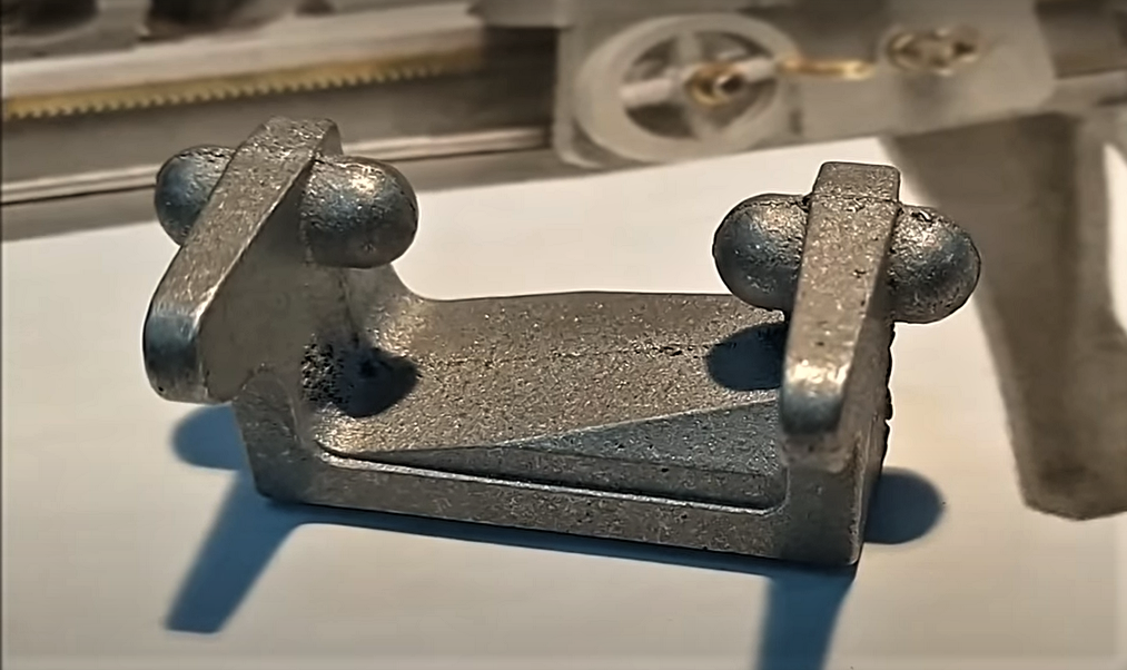

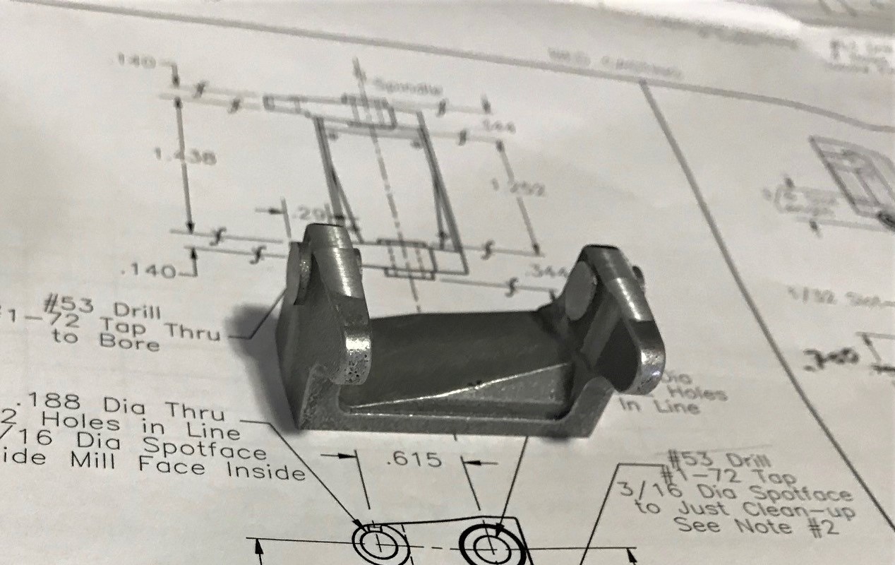

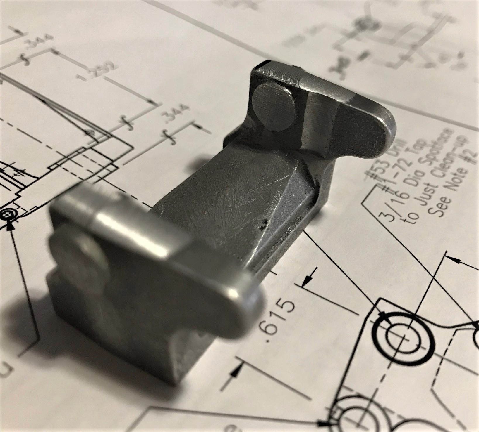

Did a little work on the headstock prep. I only made one wrong move on the mill X handle, as you can see. Luckily, it was not in a critical condition area.
