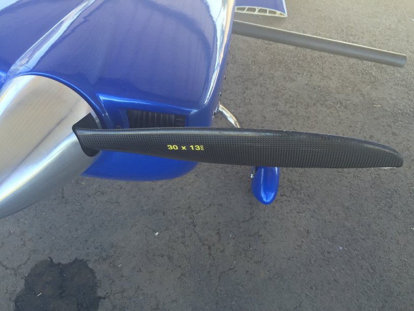

I purchased this prop brand new. 30 x 13 EVO prop. I used it on an IMAC airplane with a 170 cc engine and stock muffs. Worked well.
I upgraded airplanes, and had this laying around. I flew it for maybe 20 flights or so. Never a nose over or a prop strike, never involved in a crash.
OK, prop was just collecting dust, my buddy needed a prop, so I sold it to him for 80 Dollars. He competed in 3 competitions with it,. He has put over 40 flights with this prop.

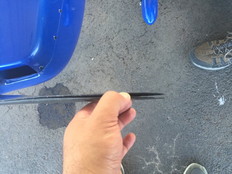

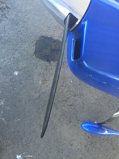

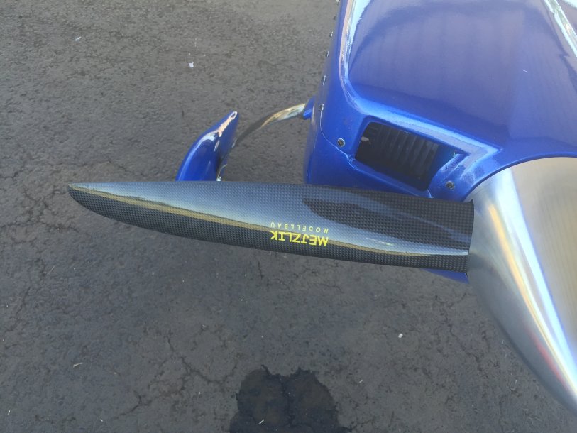

Brings it back in, and we start to inspect it, I immediately noticed this....
SO , it looks like it delaminated on one side. Good thing my buddy immediately brought the power down. I could imagine, had he throttled up again, that one side would have flown off, maybe hitting the wings or the stabs/fin, then it having only one prop on, would have created incredible out of balance, that would have made the nose shake so much, could have damaged the motor-box!
But of course none of this happened!!
We were very lucky.
Ok, someone suggested: Maybe the prop hit something during transport or it was tapped.
Someone else said, maybe a rock on the ground (do not believe so because if you inspect the prop blades, not a single chip)
I think, maybe he hit a Louisiana bug (up ion the air) that was maybe bigger than most?
