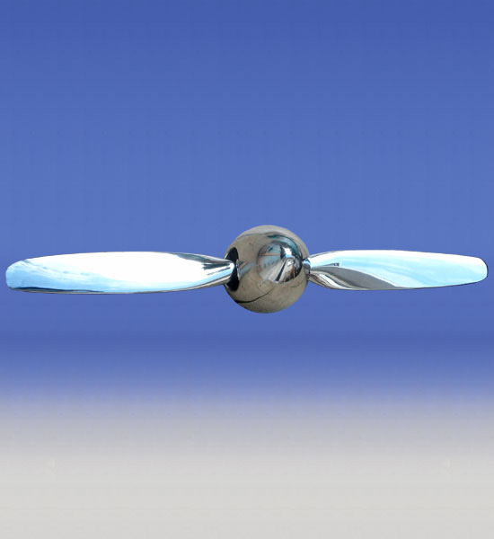

Keeping in mind "insurance" mostly decides what we get to do but the no metal prop rule IMO is way out dated. Even though I do not fly scale it would be nice to do something that you do not have to have as "static display" but functional .
This prop would be very nice on this plane.....
If I ever get around to painting my project airplane, the prop and spinner will both be painted chrome. It actually looks more like polished aluminum which is perfect.
