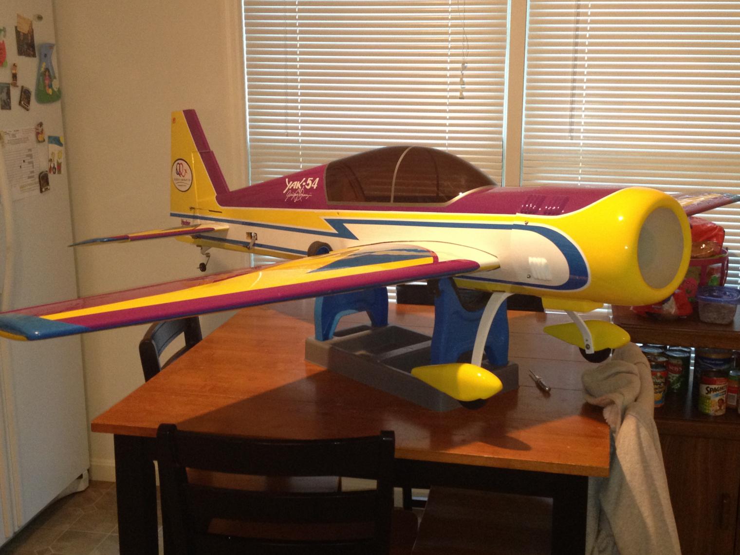

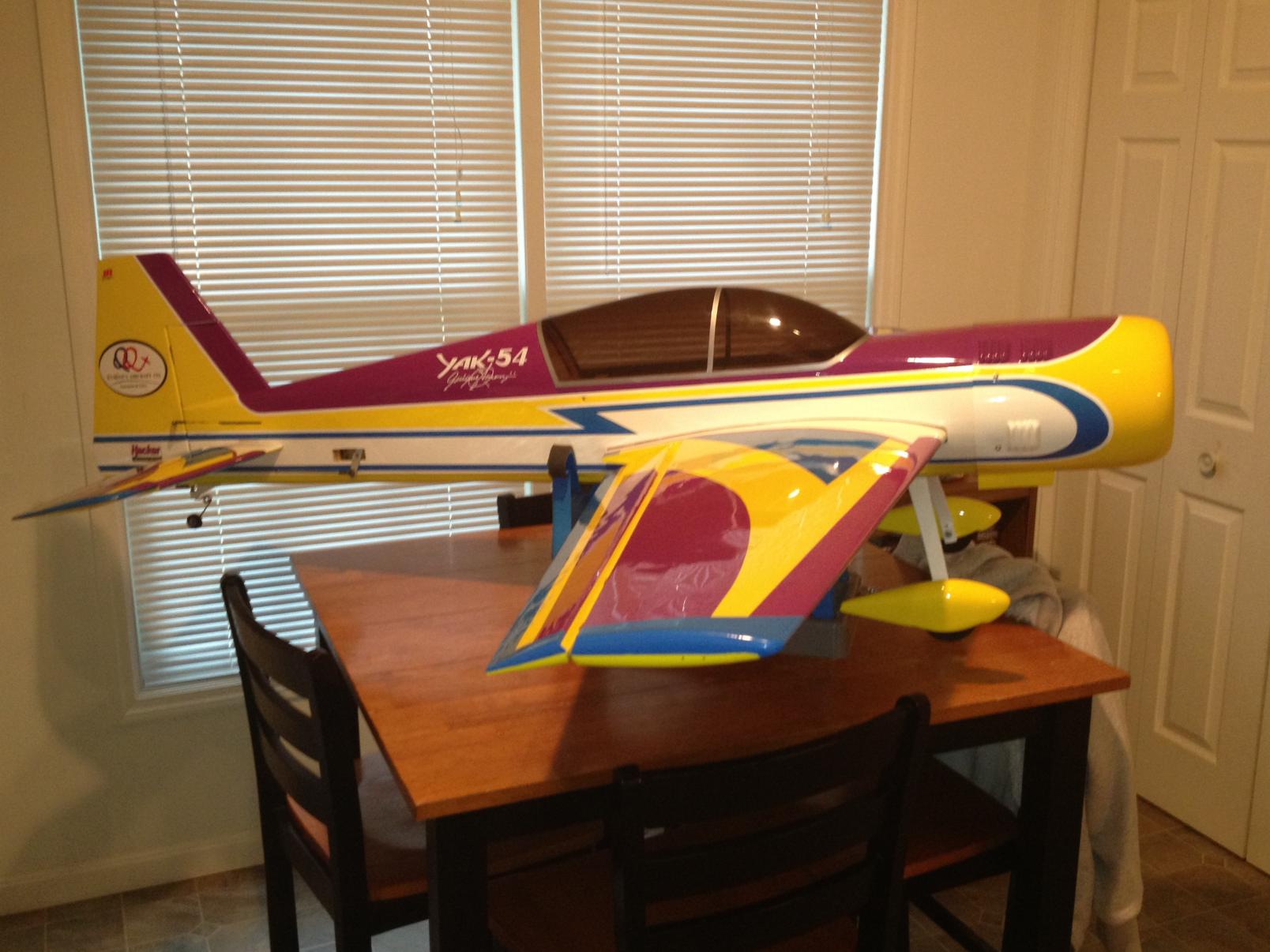

I just bought this plane today and want to set it up on 8s not sure what motor to put on it the guy i bought it off of had a gear box on it plane is in good shape has been electric all of its life any thoughts on motor/esc combos i was going to run separate rx pack but could put bec on it
thanks Ben
