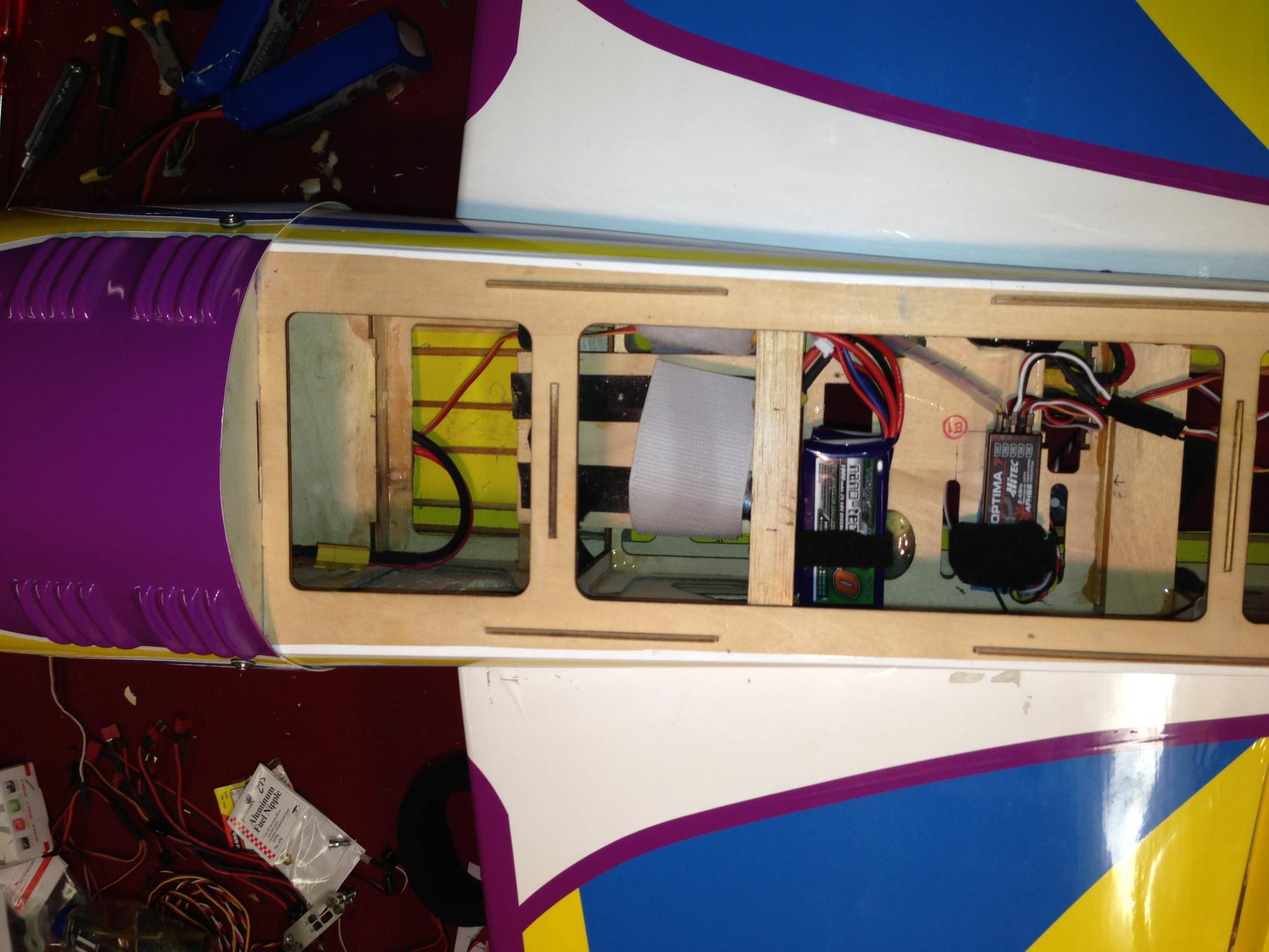

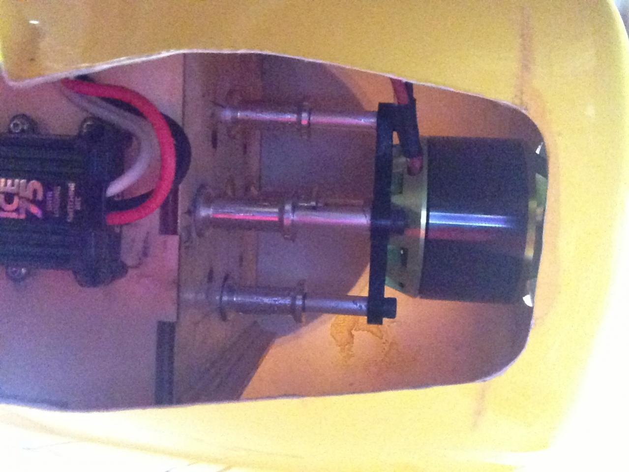

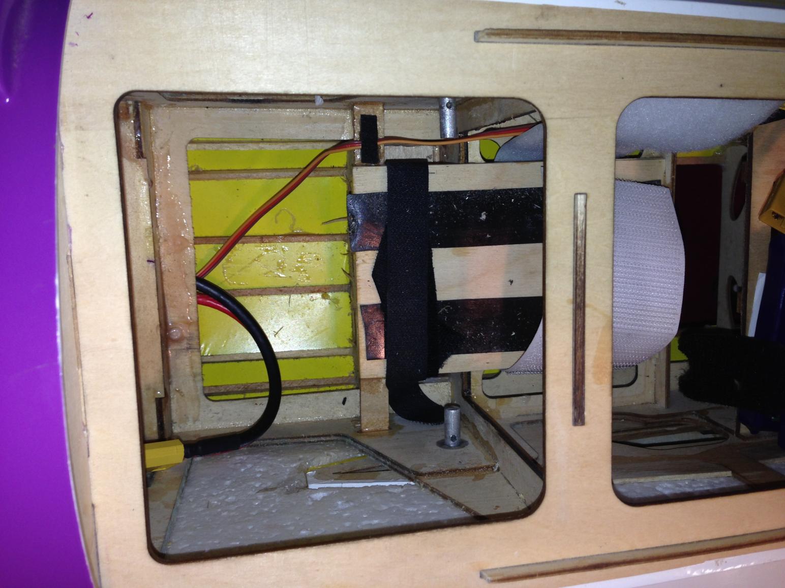

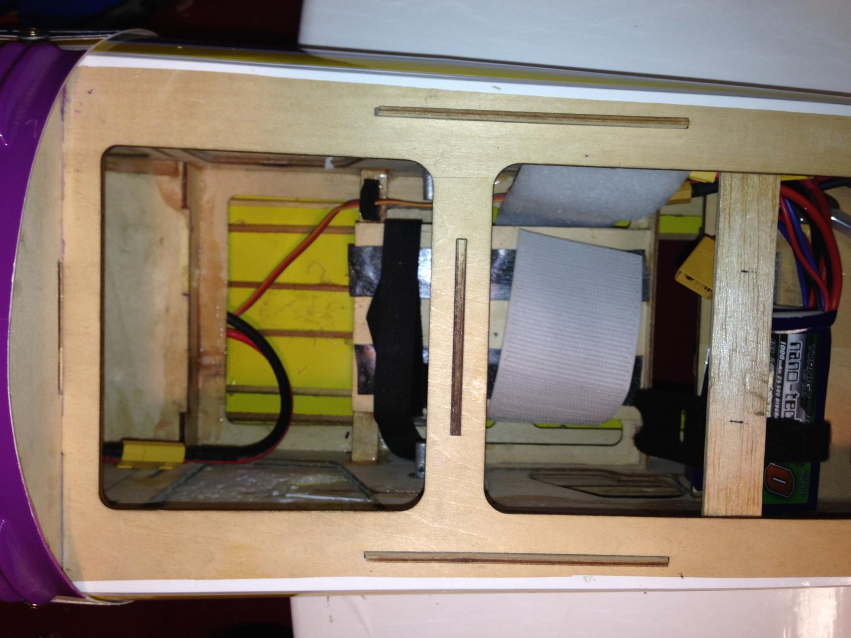

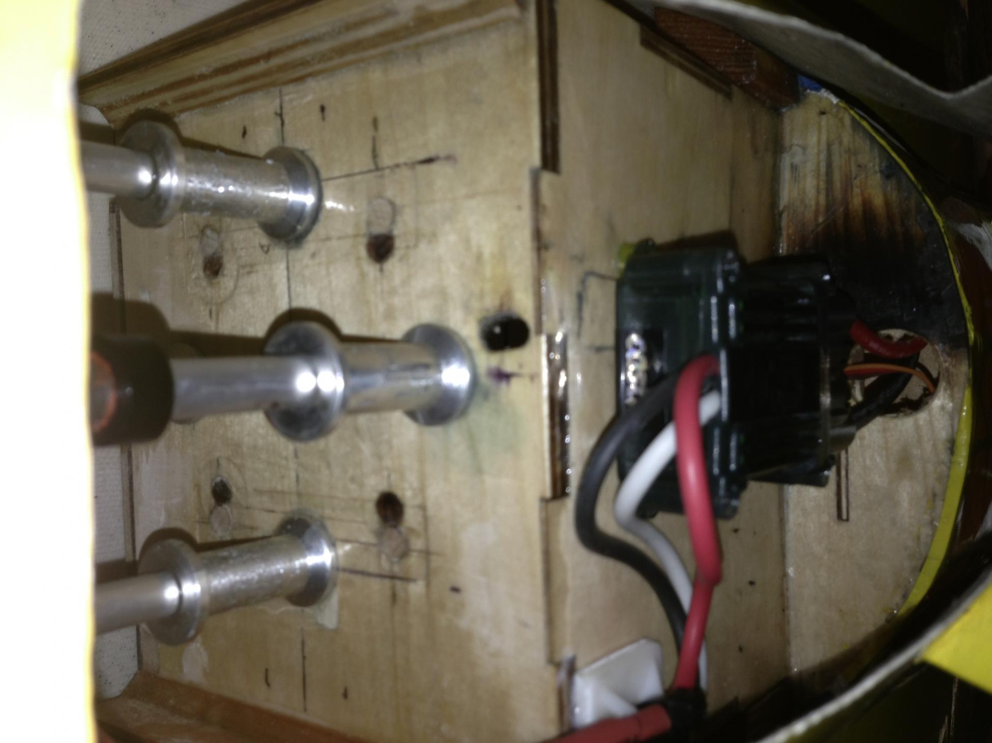

Ill get some pics for you, I didn't have to build anything on it, it is a used plane and was originally powered by a glow engine. I'm lucky it balanced ok so far cause there's not much of a tray to move the batts around if its tail heavy ill need to add a piece of ply to bridge the gap between the tray and motor box.
Here are a few pics. I had the cowl on so the pics are taken from beneath the plane looking up into the cowl

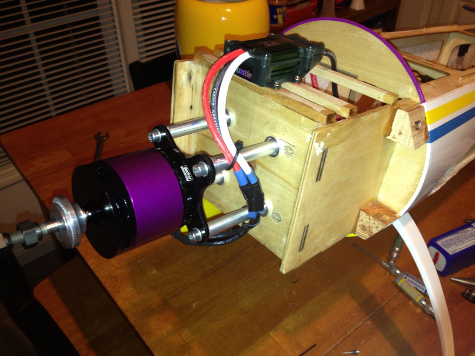

image.jpgJamesrine I got my motor and batteries this week and I had put them almost all the way to the nose to get it to balance I might be able to be half inch off the fire wall to be in the middle of the suggested cg and this is with 2 sky lipos 5000 mah 30 c packs 4 s of course I think my hacker is heavier than your tacon so you may have to build tray all I did is put light ply down also I mounted my esc on top of motor box as far foward as I could I don't know if I'm going to run bec or use the one in the ice 100 so that may ad some weight to nose if I ad one
I did get to maiden mine but had a problem with one of my batts it was sagging and hitting lvc with anything over 1/2 throttle but I did fly for 1-2mins and it seemed ok I didn't get to go inverted to check the Cg but it felt good and landed so easy so the Cg has to be close I ordered some gensace 4s4000 60c's for it. There's got to be a reason why we are so far off in batt location , I am also using 2 2s1000's for the servos and they are mounted a couple inches in front of the spar. Oh the only other thing is the motor came with a aluminum cone the goes on the prop adapter as a lock nut it seems pretty heavy for aluminum. Ill get some pics tonight I borrowed some batts from a friend to check and make sure the other batts were the problem. Hopefully ill get a chance to check it tonight.
