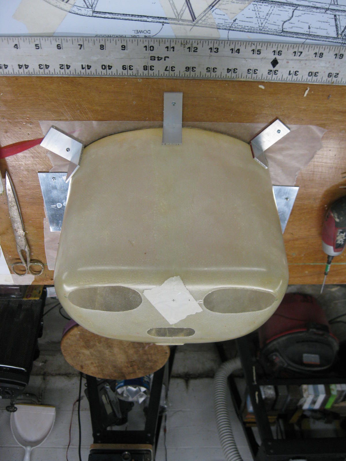

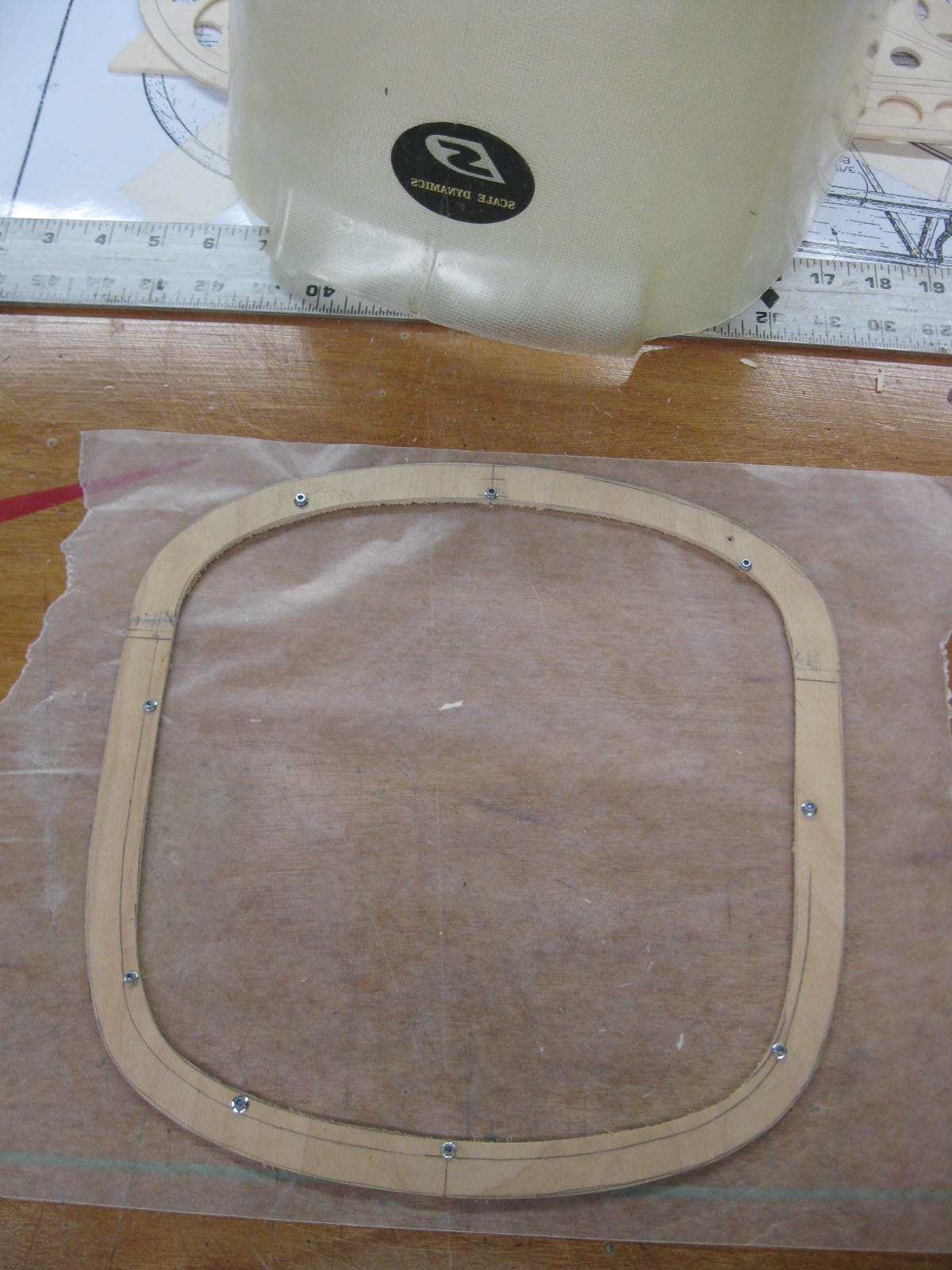

Cut out the former for the cowl and glassed it in with epoxy and 6 oz. bias cut cloth. Boy how things have changed, the plans show the former being 1/2" thick with a 3/4" firewall behind it. The former used was 3/32" thick. The cowl shape was quite a bit different from the former on the plans, it was sitting on the shelf for 2 or 3 years, maybe gravity got to it. it is pushed into shape now.
Haven't decided how the cowl will be held on yet.
