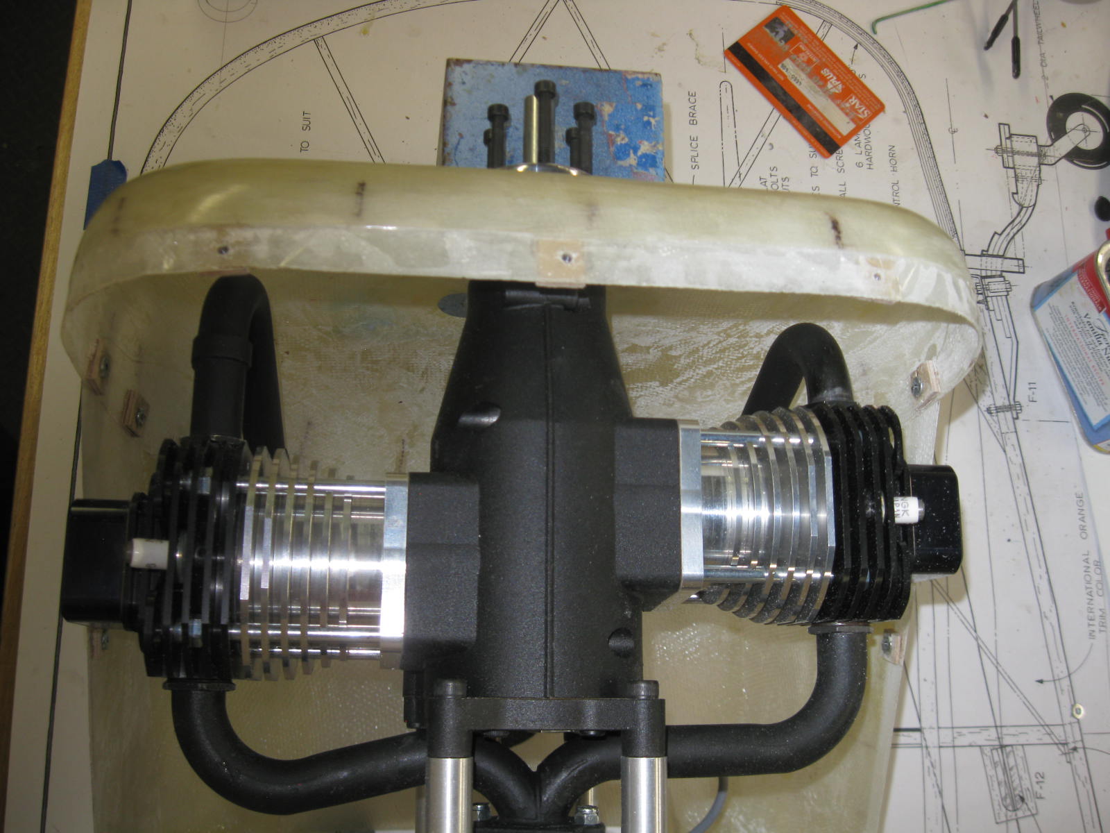

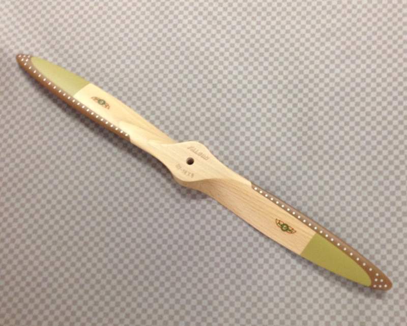

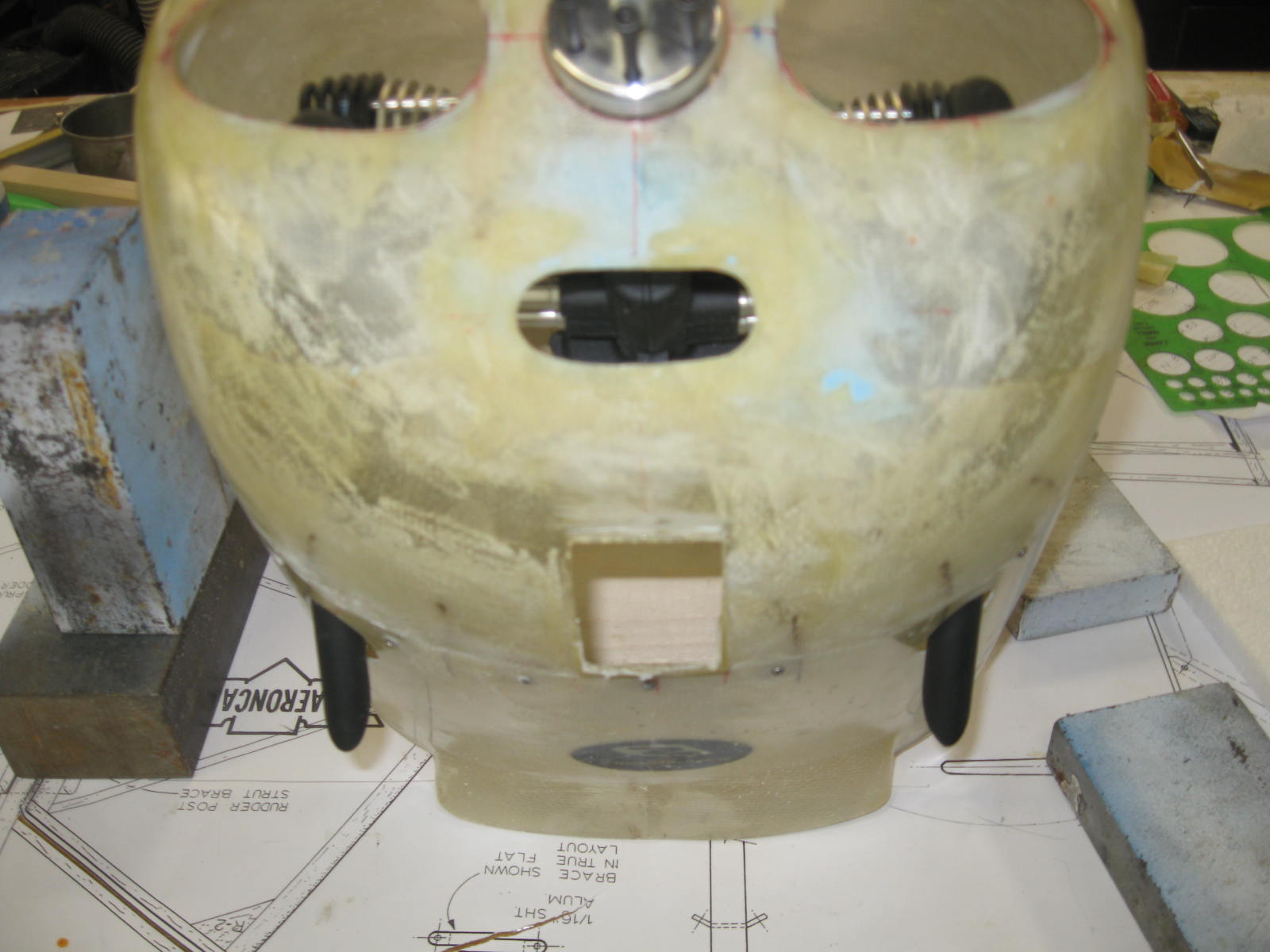

Both exhaust pipes are identical so the pipe for the left side was lengthen 7/8" to match the right side, 3 1/2" extensions were added to both. The pipes exit in the scale location and are vertically coped. I ordered a 26"x8" Falcon prop to dress the front. My wood is scheduled to deliver tomorrow so work begin on the fuselage, stab and rudder but as Snoopy1 has said the weather getting nice outside so might table this for a while and finish work on the Byron Glasair and a Cessna float plane.
