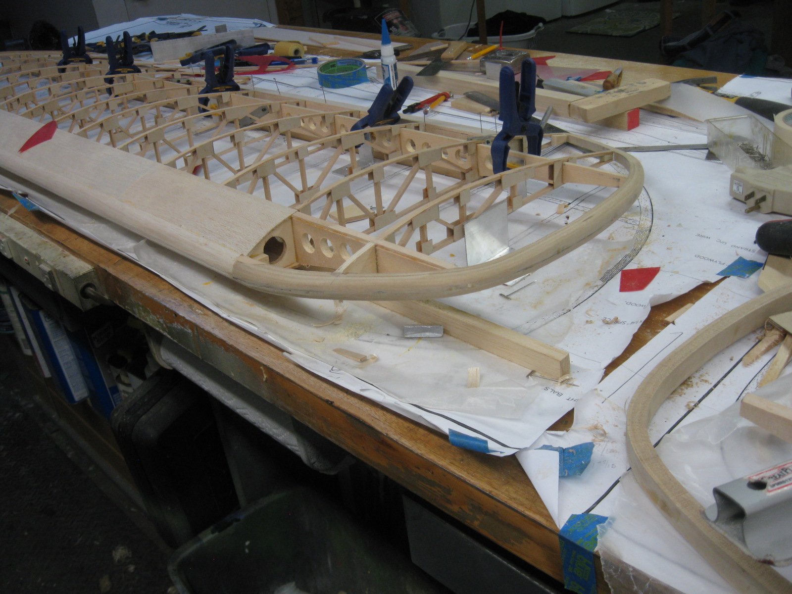

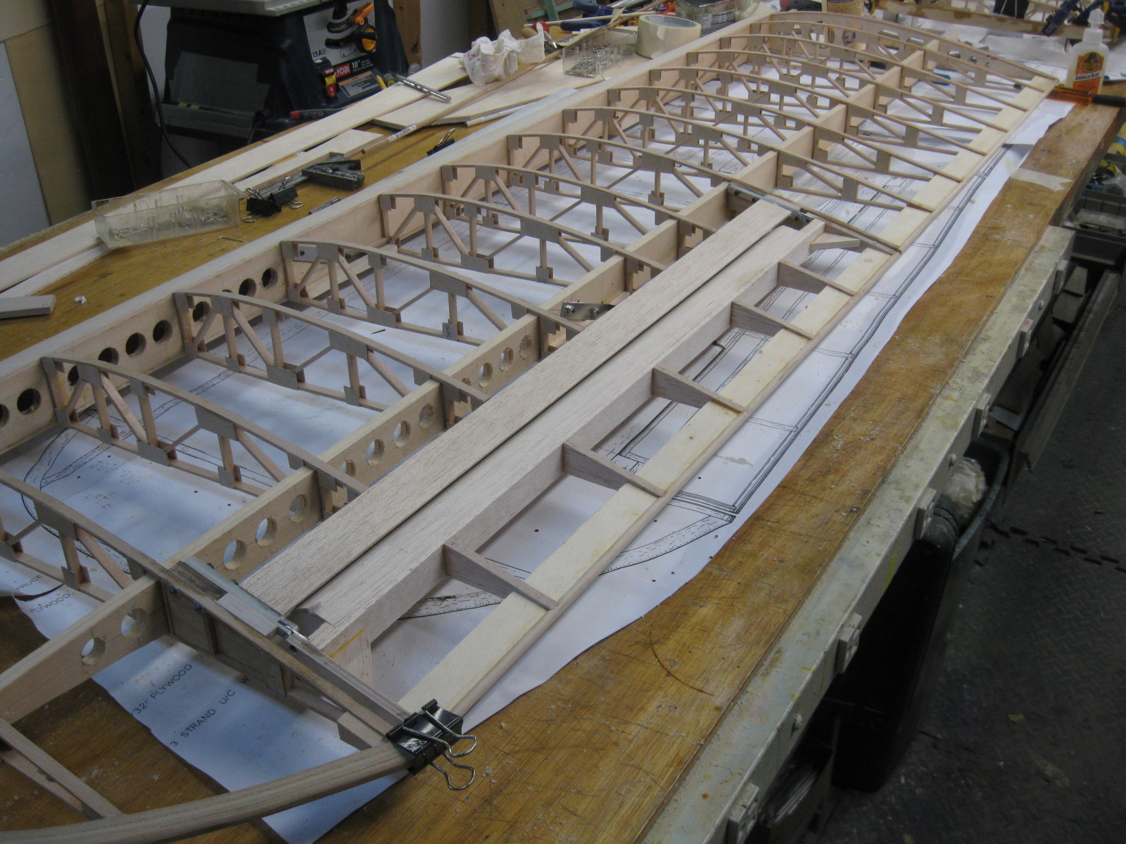

Up to this point I've been trying to keep both wing halves at the same completion level, I just realized we have a club meeting on Monday evening and hope to take one wing to the meeting for "show and tell."

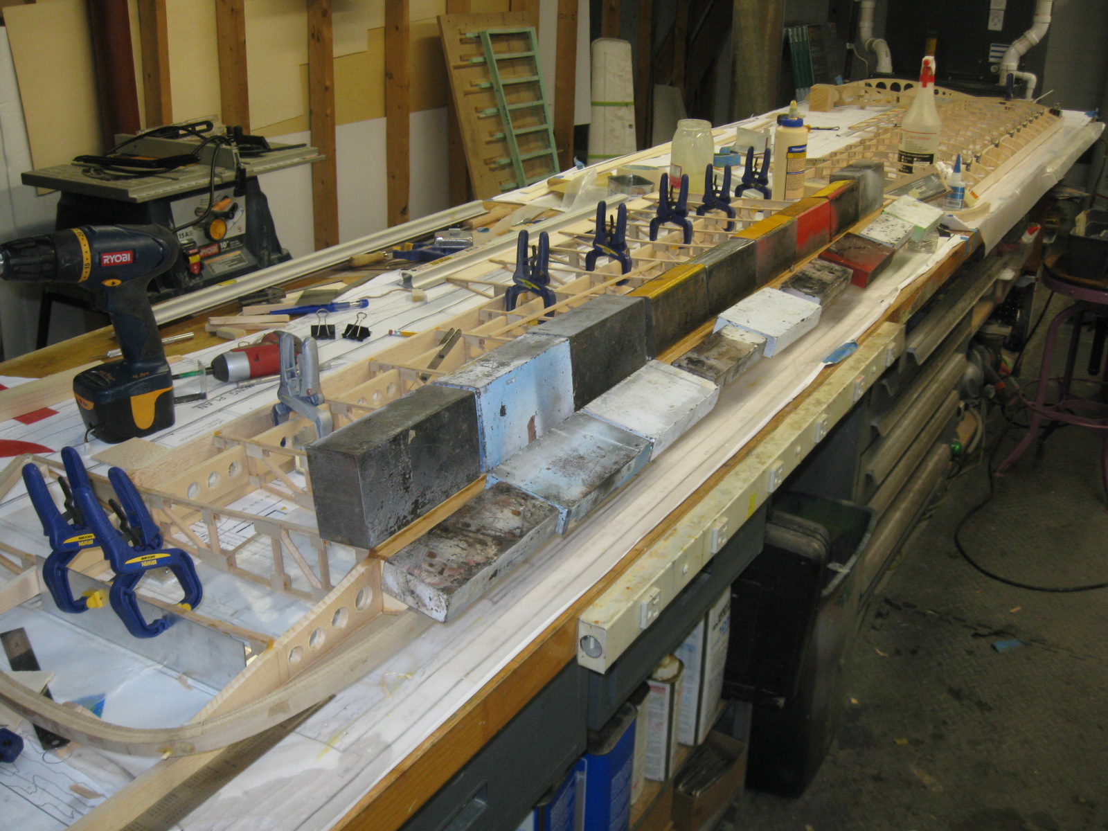

I'm working on the left now, I installed the top leading edge sheeting, I got the sheeting from National balsa, I didn't order any extra and the 1/8" sheets they sent were a little stiffer than i would like. The stiffest sheets are going on the bottom since the bend is less. For the top, Titebond II was applied and the sheet was weighted onto main spar. Ammonia was used to bend the sheet and pin it to the 1/4" balsa leading edge. There's about 60 pounds of weight keeping the wing straight and the sheeting in place.

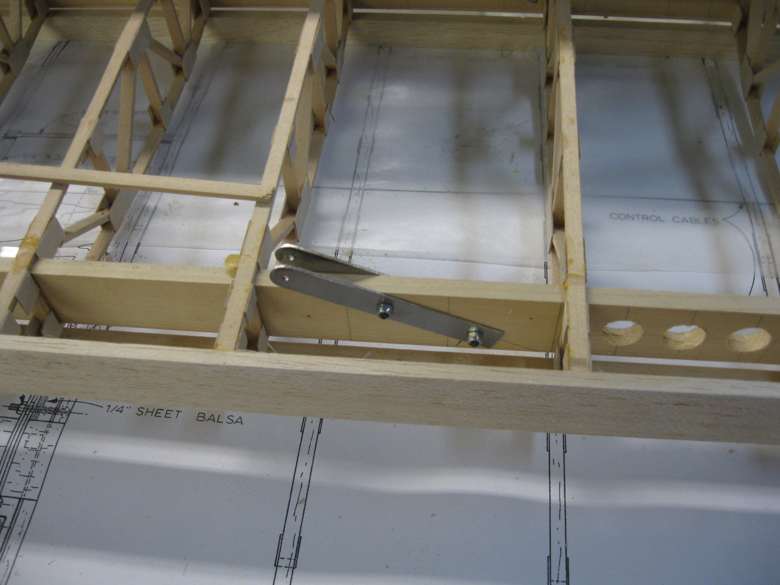

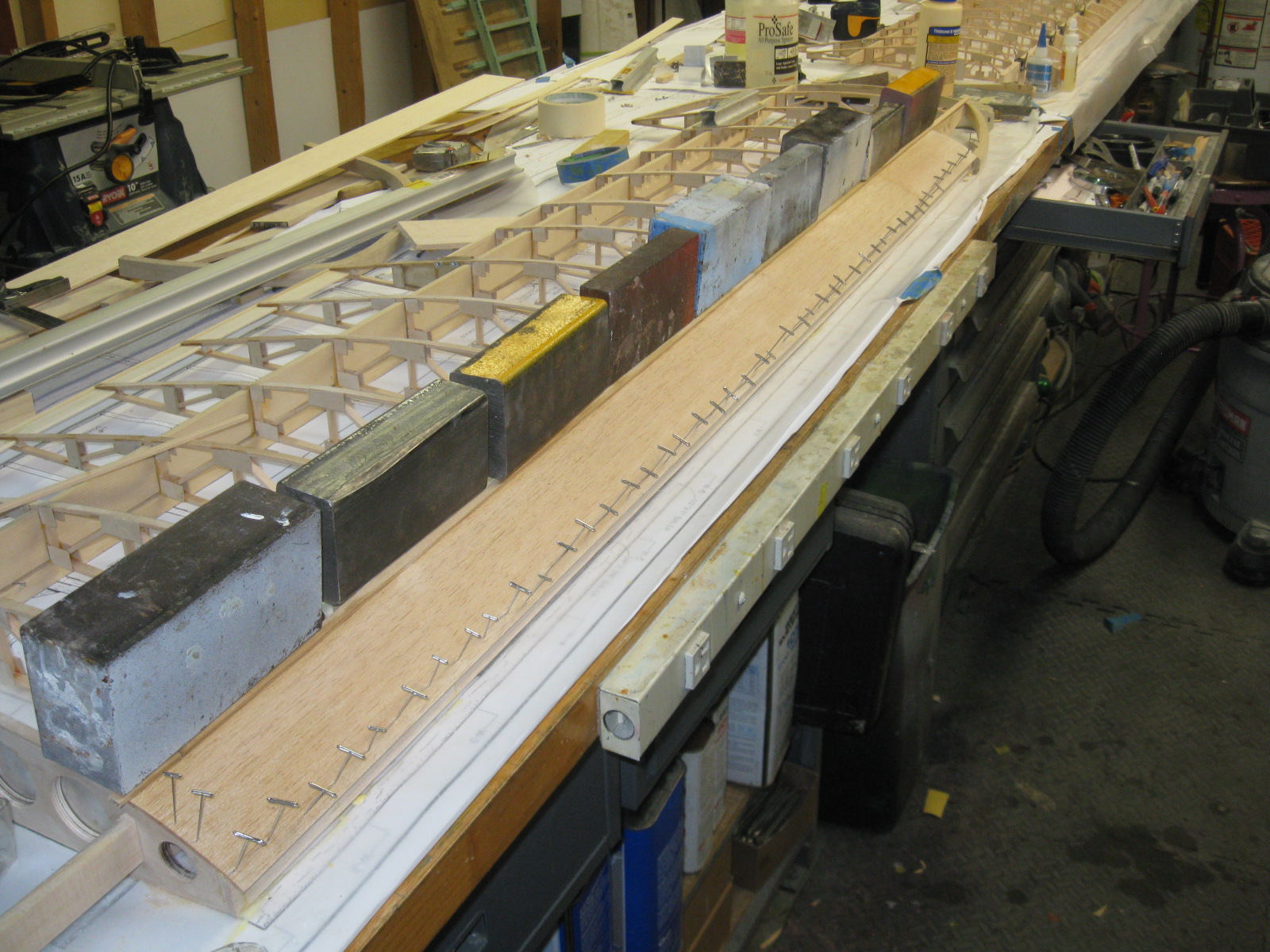

After the top sheeting was dry, the wing was flipped over and the strut and jury strut fittings were installed. Then the bottom sheeting was installed in the same manner, weights were used on the main spar and leading edge. ammonia was used as well. The comment i made about National Balsa was not negative just stating what I received. They only cut the wood and do a great job, I will use them again in the future.

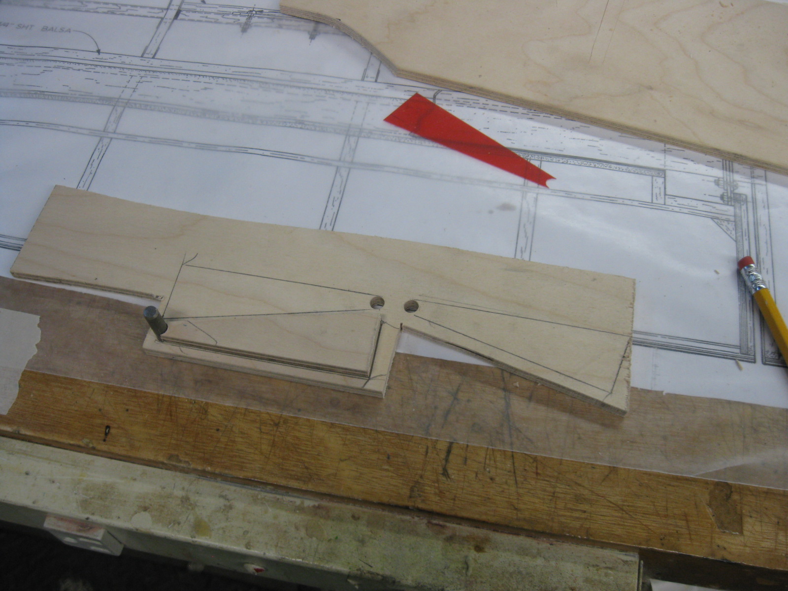

The left aileron is done, took longer than expected. Rather than set up the router table again, the ribs were pre-drilled for the trailing edge dowel then cut out. A 1/4" rod was inserted into the drilled hole, then the cut lines were laid out. The left wing is basically complete, still need to decide on what servo will be used, thinking Hitec D series.
