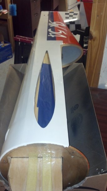

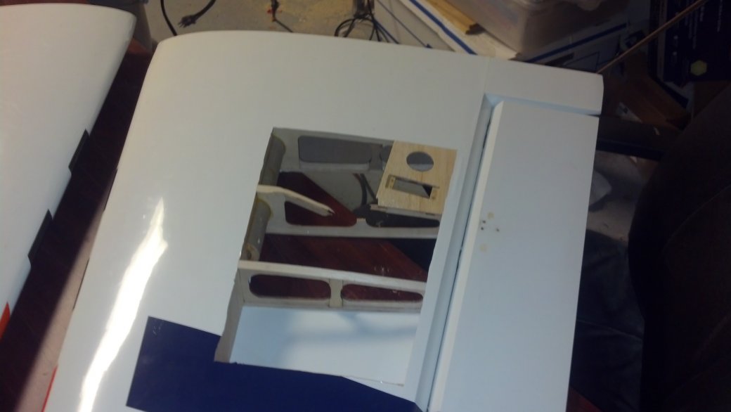

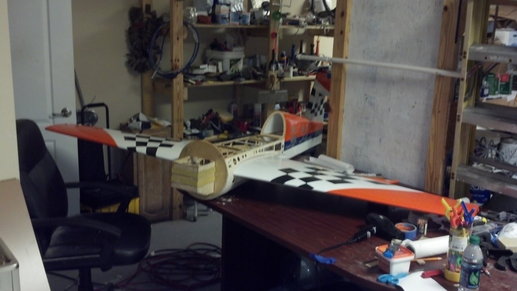

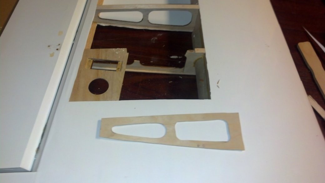

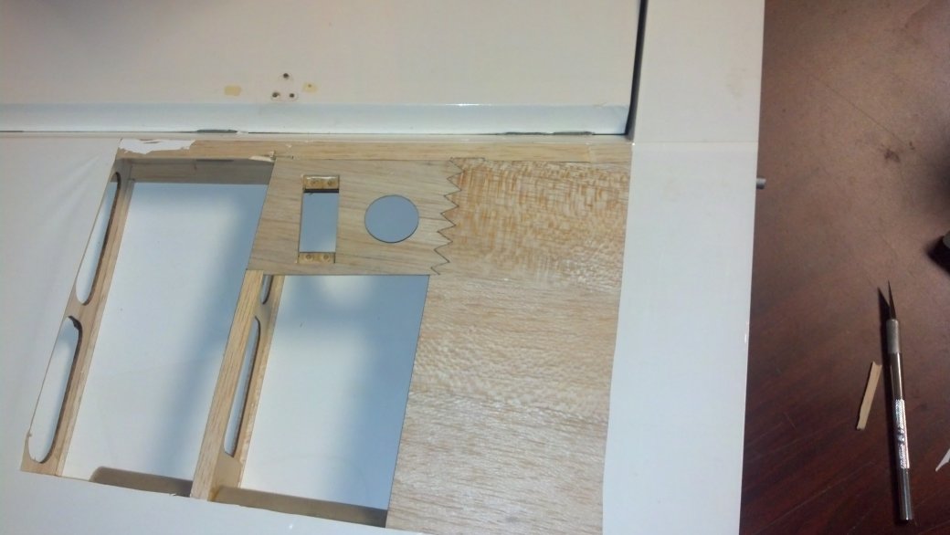

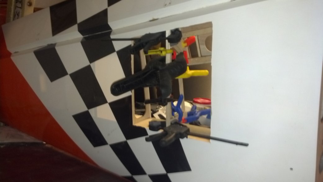

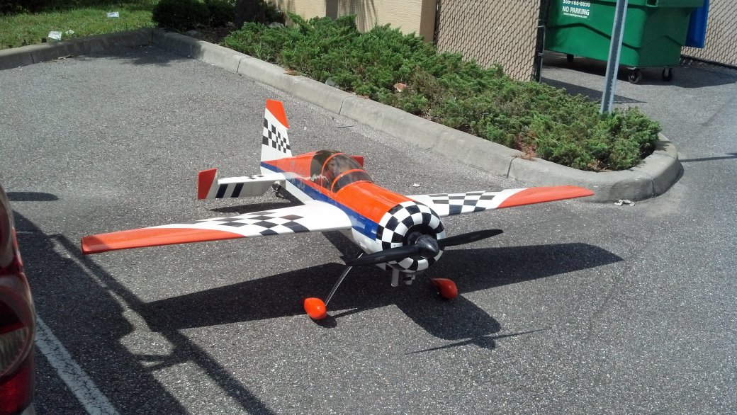

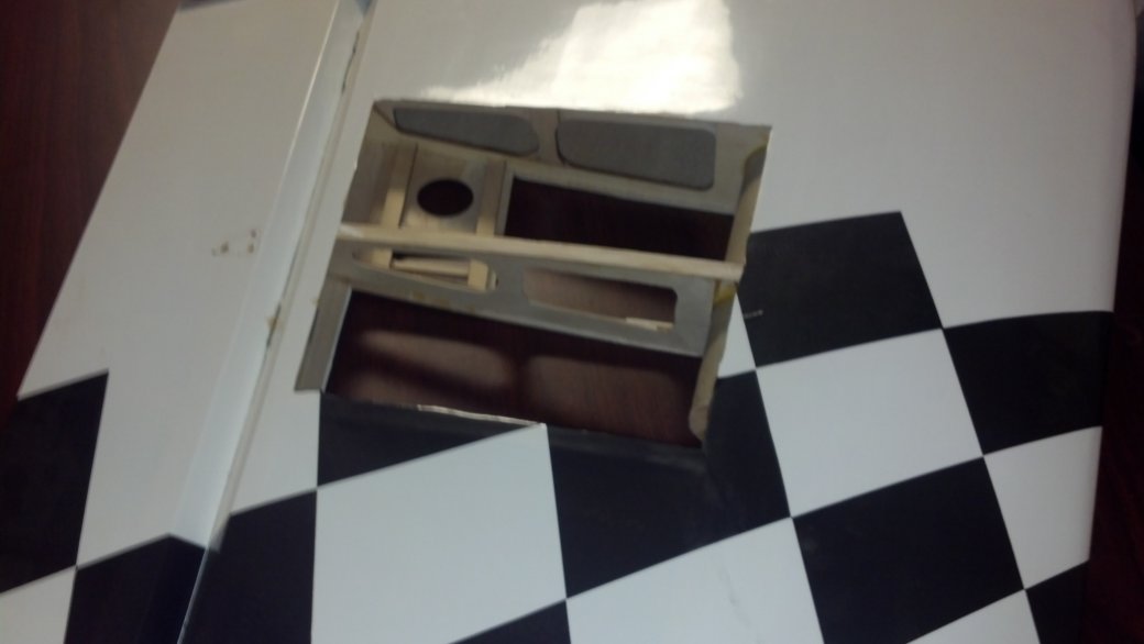

Wings had some broken ribs so I cut some new ones and clamped and glued again. Then test fit the wings to make sure everything was going to fit. Starting to look like an airplane again. :)

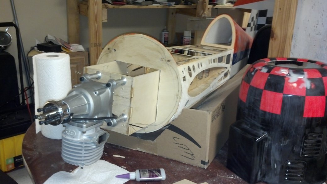

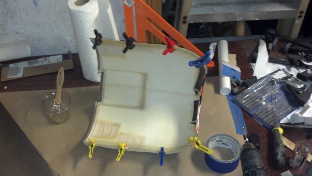

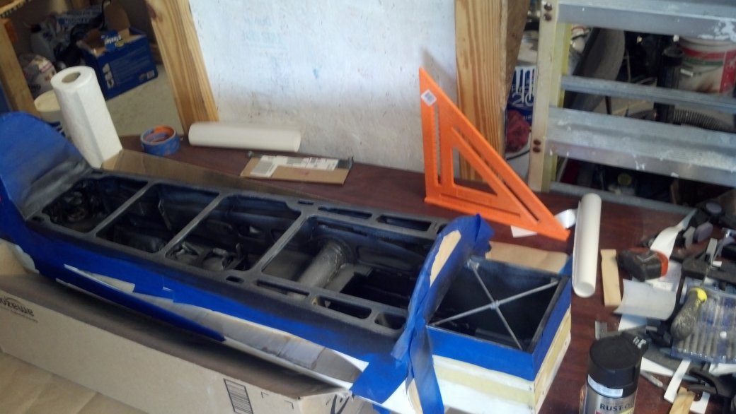

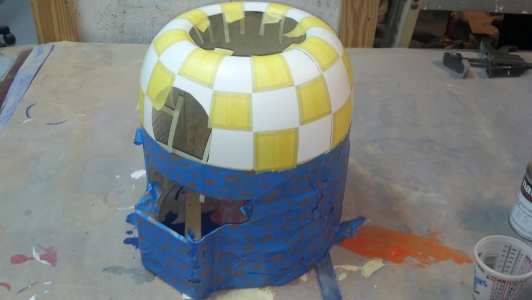

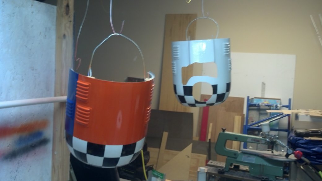

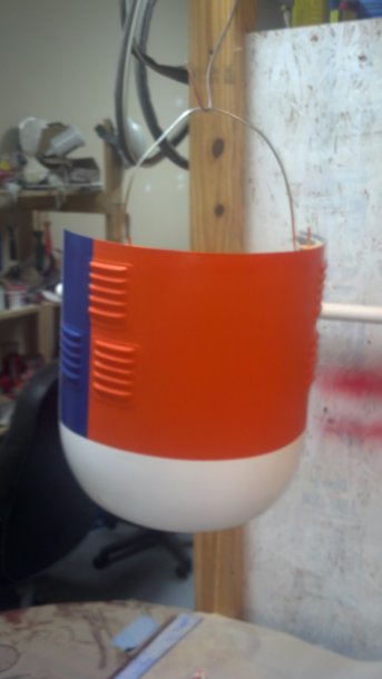

On to the cowl. The only uncut cowl I could find was the wrong color scheme and had evidently been kicked around some. Repaired broken sections with carbon fiber tape on the inside for strength and lightweight body filling compound. Also strengthened the round front with carbon fiber tow. Split the cowl, cut out for engine head and exhaust
and then painted. Checkers on a round cowl are a pain.
