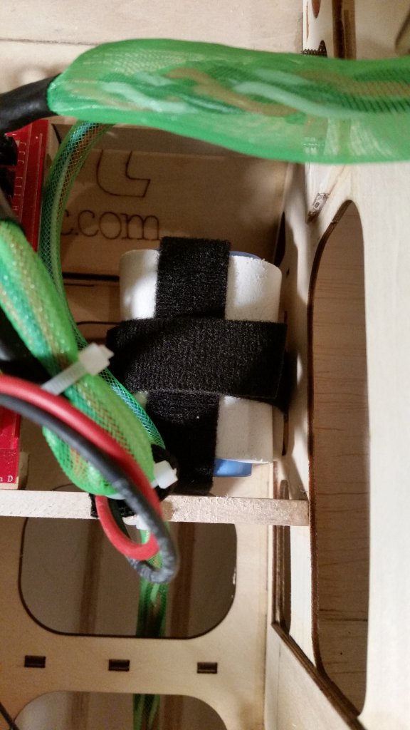

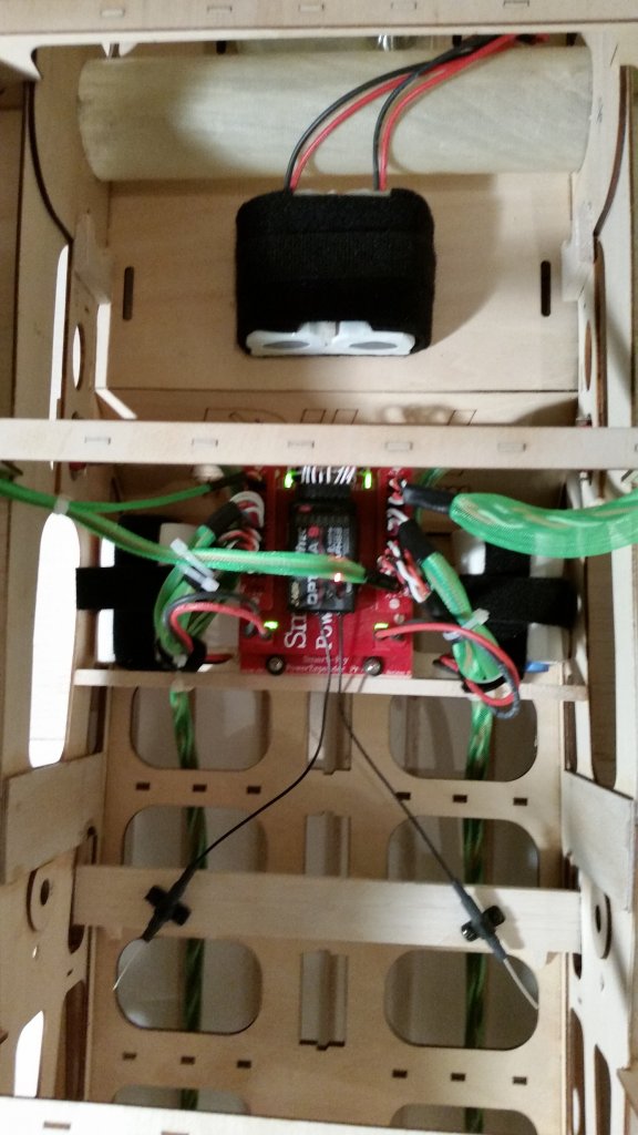

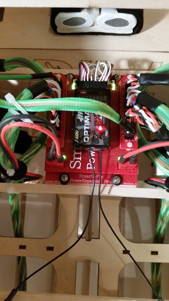

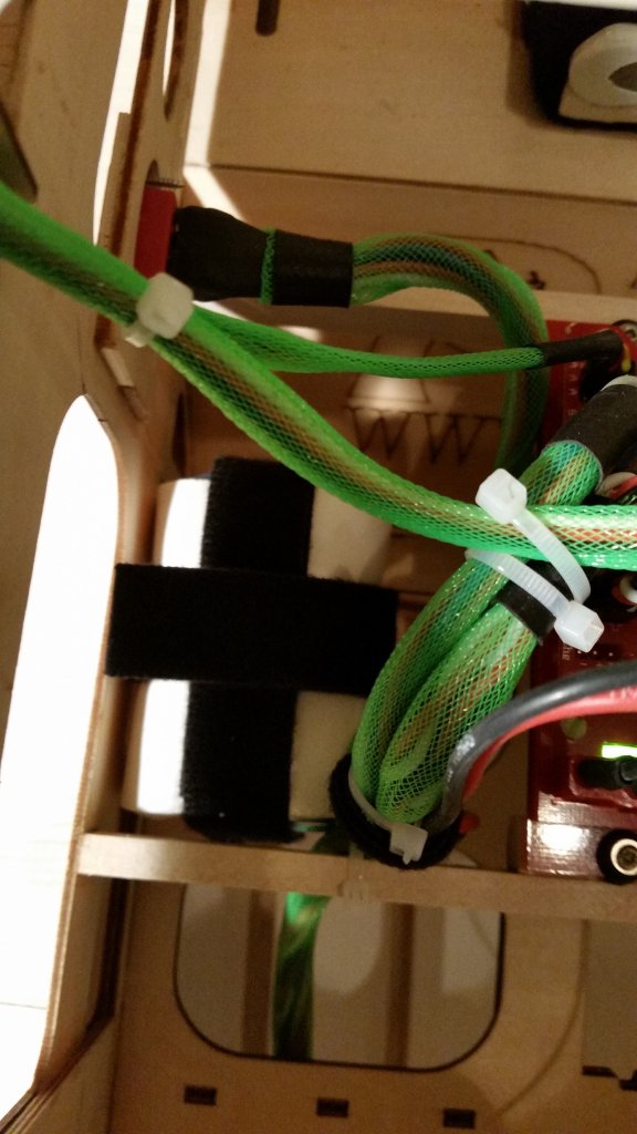

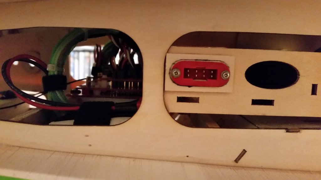

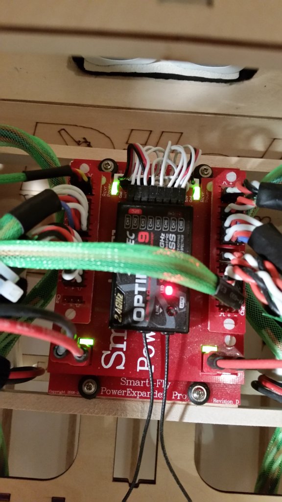

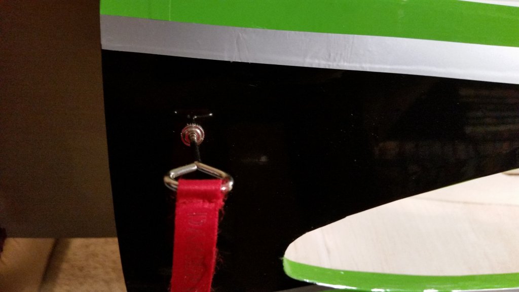

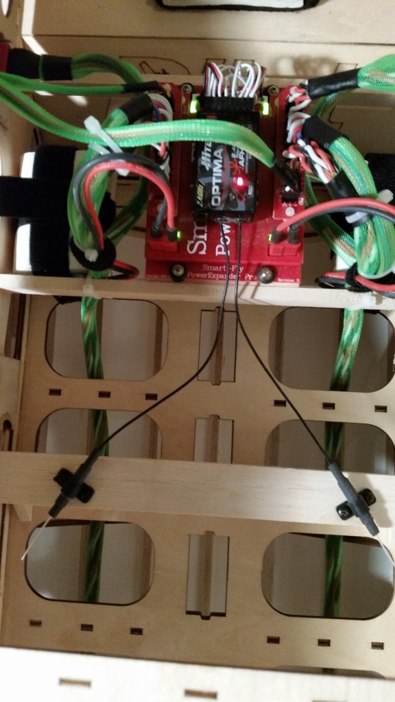

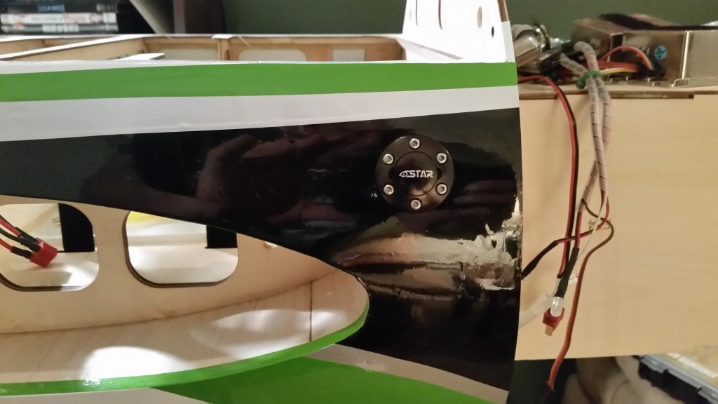

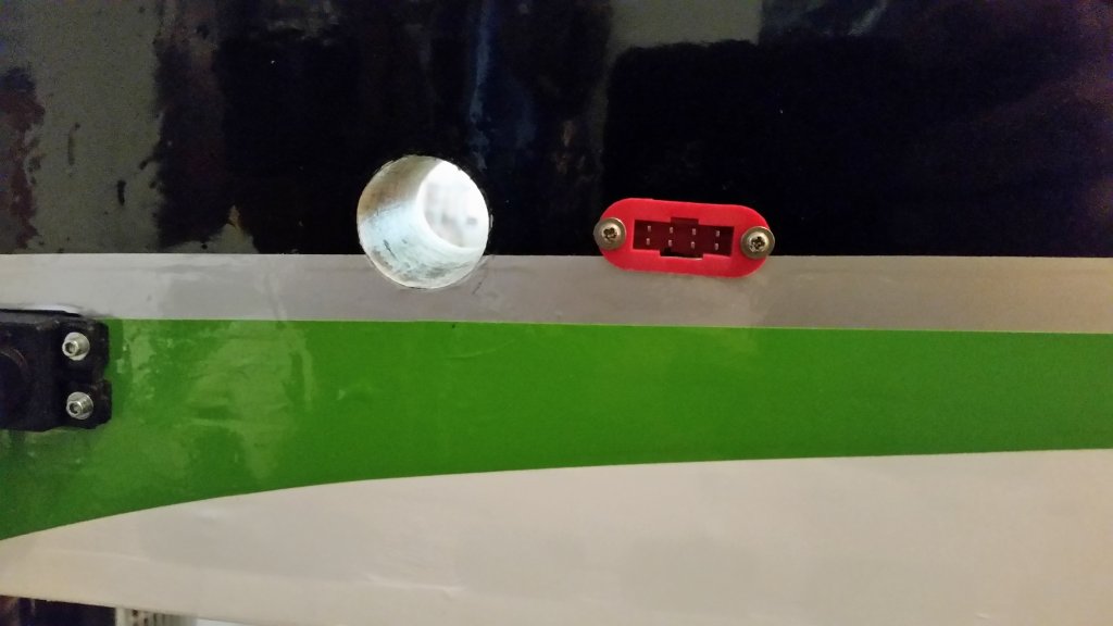

I spent most of the day arranging, re-arranging...then re-re-arranging the electronics in the Yak yesterday. I had many things to consider and this is why it took so long to lay things out to make them fit and look nice at the same time. First to consider was the fact that I "know" I lost at least somewhere around 1.5 pounds off the nose of the motor box due to the one and a half cans of paint that was on the firewall and adjoining structure. Along with the laminated 3" wooden standoff block I built to hang the 210 from when I was an idiot and cut the nose to allow for the originally planned 212 (4) cylinder. Also, the fuel tank no longer sits directly over the wing tube and now resides forward of that like any other new airframe. Next I had to consider the overall construction of the forward fuse as opposed to the original forward fuse. Though they are designed and constructed very similar, there is enough of a difference that I was afraid of the nose becoming way "too" light. Remember the can tunnel was shortened and so therefor that extra wood and construction is no longer present behind the "CG" as it was with the first fuse. Still, the extra weight of the wood from the motor box sides that are now "uncut" will help in this. I had to move the ignition batteries back quite a bit as there is no room forward of the fuel tank as in the original fuse. That small amount won't really be terribly significant by itself. But along with that, I still needed to offset that weight while also bringing a little more weight to the nose. So, the main receiver flight packs were placed forward about a good 10". The Smart-Fly Power Expander Pro was also moved forward about 6". I originally wanted to use my 5200mah 7.4 LiIon flat packs, but really couldn't figure out a way to secure them from any movement. Sooo....I chose to use my new "square" packs instead. Same-same on the batteries, just different configuration. Ah ha! That is going to work out nicely. Still maintaining my normal Rx. #1 on the left side of the fuse, Rx. #2 on the right side. (I use this configuration in all my planes to aid in my anal "charge/repair/flight" logs. Once I had everything laid out and was satisfied with their perspective location, it was time to secure everything down and fire it all up and do a functionality test. I didn't like the original placement of the accessability of the ports on the Smart-Fly, so I rewired the rx. to Smart-Fly and am now happy with location of all servo signal leads. Rudder servos in and operating perfectly, Smart-Fly Pin and Flag fail safe in position, Fuel tank tied down, Fuel filler cap installed, Multiplex harnesses in place and antenna leads secured, and rails built for Smart-Fly to rest on. I think it will work good. I was a tad tail heavy with the original fuse and expect it to still be just a tick tail heavy. But that is ok. I don't really like a perfectly neutrally balanced plane for the type of flying I do. Unless it is my Sukhoi. But then I don't toss it around like the others. Yeah, right....LOL.
Here are a few photos of what I got accomplished yesterday.
About all that is left is to hang the 210 on its new firewall, finish up the top of the motor box and install ignition and mount ignition LED's, install throttle servo, install main gear and tail gear, cowl, drill and install prop and spinner....and the fuse will be done. I still have to recover that darned right wing from the landing gear going through it, but that will not take long.

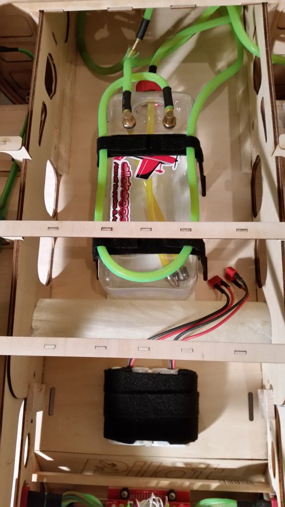

I just noticed this...
Make sure you get a piece of brass tube inside of that pickup clunk in there, otherwise it might invert on you!!
20160915_215905-jpg.88333
Thanks for the heads up Tanner. But honestly, I have never used a brass tube in any of my tanks. I do understand the logic behind it. But notice the "klunks"? They are the Sullivan Super Klunks. They are quite heavy and have the larger "draw" hole in the center for feeding hungry big engines. I have actually been using them on everything including my 100cc setups. I'm sure it is possible the klunk and carb line "could" fall to the front of the tank in a downline. If they do, then my klunk is always in fuel. I have not once found upon disassembling for the day, not one in the front of the tank yet. Even when the big Yak came down with a dead stick that subsequently damaged the front half of the fuse, once pulled apart the klunk was right where it should be.
