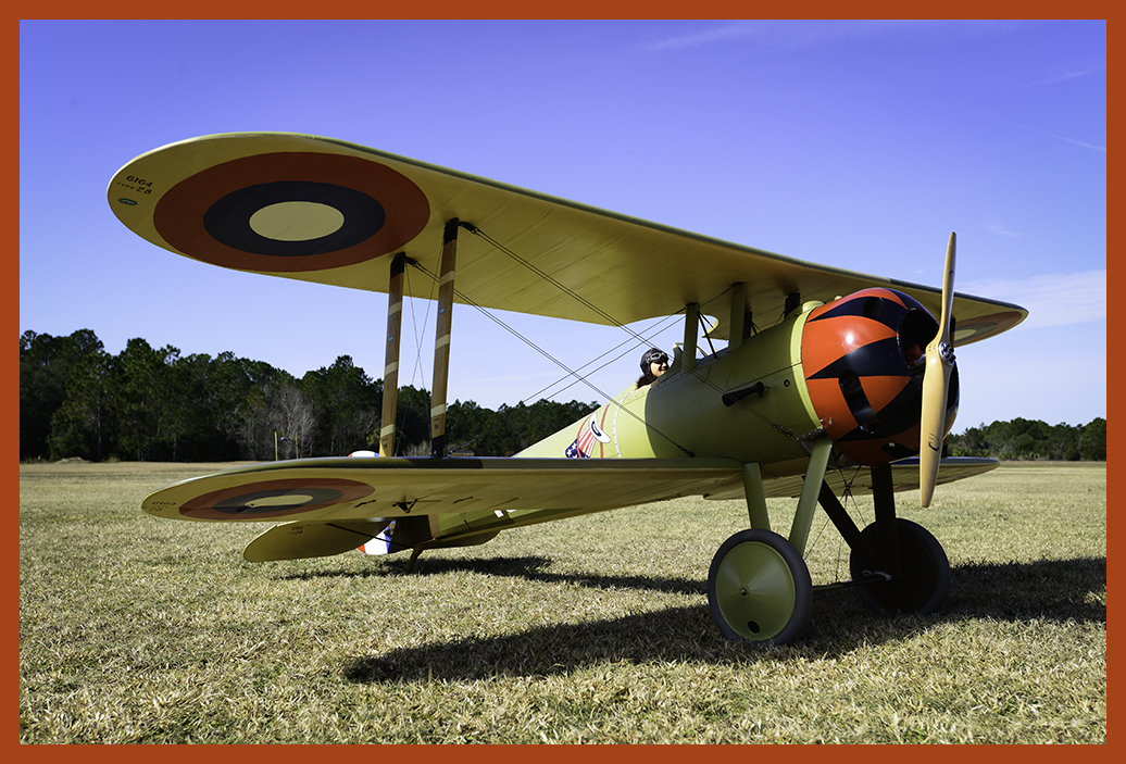

geezer.jpg By all means get into a WWI build, a word of advice, WWI models are a lot like potato chips, it's hard to have only one. I have a 1/4 scale SE 5a and it requires more power that one would suspect to fly well. A well broken in G38 or G 45 is nice depending on the amount of detail added. Mine weighs 23 1/2 lb and has lots (of detail). lol The airplane in my avatar is a 1/3 scale N28, weighs 38 1/2 lb and uses a DA100.
