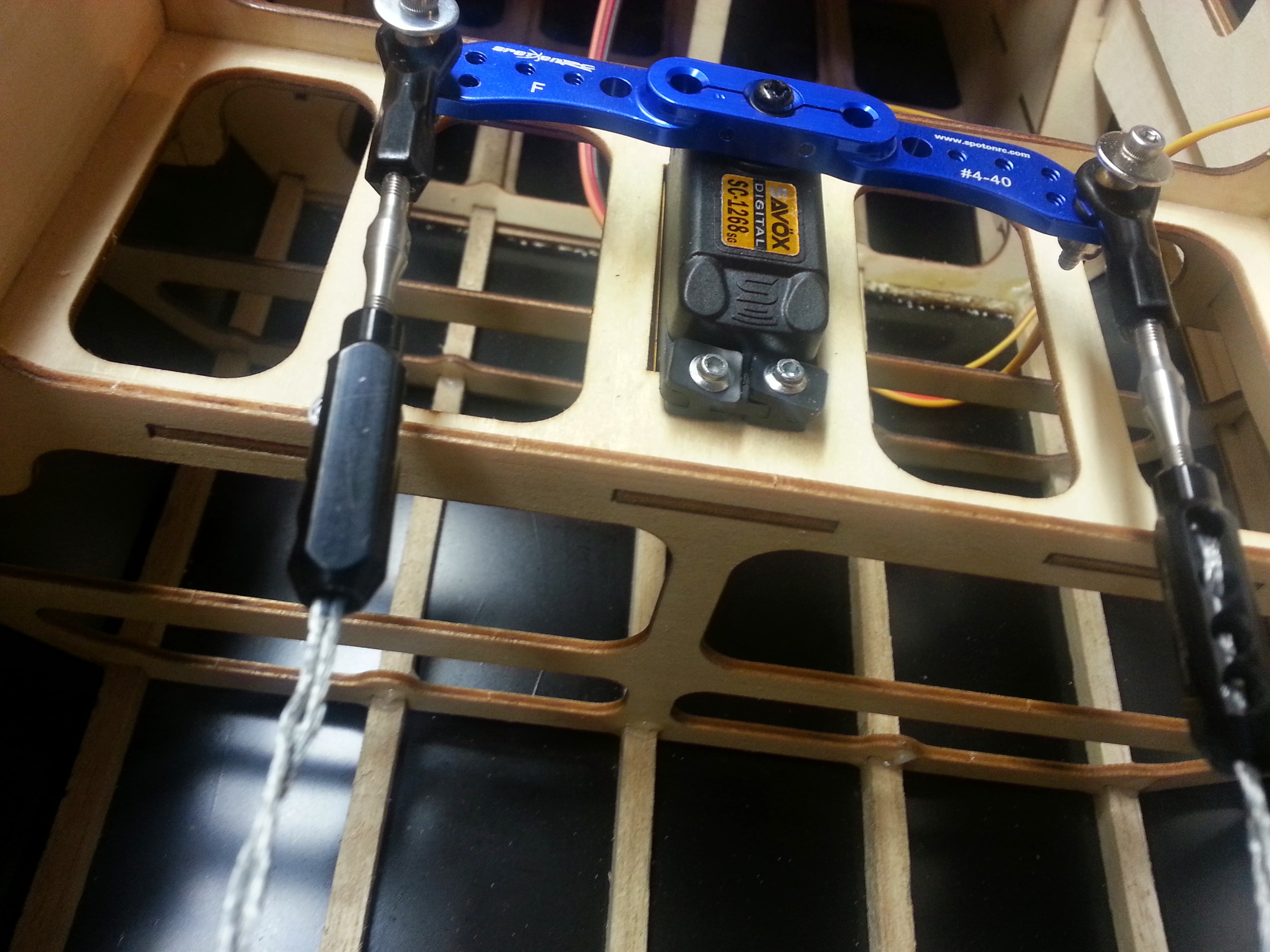

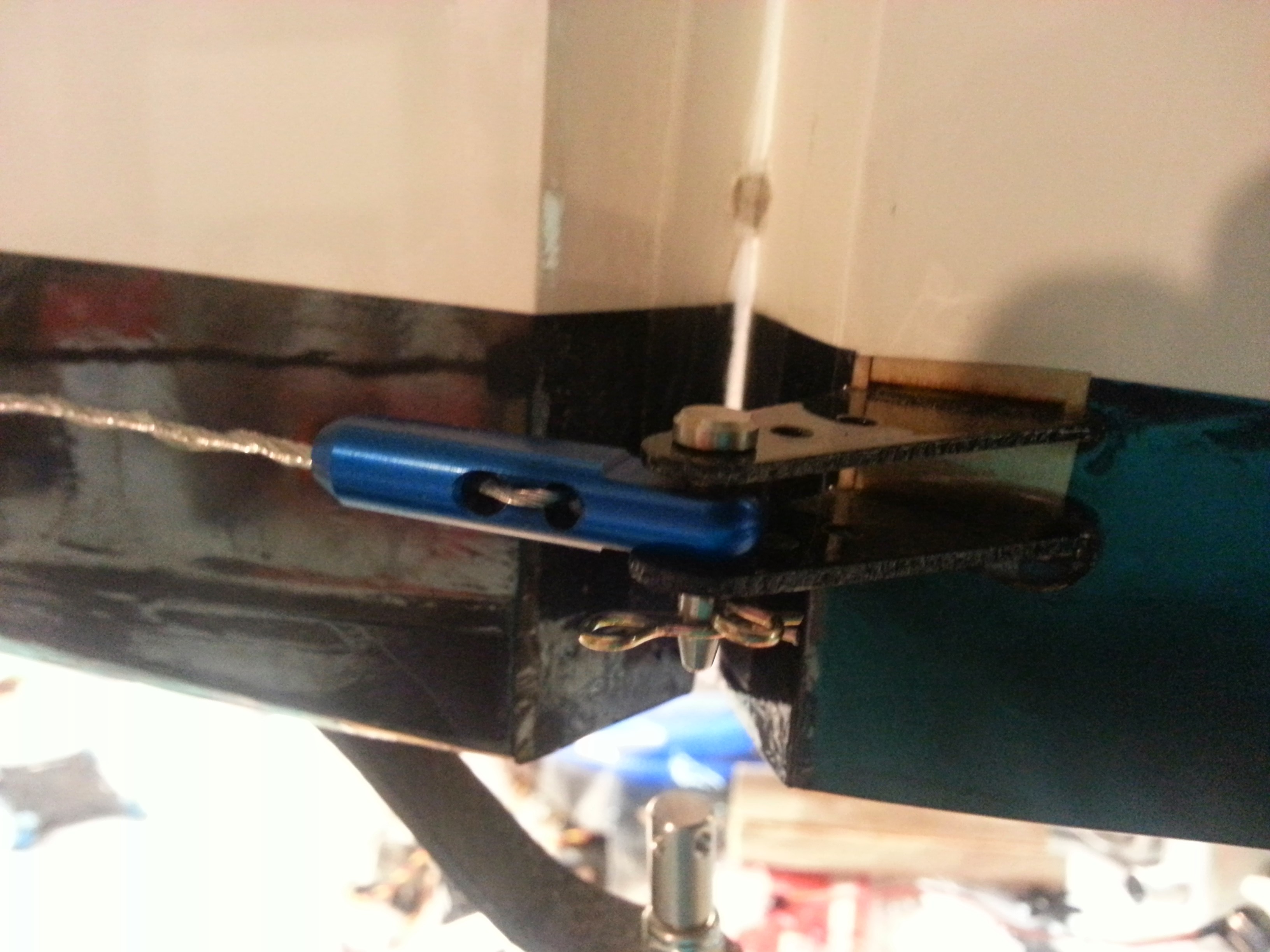

Finished the pull pull rudder installation on my extra tonight.!
It was super easy with the spot on wire tensioners!
Next step...installing the gp61!!!!!
Including two pics this time :)

Yeah I love the tensioners just never used the couplers at the rudder before unless I was planning on taking rudder off.. they sure are nice though

I would have had to drill the #4-40 holes on that servo arm pretty big to fit that post in there...The holes in the rudder control horns were much closer in size to the post.

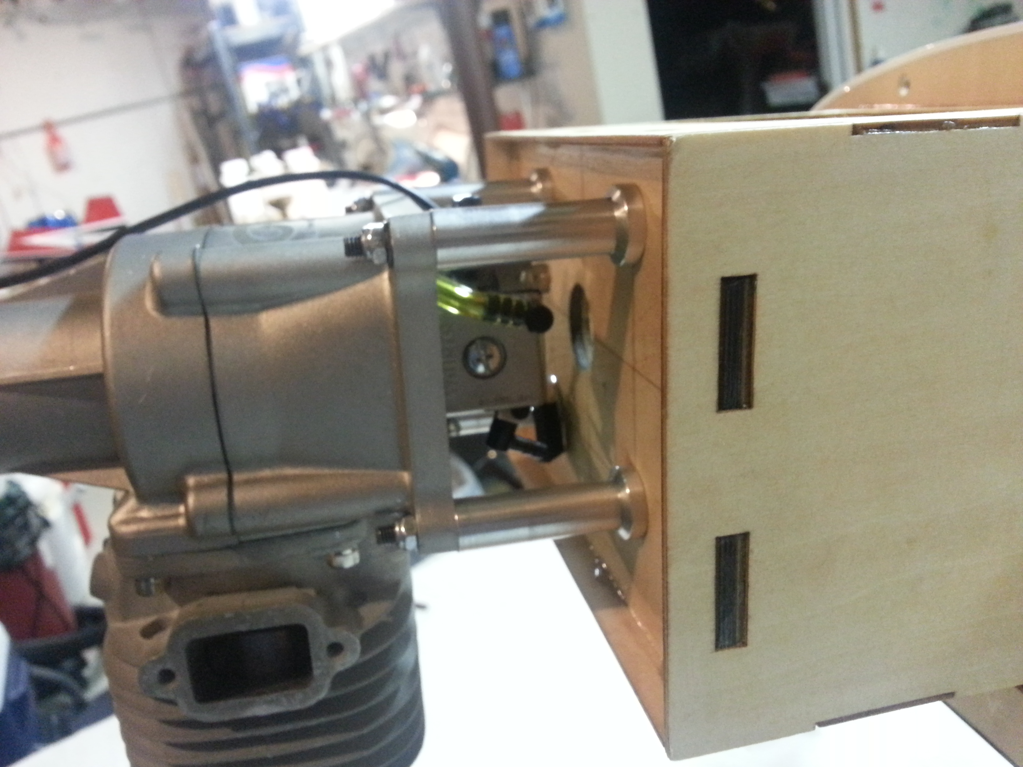

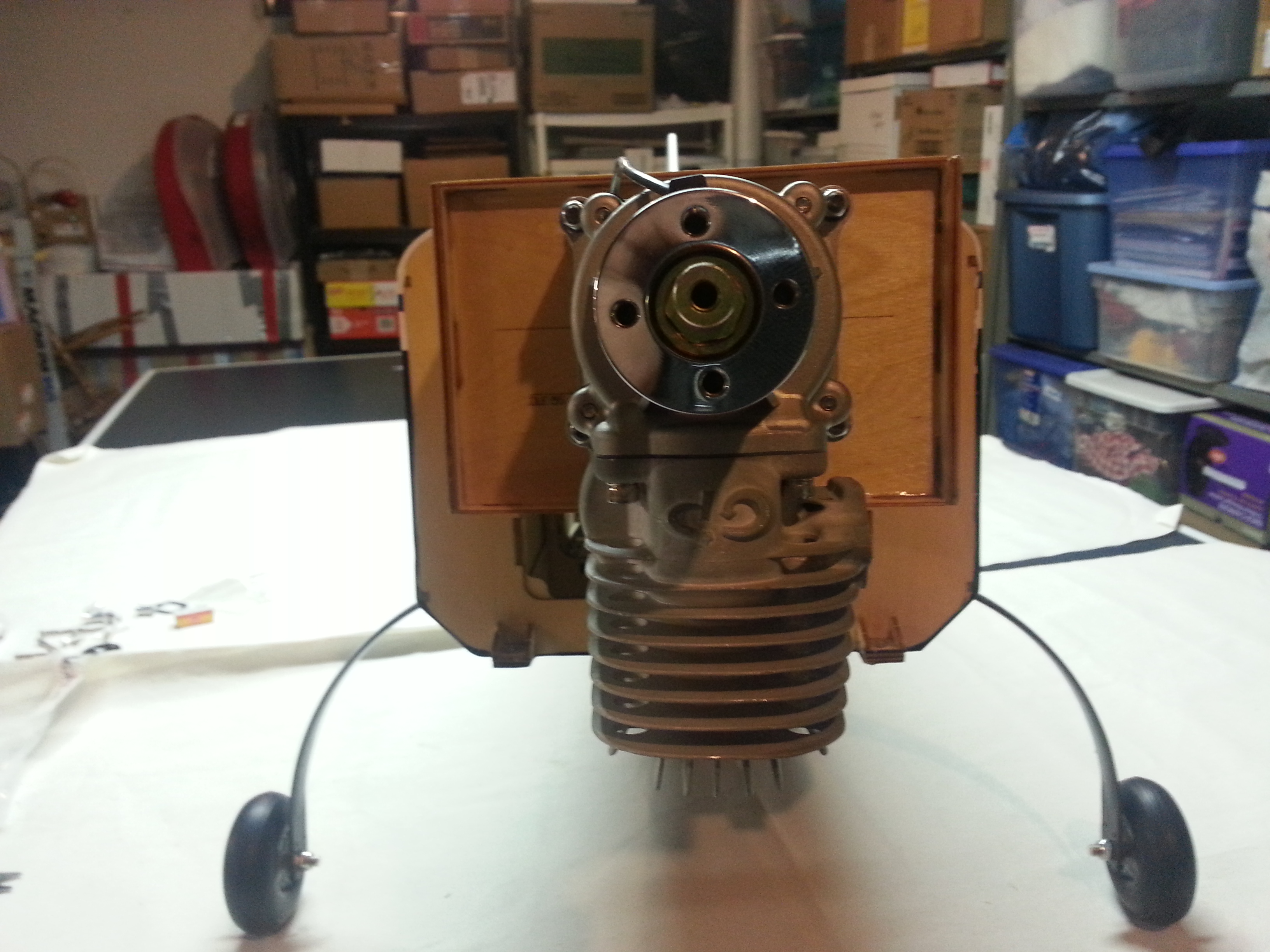

Ok - time for another update on the 50cc Extra...got the engine mounted last night!!!!!
the premarked mounting pattern for the DLE-55 was the identical to the pattern on the GP-61 - sweet!
