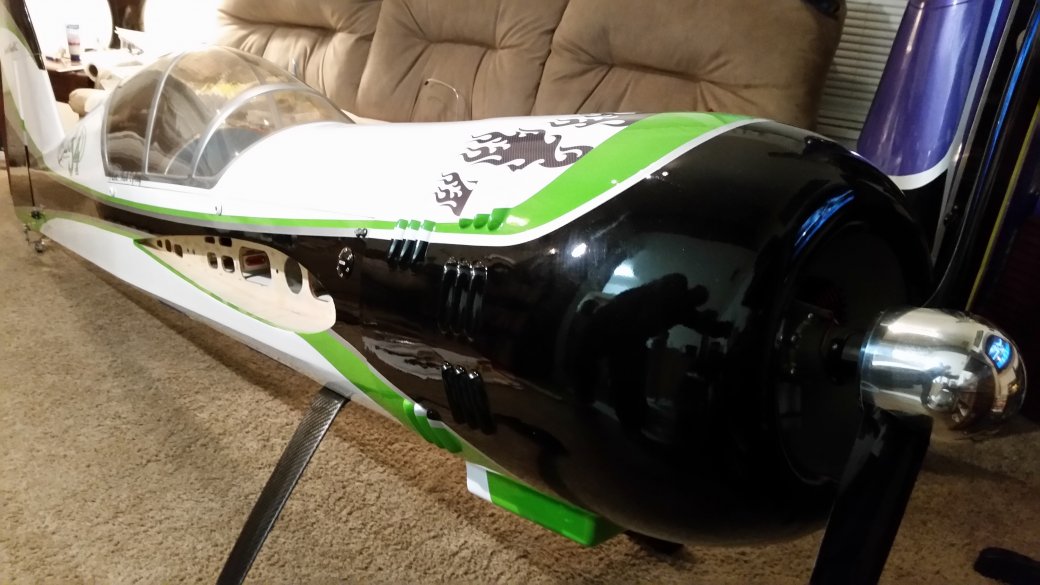

Great talking to you on the phone today! I like the flames, it dresses it up:)
:)My vote is for stock exhaust. Save the weight, heat and custom fitting the cans/pipes.
Looks damn good:way_to_go:

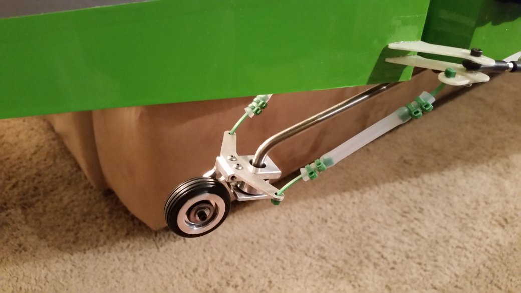

I did get a couple of smaller things done today. Tail wheel hooked up and tested. Since having the steering issues I "did" have on the 260, and after trying a variety of methods I finally resolved to a common setup that many use. And since implementing it on the 260, (as well as all my other planes) with not one further failure, I chose to do the same to the big Yak.

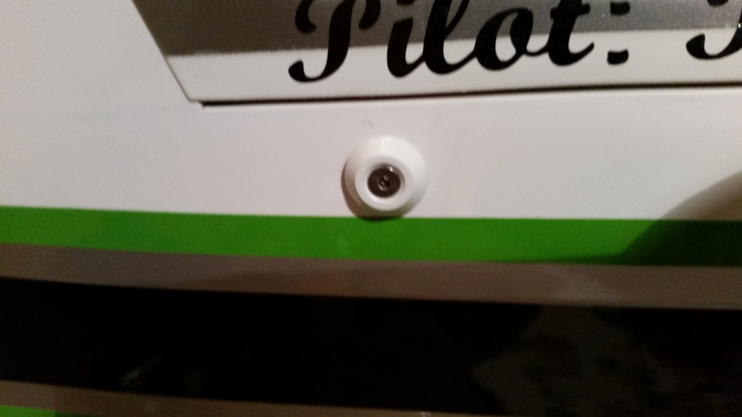

I also decided on the canopy bolt selection. Since no one offers colors in anything other blue, black, red, gold and silver...I chose to toss a coat of white paint on the Secraft canopy locks I already had. They turned out pretty nice I think.

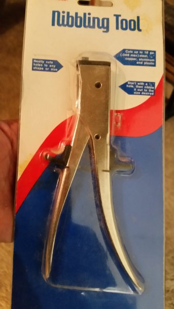

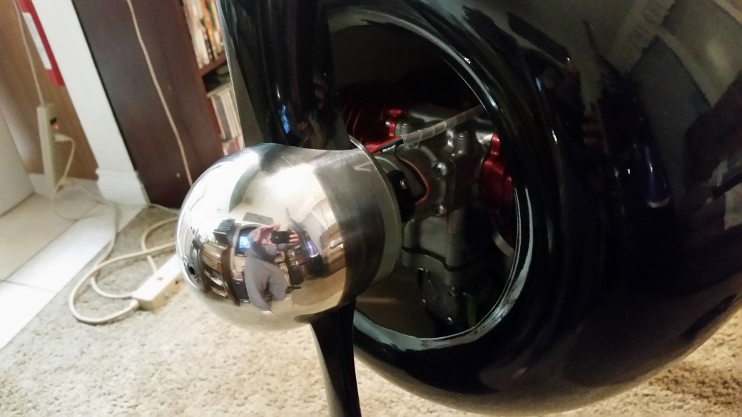

Next I got the Falcon 34x12 drilled. Also cut the spinner to fit the big prop. I tell ya, without my "Nibbler" tool, I think I'd be lost. I actually bought this years ago when I was still flying...glow... (shudder), I've found they work just as nicely on larger Tru-Turn spinners as well.
