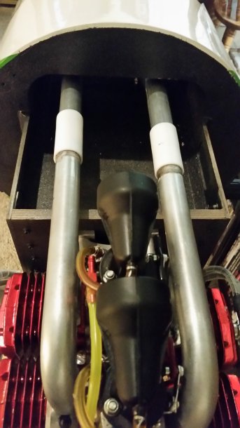

There is physically zero possibility of me putting "ANY" type of can, muffler or pipe down the tunnel of the Yak simply because there just simply is no clearance available.

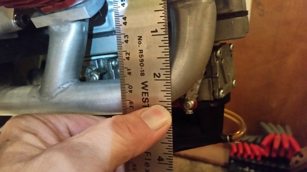

As you can all see, the headers are a 2.5" drop header. The shortest drop offered by 3w. The end of the header leaves me about 1/4" to play with at the can tunnel entrance. Which is far from enough for any cans/pipes available.
Unless......I have special headers built for the 212. Which, I may end up doing. I spoke with Kevin from Jtec. He has told me that what ever I need, they will do their best to help me figure out a way to make it work. I did some measuring again inside the cowl and I really don't know how I missed it. (This is the part where I admit my error)

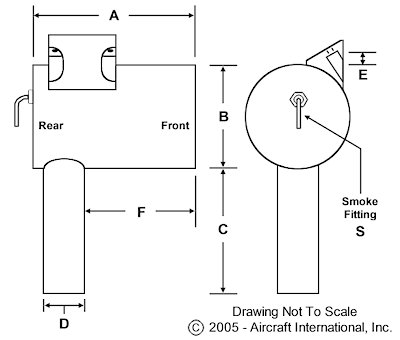

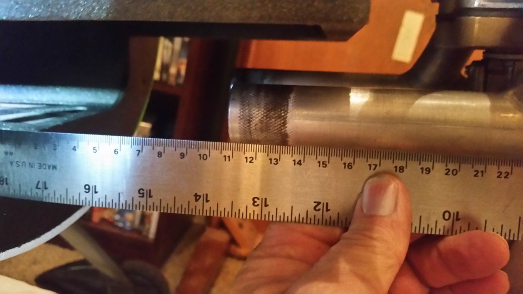

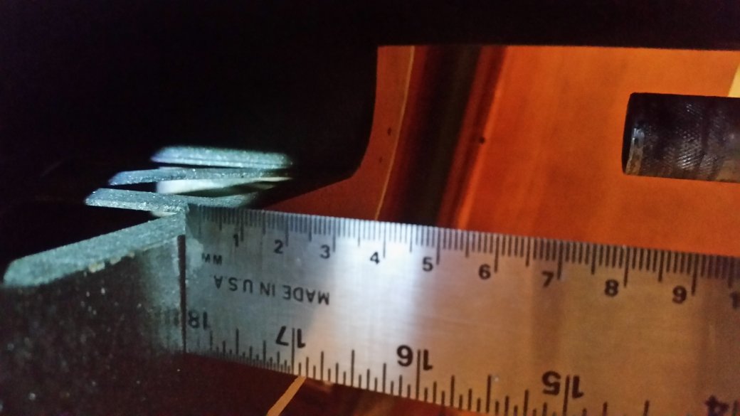

The mounting offset of the JA mufflers (E) is .50 inches. The chamber diameter (B) is 2.0 inches. The down stack (C) is 4.0 inches. For a total of 6.5 inches from the cylinders of the motor. Inside...and I measured three times with a tape this time, is precisely 6.75 inches. Hence, the JA mufflers will "INDEED" fit inside the big round cowl of the Yak. Without cutting one bit of the bottom of it out as I feared. In fact, the two rear cylinder stacks will drop right down the air exit in the bottom of the cowl. Which needs to be removed for airflow anyway. The two front will need to have two 1.25" diameter holes drilled in the cowl and then short extensions added to exit the exhaust. "THIS", this I can deal with. Along with this design, I have come up with a really easy and straight forward way of baffling the motor "WITHOUT" having to split the cowl. Whew....been sweating that one.

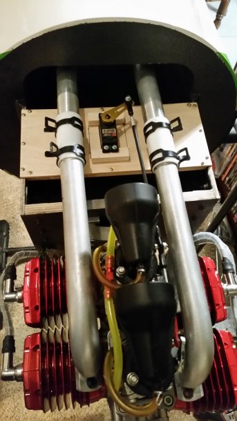

Ah ha!!! Went back to the drawing board and came up with a new resolution. Decisions, decisions, decisions! Admittedly too anal on the Yak. But!!! In my defense, I want it clean, functional, quiet and most of all my design.
Sneak peak:
This is an extremely trial fit.
So I now have the throttle servo in place and set up. I really don't think I've ever had a linkage as linear as this one. With each little incremental movement of the gas pedal stick, the linkage on the twin Tillotson carbs kept perfect time and equal movement.
Now with the test exhaust system in place, ignition batteries temp'd in the fuse, temporary fuel tank inside, (new TDRC tank due to arrive in the next couple of days) and the Falcon 34x12 torqued on the front hub...the moment for a test run is rapidly approaching. Weather permitting, I will fuel the big Yakster up and lay my hands generously upon that red headed beauty. Looking forward to tomorrow for sure.
