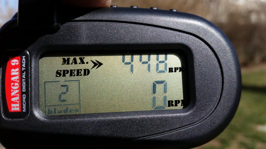

Got a video coming. But till then, I'm pleased with the 212. Bone dry with both chokes on...14 flips. Bark! Chokes off, 7 flips. Each restart after 10 to 15 minute waits, no choke three flips faithfully. The motor is oh so quiet. The exhaust...a silent hush really. Unfortunately my custom exhaust system is apparently too restrictive. Top rpm, 4480. Ugh. Oh well, had to try.WELL ? ! ? ! ? ! . . . . . . . .![]()
Thank you David. Next plan of attack? I give up. Contacted Gerhard at AI today. He still has the complete set of stock exhaust available. I also put in a call to Mr. Bill Hemple himself. As I know he has extensive experience, knowledge and success running the 212 on different exhaust configurations. If there is "ANYTHING" other than stock exhaust that can be made to work, he would know. JMO. If that fails? I will cough up $345.00 plus shipping for the J&A stockers. I am exhausted, (no pun intended) with the exhaust issues of this motor. Not to mention quite disappointed as well.Oh well, Good on ya for trying. Allot of people would have just butchered up the cowl by now. . . . .. So, what's your plan of attack next?
