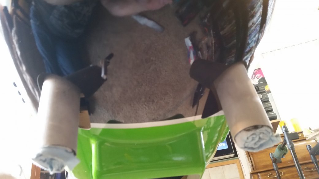

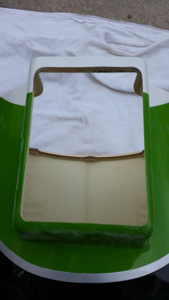

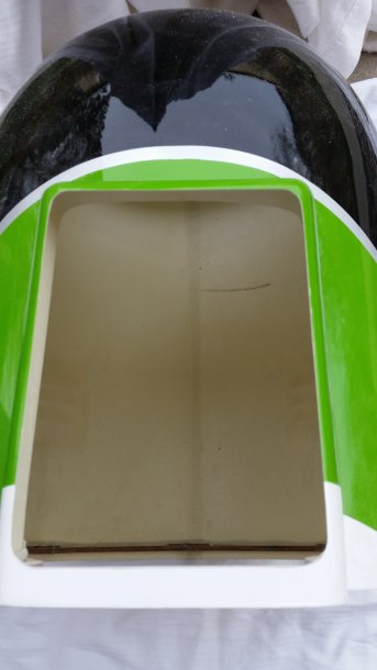

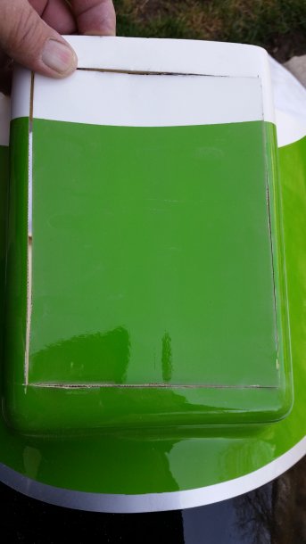

I started working on the cowl today. I wanted to get the bottom opened up and reliefs opened for the exhaust stacks. I also wanted to put some baffle/deflectors in the front of the cowl to divert the incoming air across the big block cylinders. Keeping with the norm of 3 to 4 times the amount of air out as what is incoming, I chose to open the entire extreme bottom of the nodule on the bottom of the cowl. I figured by doing this it would be the best way to allow as much air out as possible. Plus, it makes for accessing the bottom cowl bolts a breeze to get to.
Once I had my opening cut out, I sanded the edges to give it a clean look.

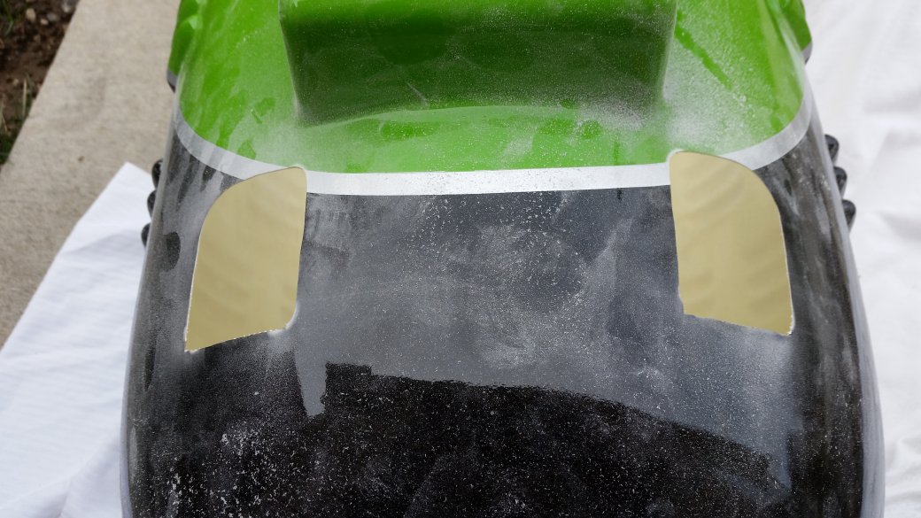

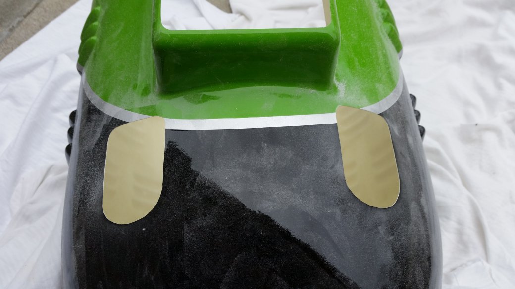

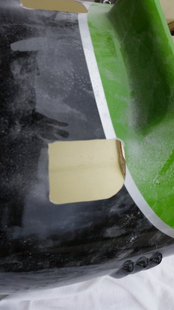

Once that was done, it was time to open up the exhaust stack reliefs in the bottom of the cowl. Fortunately I did not have to take too much out. I have been so anal about this phase of this restore, but as I mentioned earlier... I was not objective to opening up what needed to be opened (within reason) for the big block 3dub.
The reliefs turned out pretty good. All that was left on them was to do a final edge sanding and done.

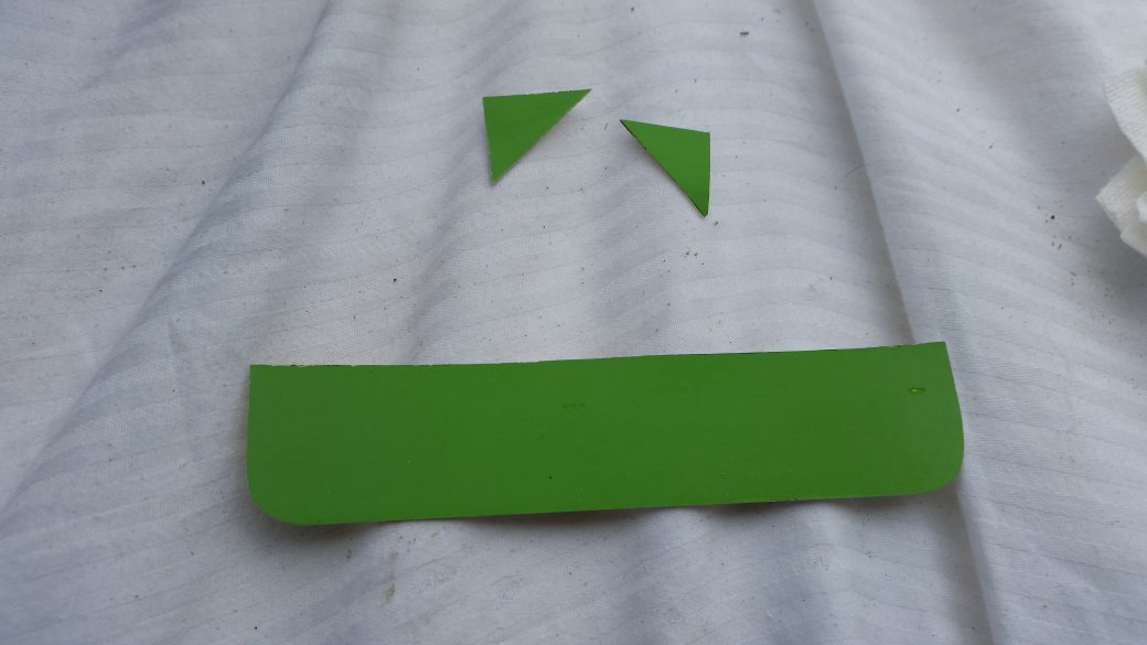

I decided to use the scrap from the bottom of the cowl to do as I did on my Sukhoi. I cut pieces to fit in the shape of a deflector to be placed on the front edge of the cowl nodule on the bottom.
Once I had the deflector in place and glue cured, I test fit the cowl with most everything in place. It actually turned out ok. I hate cutting up a beautiful cowl, but it is what needed to be done.

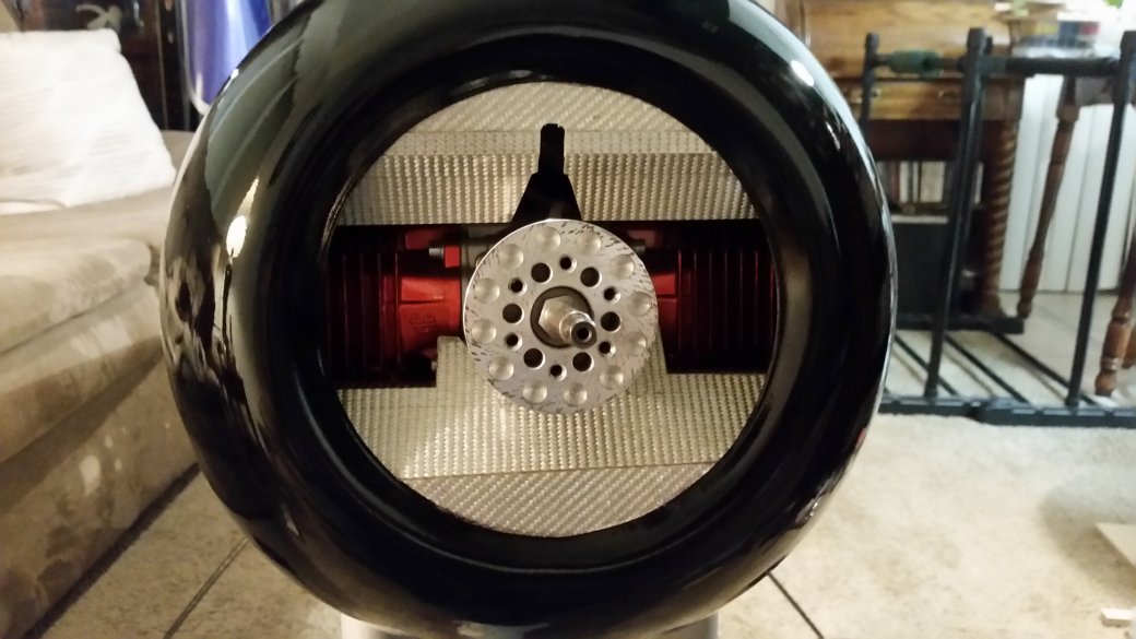

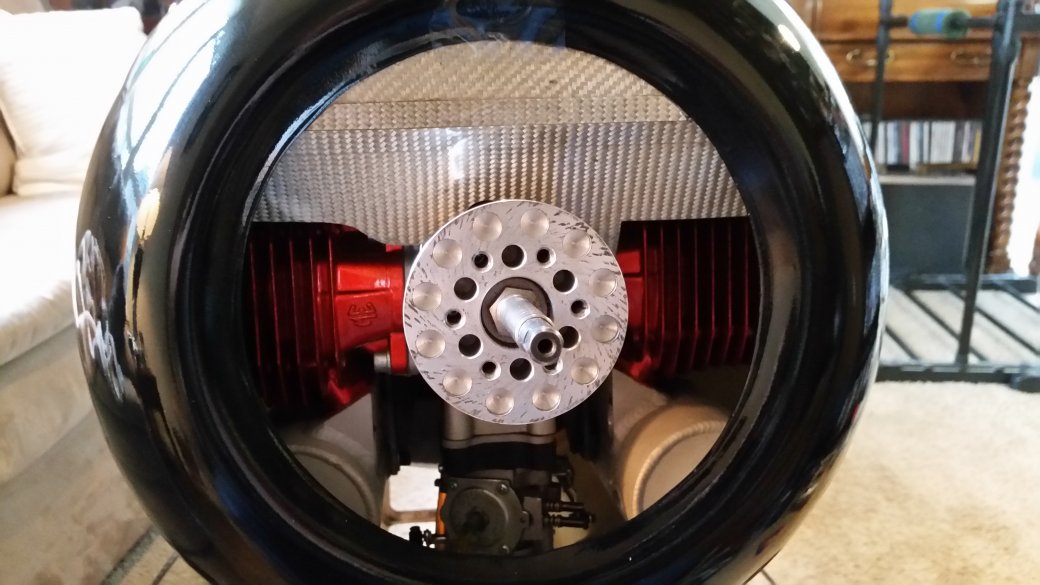

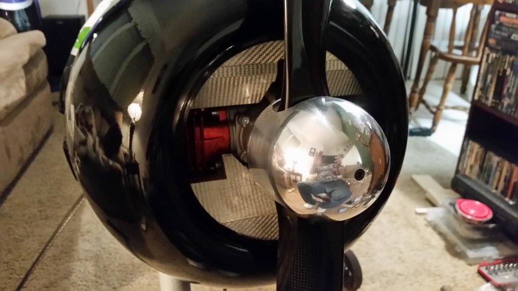

Next it was time to add baffling deflectors. I utilized the parts from the previous cowl. I considered using black Carbon Fiber, but soon realized it really wouldn't look all that great due to the cowl being black up front. So this is what I came up with. Top section in place.
Top section trimmed to fit the 210. There is quite a difference between the original 170cs that was in it. The top and bottom half moons are basically flush with the front of the cowl. The center sections angle back towards the motor.
Once everything was in place, I finished by adding the sections that meet up to the cylinders to keep the air squished so that it "HAS" to go through the fins before exiting the bottom of the cowl. Later on if I need to open up for more air flow, I will simply open up the vents in the belly of the fuse. With the prop and spinner on, she looks pretty good.

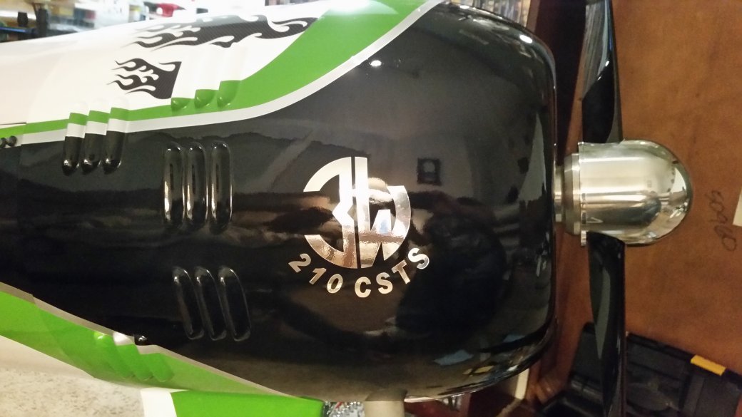

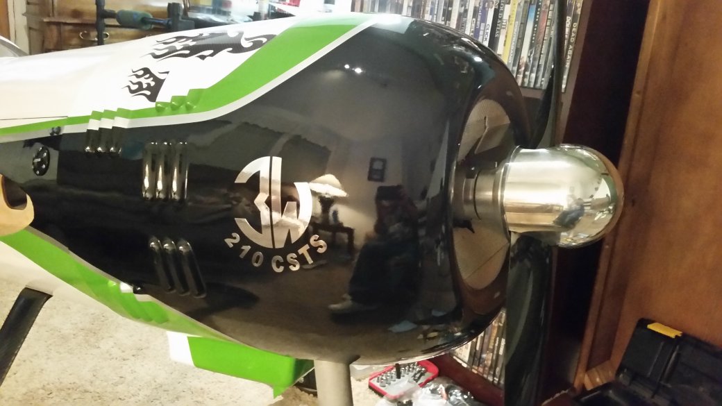

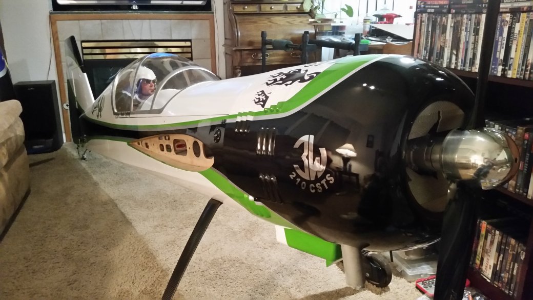

Of course no big Yak with a big block red headed beast up front would be complete without the signifying decal of what is "stuffed" under the hood.
And with the canopy put in place and a quick clean cloth....the Yak is wiped down and ready for her maiden. I am not sure the weather is going to be favorable this weekend. But I am not counting it out yet.
At last...after a very long and very decision intensive process, the big Yak is finally done. DONE... whoa. I can't believe it. I sure hope she flies as good as she looks.
As a side note: I plan to get back to the Dalton in the next day or so. This Yak was a challenge. But from what I've done thus far on the Dalton Extra, The Yak was cake. I really hope the Dalton turns out as pretty as the Yak.
