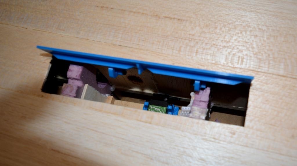

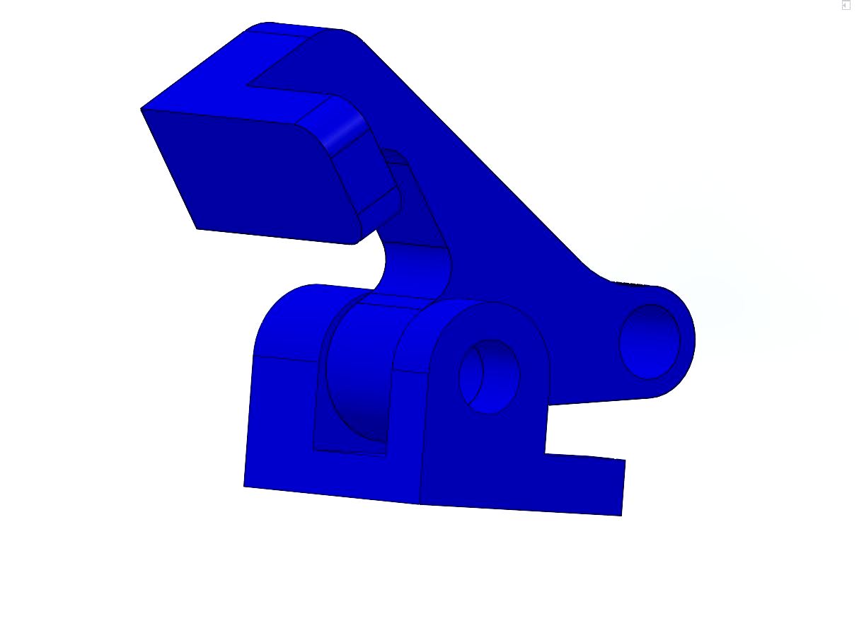

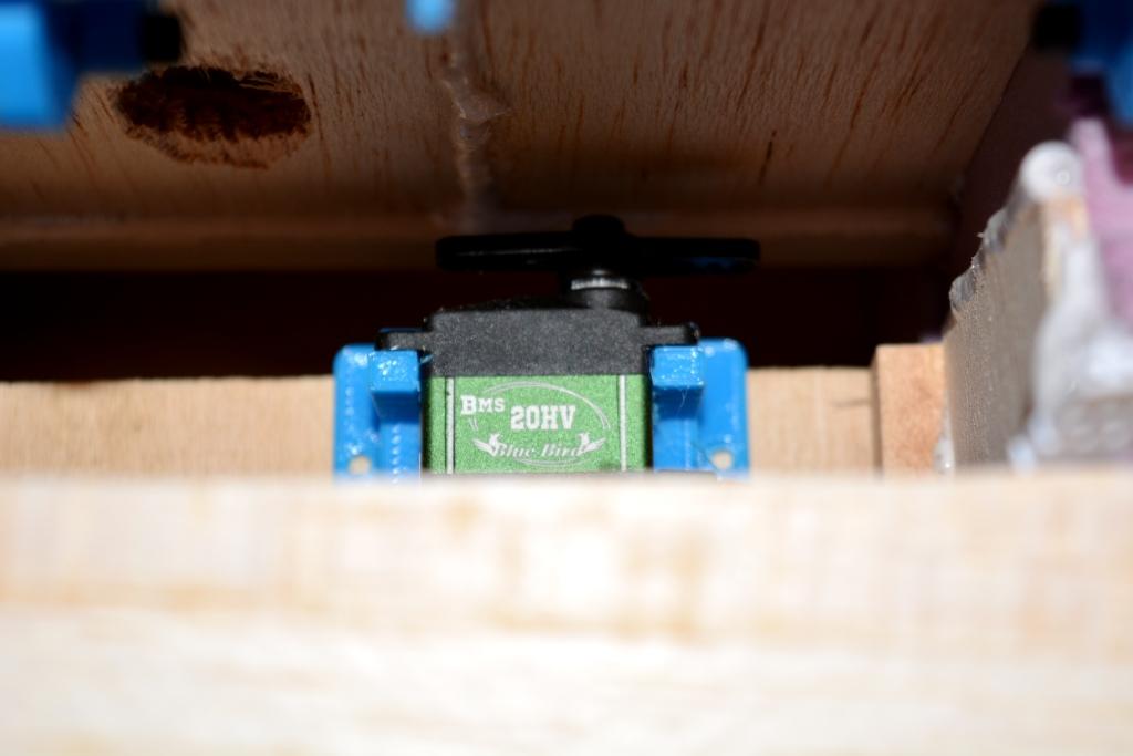

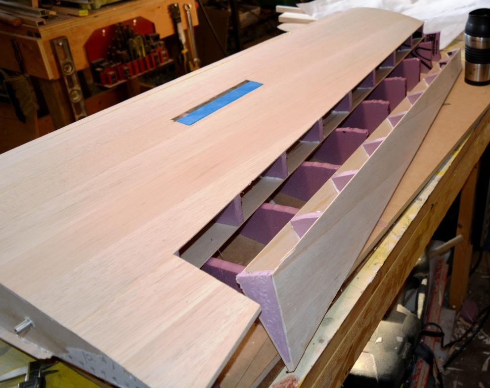

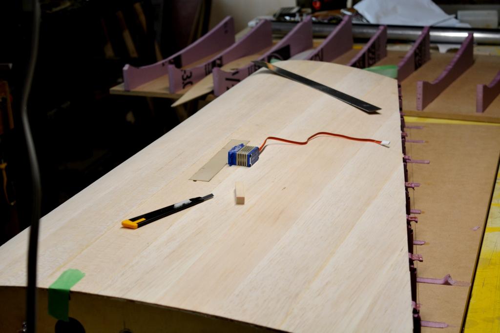

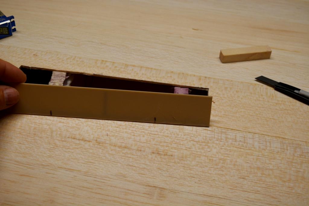

thinking out of the box, installing spoiler (lift dumpers) for shorter landings, all parts were designed in solid works

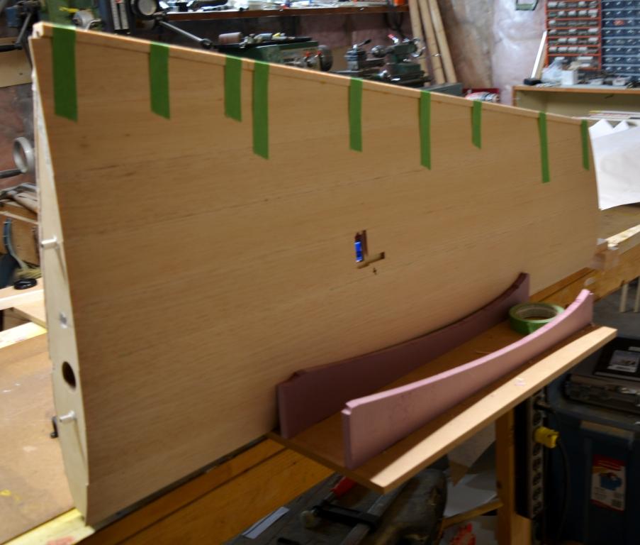

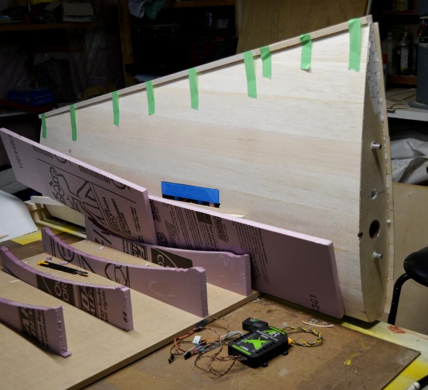

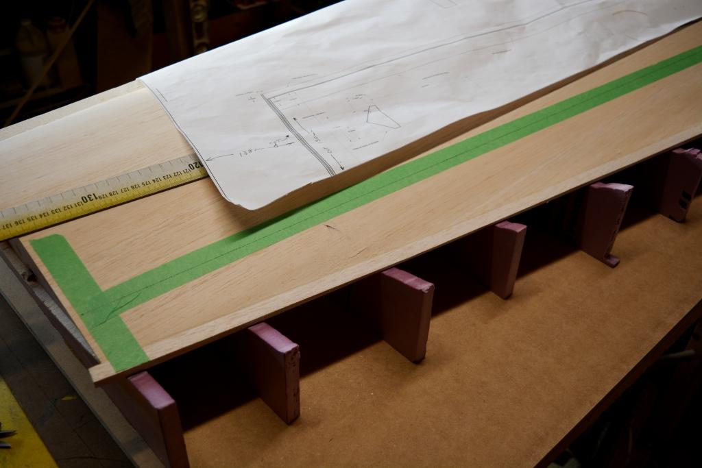

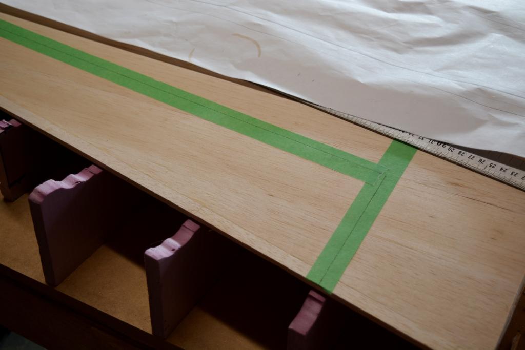

bottom skin now on and glued, and just now I glued the trailing edge , tomorrow the leading edge, once glue dried , and leading edge and trailing edge shaped properly, then measure 10 times cut once the aileron, then the work starts on leading and trailing edge for aileron ,
