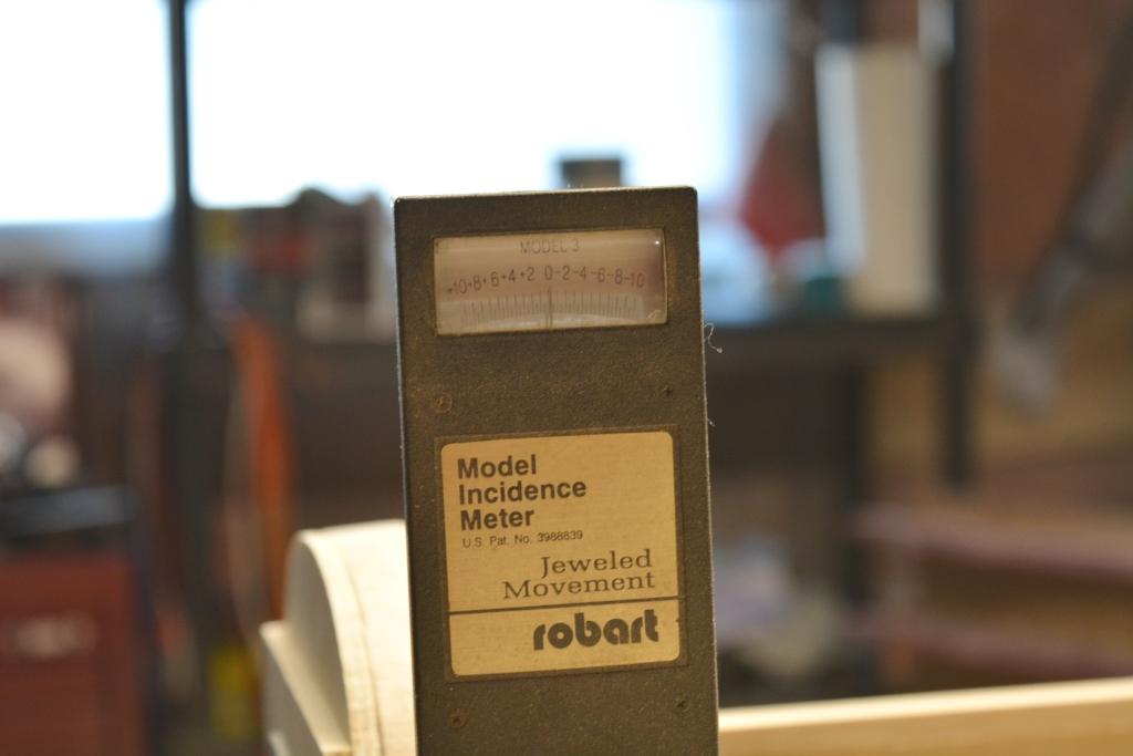

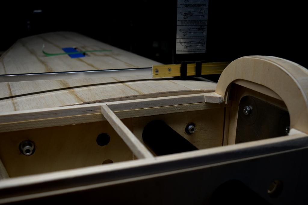

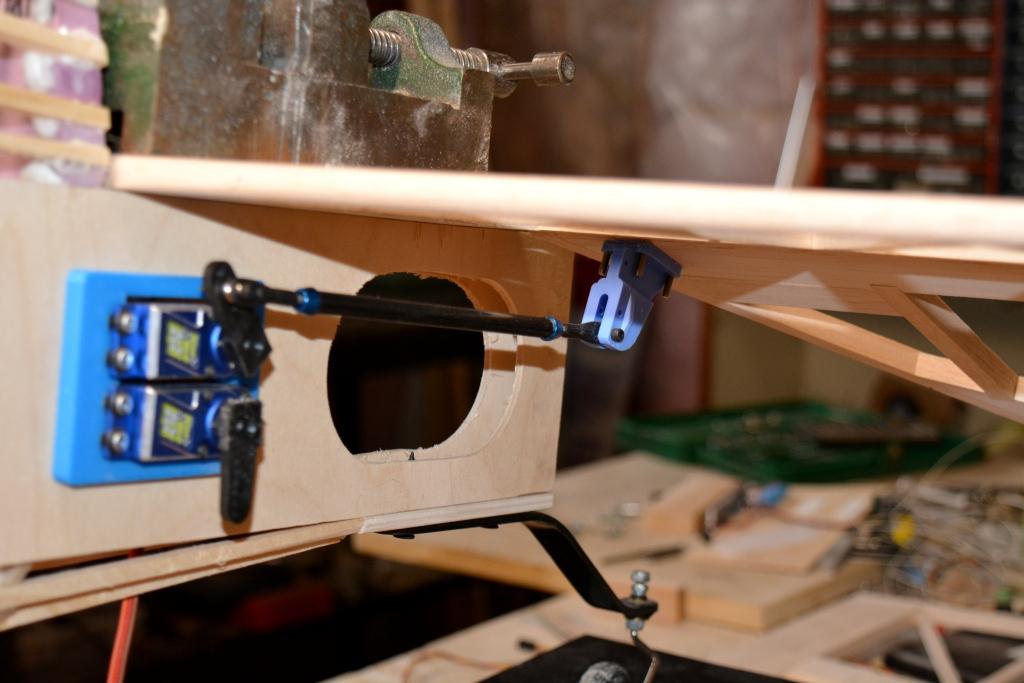

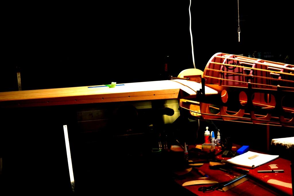

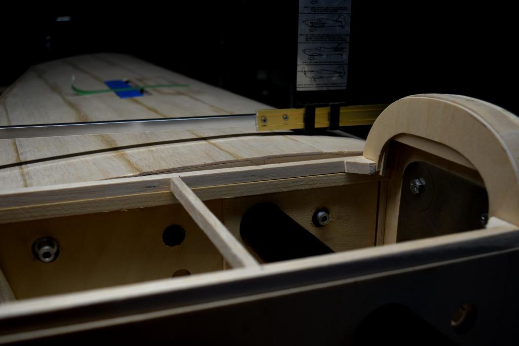

fitting the wings to be within the angle needed which is 0 to the tail, building the frame for the canopy when it gets here . all in all a good day so far

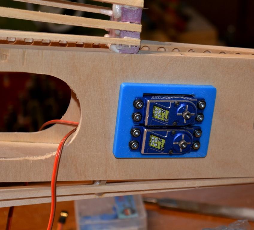

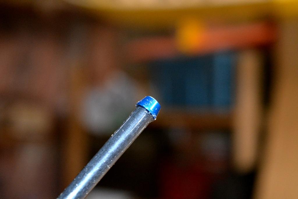

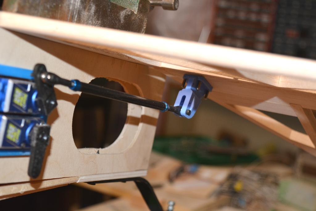

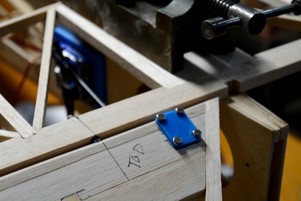

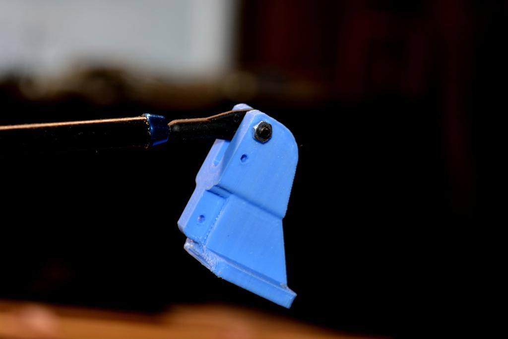

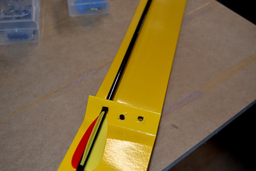

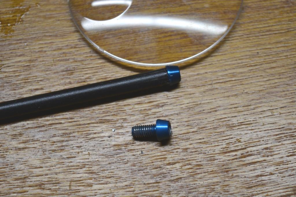

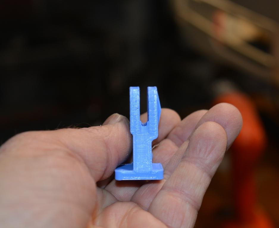

control horns, and pushrods, when there are no Hobby shops in your city, you make your own

AKNick
You sure didn't skimp on the material thickness on that control horn. You're prints turn out REALLY good. Do you tap the your PLA parts or use nuts?
