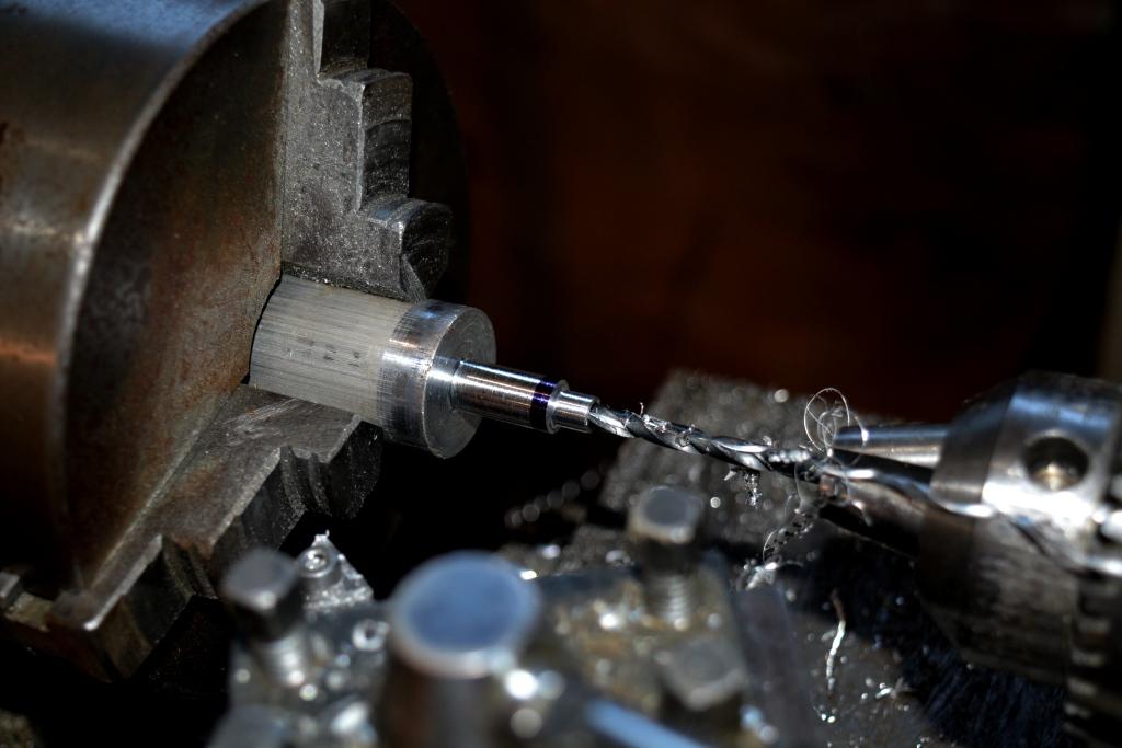

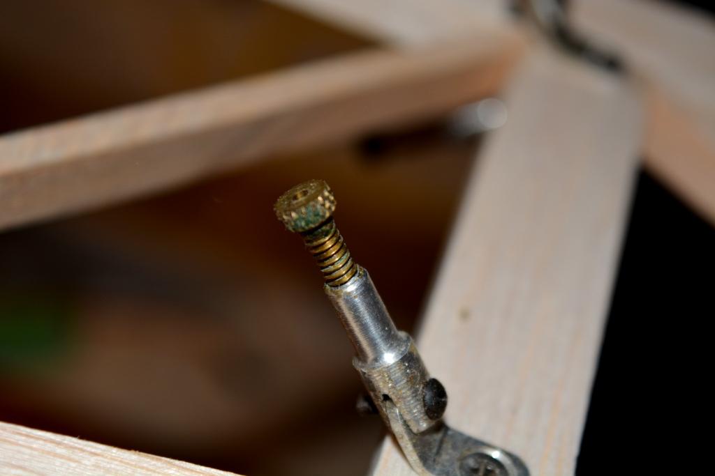

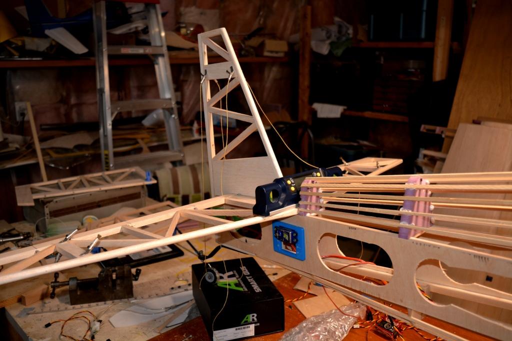

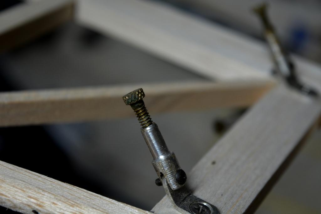

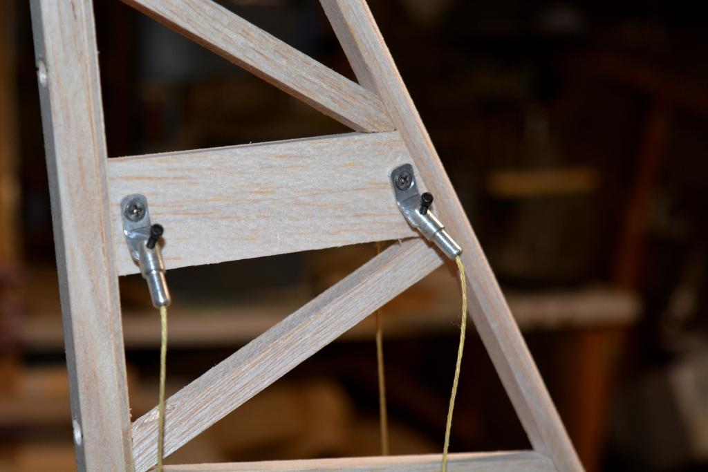

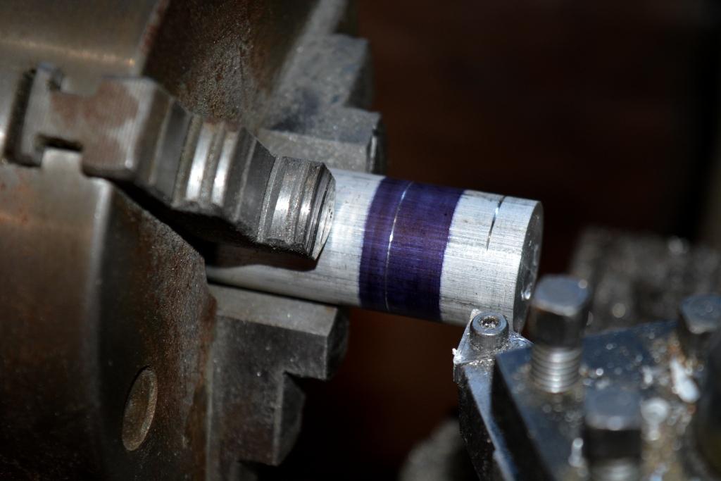

the flight cables on the tail section, using Kevlar with 68 kg tensil strenght

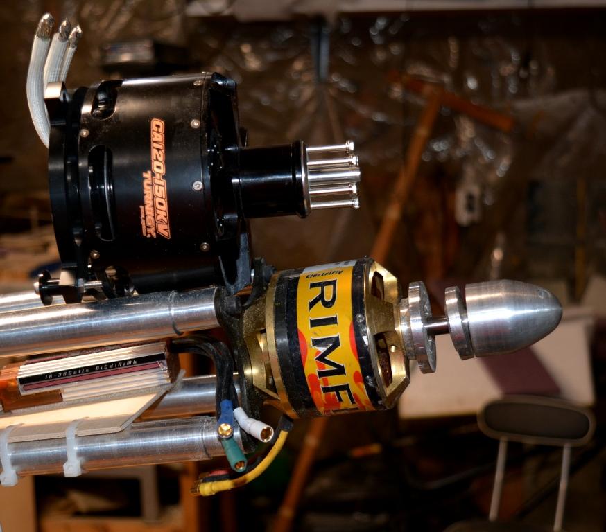

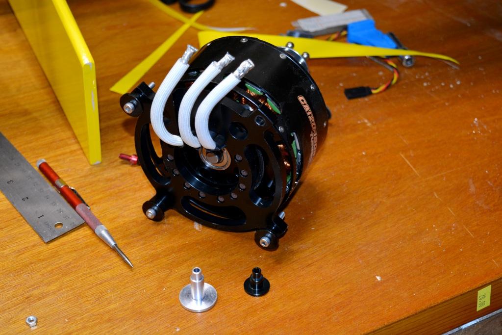

Wow big change what made you do that.
well, a few reasons, first the plans calls for a 120cc gas engine , but I don't use gas on this particular airplane so no vibrations, I can build lighter, also the plans was for a hard core 3D airplane, but I don't do 3D, just smooth aerobatics , so first I installed the smaller motor which in my opinion is all I need, but I would have to add nose weight to balance, so I opted to make the extra weight work instead of just sitting there, and finally I had this motor for a while for a project that didn't pan out . After reading what I just wrote , I think I am trying to justify myself LOLOL
I am no different I will always add some thing that benefits the plane and I have on several occasions changed the engine size if possible to compensate for nose weight.
