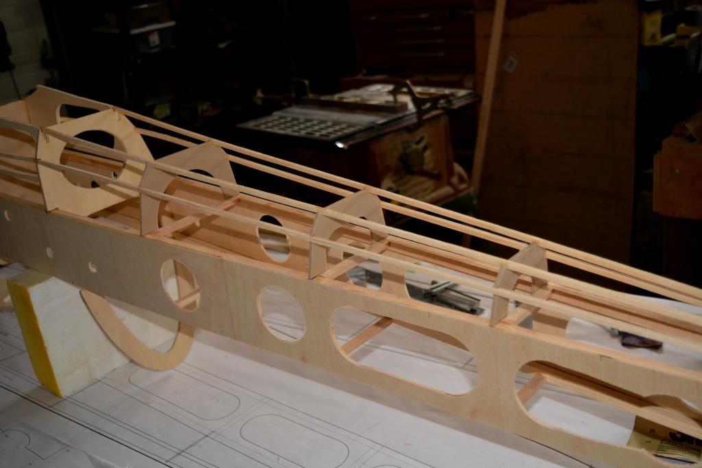

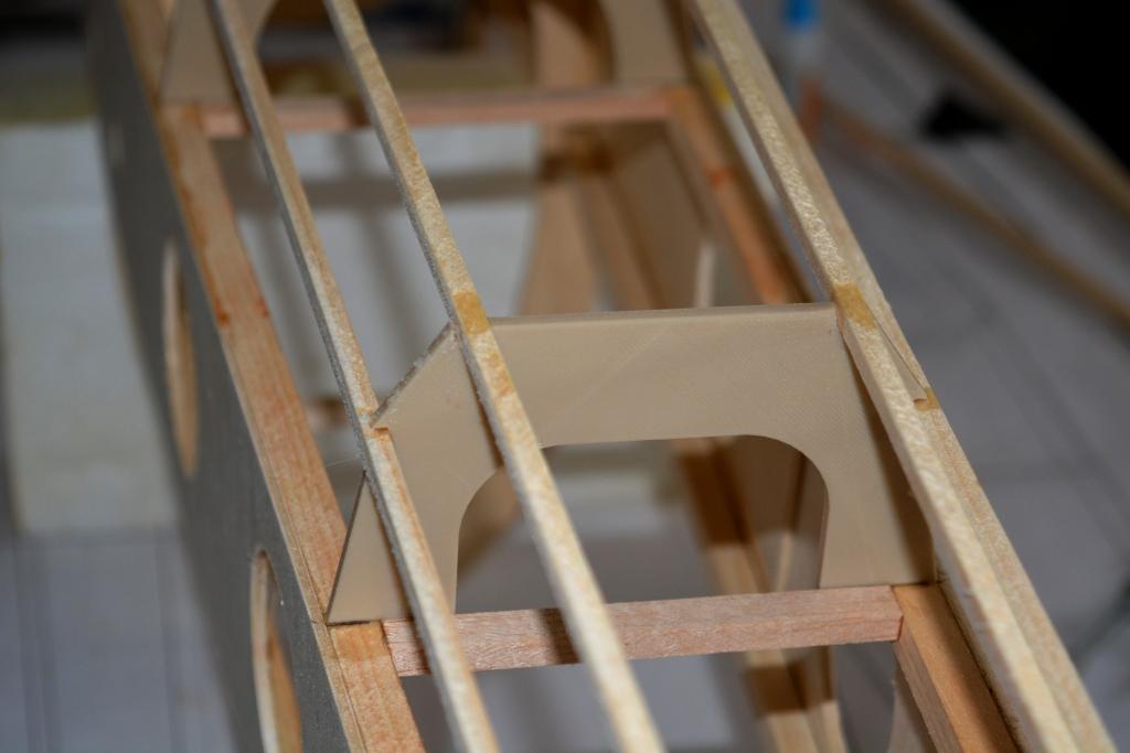

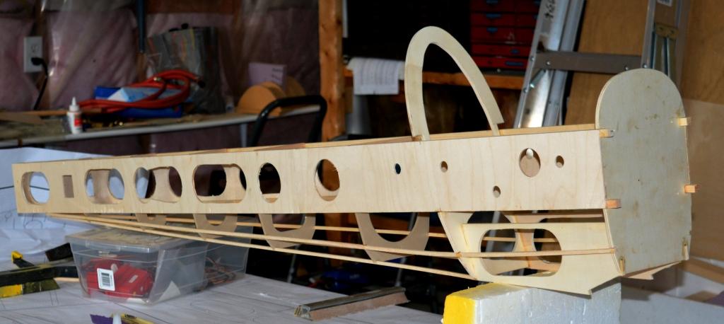

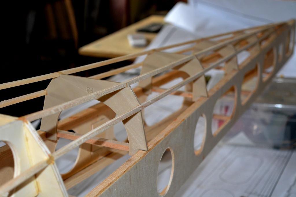

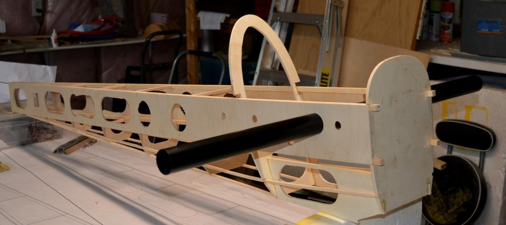

more done on the Laser, you will not the 3D printed lower formers,

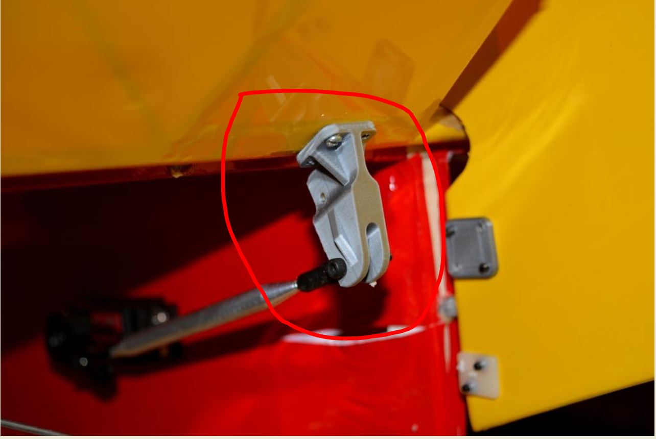

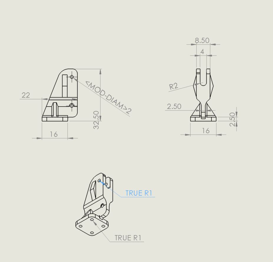

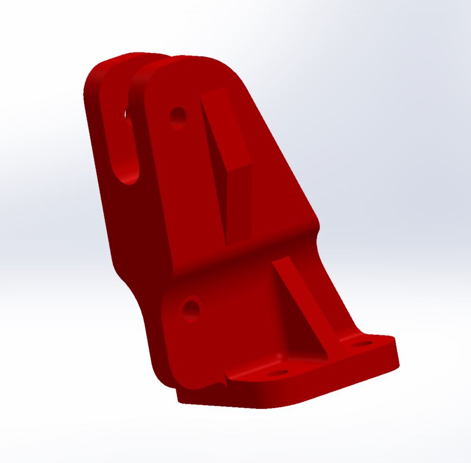

Like that nicely designed that will do the job nicely, one question how difficult is it get to the front to screws to screw into the elevator..
With all the things you are doing with that 3D printer I keep saying to my self I need to get me one of those toys. But I also need a CNC cutter just want to much stufff.
Not sure on your question in red,
The control horn widens out at the top to except the ball link. The square plate below with the four holes that screws to the elevator it looks like it will difficult to get a screwdriver straight down onto the screw to screw it down because the top part that is so wide.
