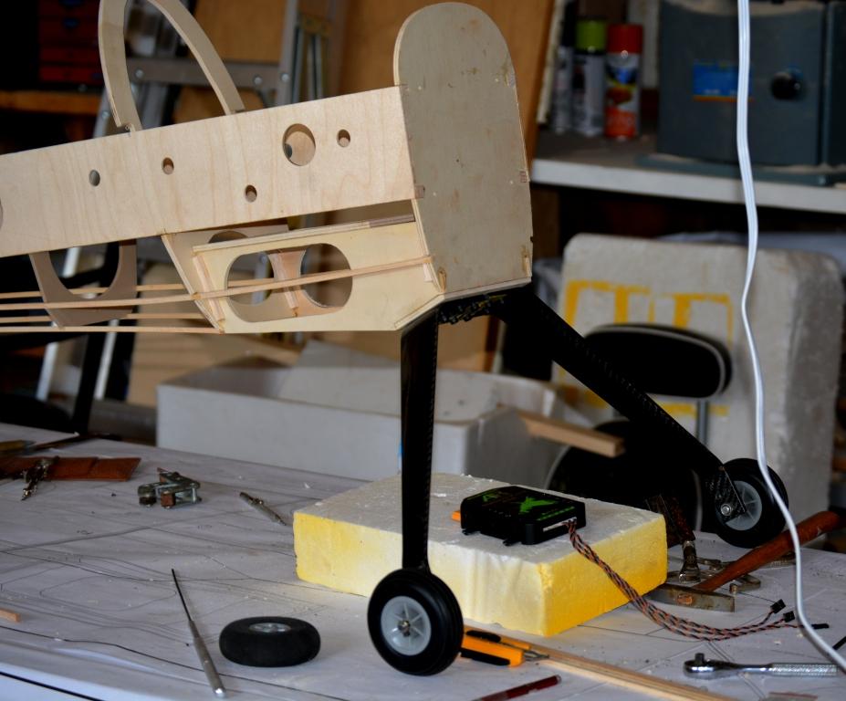

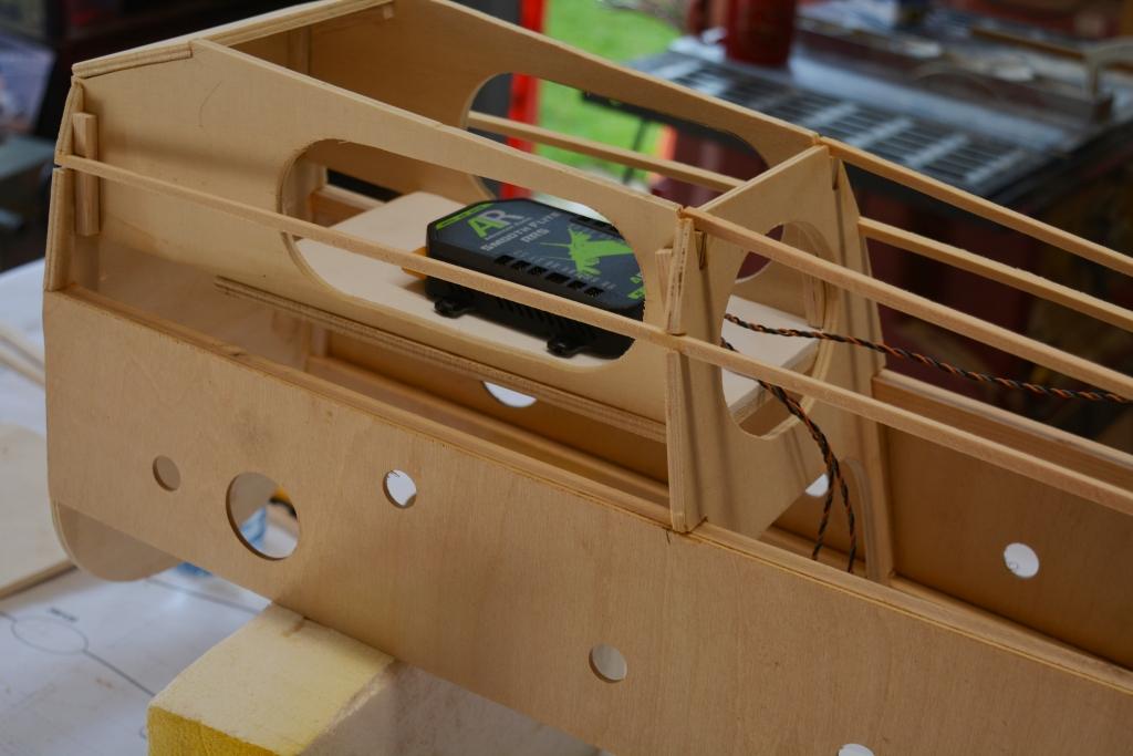

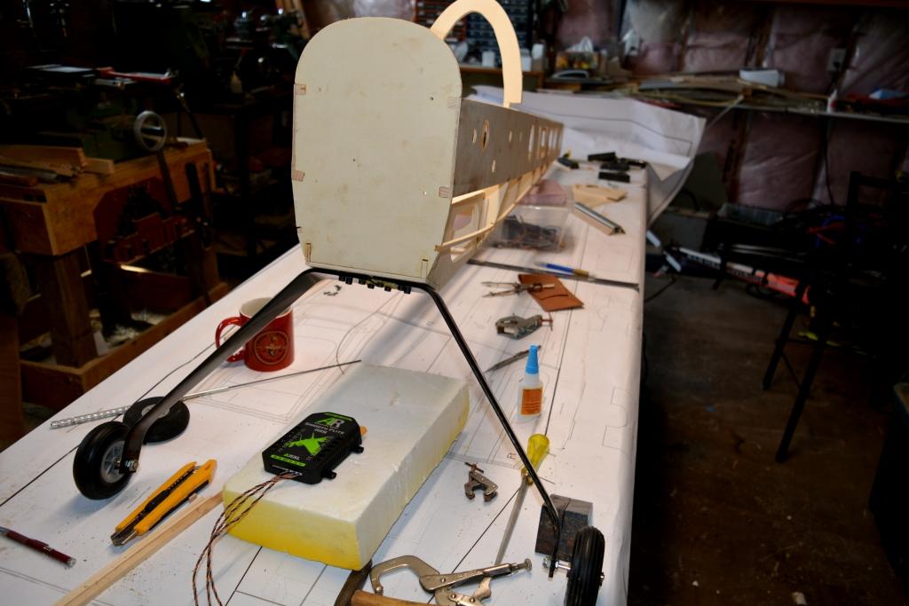

landing gear in the flight system will be accessible from the bottom because the Batteries on top

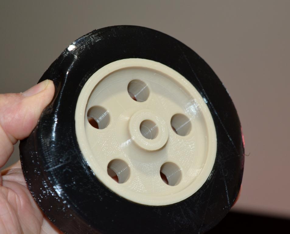

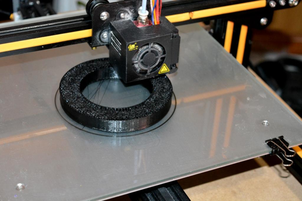

So if I understand you correctly the black part is also printed. Is it soft like a tire.
Yes it is , using TPU filament, which is basically Urathane , the amount of flex will depend on the amount of fill I program into it.
Wow that is interesting, looks good how much does it weigh or is it comparable to a H9 wheel the same size.

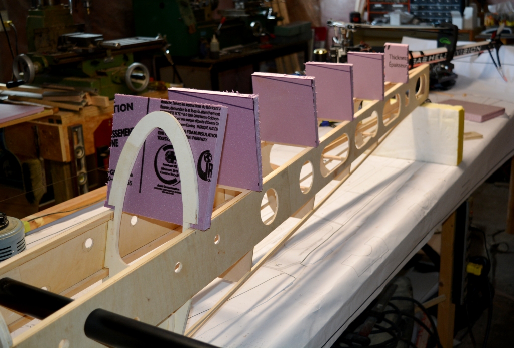

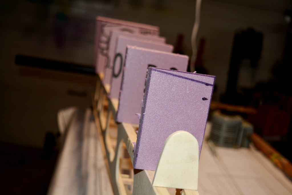

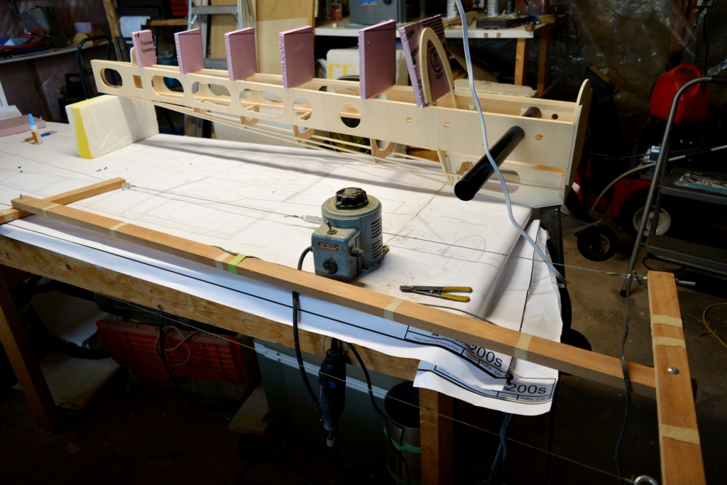

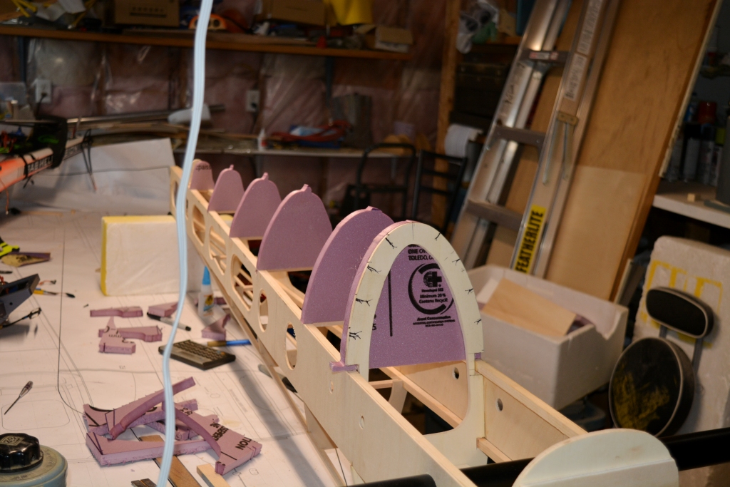

Today, another first for me, for the turtle deck, same principle as I have done before for the wings, In the picture a fellow modeler came over to help me with the cutter, here just holding to show
