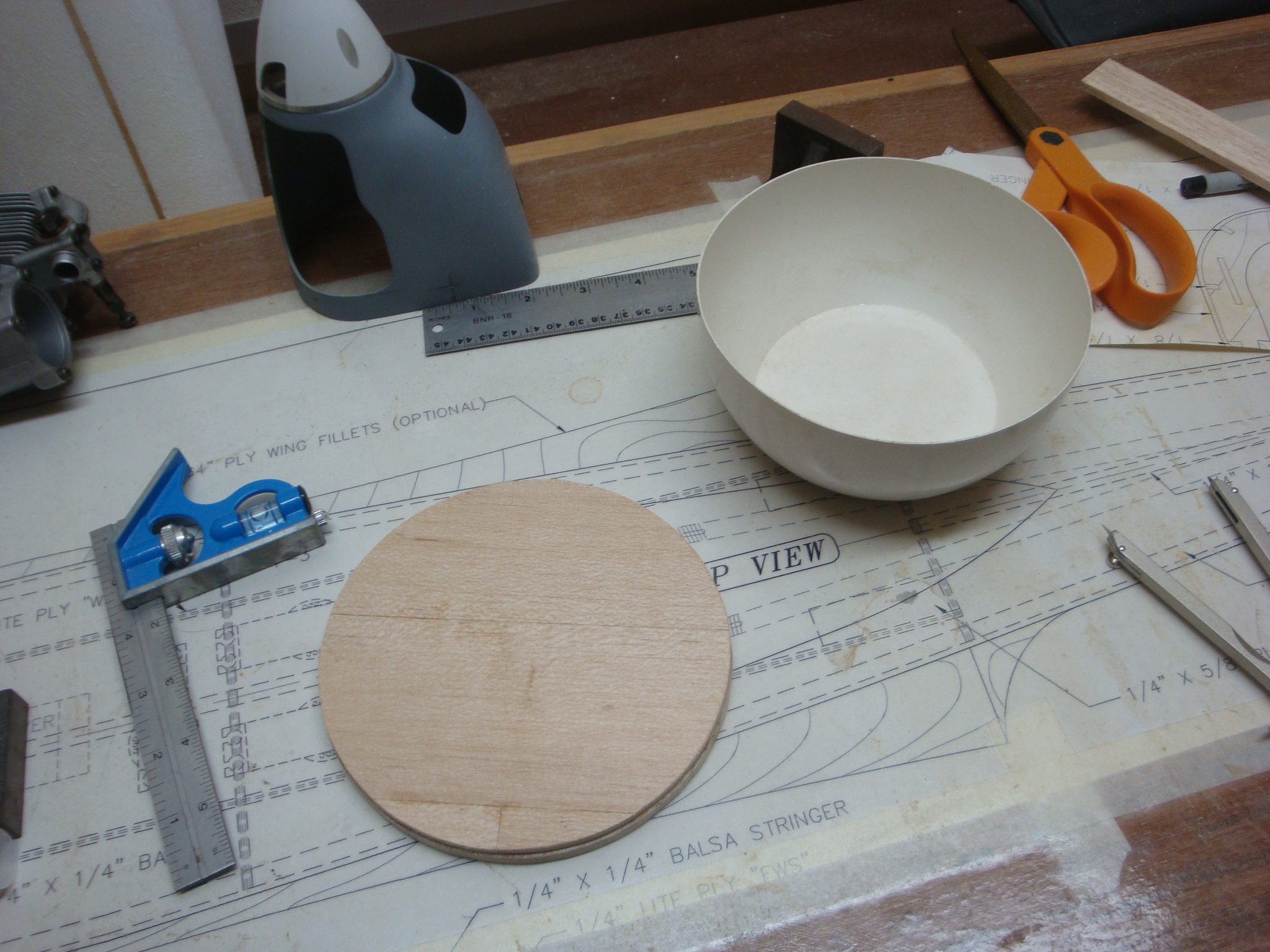

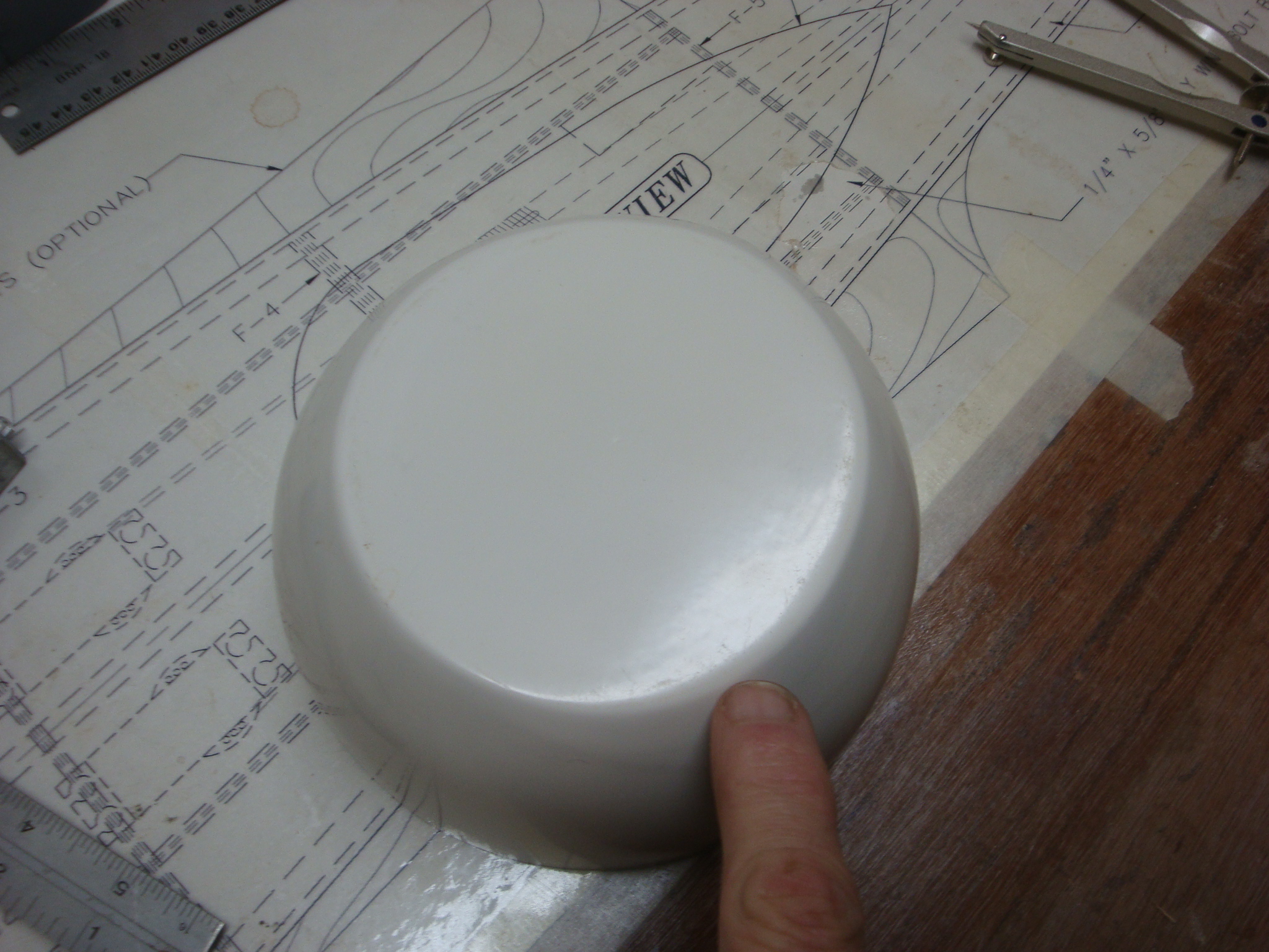

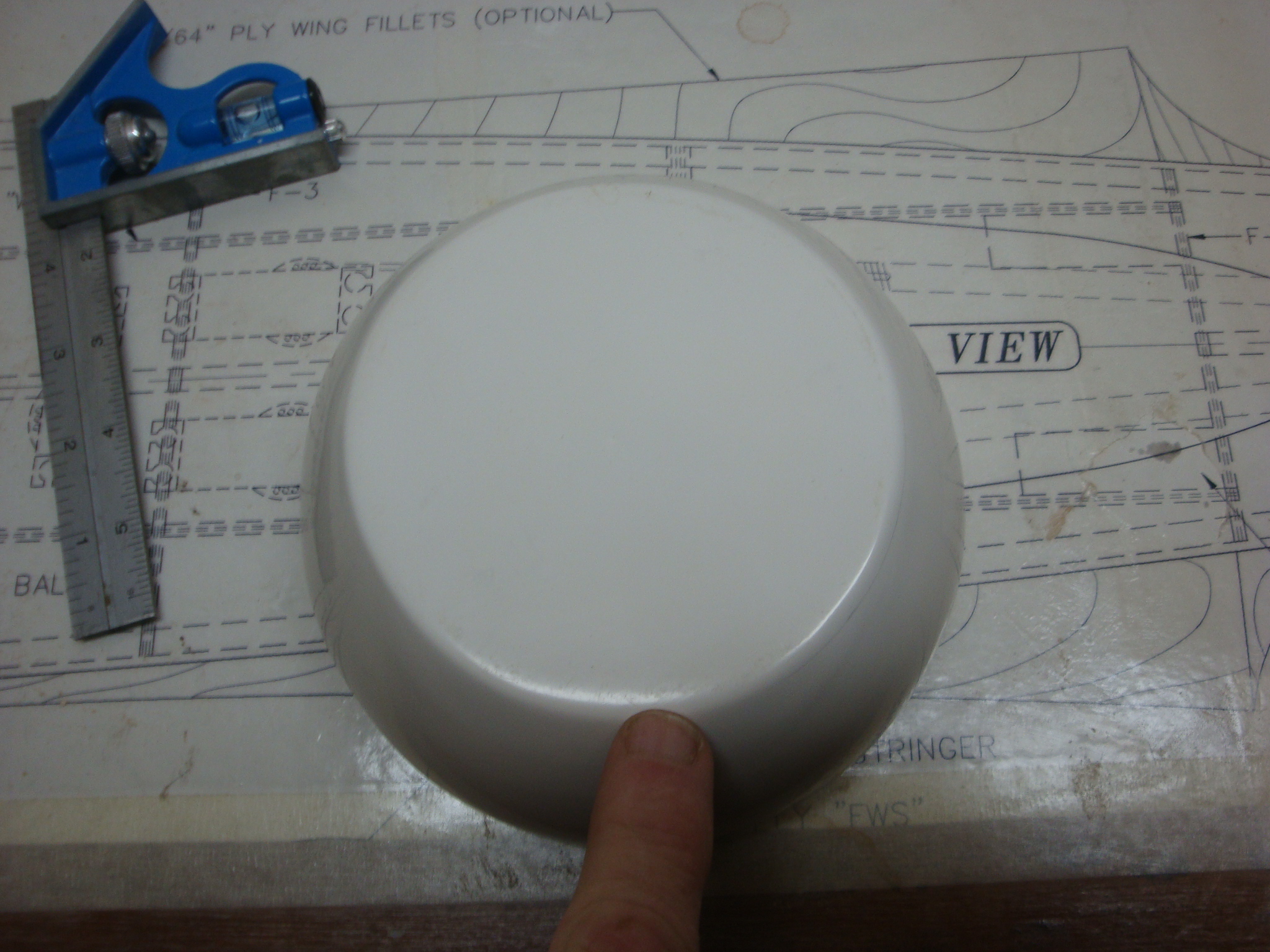

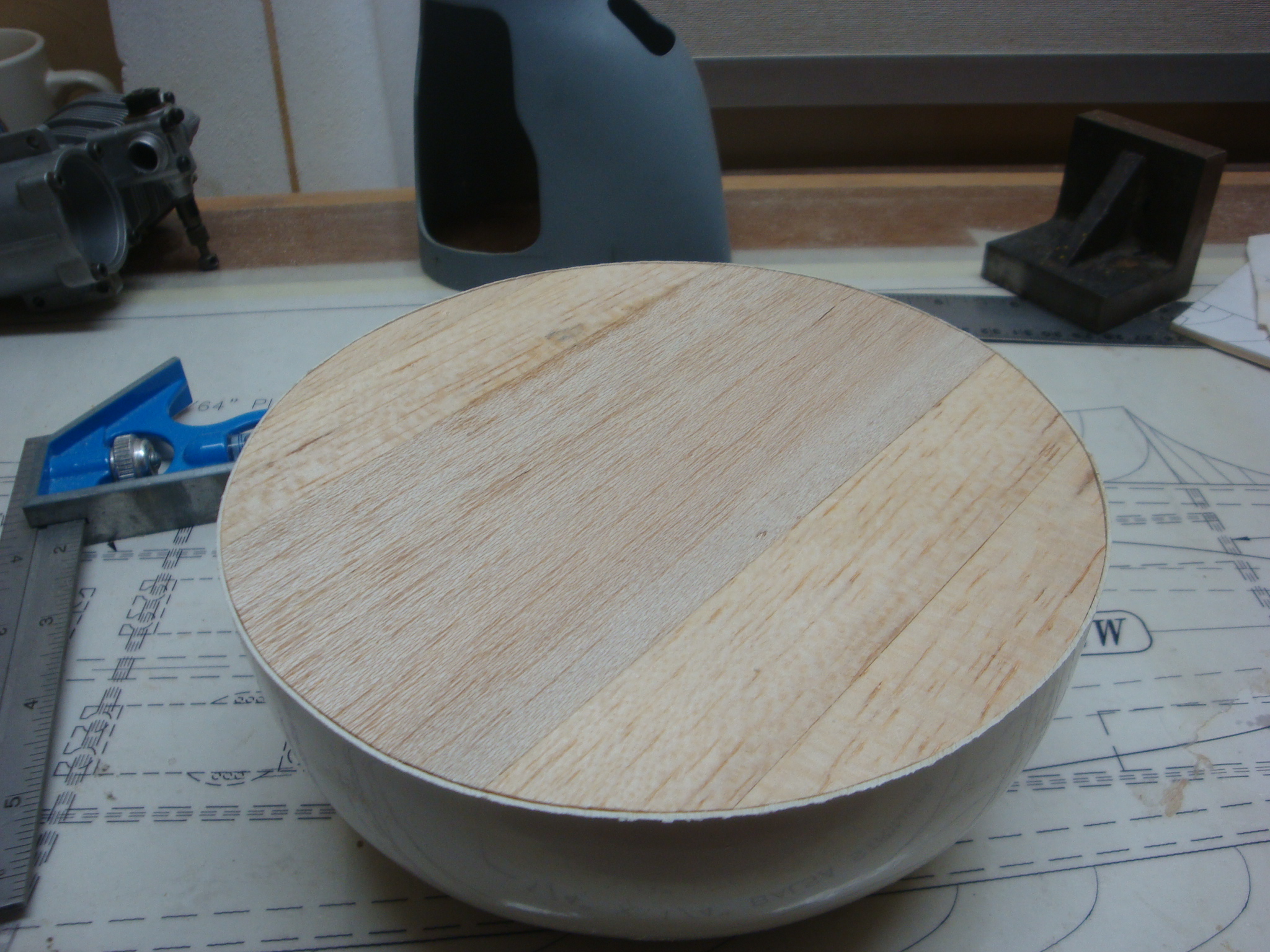

I just made a thick balsa cap for the back of it, after I glue that in I will put a hole in it and pour in some hydraulic cement to stabilize the shape. Then shoot some primer on it and sand, reprime, sand, reprime, etc..., Then stick it to plexi and lay up a mold. I found some pretty bad out of round in it at the front where the smaller diameter starts I can sand a little of that out but the thickness of the ABS is not sufficient to get it all. I will put a thick cove of gel in the transition so you can work that area over and not sand thru it. Pica Waco, not for the faint of heart! I

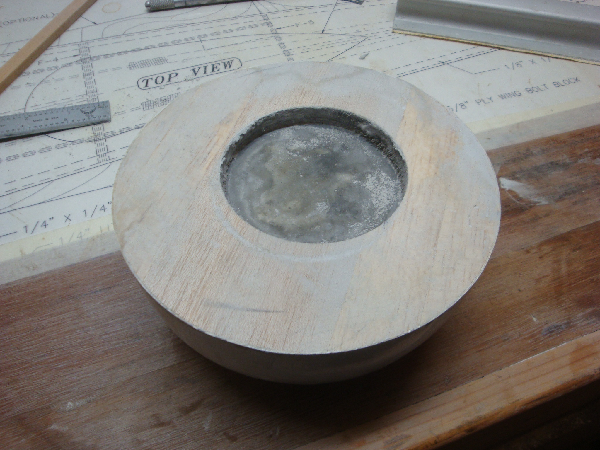

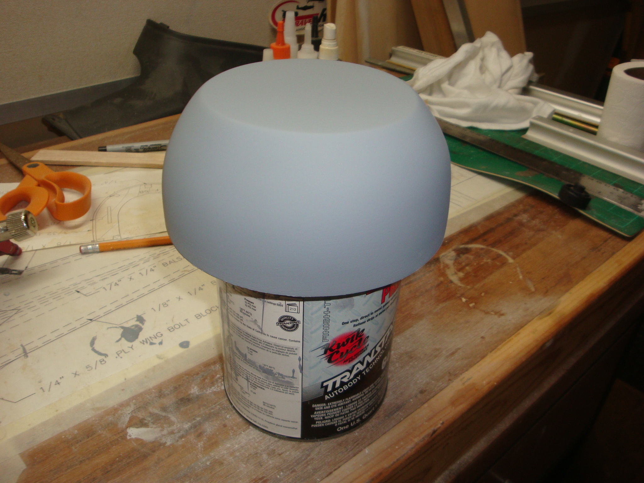

I got the cement filling into it early this morning, I'll give it a sanding and then shoot a thick coat of 2K on it later. I forgot how warm that epoxy cement gets as it hardens, not so hot that it melts anything, but pretty warm.

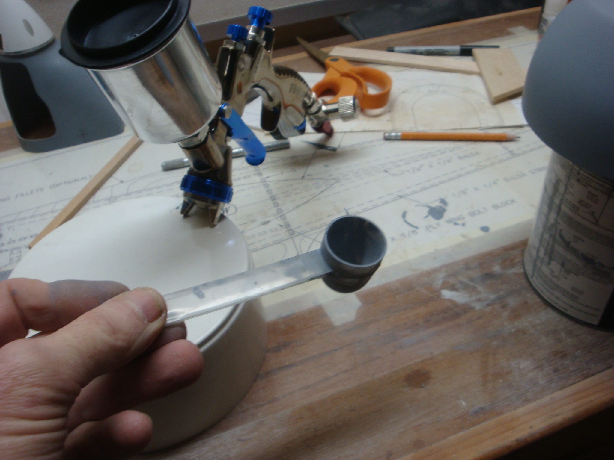

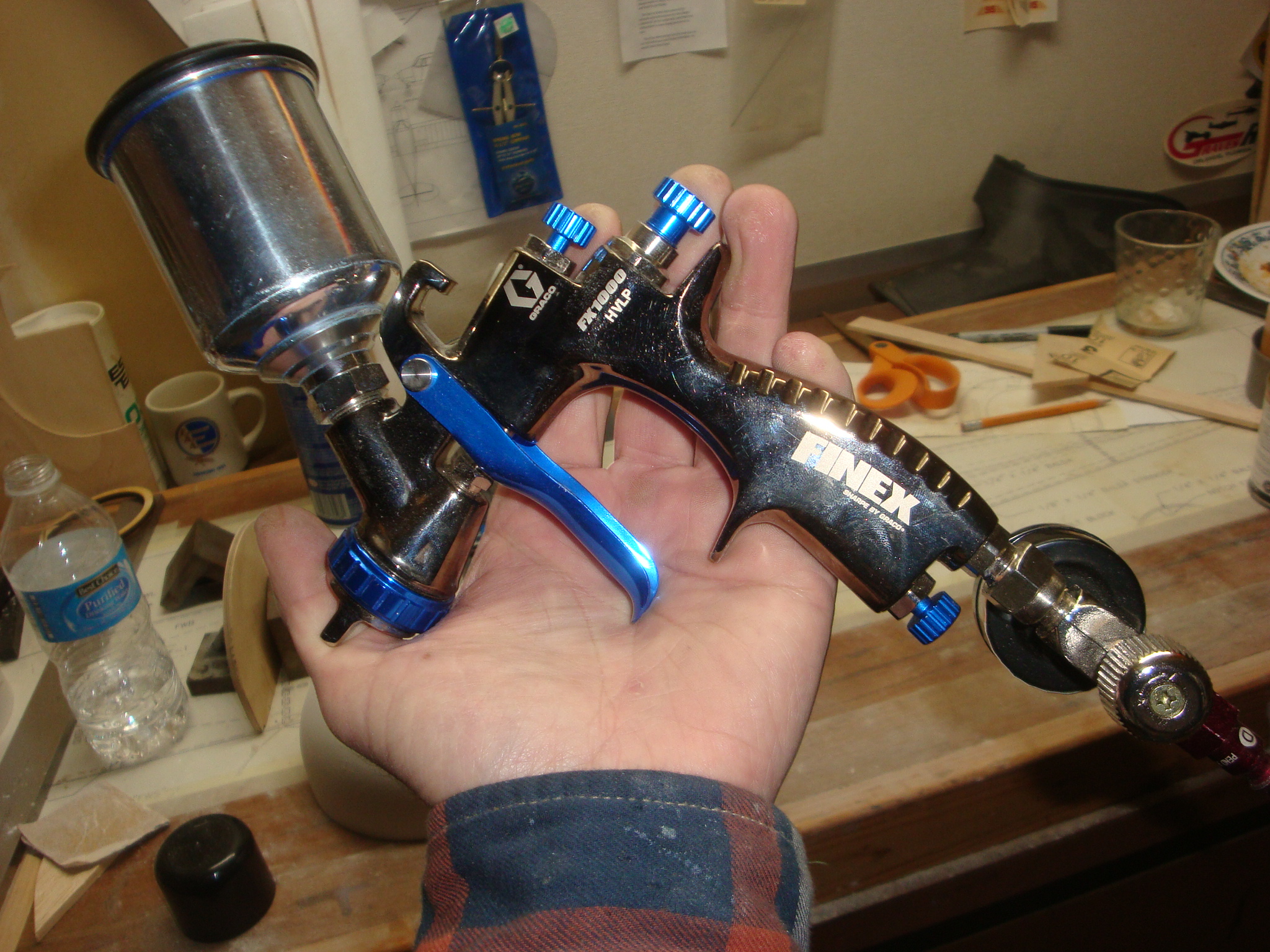

Worked it over with 150 grit. I was able to knock the horns off those out of round areas more than I thought I could. Here is an absolute gem of a spraygun that I bought last year. I've always used the little SATA HVLP guns but they are getting super expensive (not like they were cheap before) and basic maintenance parts like nozzles and aircaps are just stupid expensive. I have big HVLP guns made by Sharpe that I really like and I saw they made small guns too called FINEX. They are great, 95% the quality of a SATA at 1/4th the price, if you shop around you can find them in the 105$ to 120$ range. What I really love about these little gravity feed guns is how miserly they are with material, I was able to put three good wet coats on my cowling with one plastic coffee scoop (see pictures) of primer, and clean up doesn't use a ton of solvent.
