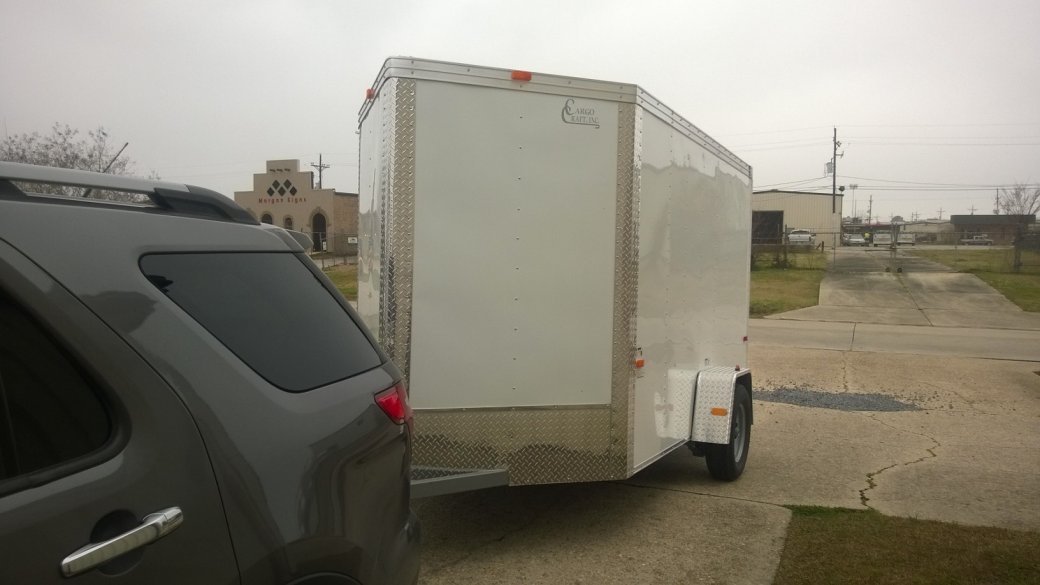

Rest day on wednesday and E-Trac on Thursday. Leave Fri morning...it better warm up in Shreveport!

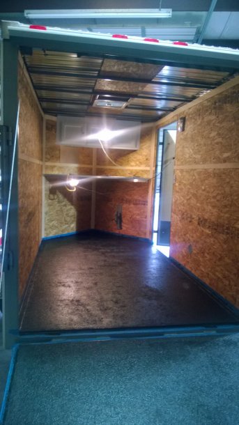

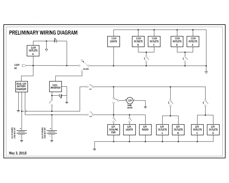

Plans are for latex paint on walls. Power Distribution for 120 VAC (Honda E2000) and 12 VDC from Marine Battery. LED Lights running off 12 VDC. (Need some good sources for prefab 12 V LED's). Storage bays under work bench for Gen, Gas and Batts.
Will modify as needed, as I admire the trailers at the events!

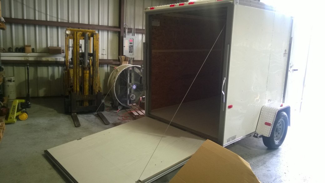

Have a month or so before the next plane project starts, so, need to get the trailer knocked out.
This is a bit of over kill, but, might as well do it like I want it and now is the time. The schematic will make more sense as this unfolds.

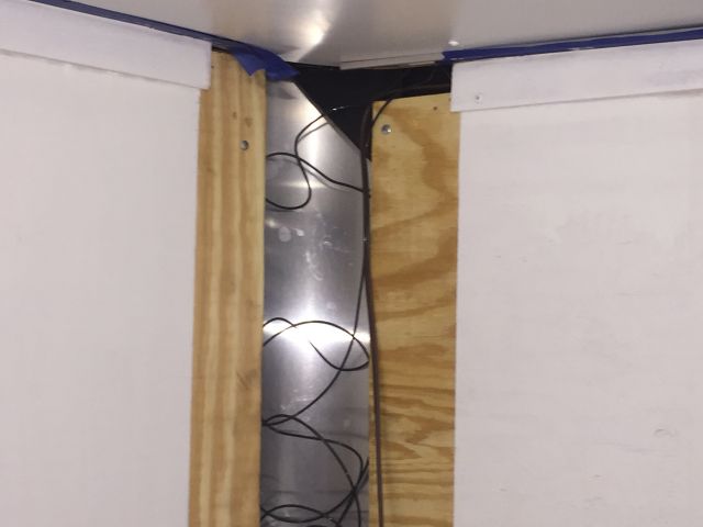

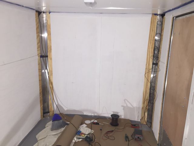

7 x 14 with a 6'6 ceiling, insulated walls and ceiling... just some primer and the start of some wiring. Ran some speaker wire and tapped into the ceiling lights and vent fan. little more paint and will start on the cabinets and all the stuff in the schematic.
