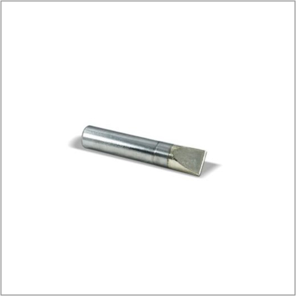

ryan_m
I like big fat tips for soldering. Ideally ones that look like this one. They hold a bunch more heat and make soldering even large 10 gauge wires easy. I use a 40 watt Weller with a fat chisel tip.
