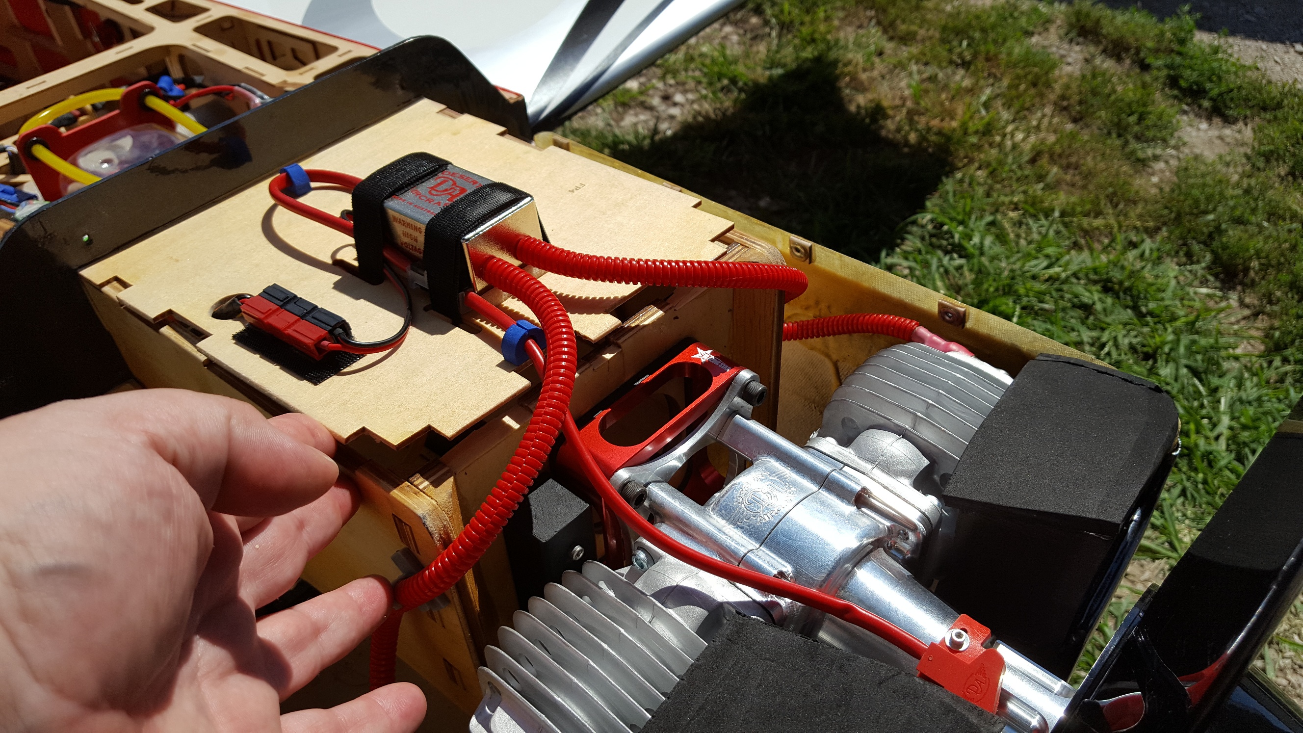

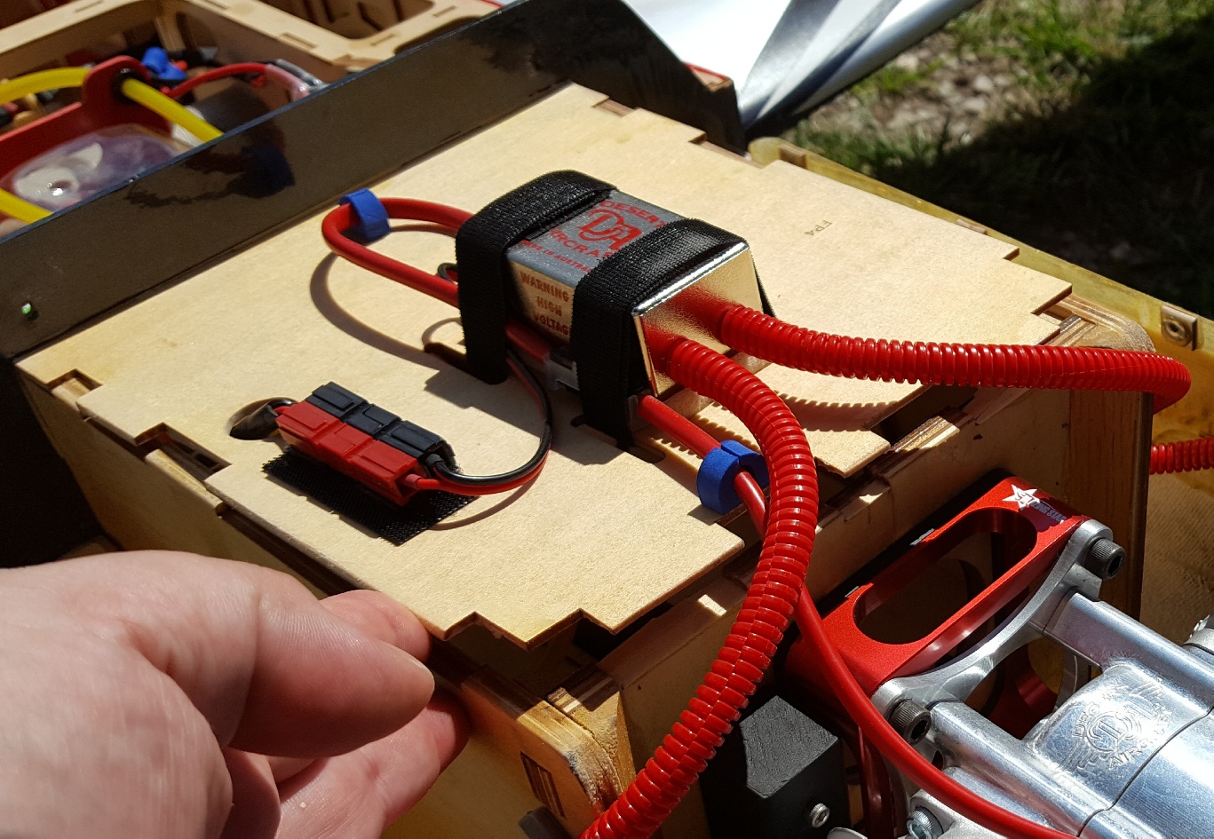

A new quality control problem cropped up on the Hangar 9 Extra. On my second flight the airplane started making an odd whirring noise when going fast and then dropping to an idle. I decided to land to check it out and when I came in to land it was idling way higher than when I took off. I went around and dropped the trim a few clicks and it was still idling fast, but landed fine. Tony said the engine seemed to be moving more than normal so I pulled the top of the cowl off to look.
I think this explains the noise, but even though the engine moves because the firewall flexes, I don't think it's moving enough to cause the idle issue, but maybe it is. I'll find out more when I can get it in the shop and pull it apart.
View attachment 105601 View attachment 105602
Yikes, that could have not been good. I seen a video once of an engine launching itself way a head of the plane it once was attached to. Needless to say, it did not end pretty. I would be that firewall is flexing just enough to cause your throttle arm to move just enough to give you and unstable idle. Re-epoxy that dude and put some wood dowels or screws through the top motor box plate directly into the firewall.
That just should not happen I know they cut corners and skimp on glue but of all places not the motor mount. The only good thing to come of it is you caught it and nothing happened.

Yikes! Screeching metal and locked up engines are never a good thing. It makes my engine box issues seem pretty small.
