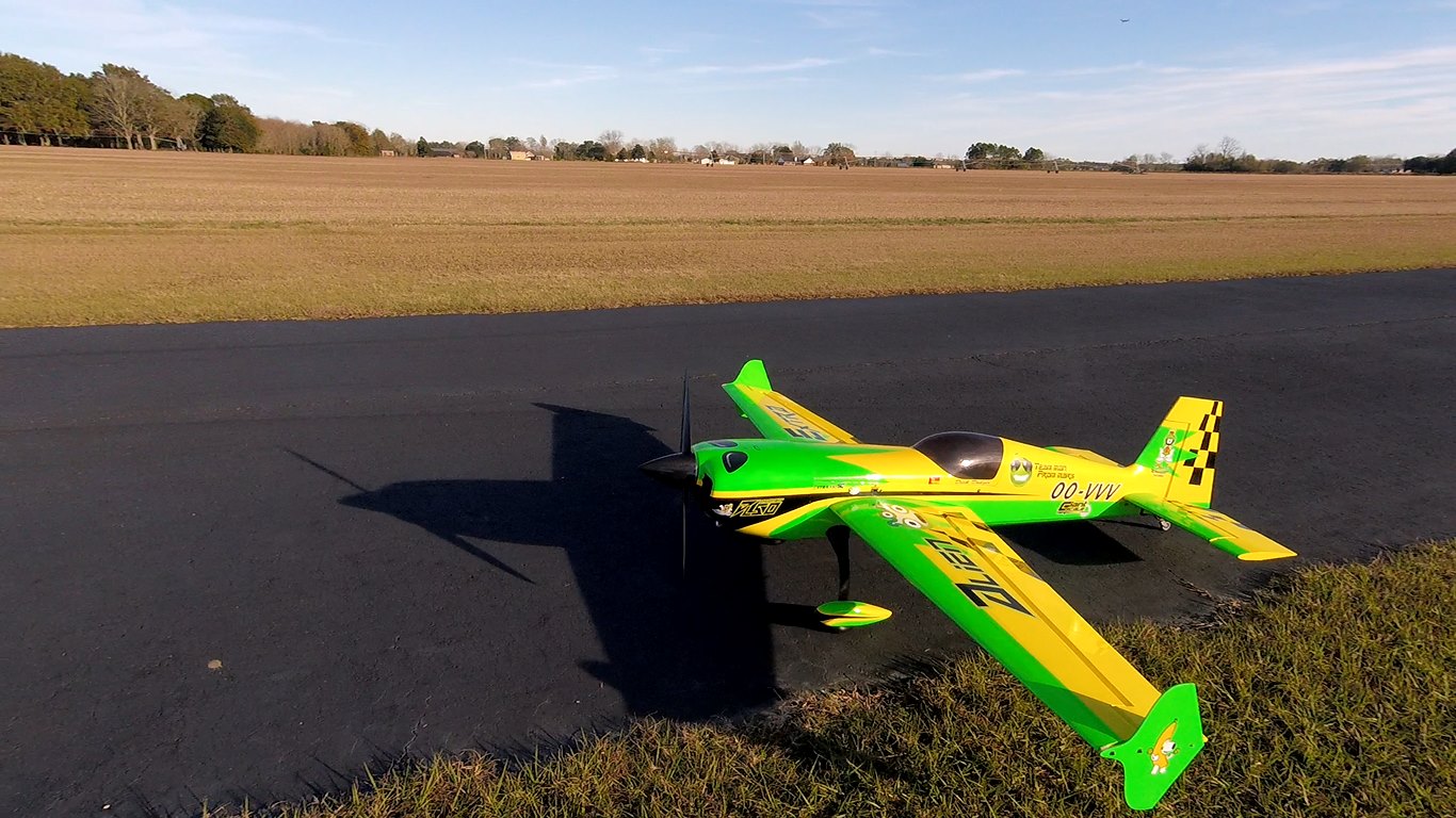

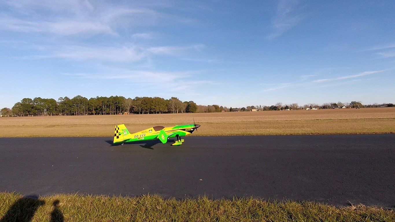

. So after watching a good hour and a half of my flying time fade away I finally found the problem (open ground connection on the battery clamp itself and not the battery post) . The ground wire was firmly attached but corrosion/copper oxidation formed an electrical barrier/insulator inside the clamp. So with a little elbow grease and lithium grease all was made good and off to the strip I went. I was starting to think I was cursed by this DJ72 but it fired right up and ran like a champ. Flies the Alien extremely well even being choked down a bit with the air filter. And the new AX3000 flight system works great. My plane is a real "Floater" now and rock solid in harriers/elevators and high alpha KE. Feels so good to handle and flies like a totally different plane. I only got two flights in. One to check engine performance and reliability and a nice long (for me) 15 minute one playing with the new flight system. I put the gain and stabilization mode on the rotary knob on my transmitter and easily transitioned from "stabilization" to "heading hold". What a hoot it is! Held a High Alpha KE pass hands off! Hovers hands off too! Kept it high in the sky whilst learning this thing but in short time (Long as the truck starts lol) will have it to the deck.
