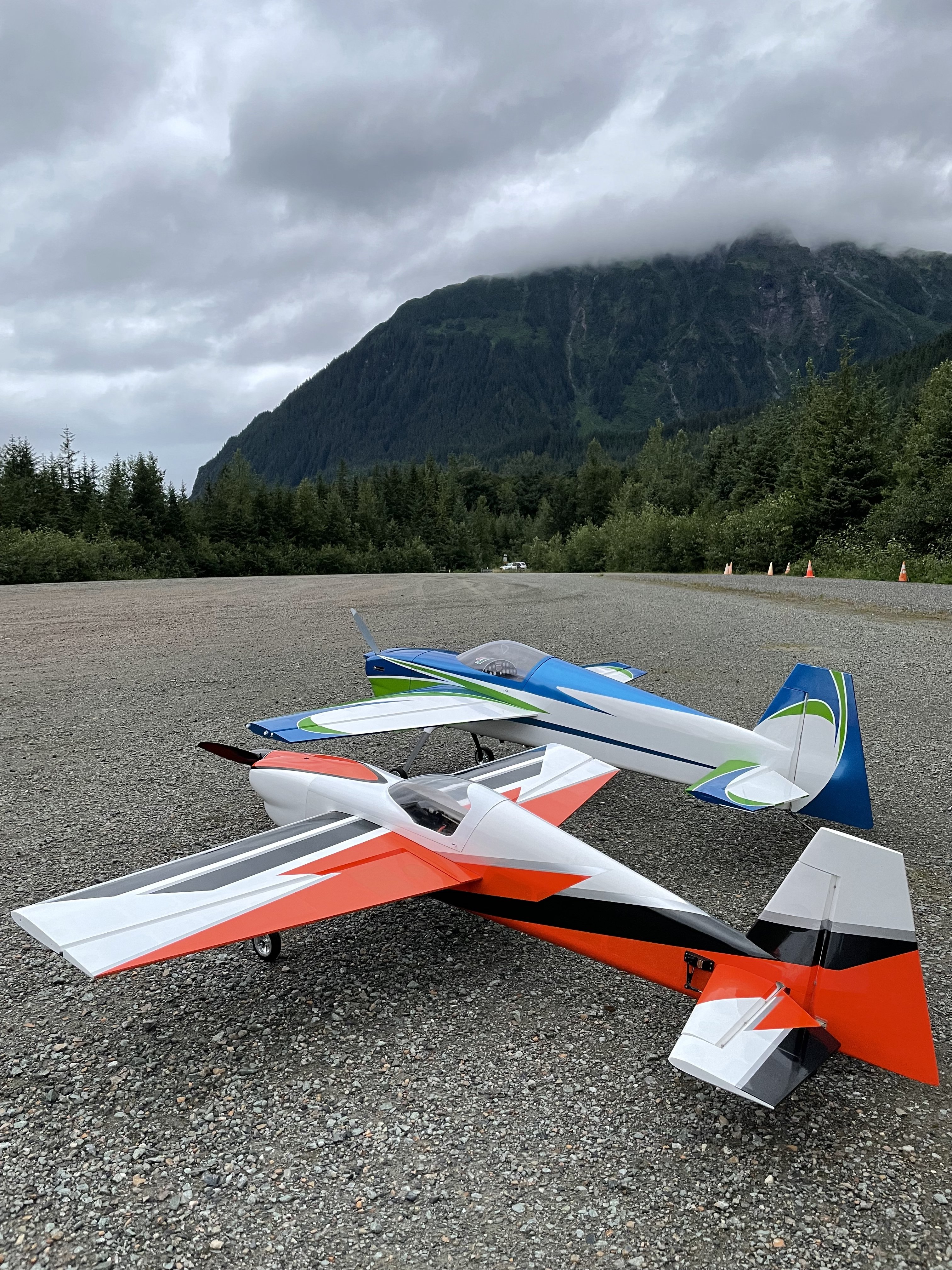

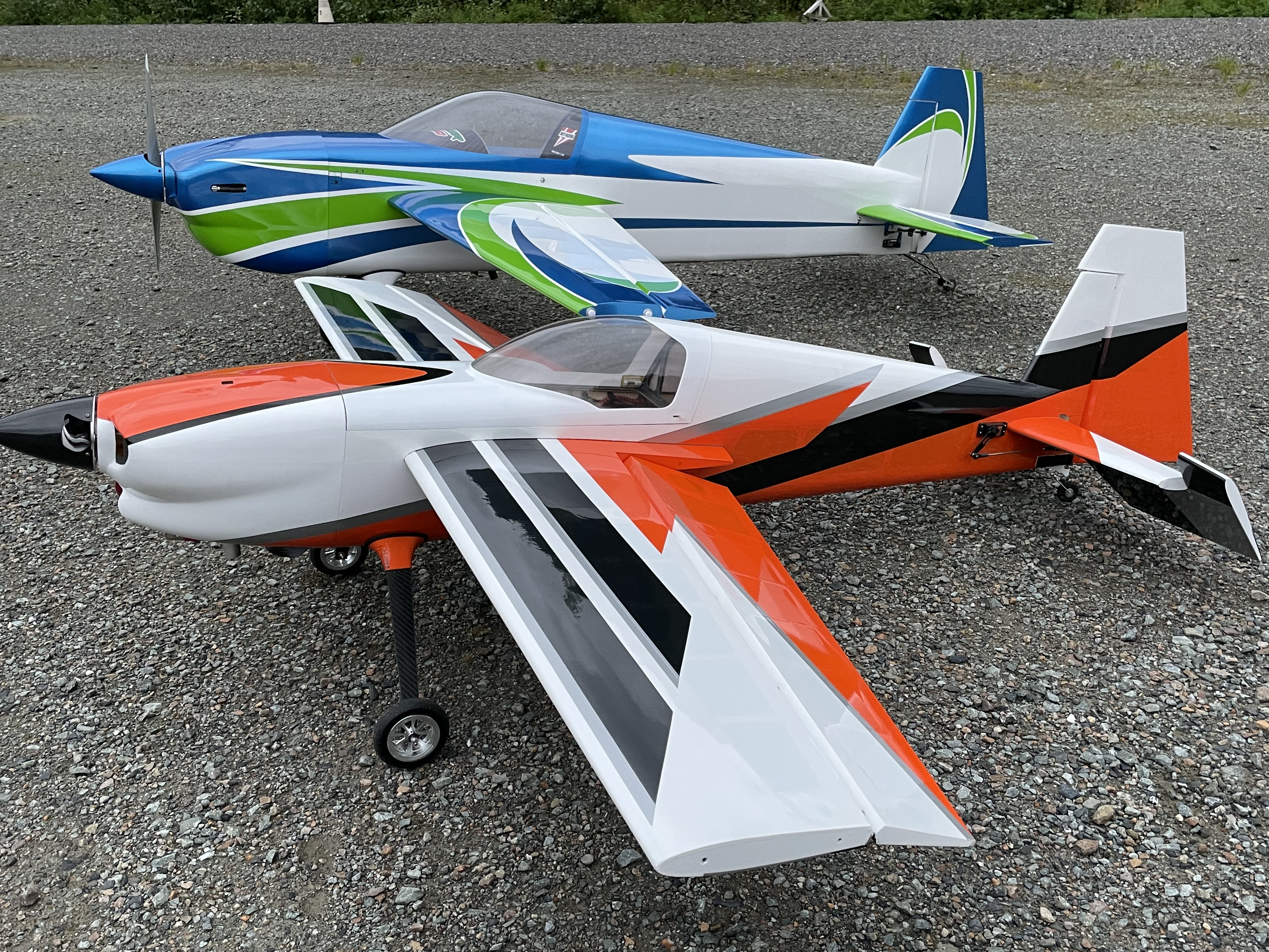

Took the 89” laser out along with the 75” edge. Both flew great. Need to figure out my throttle response on the laser - was playing with the throttle curve but it’s not helping much. Super peaky at mid range. I’ve never run a canister before and am curious if this is part of the issue.
A4C1DCC4-84AE-478D-B7A1-14880EC8D85C.jpeg 46ACC6C7-5534-4B7D-AE53-6227AF17F519.jpeg

Shouldn't be the can. All my planes up till now had can's. Never had that problem. I was told can's can't be tuned. Trust me, I tried.

Roger that, It seems strange to me that the engine feels like there is no throttle movement from 1/3-1/2 then just wakes up and starts pulling super hard. Time to investigate. Think I have about five flights on the plane now. It's very consistant so I'm guessing I have a geometry issue... I tried the linear setup 1/2 stick - 1/2 throttle - 1/2 servo movement. I'm thinking about re-doing the throttle to utilize a geometric setup like I have in the ARS which I really like... but maybe my curve is just messed up. o_O

Somewhere sometime ago I was told that cans should be installed at the quarter wave length for what it is worth. I normally just make the headers work for the plane. I did build my Christen Eagle around a ZDZ 80RV with the supplied header and JMB can and it has very linear response.
