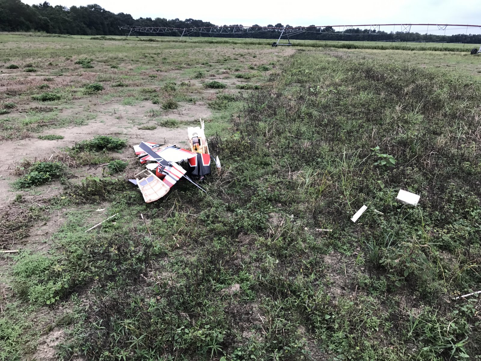

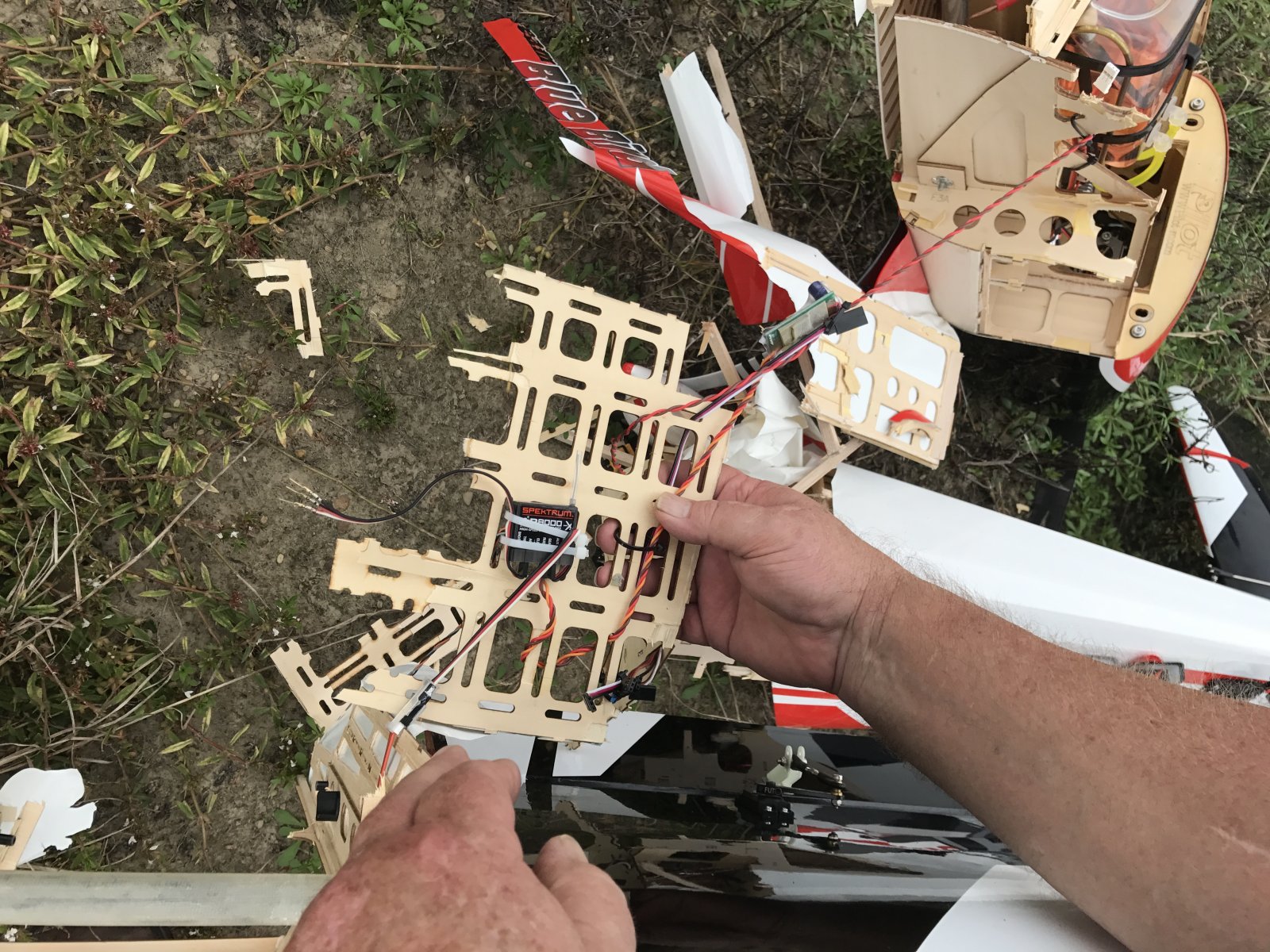

Now I'm a bit rusty but this is due to radio failure :very_angry:.
Both batteries read 90% or better. Damn thing locked up about 200 yards out at about 200 feet up.
When I approached the plane it was snapped in half and pulled both power leads out so I could not see if the AR8000 and remote were blinking or not. Spektrum :cautious: ??? :steamer::steamer::steamer: ? Had to be the new stickers :pink_epic:.

Looking on the bright side......The first pic is exactly how I found it after impact. All balled up nice and neat ready to be toted off to the scrap heap. Guess I need to get the DL50 rebuilt and sold and a DA 70 bought along with a Pilot Edge. Just don't know if Spektrum going to do any more guidance or miss-guidance for that matter.

I had great success with Futaba as long as I kept it all Futaba. When I decided to use blue bird servos Futaba worked great until these new H50B servos showed up and the Futaba gear did not like em. Spektrum however liked em and they worked perfectly. Now these Blue Bird servos are very power hungry and I am thinking I may have browned the receiver. Thing is I just got done with some hard g tumbles and was heading on my down leg for landing at part throttle so no high servo load was being seen by the radio when the gravity storm struck. I am leaning towards "reception". I also wonder if I had the IBEC mounted too close to the Rx? But I have flown it 4 times with no issues. The only thing different this time out is that I made a really long scale like down leg to final. When I turned to the right for final it just stayed with the ailerons locked, slight up elevator and a tad of left rudder. It gently spiraled downward. At about 10 feet from terra firma I saw the nose amazingly pop up as if it was in a hover! So I gunned the throttle but had no response. I hit the kill switch and just let the sticks go to neutral as it flipped over on its back then hit the ground nose in first wings level.
