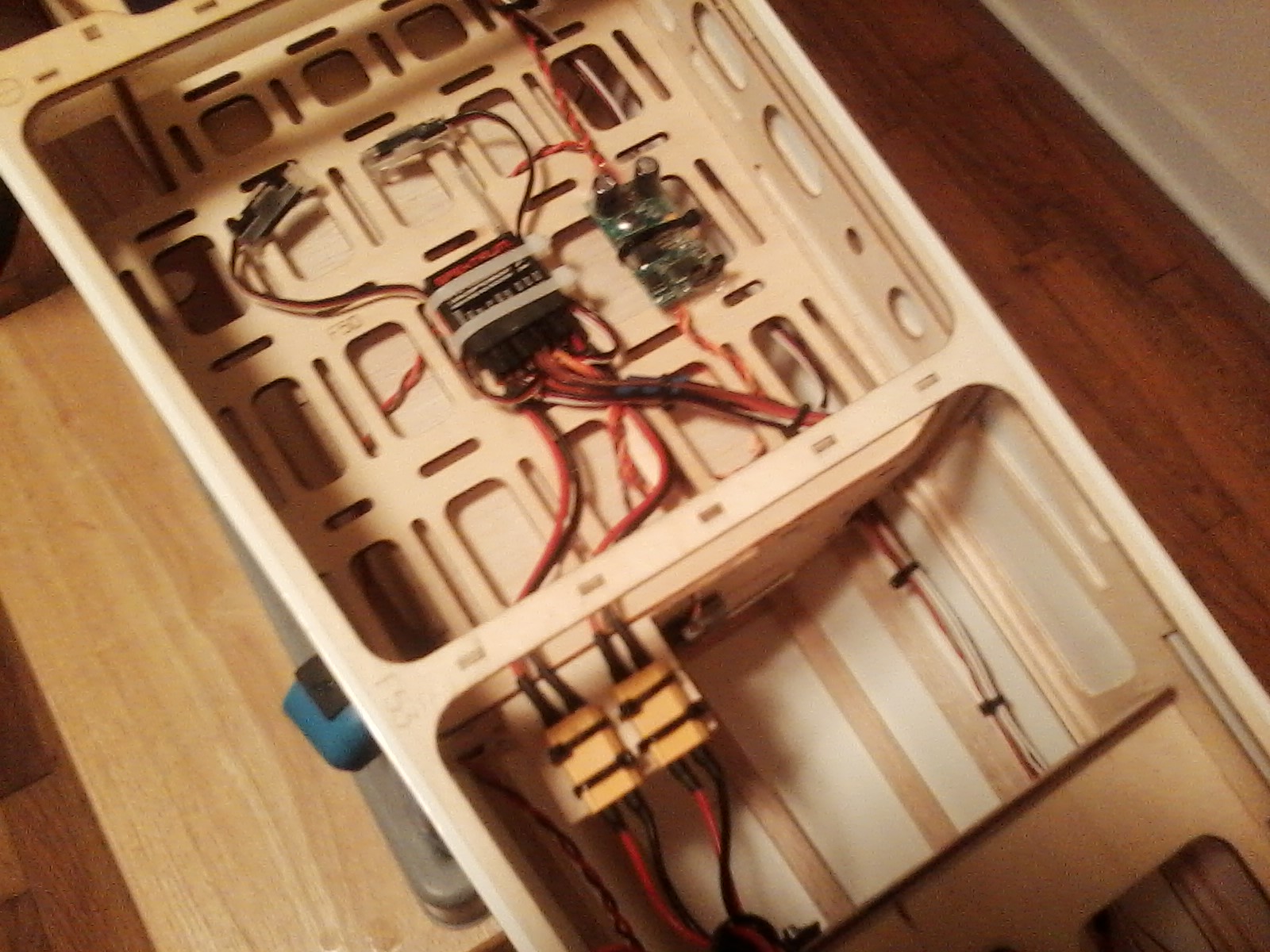

I had great success with Futaba as long as I kept it all Futaba. When I decided to use blue bird servos Futaba worked great until these new H50B servos showed up and the Futaba gear did not like em. Spektrum however liked em and they worked perfectly. Now these Blue Bird servos are very power hungry and I am thinking I may have browned the receiver. Thing is I just got done with some hard g tumbles and was heading on my down leg for landing at part throttle so no high servo load was being seen by the radio when the gravity storm struck. I am leaning towards "reception". I also wonder if I had the IBEC mounted too close to the Rx? But I have flown it 4 times with no issues. The only thing different this time out is that I made a really long scale like down leg to final. When I turned to the right for final it just stayed with the ailerons locked, slight up elevator and a tad of left rudder. It gently spiraled downward. At about 10 feet from terra firma I saw the nose amazingly pop up as if it was in a hover! So I gunned the throttle but had no response. I hit the kill switch and just let the sticks go to neutral as it flipped over on its back then hit the ground nose in first wings level.
Thanks Doug.
In your pile of rubble pic, I can't tell if you had a remote receiver plugged into the AR8000 or not? Just curious.
